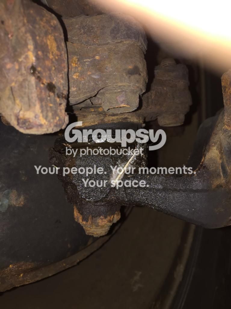

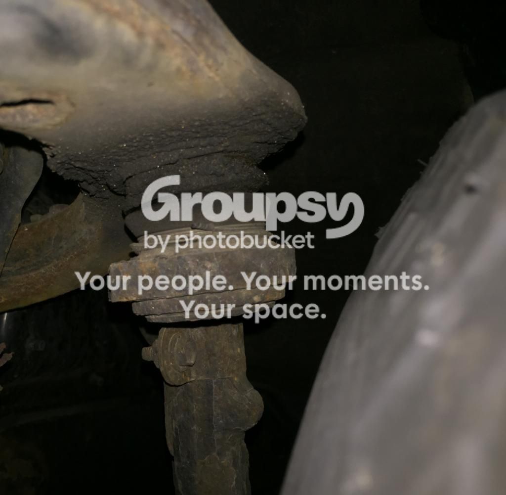

Drivers side LBJ boot is definitely torn so that's on my ASAP list for replacement. I did not notice any visible play in either joint.
