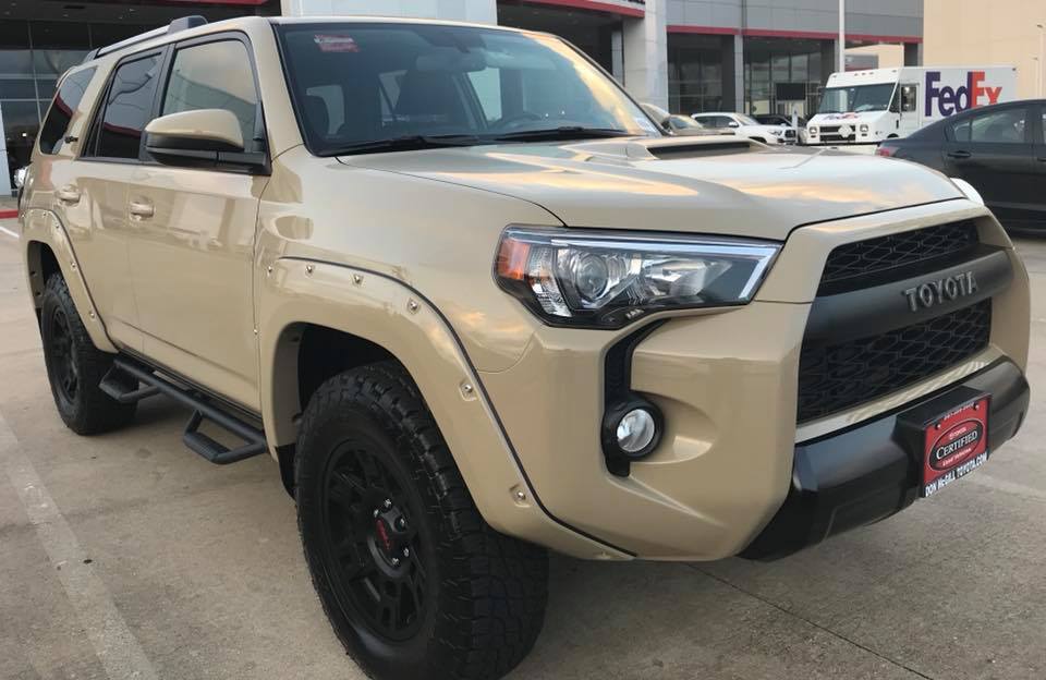

I picked this one up for my wife and it came as seen, I've never been a huge fan of this style of flares but I must say they are really growing on me, pretty sure they will stay on, I may just paint the bolts black though
Do you happen to know which running boards came on your wife's 4runner? We just installed a set of running boards bought locally and they didn't fit with the Bushwacker pocket flares. Thanks ahead of time or if anyone else has insight. We've only had ours for about a week!
Anyone have a picture of these on your nautical blue? I am wondering if I should color match them or keep them black?
Those look to be the Nfab Step Bars
https://n-fab.com/nerf-step-system/2017/toyota/4runner
Not great for off roading but better than nothing. You can get them online or at any dealer but the dealers around us (I also live in PDX) will jack the price up.

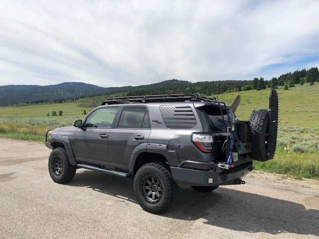

I had mine color matched to magnetic grey. The paint and prep to have them color matched was as much as the fenders.... so ~400 for the whole set of flares and another 400 for the color match. You can also try the duplicolor color match spray paint. I have used that for other external accessories and it is close but not an exact match (at least for magnetic grey)
https://www.amazon.com/Dupli-Color-...y+spray+paint&qid=1554074516&s=gateway&sr=8-3
