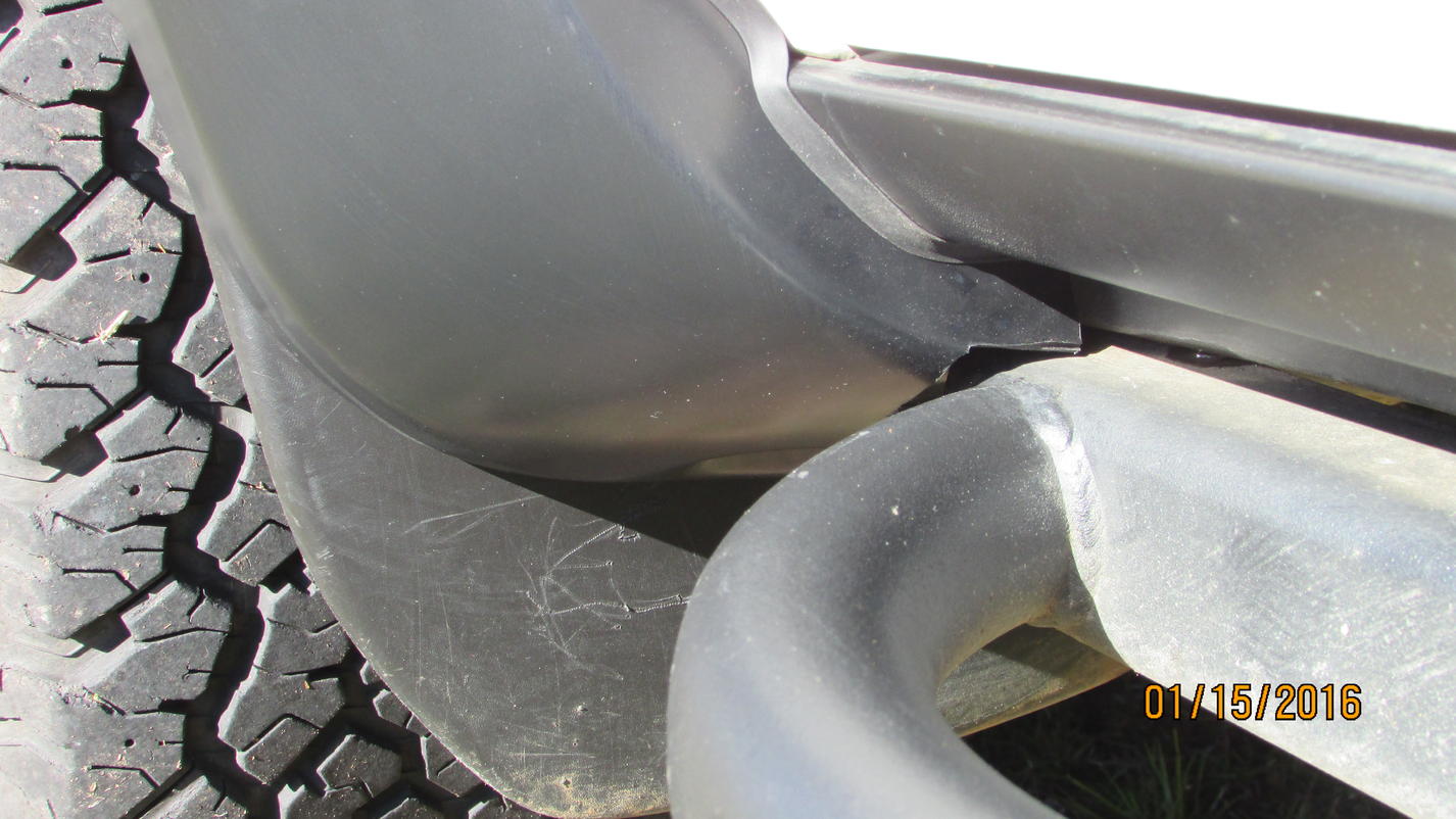

Curious on the ones running these flares with sliders
1. What sliders are you running?
2. Were they a direct fit or did it require cutting/modding the flares?
I had to make a small cut on both front flares to clear the tubing of my Shrockworks step sliders, but others were able to mount theirs over the same without cutting. :noidea:

I am not aware of any TRD sliders. There are a couple different models of running boards though.... can you post a pic? I had to notch my front bushwacker flares for my OPOR sliders. It was easy, and I cleaner job than the pic a couple posts up. ;) (sorry 3wbdriver.... I really appreciate your input on them and I used your idea. I had to tease)

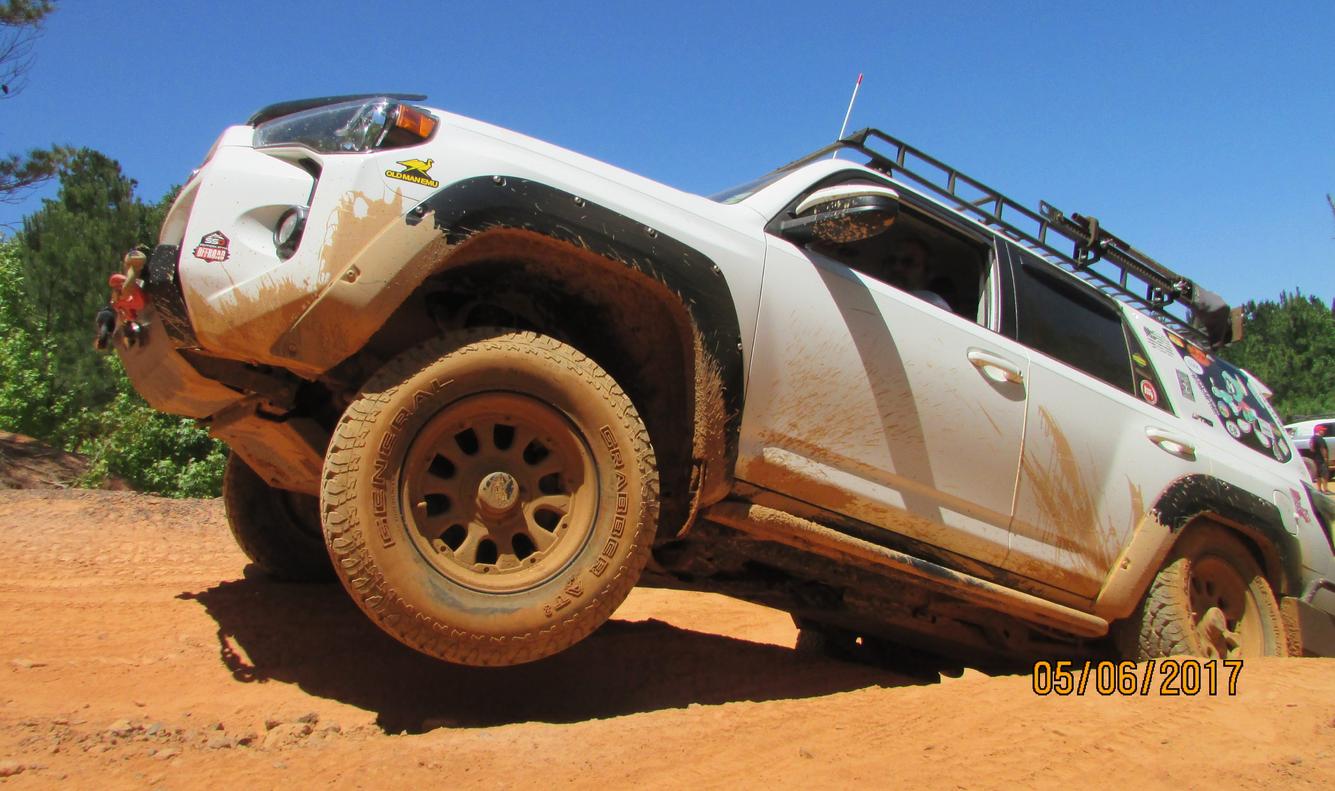

For those that did the fender liner mod with some trimming of the bumper cover before. Did you have to trim the very bottom of these as well? or do they not cover all the way down to the end of the bumper cover?
I had already done a fender trim when I mounted mine. If anything I need to trim more fender because there is a little white still showing if I get down low. And these do wrap all the way down.

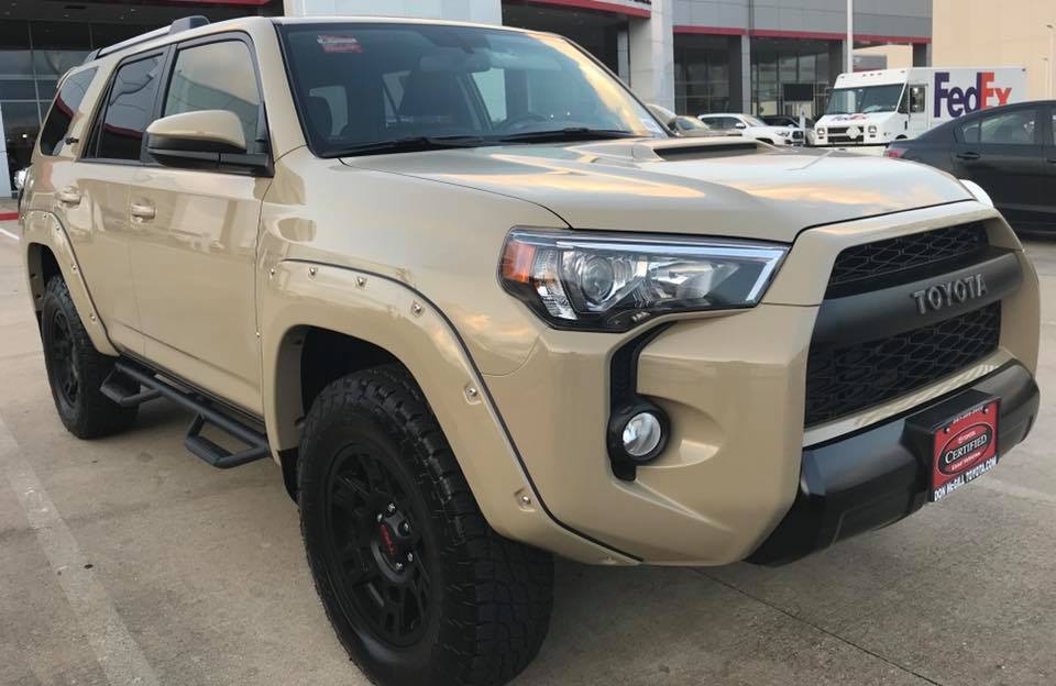

I picked this one up for my wife and it came as seen, I've never been a huge fan of this style of flares but I must say they are really growing on me, pretty sure they will stay on, I may just paint the bolts black though
