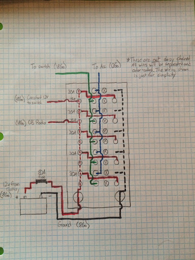

Ok so here is what I came up with. I think it should all work, but please let me know what you think. Edit: Sorry if this is too small. I could make it bigger if you need it.

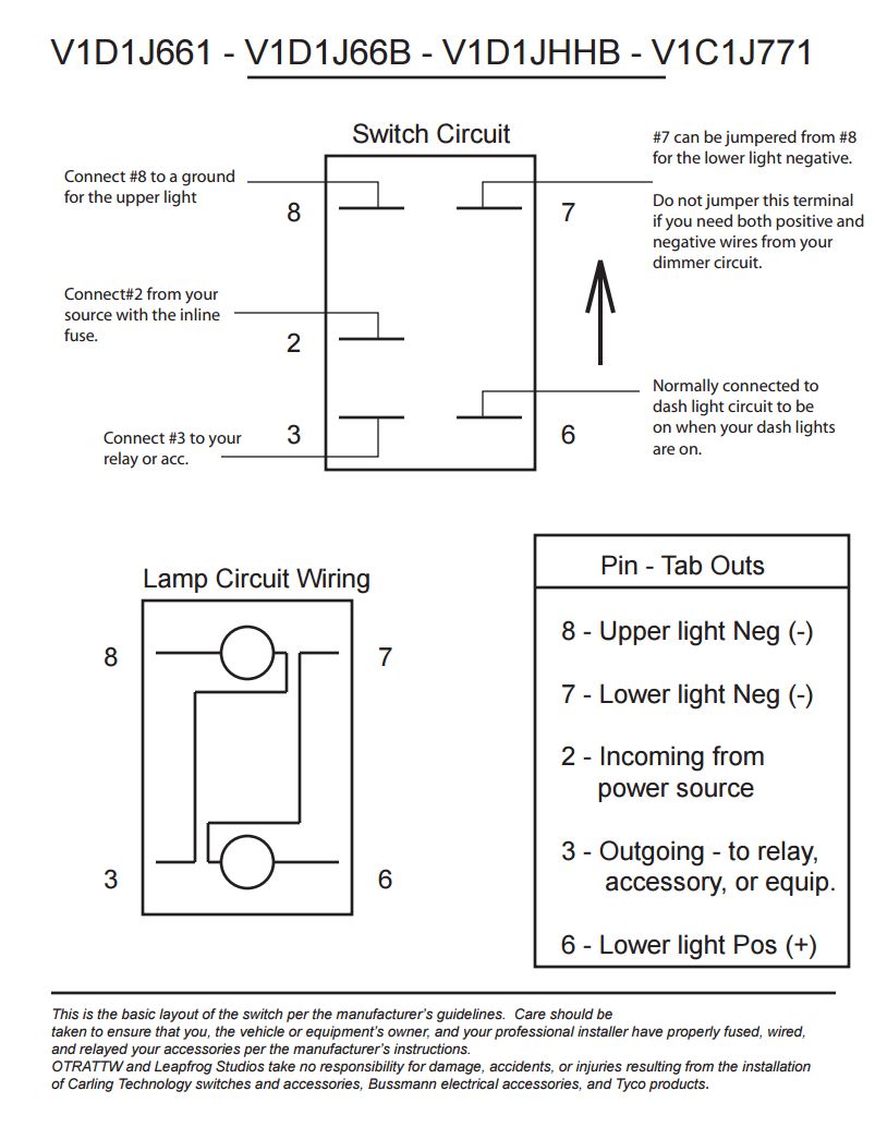

The only thing I am a little confused about is the switch wiring. This is a switch I currently have, and I cannot figure out how to get that damn lower LED to work. The wire coming out of the box labeled "To Switch" will go to pin 3 (daisychained to other switches). The constant 12V will go to pin 2 (daisychained to other switches). Pin 7 will be daisychained and grounded, as will Pin 8, although they will be separate. That is how I currently have it and the upper LED comes on. I tried tapping a fuse in my normal fuse box and connecting it to 6 for the lower LED, but that didn't work. I don't want to damage the factory wiring too much, so I might use a T-Tap on a wire in an unused switch that I know only comes on with the dash lights. Then I'll daisy chain that to the rest of the switches. Would that work? Here is the diagram for reference.

Thanks for the diagram! Pictures make this much easier.
Pre-edit: <s>I think your diagram has the relays flipped around, as if they were installed 180* backwards. The fuse box shouldn't be supplying a common bus to the coil (pin 86 on the relay), but rather the switch pole (pin 30).</s> Now I think I was wrong and your diagram is correct. This changes a bit of what I was saying in previous posts as well, sorry!
Okay, so first: The dotted red supply bus from the battery to the fuses would terminate at the unseen terminals (like you did for the dotted black line to the relays). Your circles there are the fused outputs from that bus, half of which you've routed over to the relay circuits (pin 87). Not important, but you could route those wires to pin 30 instead to have a slightly shorter/cleaner run. Your blue wires would then move over to pin 87.
The outputs from the relays are your blue lines, I'm reading your note to say that you realize each circuit gets it's own blue wire (so 5 total leaving the box). Those will supply relay controlled fused high current power to your accessories.
To turn the relays on/off, you have your switches providing switched +12V on the green wires to the relay coils (pin 85), and the coils grounded via pin 86 and the common bus within the box. That'll work fine, <s>but if you reverse this control scheme your wiring will become slightly simpler...</s> *The benefits are negated since you're using lighted switches and will have +12V at the switch anyway.
You don't need #8 for the battery ground wire; it's only carrying the relay coil currents, which will be about half an amp for all 5 of them combined - even #18 is overkill! You also don't have to run it all the way back to the battery, any good chassis ground spot will do.
All told, your schematic should work fine! Sorry for trying to steer you wrong before - some of the diagrams are top down, others are bottom up, spacial manipulation can be tricky.
As for the switch wiring: You can't daisy chain pin 3 on the switch to other switches/relays, that's it's individual switched output and should go to a single relay's coil contact (pin 85). i.e. you should have a bundle of 5 green wires coming out of your relay box, just like the blue wires. You're fine with what you're thinking on pins 2, 7, and 8. For pin 6, I don't know why tapping a fuse didn't get it to illuminate; it should work fine if you supply it +12V as long as pin 7 is grounded. Maybe jumper pin 6 to pin 2 just for a quick test - if it lights up, all is good. After that, you'd be fine tapping into an existing illumination wire on some other switch (can't help you with which one though, sorry) and then daisy chaining that to the rest of your switches.
Hope that helps, and good luck!

Thank you for all of your help! No worries about "trying to steer me wrong" lol. The reason I went with this layout was simply because if I switched the relays around (i.e. reversed them), then I would still get one bus for power but the other bus would be the pins for the switch activation. Not sure how I would bus that, as you mentioned I can't daisychain those. I know I can't daisychain them. I have no clue why I said I was going to lol.
I have seen other bussmann boxes like this with only one post for grouping connections (like I have with my Pos and Neg busses). These have more pin openings and probably offer more "customization" but I figured if I can make a common power and common ground simple, why wouldn't I? Also thanks for the heads up about the ground wire size.
Yea I am trying to use lighted switches. They are lit on the bottom when off, and then lit on the top and bottom when on. I still can't figure out the bottom light though. That one wire labeled constant 12V for switch is simply a fused connection from the box to the switches that will eventually get daisychained to other switches. That will allow the top light to turn on while activated. I am going to play around with other wires and fuses and stuff, but at this point I am thinking I may have gotten a bum switch. Might order another one simply to see if that is the case.

[MENTION=127401]Krayziekid[/MENTION] The front of my 2005 4Runner use to be lit up like a Christmas Tree (as someone once commented, haha) and having been there and struggled through the electrical connections to the OTTWATTW switches let me help you out. Attached is what will work.
I hope this helps you.

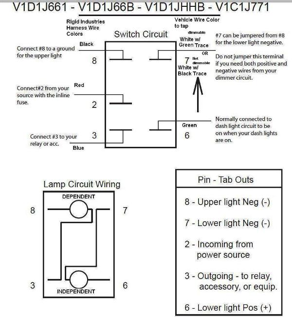

Question. Do those wire color labels on there correspond to the wires from the relay box I posted earlier? Or should I mainly just be looking at the two on the right (the top and bottom pins). If so, am I T-Tapping those two wires from an existing switch? Sorry about all the questions, but I really appreciate it!
I don't know what lights/ accesories you are using or what the harness looks like so if you can correlate to the colors of the Rigid Industries Harness then the left side of the switch could be useful to you...
However, I posted mainly for the right side wire colors to try to help you out. Yes, I just t-tapped as you say, into those existing wire colors, which can be found on the back side of any dimmable switch on your dash or center console. Don't overcomplicate that part of the wiring. Find the closest switch that dims next to your install and tap there (then daisy chain for your other switch bottom lights on the right side of the OTTRATTW switches, done.)..
Ok, one final question. When you say dimmable, you mean these switches will only light up when the dash lights are on right? They will be off otherwise?
