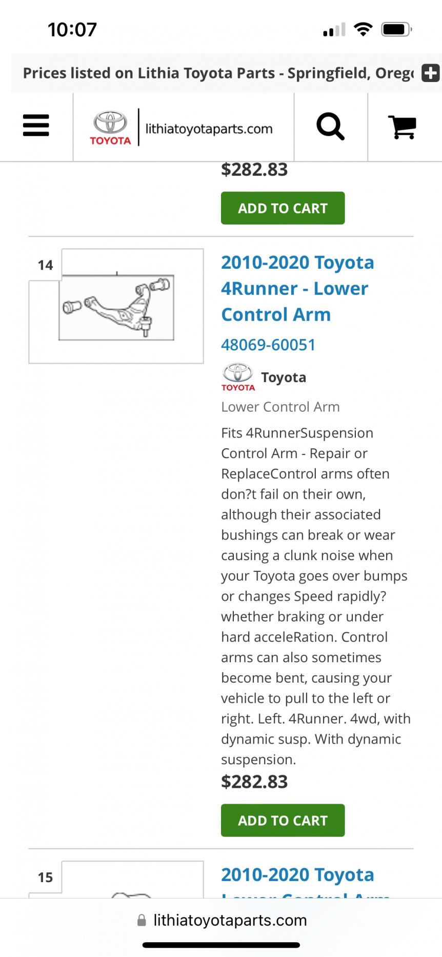

Also, whomever told you OEM LCAs are $1500 is lying through their teeth:
Not lying, per se. They SHOULDN'T BE $1500, but that's what they charge around here.
I live in CA Bay Area. Dealerships here charges huge markups on everything, including parts. Stevens Creek Toyota wanted $1,500 for LCAs. They wanted $400 for cam alignment bolts. Ridiculous. Same with Toyota SF. Also, none of the dealers here had parts available. They were backordered a few weeks to months and I couldn't have my only vehicle sit without suspension at a shop that long. So I went with Moog since they were available. I called a few out of state dealers but none of them would ship LCA.

You can always order Toyota parts online for far lower than the delearship will charge. Example: local Toyota Lithia dealership wanted $530 for an alternator. Got it from Lithia on line for $327 plus shipping. Had to wait two more days, but you have to get appointments at dealerships. Took me a little over an hour to install. There’s some education, but my expectations are low with you.
