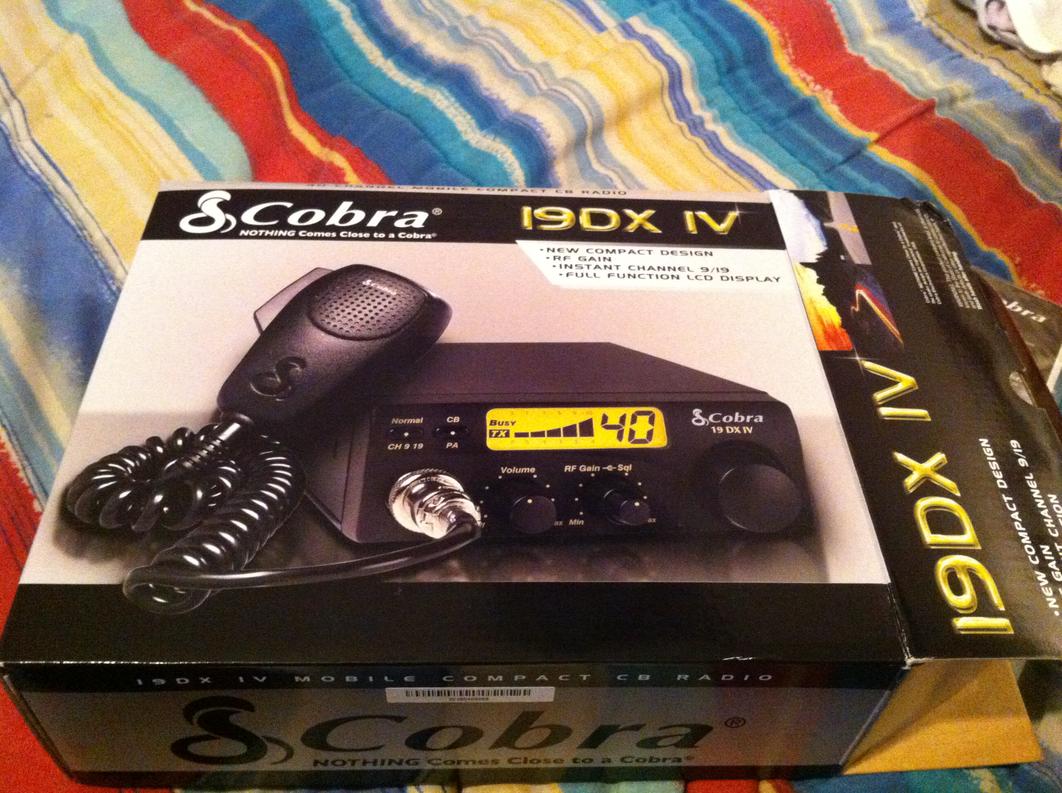

:party: look what i got today ... came across country in 3 days WOW!!
By seanlancer2011 at 2012-04-11
that one of erics(t4r4life) mounts?
yeah too bad I'm at school and i won't see it till i get back in may... hopefully will start to mod it the day i get home
