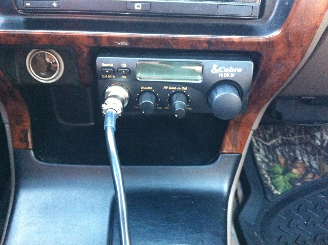

Ok guys i got almost every thing, just waiting on the spring shock. i was looking for a way to mount it. i took out the ashtray but dont know how or what to cut. or i was going to mount it the dash to the right of the stearing wheel. some advice?

Check my build, I did a little write up on the ashtray install. But the ashtrays are a bit different on the 96-98 models.
really wasnt as bad as i thought it would be. :reddance: now all i need to do is wait till the 22nd when i get my mount from t4r4life!

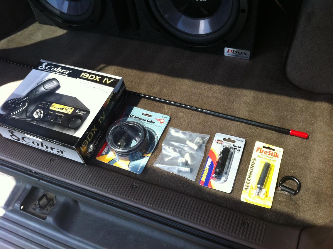

yea i got them on amazon, Amazon.com: Roadpro 90 Degree L Connector-PL-259 To SO-239 Right Angle Male-Female Excellent Performance: Electronics

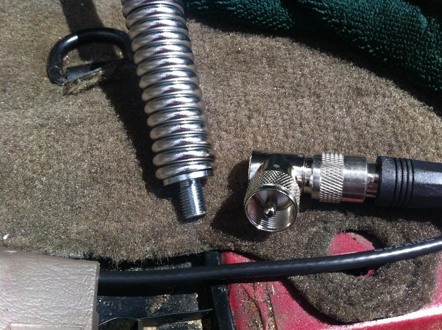

Thats the ony thing im worried about is the spring to antenna line, will it be a direct bolt up or do i need to order something real quick?
i hooked up my 90 then the coax, but the coax will mount right to it also.
I was going to go (top to bottom): Antenna(4' Firestik)>Spring>Quick Disconnect>tr4r mount>90deg coax fitting>18ft cable
So I don't need the K-4/K-4A mount? The coax screws right into the spring or quick disconnect? Didn't know those had coax connections on them. But you also can't tell from the pics.
Also...can't decide that 19DXIV or the 18WXSTII. Do I really need the 10 Weather Stations. I am in CO and weather changes here constantly. I like the smaller size of the 19DX, but can you hear the speaker OK if it's mounted in the ashtray? Opinions???
Looks like you need a Firestik Stud like you linked above. But I could be wrong. But glad these questions are getting asked cuz I wondered how the coax connected to the spring or quick disconnect.
my 90deg doesnt screw into the spring, i think i need some type if mount but im not 100% sure, i need someone to tell me that has done it!
i have the 19dx and you can hear the speaker fine in the position, at least for me in my 96, idk about 99-02
yea i think we need this. i better be able to overnight it or something in time for this weekend!
