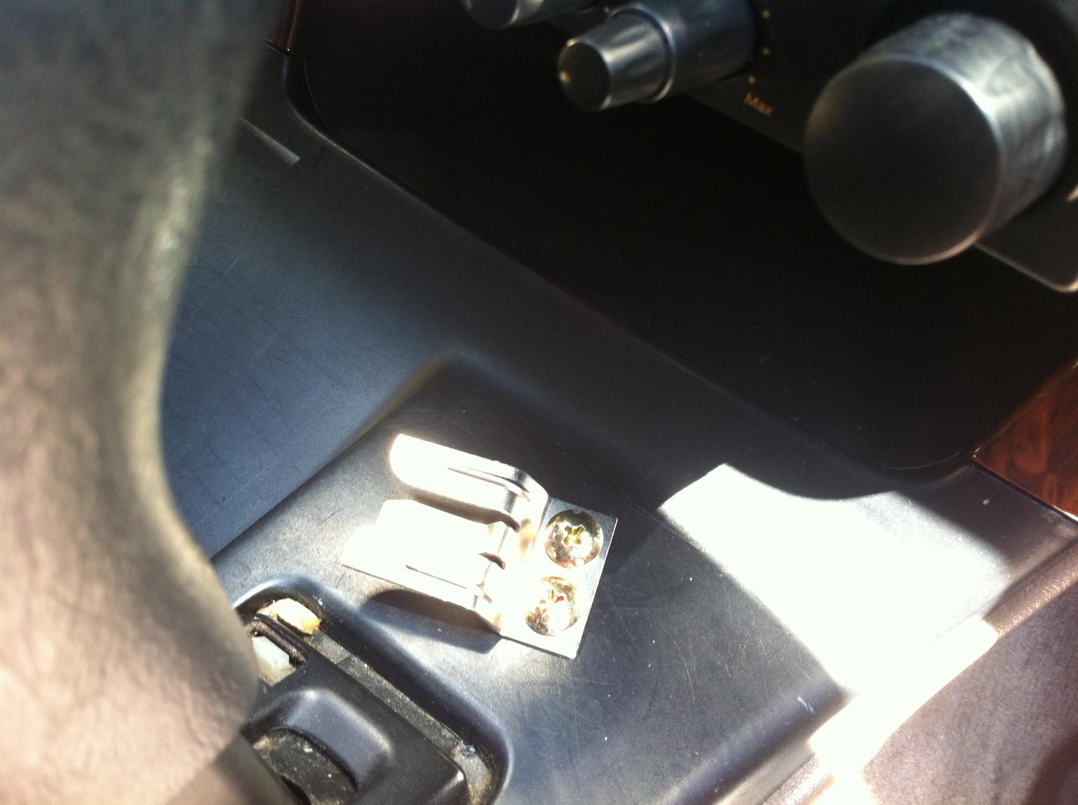

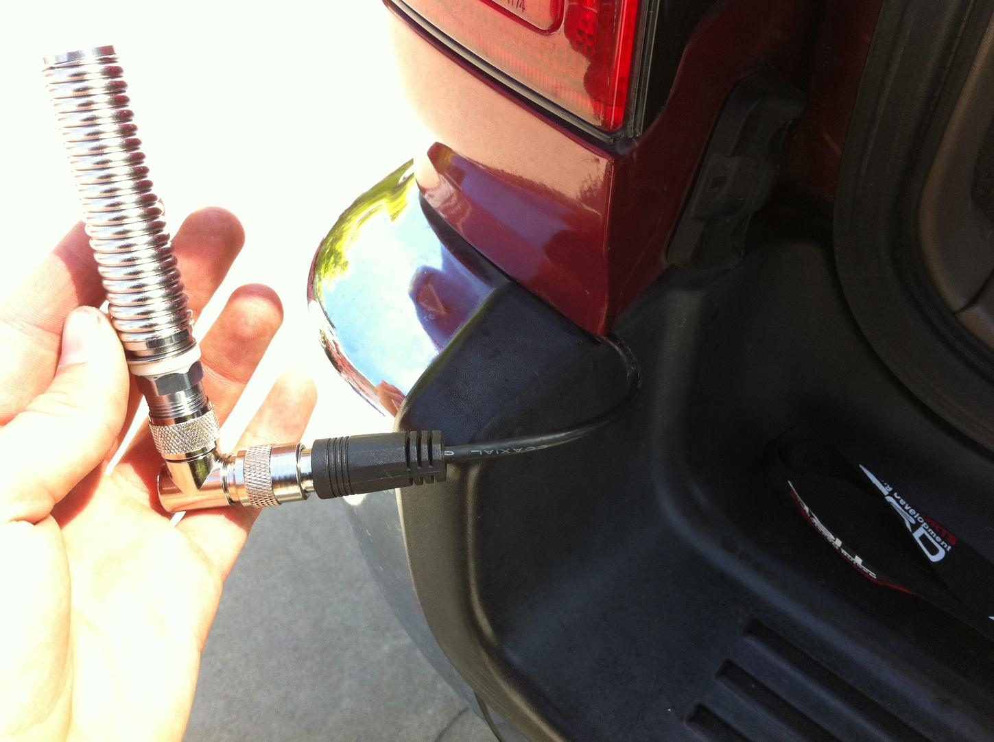

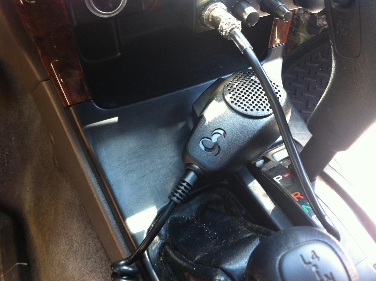

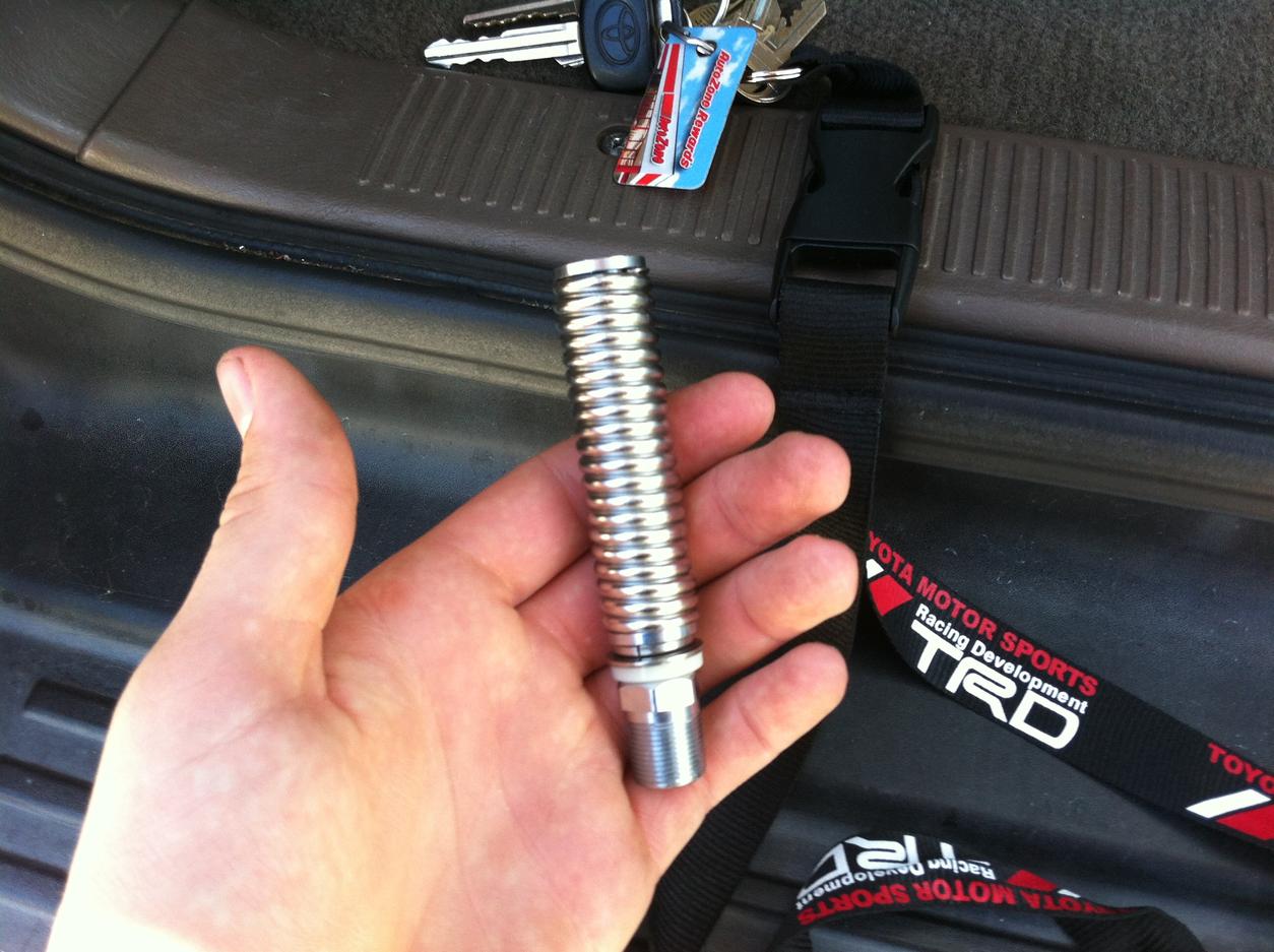

Finally got everything routed and got the right spring. waiting for this sunday for the mount! i also mounted my speaker.
Update: I got everything mounted and working this weekend. On the way back from Hollister hills I noticed my antenna going crazy, do I need to take it off if I go over 45-50? Or is there someway I can fix this? Shorter antenna?
they do that, you want it to swing like crazy absorbing the wind, if it was stiff the force will break the ant. i use a 4 feet for mine.
Mine is 4 foot as well, I know it will swing but when it starts slapping and scratching my lift gate and spoiler I get kinda pissed. I think it it's the spring. It's medium duty, I think I need a heavy duty spring. I have one but it doesn't have the right connection.
believe it or not this is a big problem for guys with 4 feet antennas. i used the heavy duty spring from fry's electronic, it works great and cost less.
