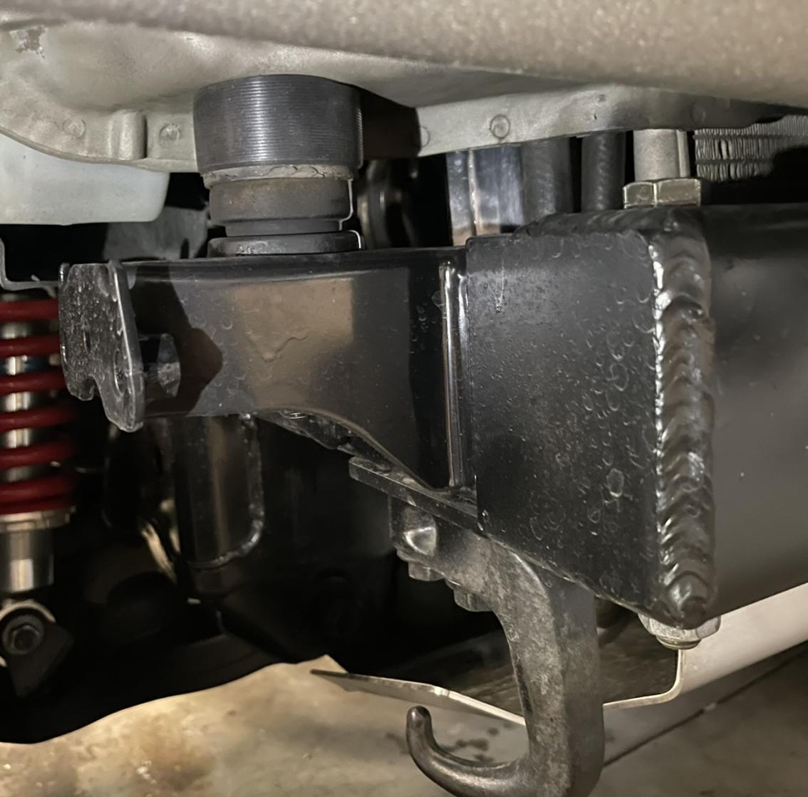

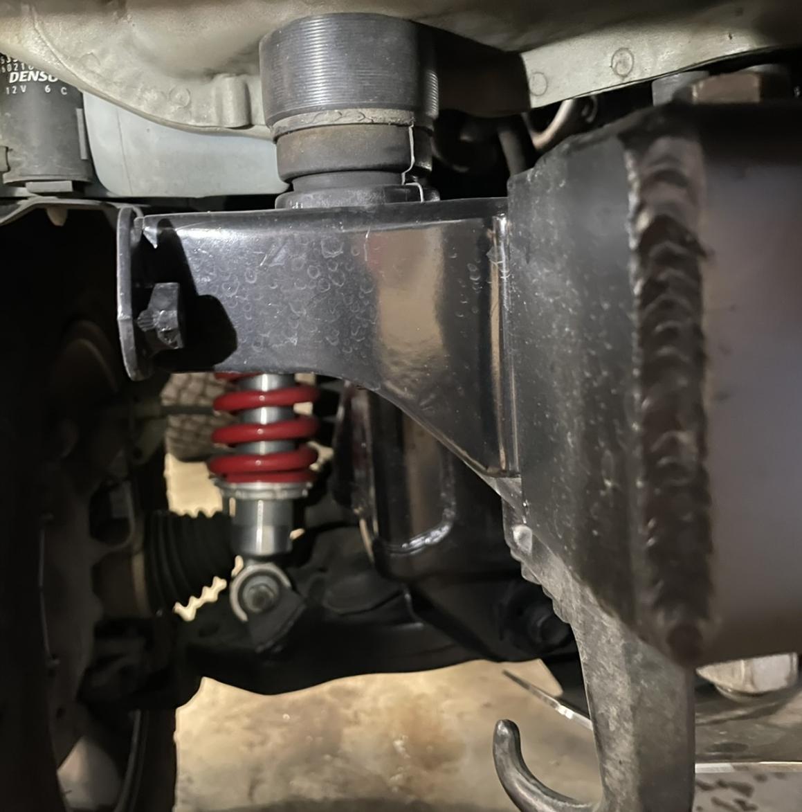

By the way, I would check the front body mount and where the bumper attaches to the frame. If the center mount is already rusted to that degree... this area may be toast. Pics below.

Okay, I will definitely check that spot out. Your frame is unbelievably clean! Thats amazing
Haha yeah I thought the same thing, I was like well damn thats shiny.
as far as rust goes it's extremely minimal, if you wanna nip it in the bud just hit it with a wire brush and throw a little rust converter on - shit is magical. It's impossible not to get an even coat and the shade of black is perfect.
