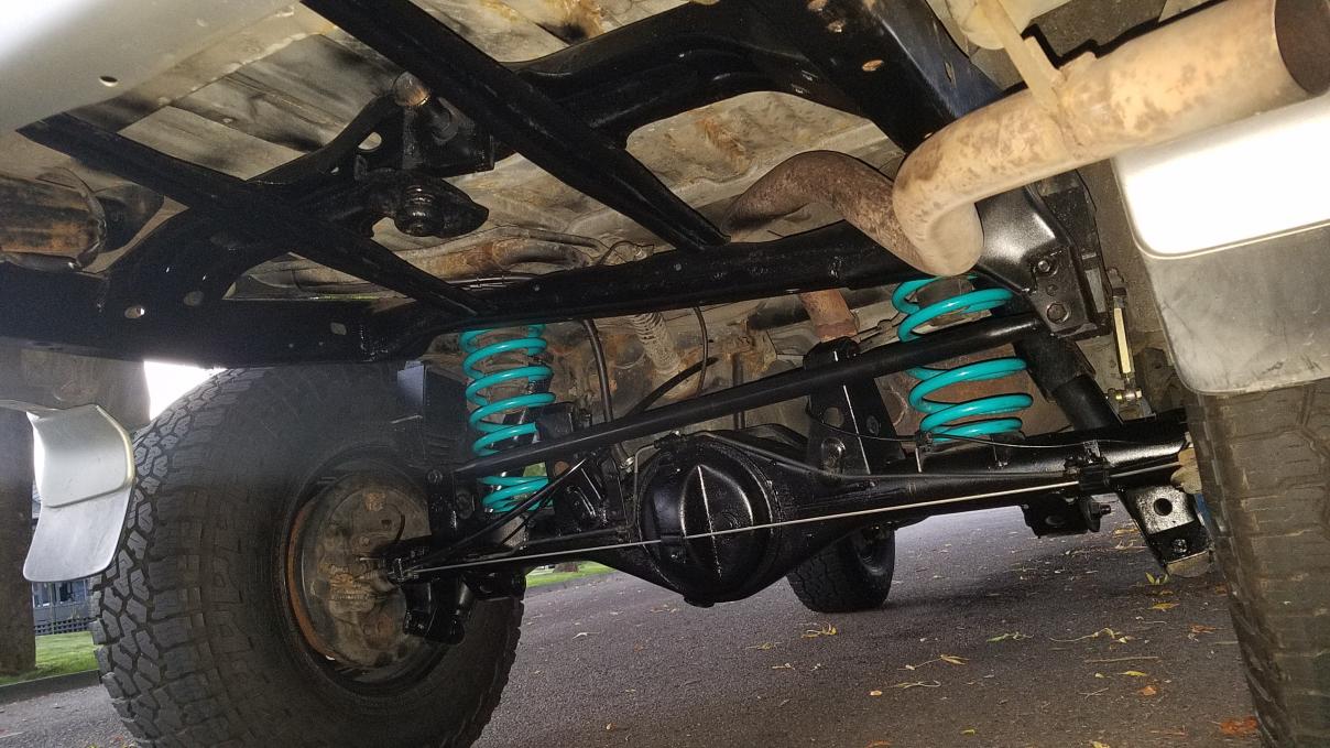

The only rust I had was on my rear axle and the weld seams at the rear half of the frame, which I spruced up a few weeks ago. Takes no time at all and looks miles better (exhaust to be done soon too). Didn't really care about overspray where it isn't visible, and didn't even have to prep the body since it's so far away with plenty of room.

That cleaned up really nicely! What product and process did you use?

Just some wire brushes, rust converter and some farm paint. Used a twist knot cup on an angle grinder on my frame, but just used hand brushed on the diff (I wish I would've gone the extra step and used the grinder or some sandpaper to make it look a little smoother but oh well). Cleaned it all up on sunday then that mon-fri I just kept applying a new coat when I got back from work.
The rust I had along my welds was at a very similar level to what you pictured, not sure what the rear axle looks like though. Like others said, it's very minimal, I just personally advise taking the time to do something about it given you're in the salt belt. A little TLC goes a long, long way

I appreciate that, I will definitely be doing some rust removal and preventative maintenance. I had a buddy that works in the oil industry recommend Ospho 605 after I remove what rust I can then he said to just paint it with some rattle can.
