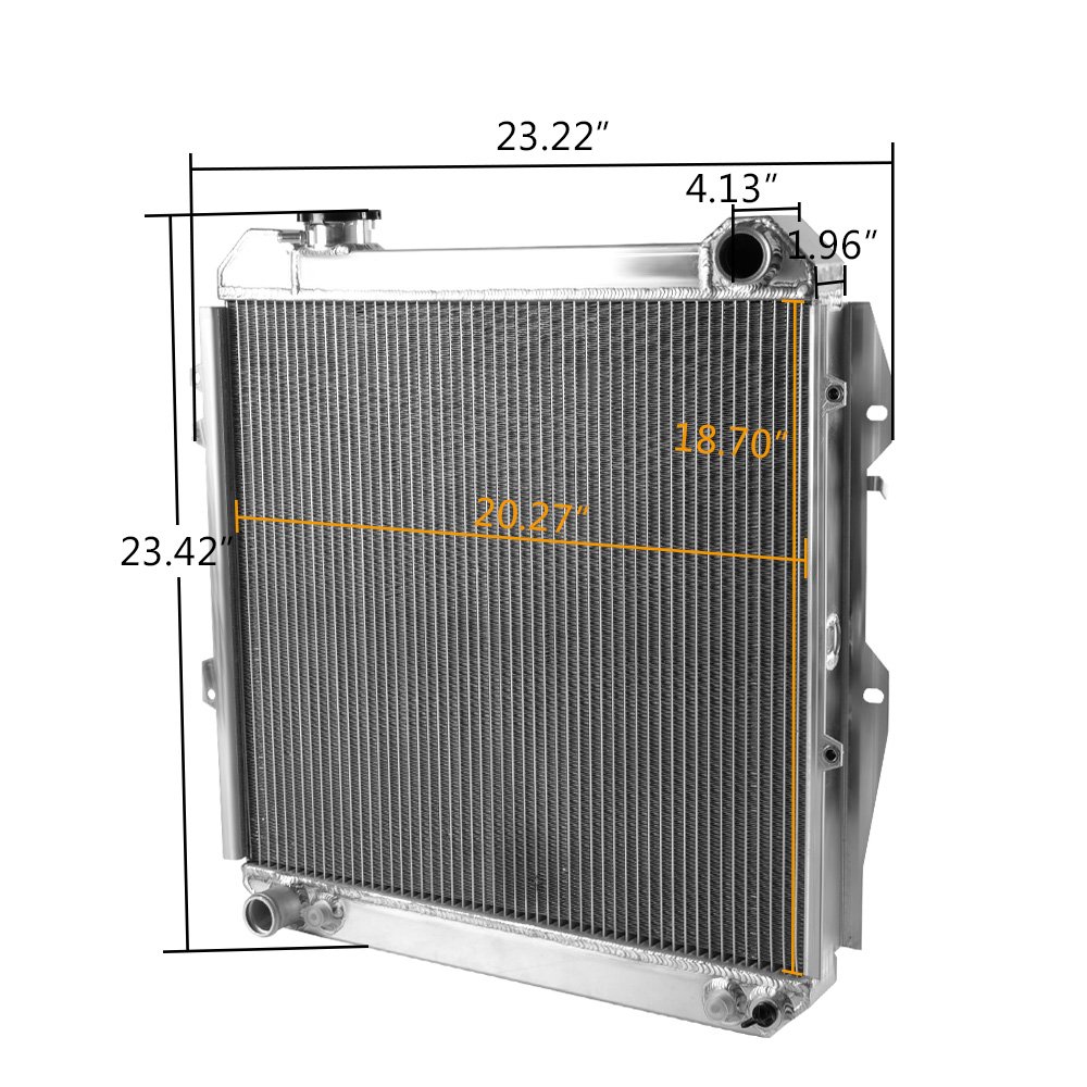

Also; I wonder if this 88-95 2-row aluminum radiator could be retrofitted for the 3rd gen 4runners. The price is decent enough. The inlet and outlets are in the right spot but I don't know about the hose size and if the mounting holes line up. Any experts here know?

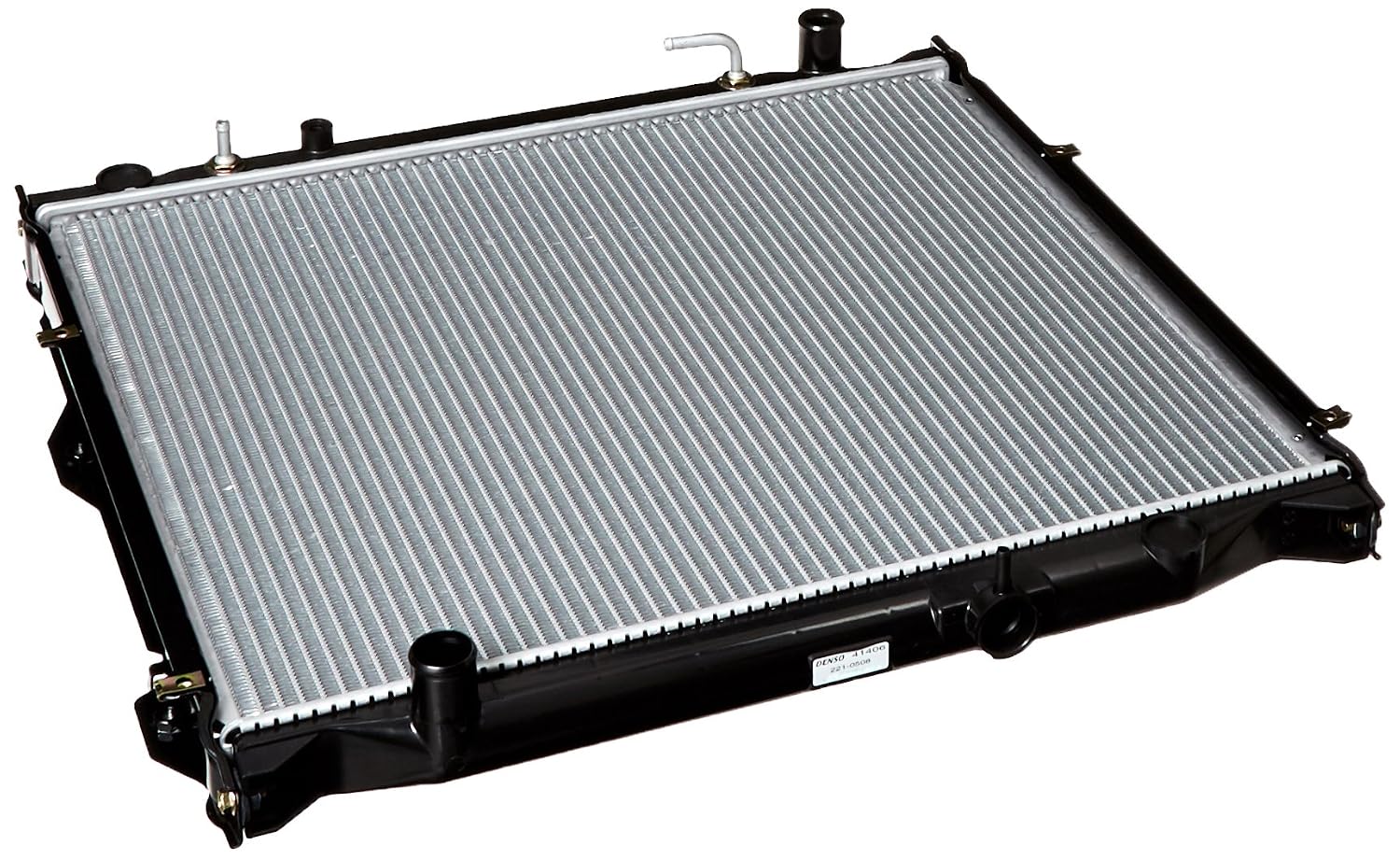

3rd gen Denso:
Well decided to buy local to verify condition and put an end to this returning madness. Went with one from Advance auto, Carquest brand, $107 with 25% coupon with tax. Looks exactly like every other radiator on the aftermarket. Trans fittings were tight, mounting holes and hangers lined up perfect, threads were clean, no broken nipple or damaged fins. Literally took 20 minutes to swap out.
