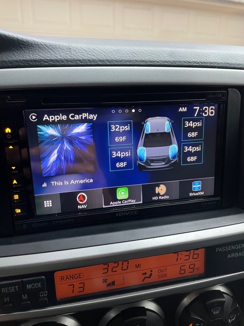

I dunno...I love the tech...so much so that I got an idatalink Maestro so I can see which tire the system was flagging as low, no guessing.
