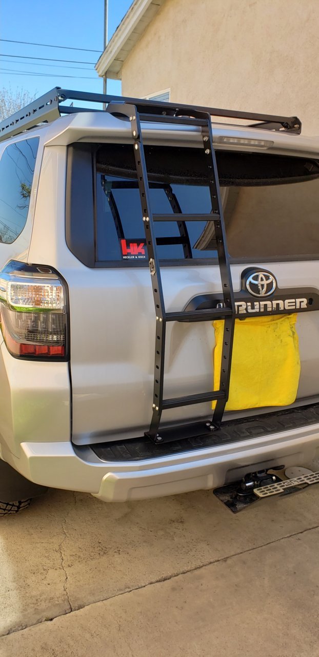

installed mine last night. was very easy and straightforward.
the ladder came in many pieces... all individually wrapped in a great box. held together well.
while there was no instructions, a quick google of c4 ladder installation pointed me right to an online PDF and the actual liftgate attachment install video
While light and thin, it holds my weight extremely well and i have no qualms about hanging all over this thing. (i weigh 230)
I can easily climb onto the roof rack and this will be very nice.
i didn't wait a super long time for this.. i believe that I ordered beginning of Sep and It arrived a couple days ago so about 2 months but totally worth it.
It looks just right. especially with the prinsu rack on top!
thanks c4!

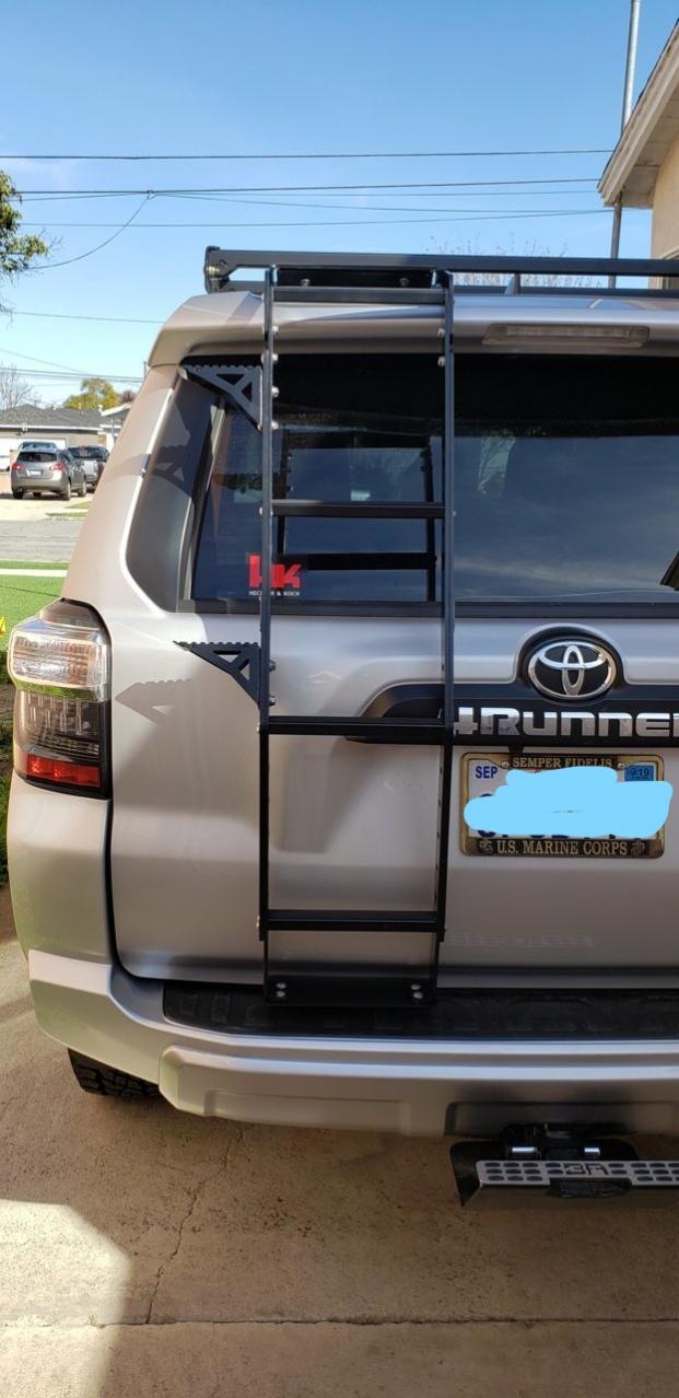

Got mine installed finally.
Install was easy and fitment is great after you play around with adjusting everything.

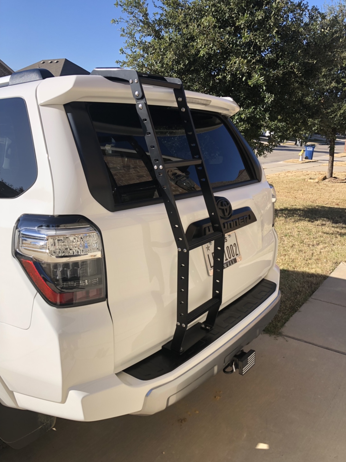

Question about rear spoiler clearance
It looks from the photos in this thread that the top of the ladder contacts the rear spoiler before attaching to the the top base plate. Are any owners experiencing wear on the body/spoiler from the ladder contact or movement of the ladder against the body while off-road?
Of all the ladders on the market, this one is at the top of the list for me. Thanks for all the great info to C4 and users.
Nope
Took a quick look at the ladder - haven't taken it off-road yet, but have put on some highway miles since installing it.
I think any rubbing depends on how you install it. If you put a lot of pressure (towards rear of vehicle) on the top plate during installation by jamming in cardboard, as direct in C4's instructions, then the top hook that wraps around the spoiler may be very close to the paint. This probably would cause the hook to rub against the spoiler and cause damage over time.
In my case, it looks like there is still about a 1/16"-3/32" gap between the edge of the hook and the edge of the spoiler. This may change with use as the double sided foam compresses and weathers with use. Additionally FYI, with the hatch fully open, the top plate does not touch the roof line.
Will try to take some photos later this weekend for some show-and-tell. Also doing some light off-roading in the desert this weekend and I'll try to look for any damage afterwards. Don't think there will be any, though.
