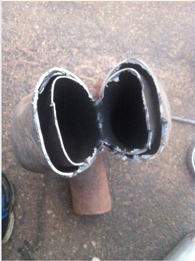

Stainless steel construction and less restriction because the factory crossover has a tube inside of a tube (Its more restrictive than it looks from the outside).

Here is a quote from djtc's build thread.
#1. The crossover pipe that looks crushed going behind the trans cross member is one of the lowest points that gets caught on every belly dragging rock.Not to mention its extremely restrictive.
Just to show you. This is the crossover pipe cut in half. It it a double wall pipe with an internal 1" pipe.

i dont see the 1" cross section pipe?
i think hes referring to the oem "y-pipe" which aftermarket make now with a real y-pipe
in the diagram posted above by az4runnin i dont think pipe #38851 is double walled 1"
My phone doesn't display the picture I quoted, but my computer does for whatever reason. 38851 is the exact tube I'm talking about and quoted a picture of. Seems pretty clear to me its double-walled.
