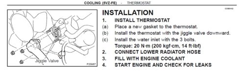

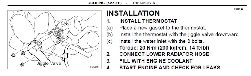

I'm not sure if you mentioned your engine coolant temp earlier, but it's part of the puzzle and well worth popping to 3 bolts on the water inlet and making sure the jiggle valve is at the bottom of the TStat. I know it gets argued about a lot and doesn't seem to have much effect for some (I take their word for it), but I dropped 12 degrees (coolant) immediately and for evermore.....

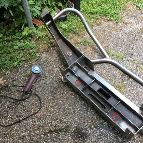

Haha! Yeah I probably will end up doing both but adding holes to the bumper is going to be messy since the bedliner coating was already applied. I asked my wielder friend who built the bumper for me and he says he can add holes behind the decorative slots in the front plate but he said it may not be pretty so I was hoping I might be able to avoid going that route by installing an aux trans cooler. But there's still a lot of radiator and AC condenser down there as well that could also use more airflow so I'll probably do it.
These are the cuts I made. I made the slot first, and later added round holes where the red circles are. I'm sure there's a lot of stagnant air behind the bumper's bash plate at road speeds but at least the fan can pull air through.

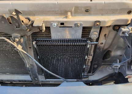

I sell the 4runner transmission cooler kits. I hear from my customers they can reduce the temps by 30 degrees F or more.

Oh man, I really like your kit but it looks like it might not fit on my 4runner as my bumper overlaps the rail that the lower section of your bracket attaches to. Or am I maybe looking at it the wrong way?
Thanks! Yes you are correct, my bracket won't work with that bumper. Is it a Coastal Offroad?

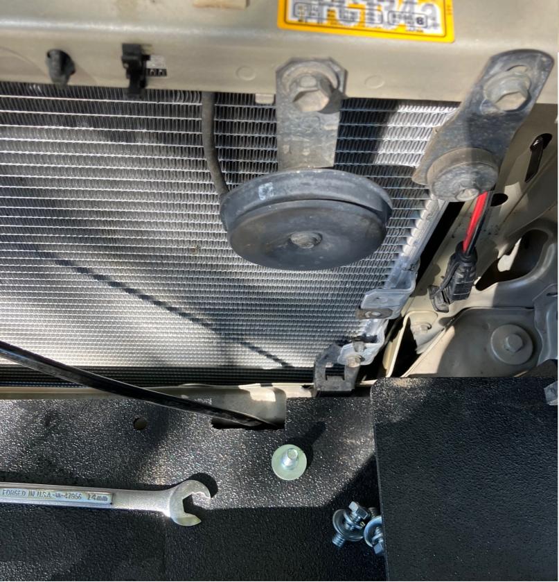

Where there's a will, there's a way. Grinder to the bumper, mount the cooler on the back side, spacers as needed, etc. There's plenty of room left in there for a trans cooler.
I custom mounted my cooler - it sits behind everything, right next to the AC condenser so the fan pulls as much air through it as possible. Modified the upper and lower condenser mounts, etc. I also used a thermostat on the cooling system to minimize overcooling in the winter. There's now a winch control box in there, and it all still fits...
