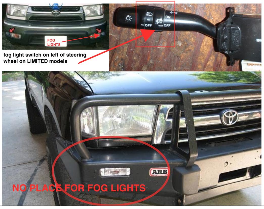

i am looking to get an aftermarket bumper (ARB) that doesn't accommodate the factory fog lights..
Can i re-wire the factory fog light harness to some aftermarket lights or light bar???
has anyone done this before? is there a max wattage i should be concerned about (i.e. 55w etc)...

I used the wiring for my stock, lower valance, fog lights to power a pair of Hella 500, 55w lights. It has been years with zero issues. The stock lights are 55 watt too so Expected no issues.
If you wanted to power more powerful lights, you could have the stock wiring trigger a solenoid.
By the way, 55 watts times two lights for a total of 110 watts of power.

do you have a write up on what the wiring looked like? is there an adapter so i can easily plug the lights in without splicing the wires?
110w's im assuming is what your running? what types of hella's did you buy? model number?? yours looks good. any advice on using a light bar instead?
simple
its really quite simple. using a relay and using the live from the for lights to trigger the relay. i live in walnut creek in the east bay. where do you live? i could come help you out.
If you're not adding additional lights and you're just replacing the existing fogs with something mountable to your ARB, then just cut the wires before the pig tail (save it, in case you want to re-install) and connect your new fogs to the wires. Done.

I've done a similar mod to my '02 4Runner on a TJM bumper that was modified to allow fog lights.
First, I did the "Fog Light Mod". This provides you control of the fog lights independently of the headlights as long as your parking lights are ON while still utilizing the OEM fog light control on the stalk of the steering wheel column. As seen here: 2002 Toyota 4Runner: Fog Light Mod - YotaTech Forums
Second, I just snipped the OEM wires (where they plug into the stock OEM fogs) and spliced in my own aftermarket fogs.
Both steps required very little effort. I do not have any step-by-step photos of the install, but you can click the link in my sig to find photos of the finished install.
Good luck.
Make sure you pull wires from the bumper fog lamps to your new lights. The OEm bumper lamps are 55 W and if your aux lights in the same wattage, you should be fine.

I did this for my $8 dollar tractor lights from Harbor Freight that I put in my Outdoorlogic bumper fog light holes. Works just fine.
I used the fog light circuit/switch to power my driving lights, but added a relay and heavier wiring. It also keeps the fog lights on when the brights are on (or the headlights are off). You can do just that part (grounding the green/black wire) if you just want to be able to have the fog lights on at any time.

Tons of good feedback. Thanks for posing the question! With all the info from this thread Im ordering Hella Micro HDs 55w and directly swap my factory fogs (driver's side housing corroded) using all factory wiring currently in place.
