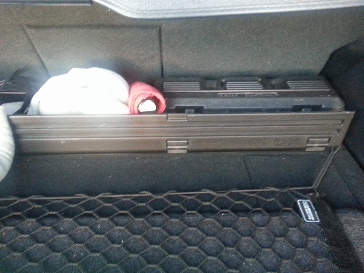

I know some (or all) hate the cargo divider, but I am tired of things falling down below when I pull out the tray (no, not getting rid of the tray either). I asked for, and received, a cargo divider for Christmas, PT924-89100-20 on the plastic with the words 2010 4Runner above it. However, the bolts do NOT line up to the plasic plug holes! The 2 end ones will line up perfect but the 2 middle ones are offset about 1/2" to the drivers side each of the hole. If I line up the 2 middle holes the two outside offset to the passenger side about 1/2". What gives? This is the correct part for my 4R, correct? Anyone else have this issue? Anyone else want to measure on center their plugs to see if mine was just some oddity from the factory (number 700 something off the line). Thanks!

I think I had the same problem before I turned it around to have the ribs facing the rear.

Duh, turn it around moron - said me to myself. Since there were no instruction included I assumed the 'nice' side would face out, not in. Also, the divider did not come with any nuts, wtf. I only plan to use 2 hand tight for easy in/out removal when I need to. Thanks!
