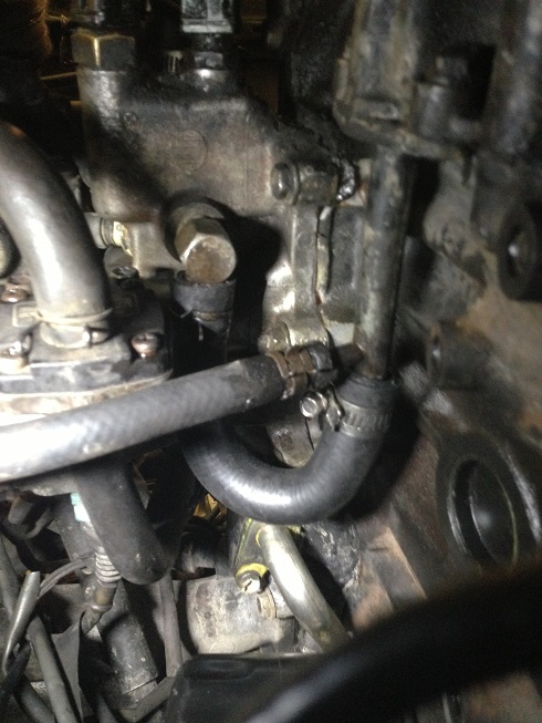

Another rotten hose burst under the intake and it was in a horrible position. I was able to get it off but I decided to take the AC out to free up some space and make it easier to get the new hose on.

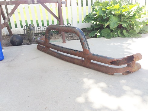

I was sick of my rusted out front bumper so I pulled it off and rhino-lined it with a $14 can. It has held up surprisingly well so far.

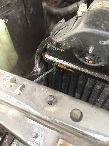

A hose or something burst in my radiator so I took it to a local shop and I decided to have them fix it instead of buying a new one to save me some $$$. Holding up good still.

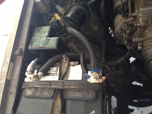

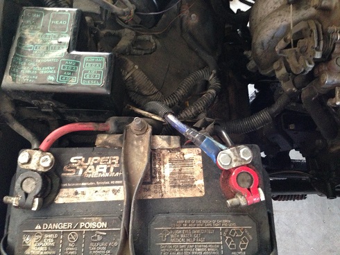

Decided to do a Big 3 Wire upgrade for more current flow from my battery and because the wire from the fuse box to the positive terminal needed replacement. It's nice to know I have solid connections everywhere now. Shouldn't have any random power issues like I was having last winter.
I upgraded my Neg - Chassis, Neg - Engine block, and Pos - Starter all to 0ga wire. I soldered ring terminals to each end for solid connections. I have been told to put a wire from the Pos - Alternator, but I'm still not sure if that's necessary because there wasn't a stock wire that did that.

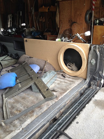

I started working on a sub box to work as my side panel to save cargo space, but I decided I'm just going to build the box exactly to the specs of the sub I'm getting. I'm only going to have one 12" sub instead of 2 so the box will be considerably smaller anyways.

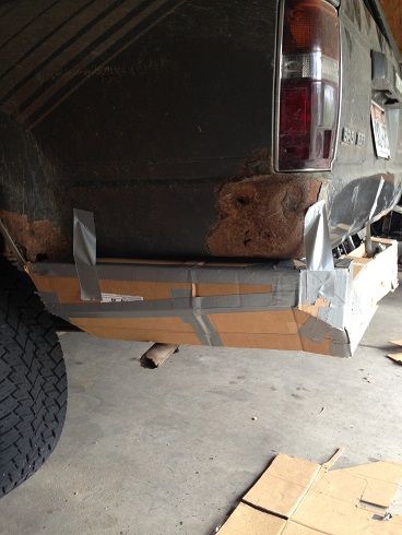

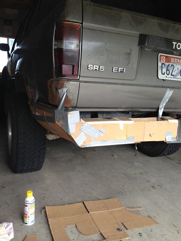

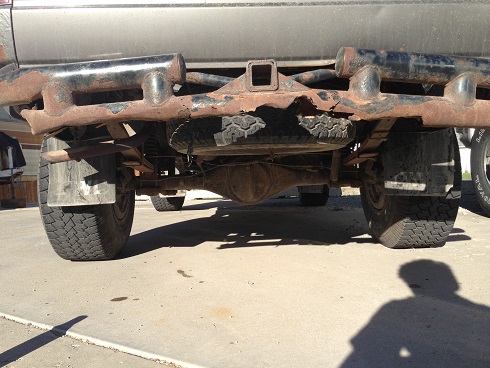

I also pulled off my rusty old rear bumper to mock up a plate bumper that I will start building at work. I work at a metal shop now so I have been gathering up scrap 3/16" plate steel that I'll use for the side panels of the bumper. I'll be using 3x5x1/4" tube for the body of the bumper.

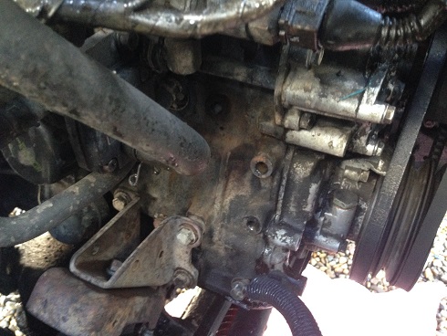

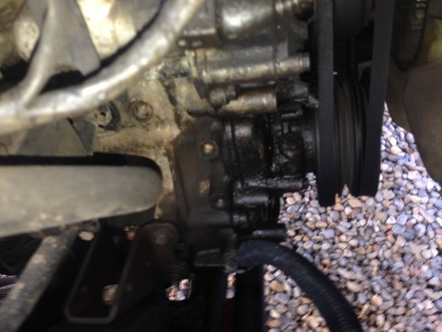

Today I tried to degrease my engine and under-carriage. After 3 cans of degreaser and a lot of scrubbing with a shop towel, it looks a little better but not much. I mostly did it so I can figure out where I'm losing oil. Once I figure it out I think I'm going to tear into it to replace my timing chain and fix the oil leak. When I have it apart I'll give it a better cleaning and some paint.

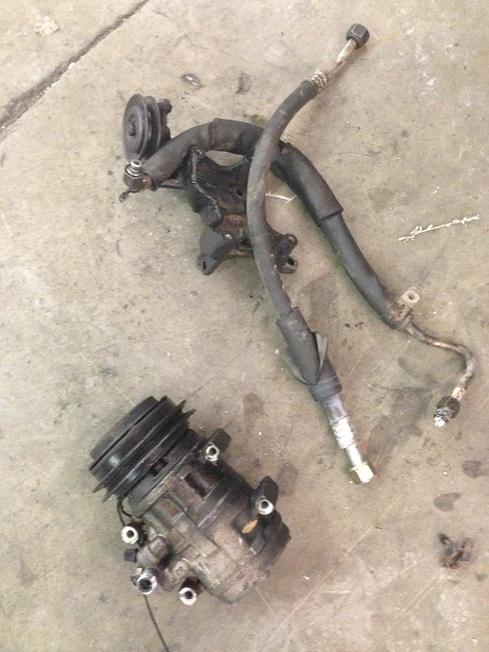

I also decided to black out the yota. Hopefully it looks good. I took off all of the trim and the bumper to get the grill off for paint. While I had the grill off I took out the rest of the A/C components.

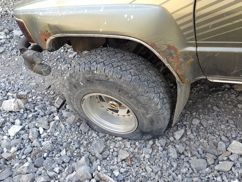

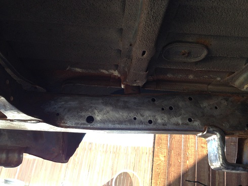

I didn't realize how rusty my fenders are.. Would it be worth it to try and repair the rust? Or just chop as much off as I can and get some cheap fender flares?
Cheap fenders, or fiberglass what you have and make them look almost normal again. If you need help with tearing the engine down give me a holler :bigok:
Thanks will do :) The only fender flares I can find that I would be able to chop the rust off are these Bushwacker's:
Bushwacker Cut Out Fender Flares
Pretty much $400 for a set... I'm eventually going to end up replacing everything that is currently rusty and re-painting. It almost seems like it would be easiest to find a donor truck with a perfect body and just swap them because pretty much every panel has rust besides my passenger door and hood. If that's the case then I might as well just save the $400 and deal with the rust until then eh?

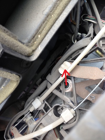

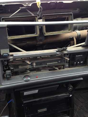

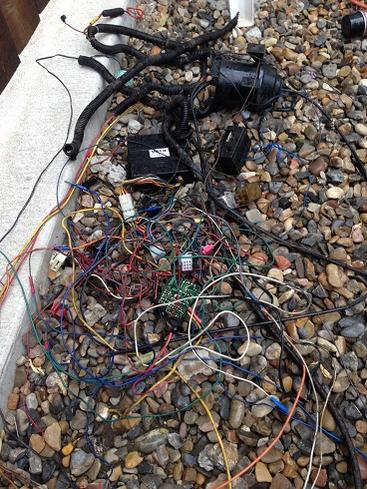

I took out the aftermarket alarm and cruise control systems the previous owner put in. The wiring was horrific. I can't believe how much cleaner it looks on the interior and even the engine bay. I pulled my dash apart to get the dumb little lights out. My heater control lever has been messed up for a while. I found out that the plastic clip that holds the lever at its pivot point is missing. I have tried looking for a replacement online, but without a part number there isn't much I can do. I'm thinking I'll just make something that will hopefully work better than the stock set up.

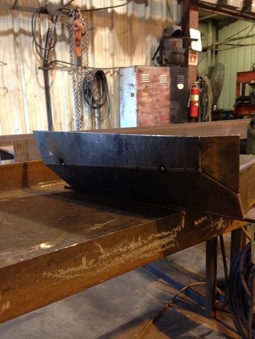

The bumper is finally shaping up. They don't let me work on it much at work. I got most of the plates cut out. I tacked one side up to take it home and do a little test fit. This will give you an idea of what it will look like.

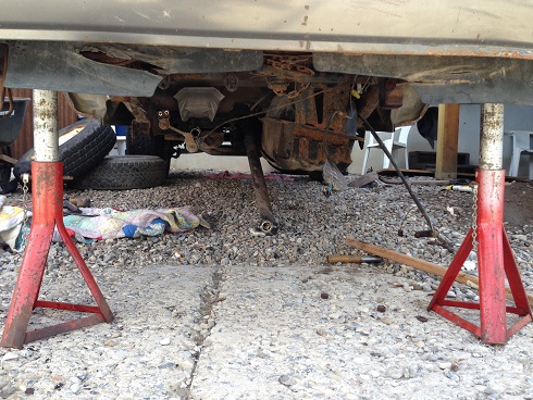

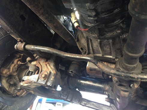

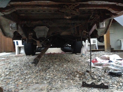

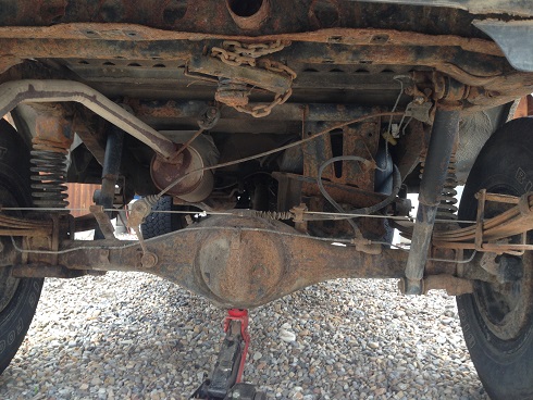

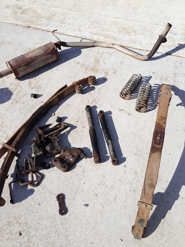

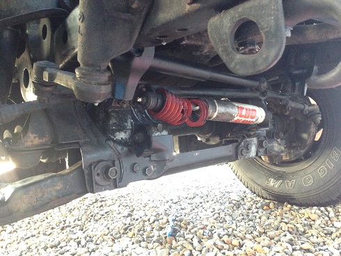

Pulled out the axle and the leafs today. Man were those leafs a *****.. I could not get the driver side hanger pin out to save my life. I even sawed off the rusted out muffler to make some room so I could pound on it with a sledge. Didn't even budge. I ended up just using the saws all to cut the bolt on the inside of the frame mount. The other side slipped right out. It was pretty frustrating, but everything's out and ready to go now!
I'm wanting to sandblast and powdercoat my axle. I can't decide if sandblasting would be a good idea or not.. I could use a wire wheel, but I want absolutely every bit of rust and build up off and have a nice durable coat of black that will last forever. I also want to look at armoring it up.

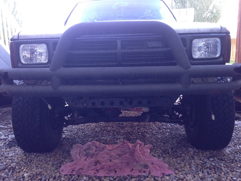

Here it is with the blacked out grill

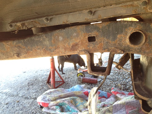

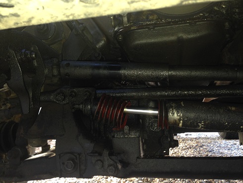

Tank is out! The other day I started to grind the frame down for paint.
