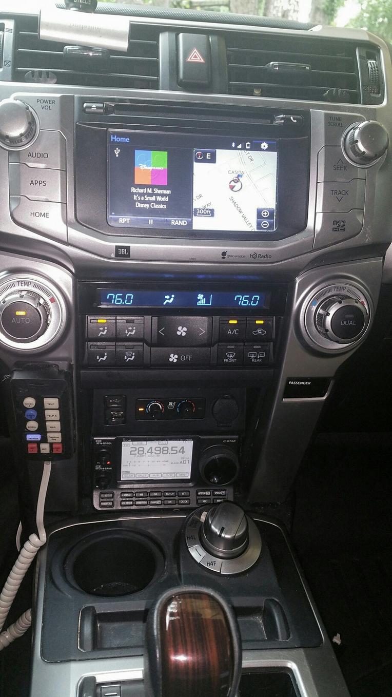

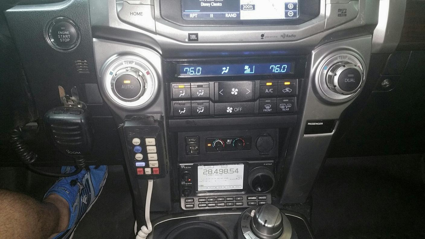

Go HAM and have it modded to pick up CB channels. Best of both worlds in one unit. Here is where I ended up installing mine. It fit nicely in the empty space.
