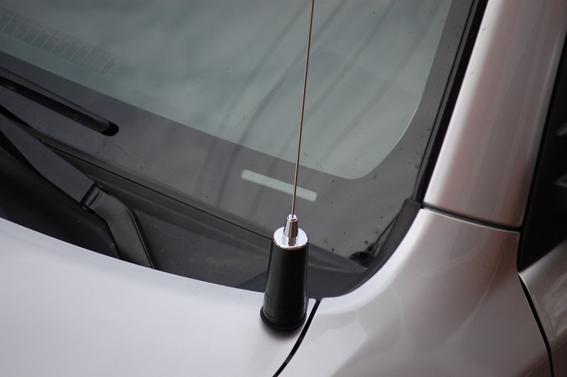

Looked through the group buy thread, couldn't really tell how its actually mounted, but it should be bolted to the body pretty well. That should give you a decent ground by just bolting the mount to the body, but if you want/need a better ground, run a ground strap behind the light and drop it to the frame, I believe there's a channel that will get it all the way to that point.
Couple of things here, make sure to remove the paint where you mount it with either some sandpaper or (my preference) a dremel with a small wire wheel. Also, make sure you put some dielectric grease over the bare metal so it doesn't rust! Personally, I use copper antenna paste, but only because I have a bunch of it for my ham antennas. You can find this at almost every ham shop.
This also applies to the frame if you run a strap down from the mount.
And I wouldn't bother with the NGP antennas, they don't work nearly as well as a true grounded antenna, can be very finicky where you have it mounted, and are more expensive than just a nice, tried and true, Firestik or similar antenna.
Totally agree. NGP antennas really aren't worth it and have read of tuning problems when using them on a vehicle with a ground plane. Only good for a boat/motorhome/other mainly fiberglass vehicles.
Your ground will really determine the usefulness of your radio. Flyinghawaiian makes great points about making sure that the ground is touching bare metal, no paint, and even going a step further and running a ground strap to the frame which would just about ensure a good ground.

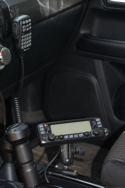

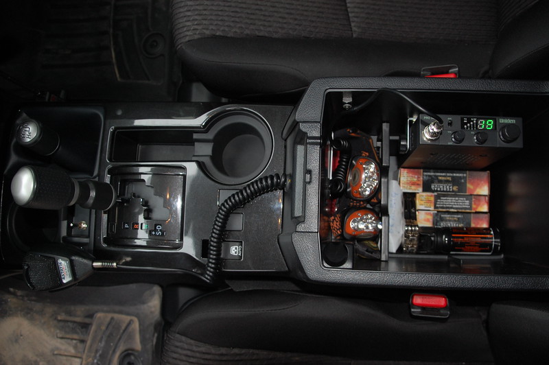

If I were going to mount a 75, I would remove the top of the shifter console and tuck the 'junction box' in there, leaving the antenna permanently connected to it. Run the QD cable for the mic out under the bottom of the console, between the plastic and the carpet, and let it hang. It's unobtrusive like that and easy to access / install / unistall the mic. This way nothing is really visible once you reinstall the top of the shifter console. I personally wouldn't mount the 'junction box' exposed as it just looks crappy.
I was running a Uniden 510, and I had it in two different places, but neither one really appealed to me: inside the console and in the vertical console pocket. I may well go the 75 / Lil' Wil route because I want to run a CB for trail use but am dis-satisfied with the mounting options I have used thus far.

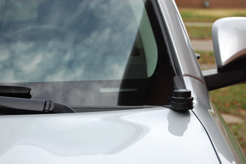

Well that's simply not accurate. If anything I would say the main issue is mounting a full size radio in a 5th gen. The antennas are easy.
You've got a million different magnet mount varieties, NGP through glass varieties, permanent mount, hatch mount, hood mount, etc.
I see a lot of hatch "slip over" mount styles in use on 5th gen, and I use a similar concept but in a different way - a "trunk lip" mount that slips over the hood:

GGGGEEEEEZZZZZ. Total brain dead senior moment here . Completely forgot about the 12V outlet inside the console box.
