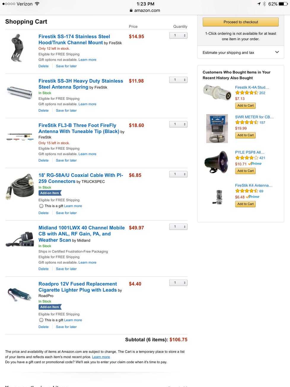

I know very little about CB's, but I'm thinking about getting one as they are used more than HAM's in my area (as far as I can tell). I've done some digging and I think I've selected all that I need. So, based on the image below am I getting all that I need to get started with a CB?
Thanks in advance!

You could probably delete the spring as the Firefly 3' is pretty flexible anyway, and the cig lighter plug I guess can be used for a temporary install but why not just wire it up correctly?
The only issue is lack of a good ground. The solution to that is simply to run a ground wire from the antenna base to a good ground.
Thx!!! I went back and forth on the spring and it will help keep price <$100 even more so if I remove cig lighter adapter. I haven't found any info on how to wire it up "correctly". I'm assuming this would entail running wires to fuse box, or splicing into existing wires?
Any tips would be appreciated. I'd prefer a clean direct connection through fuse box, but don't know how to do this.

All the CB installs I have done have been directly to the battery. Came through the firewall with the wiring and find a nice route out of sight to keep it clean.
