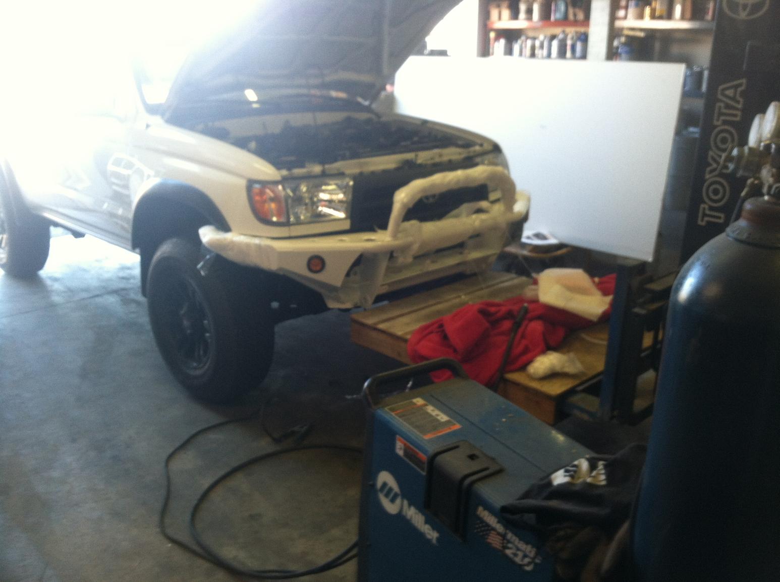

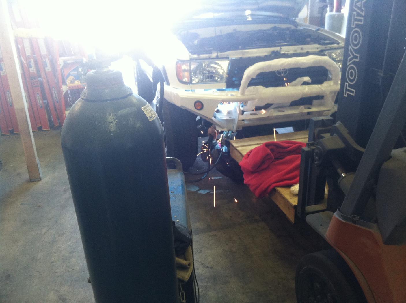

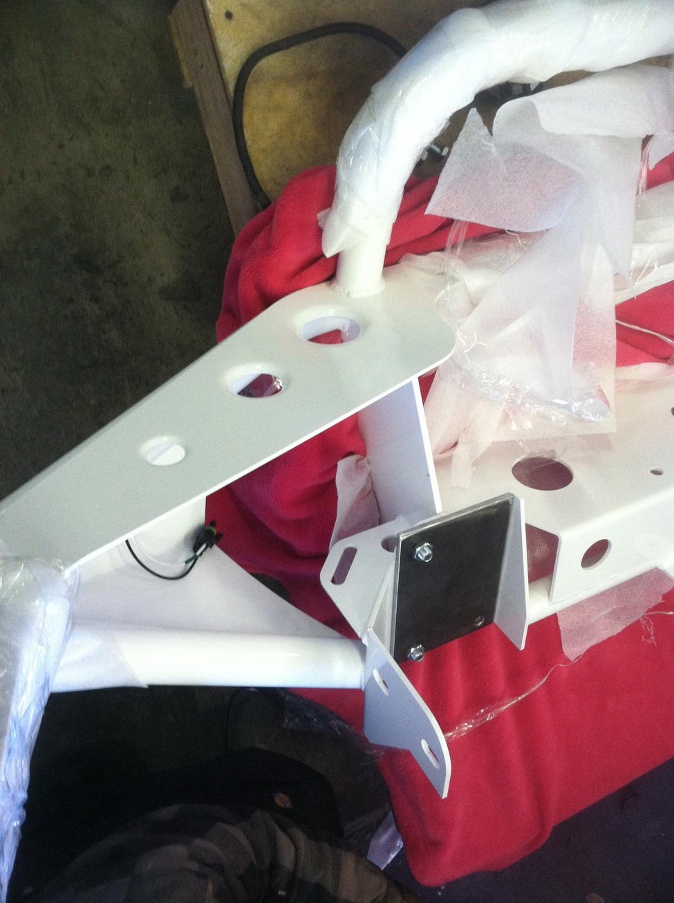

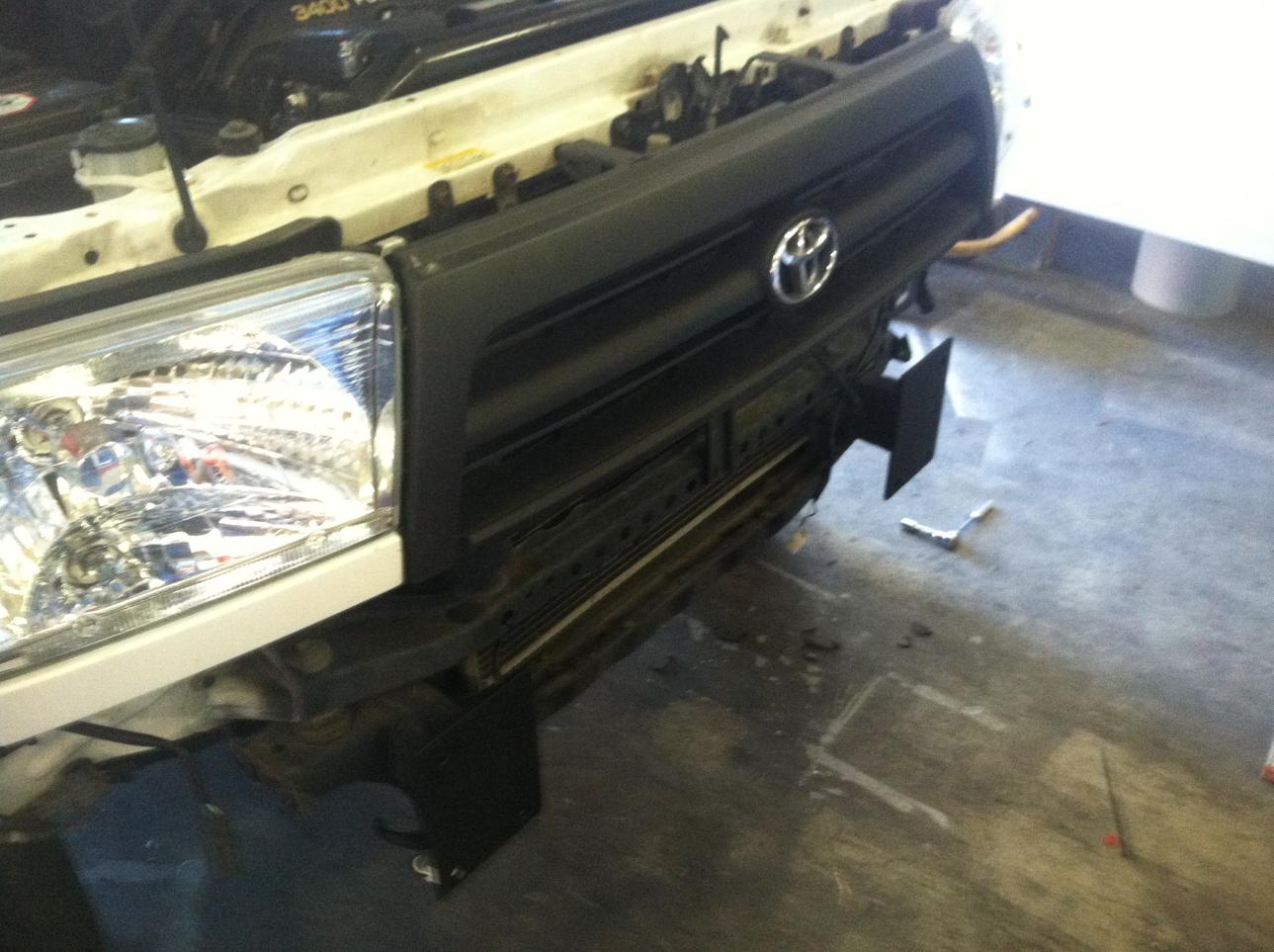

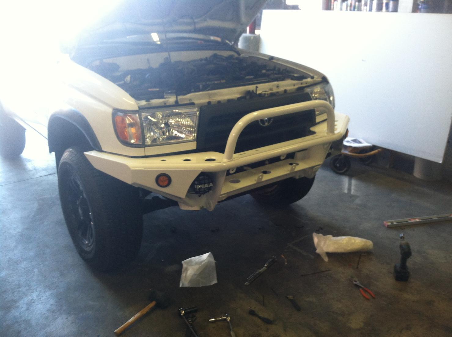

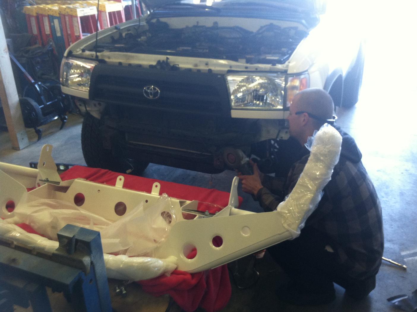

Arc,Heres some of the steps i took when installing the CBI hybrid ,mind you this write up is just for reference purpose on what i did to my personal vehicle ,so what anyone does to their or any other vehicle after reading this is not my responsibility and i accept no way any liability . how you do a bumper install is entirely up to you and also your responsibility .i didn't have the CBI supplied plates or instructions but its pretty straight forward so I went ahead and made my own plates out of 1/4 " . from i understood some of the later model 3 gens didn't need plates (i think if you had the "fat lipped" bumper factory mounts would work )but since mine did here are the steps taken Hopefully my pics will be in order for you to understand the process .first step : initial prep and mock up,for this step you will have needed to remove your factory bumper and expose the areas where the plates will be prepped (paint removed and grind )and then ultimately welded .it wasn't necessary for me to cut the end of the frame i welded my plates right to the end ,but i did end up having to elongate the rear mount hole because of this .it will be at this point when you will also want to mock-up your bumper (test fit).i left the factory shipping material on while doing this step so if you run into any fitment issues it will be during this step , any parts of the bumper you think might make contact or scratch your paint ,should be protected . the most important part of the mock-up process is to go ahead and bolt up the plates before mock-up fitment is done so they can be tack welded to the frame while in place .at this point you are using the side mounts go ahead and bolt up the bumper (this is a two man process) bumper fitment was spot on, and went on pretty smooth as things lined up nicely ,with just a tad of bumper paint grinding to do as well as a slight elongation of the rear holes for mine ,just an FYI of what you might be up against

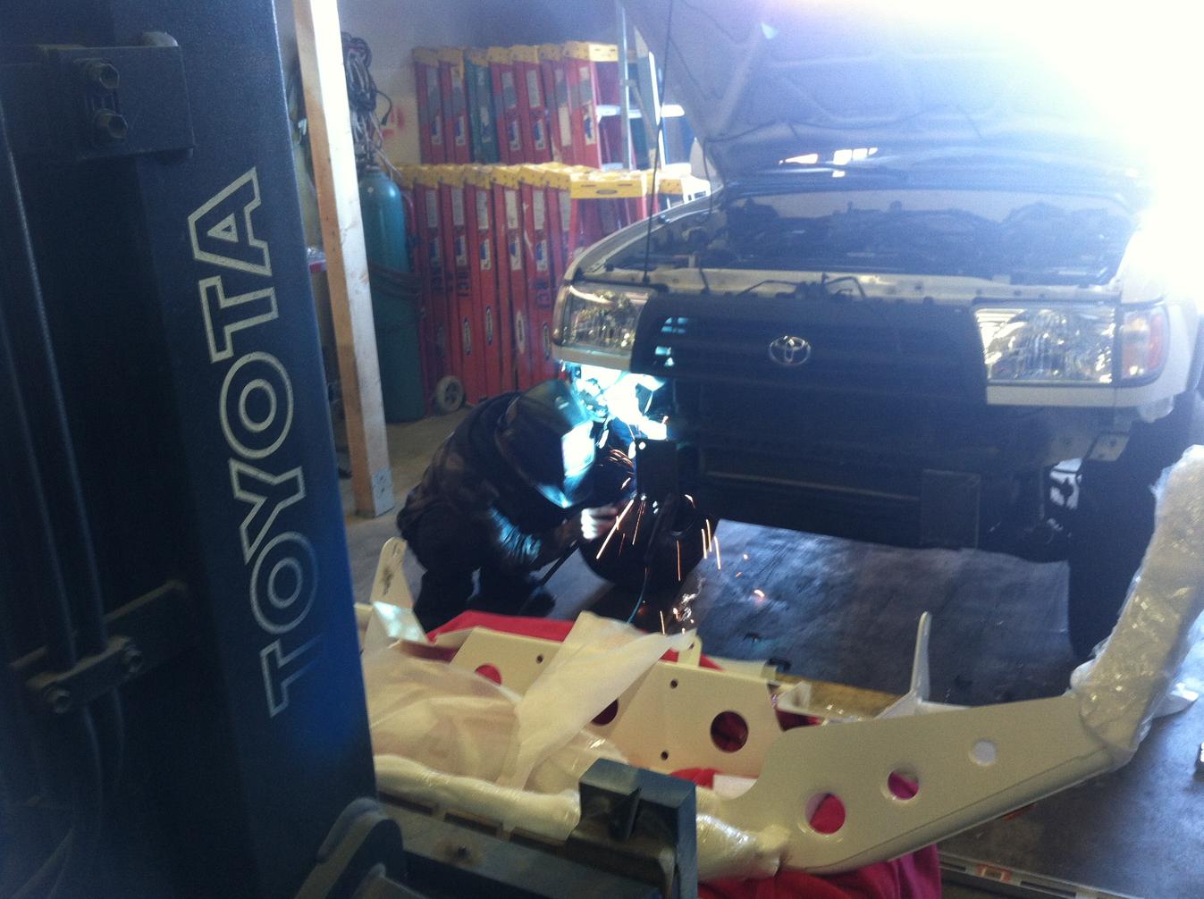

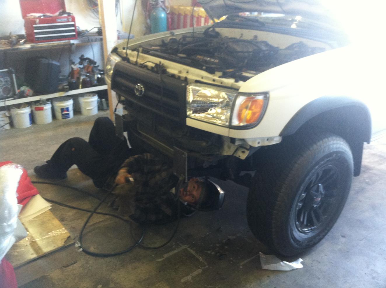

Once mocked-up with the bumper in place its now time to determine if the placement of the welded items or plates are good to be tack welded on. it was at this point when we were looking for the side holes lining up and that the plates sat square to the frame .go ahead and tack weld the plates .after tack welding you will want to remove the bumper and finish welding all the way around your plates making sure they stay square to the frame .

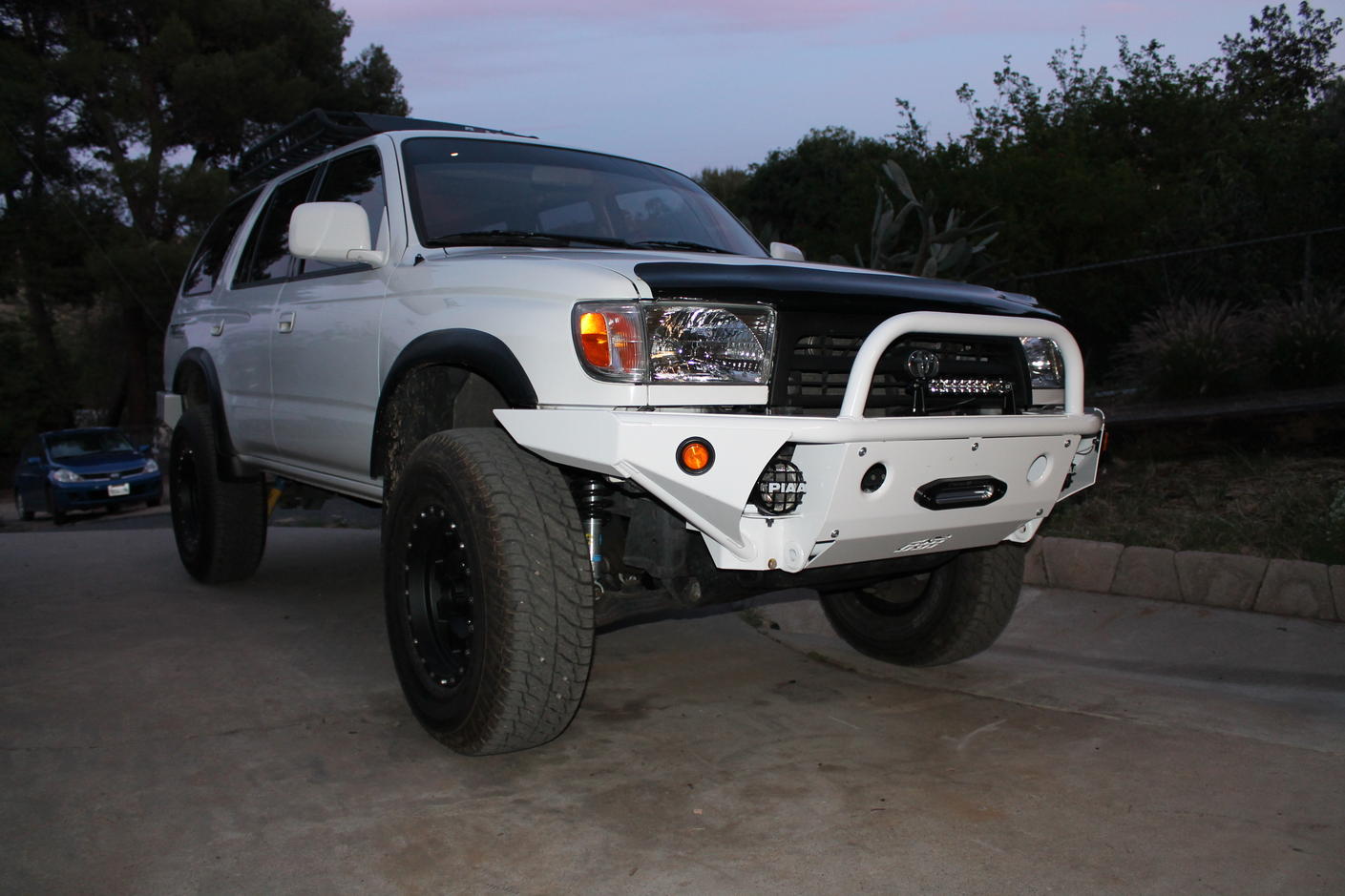

After all welded up and painted you are now ready to do your final install .at this point if you have wiring that needs to be done it should be all finished as its much easier to work on at this point .Now its time for the time for the final bumper placement,this will be your final step. Bolt it up and Enjoy !

rubbertoe's process is almost exaclty how I did mine as well. I cut the end caps off, then test fit the bumper with the plates bolted on. I don't own a welder, so at this point instead of tacking the plates on (which I would have preferred to do) I drew an outline of the frame with a sharpie. Took the bumper off and waited until my buddy had time to weld them on. Tacked them on, made sure everything was square and then did the final welds. I went home and immediately did another test fit and luckily everything lined right up.
