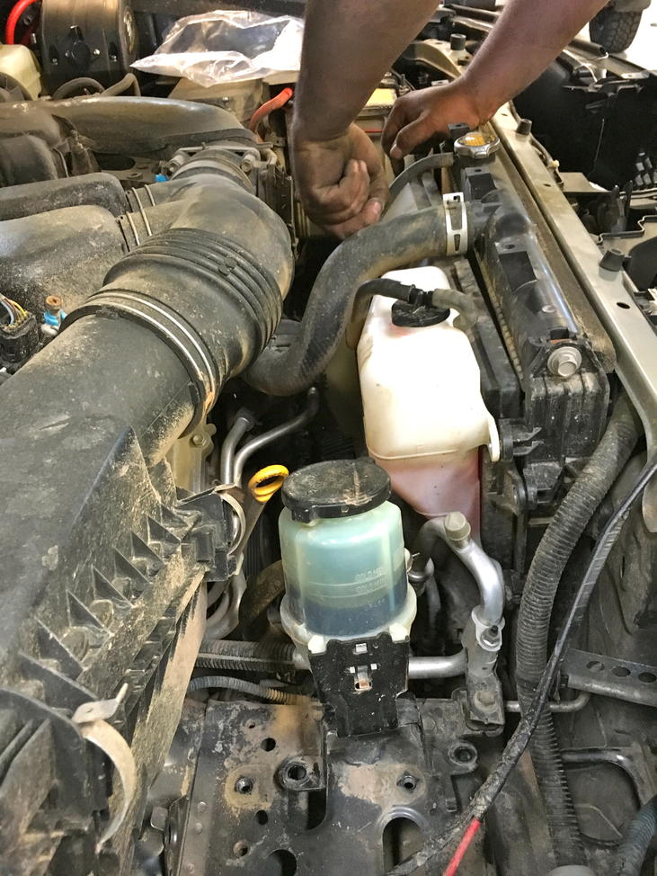

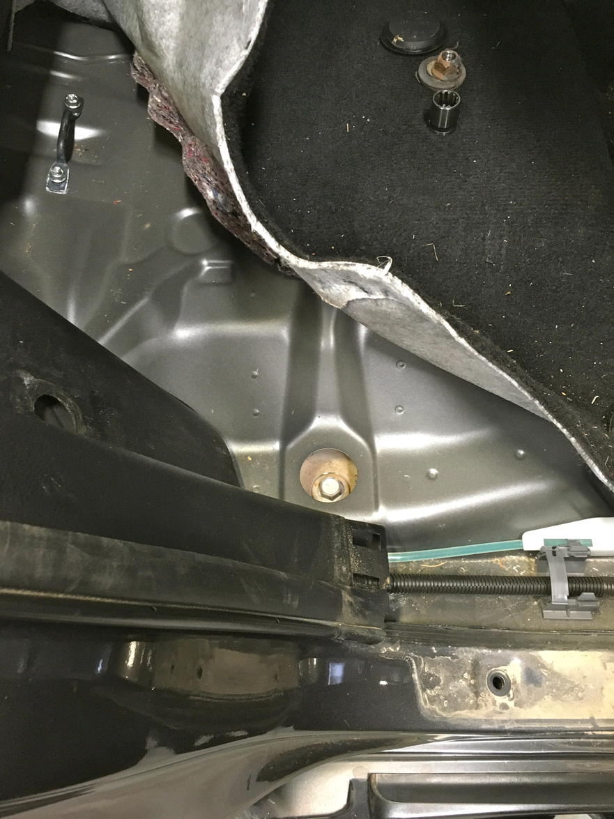

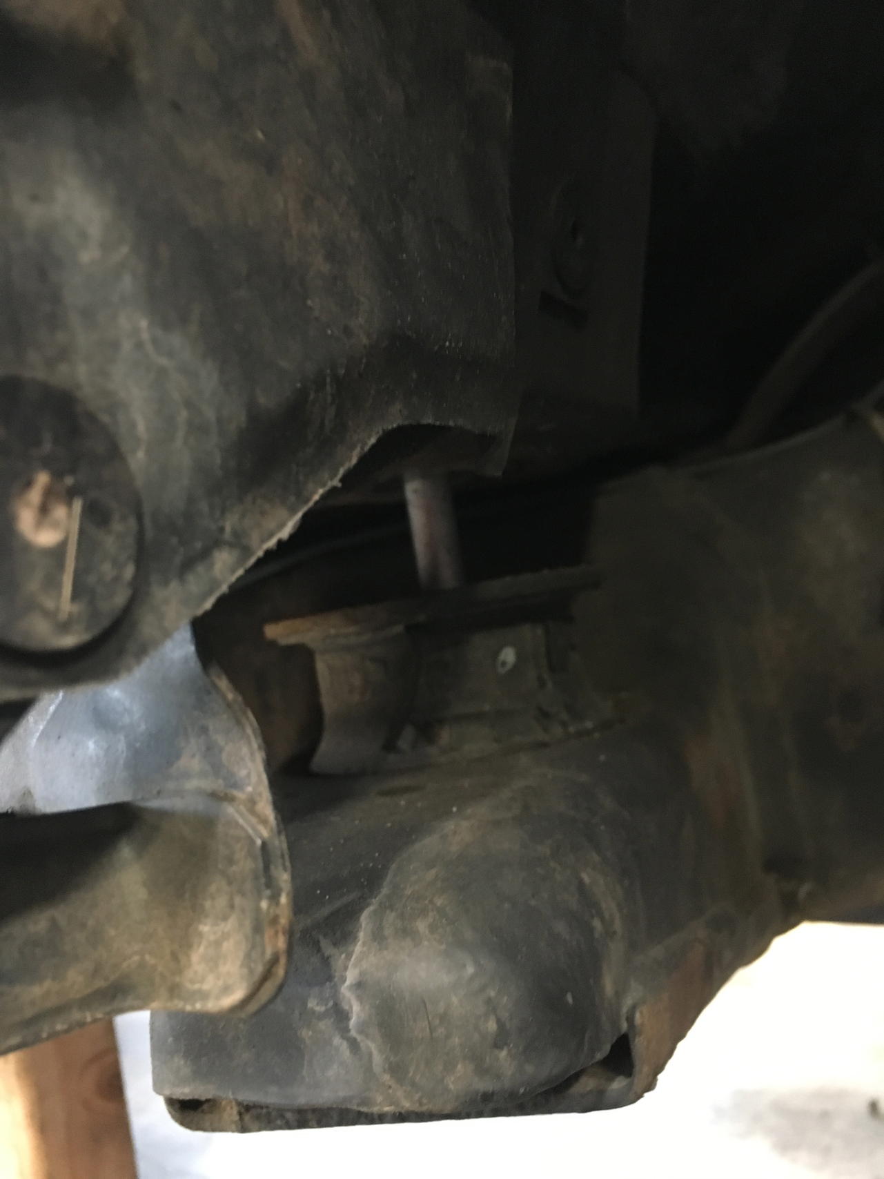

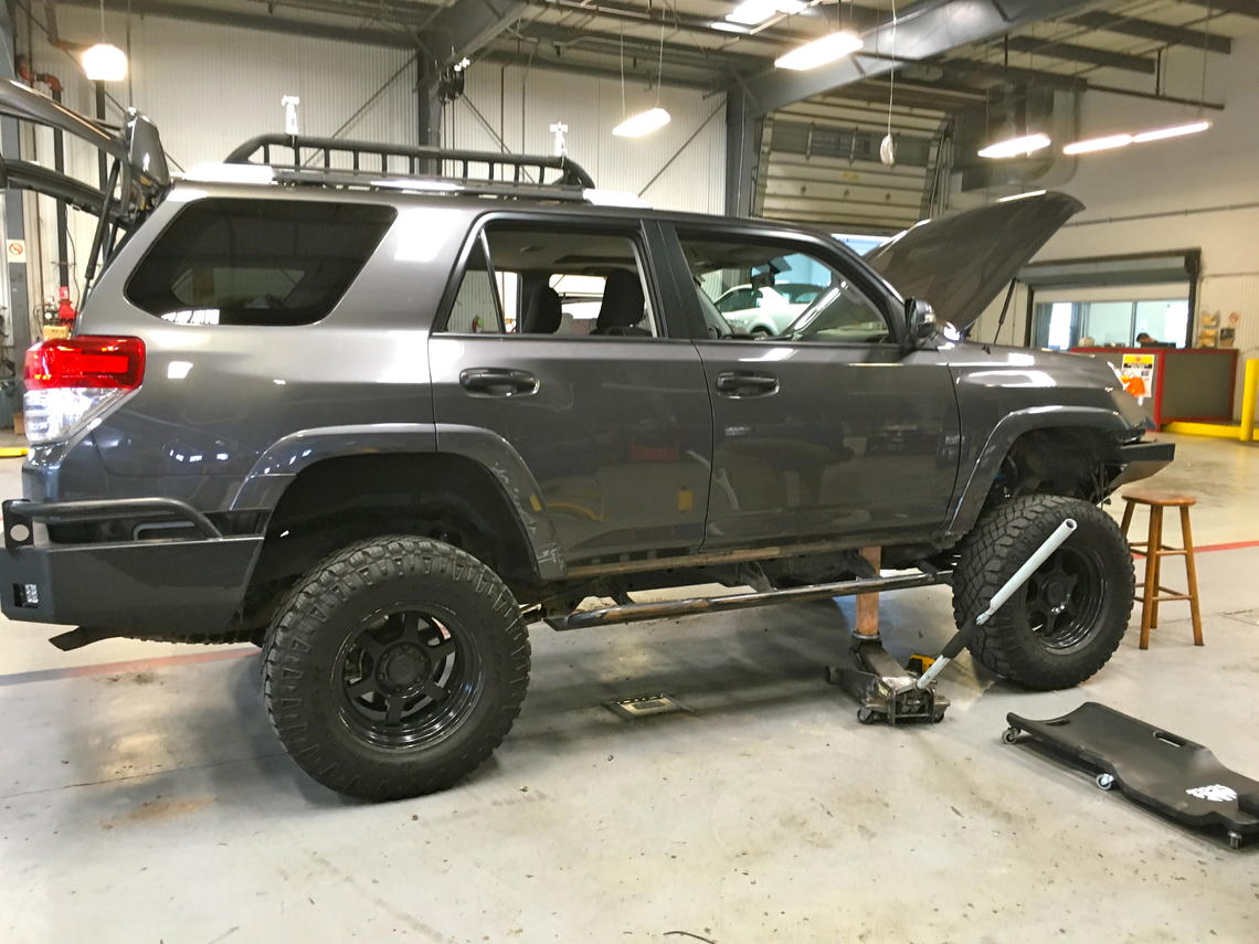

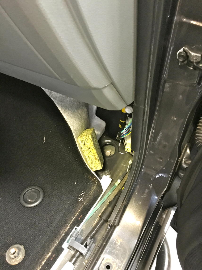

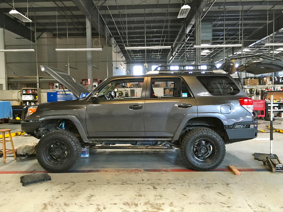

Installed my 1" body lift from Leroy with my buddy Alex. Thanks for your help as always. Went in very smoothly. If we hadn't taken a few unnecessary steps, we were done with the lift portion in a little under 3 hours somewhat taking our time.

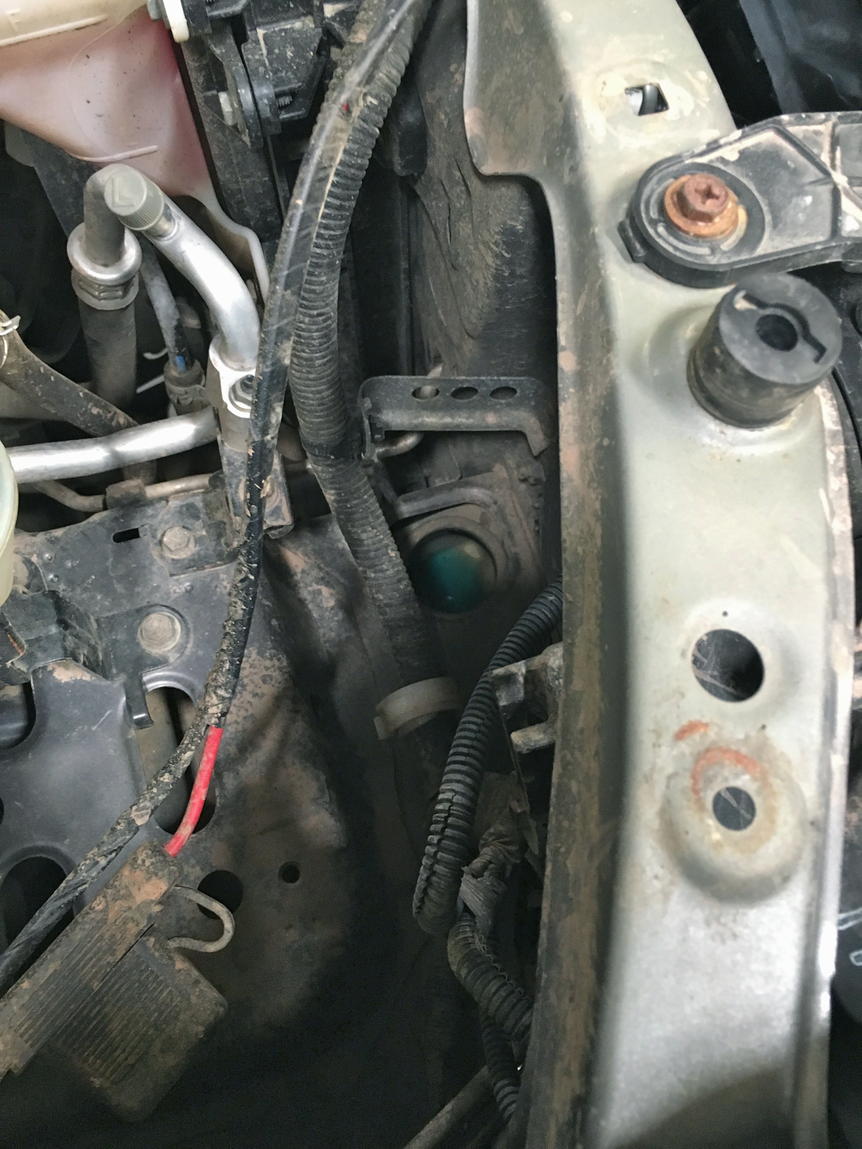

Didn't really have the right tool to cut the bottom of the fan shroud, so we went out hitting up some hardware and auto stores with no success. Ended up using a larger electric saw tip tool to cut and snap off the pieces. Talk about a hack job this seemed like LOL.
Tried to take the shroud off and snake it through the top without taking off the radiator hose. That definitely wasn't happening. But to get to the fan and shroud, we took out the washer fluid reservoir and coolant reservoir. NOT NEEDED. We were doing this to make a clean cut which never happened. We just made cuts that worked though.
It took longer to deal with the engine things than the actual lifting part of the install. It was a smooth day all things considered.

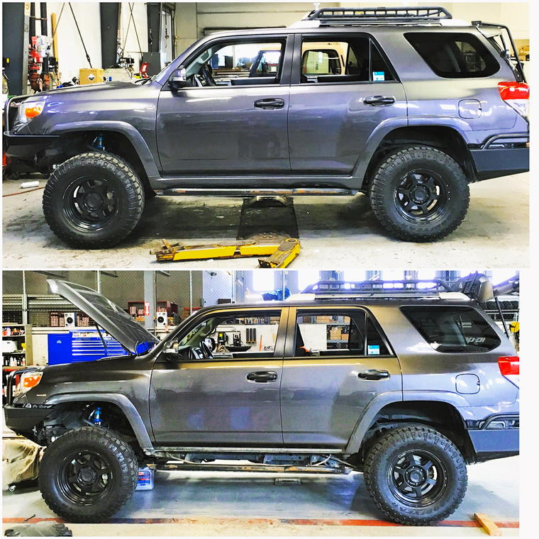

Body Lift 7/17/2016
1" Body Lift Pictures
Double Picture
Top: Before
Bottom: After

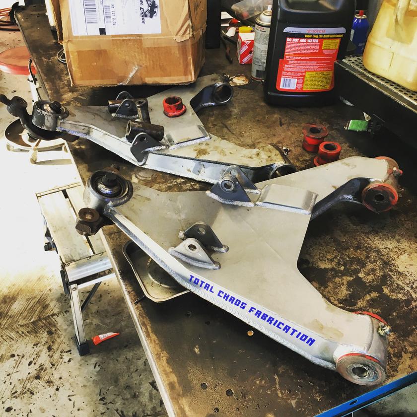

Dropped off the cam gussets with the welder. Will have them Friday. Praying that the following Monday or Tuesday they will be welded to the truck.:pray2:

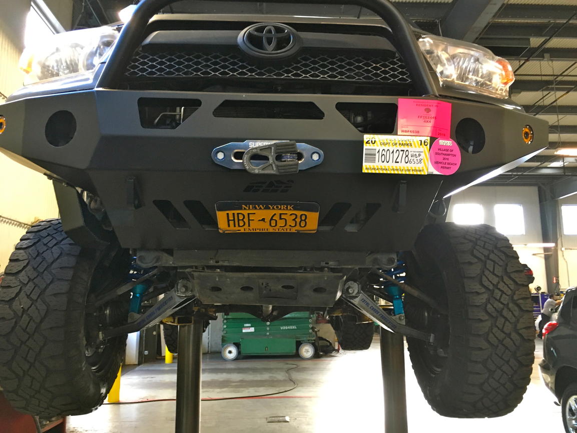

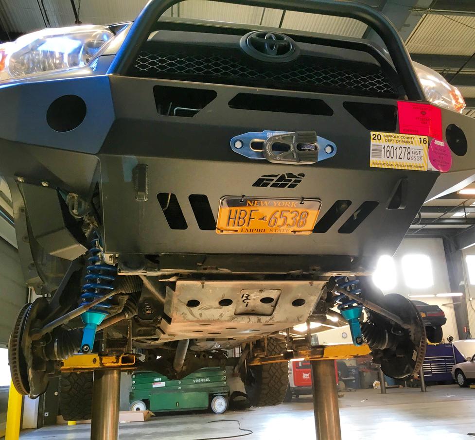

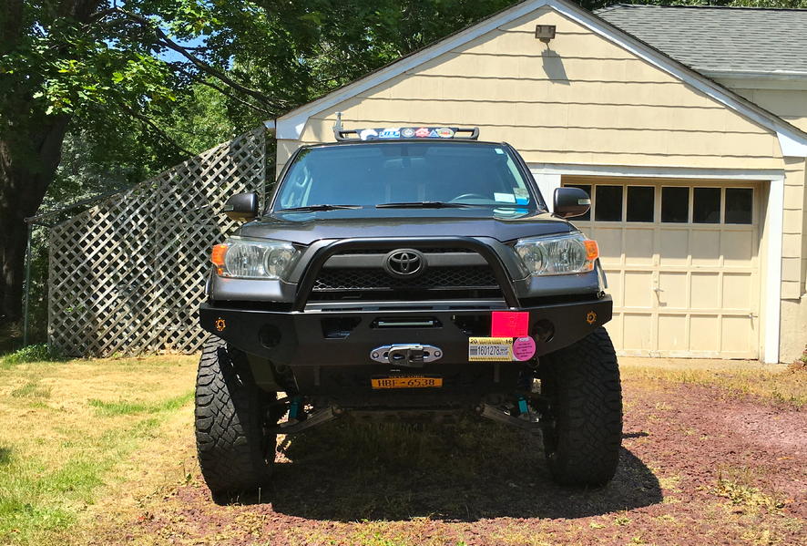

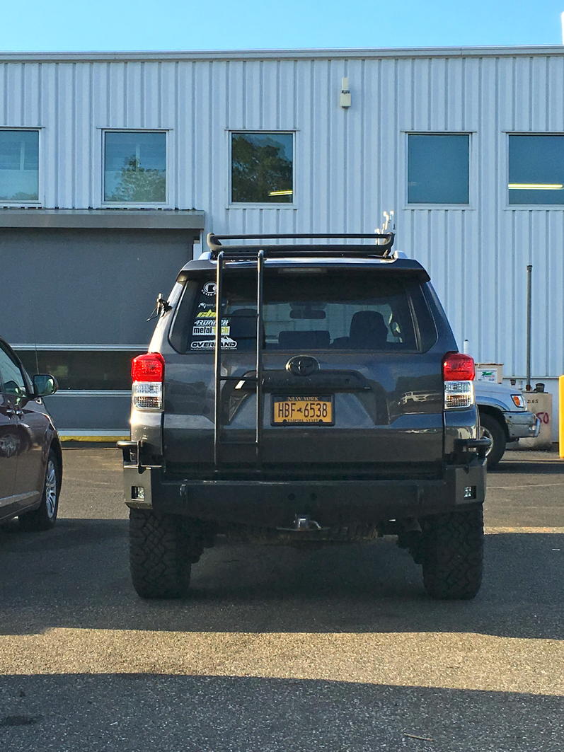

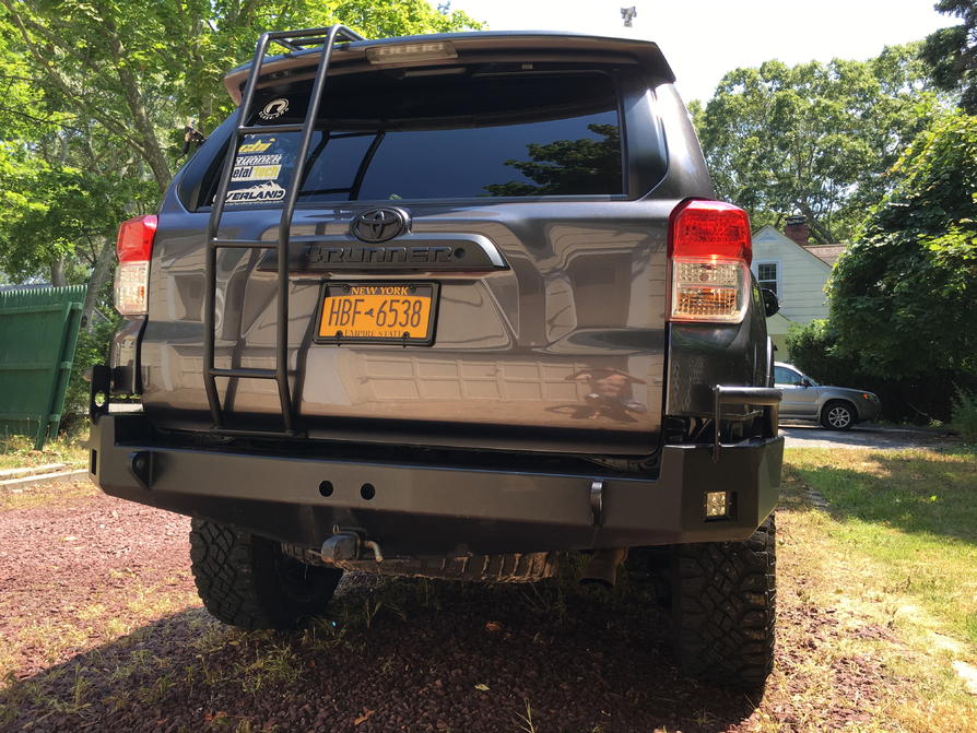

Some cleaned up shots of the gaps from the 1" body lift. This should help with the rhetorical questions…if you can read.
As stated before, I plan on cutting and redesigning the angles of the sliders to angle up and fill the gap. Finally ripped off my rocker panels. Decent amount of wasted clearance. Pretty pumped on that. I've wanted to do this for a while now and should've just bought the ones for the Trail model to begin with(over 5 years ago). I'll also buy new bumper covers to cut to fill in the bumper gaps. Keep in mind, I had already cut the stock bumper covers to begin with when I put the rear and front aftermarket bumpers on also leaving room for flex. So to some, it is a little larger gap than how I've seen where others have cut their stock covers.

Got the cam gussets back from the welder today. Shooting for next Wednesday to burn them on.

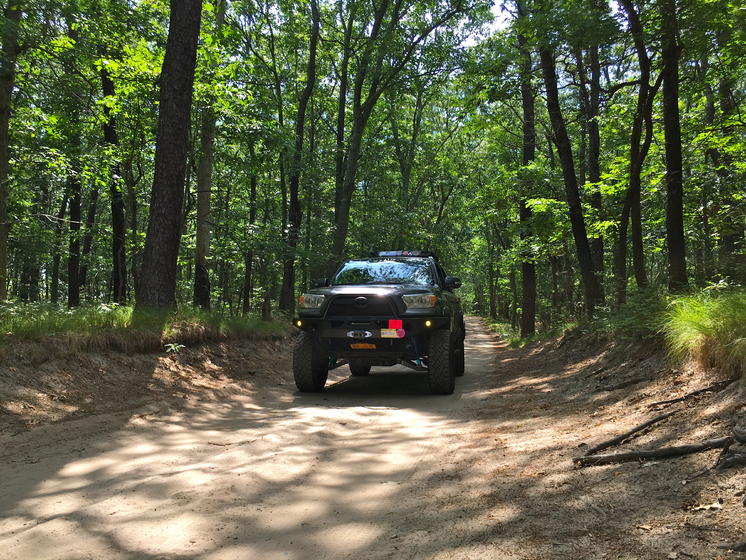

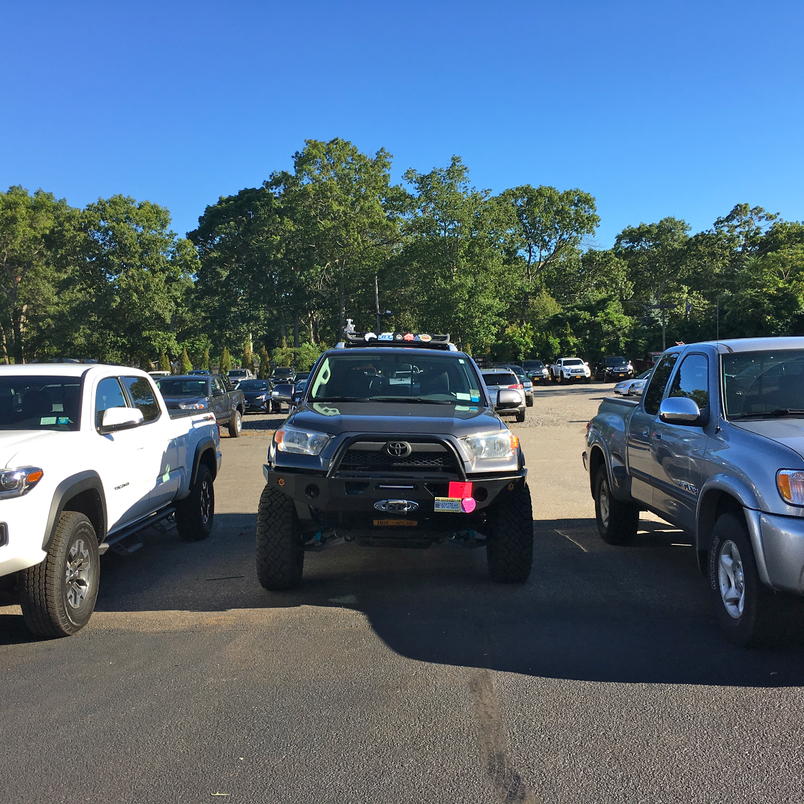

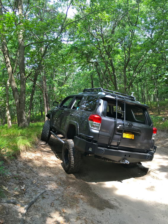

Cruised through a park I hadn't been to yet. Grabbed a few shots.
Where on the island is that? And I assume the pink sticker is your Southampton (private) beach pass? Stupid plovers are still keeping smith point closed.
This was just some small park in Riverhead on the water. Definitely not worth going out of your way to go to. I was just on my way back from the gym that morning and figured I'd have a look.

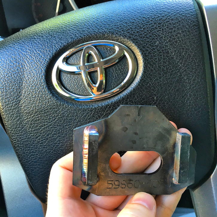

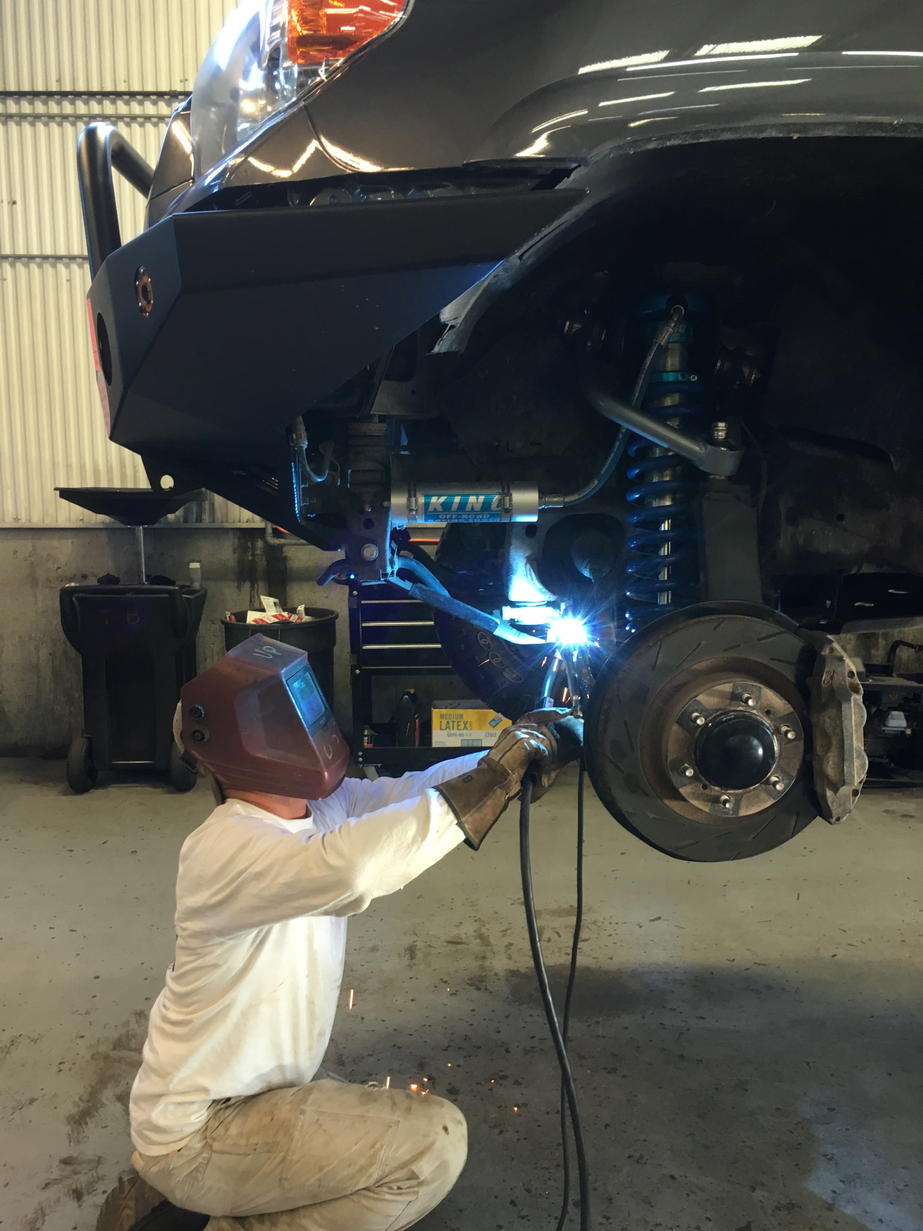

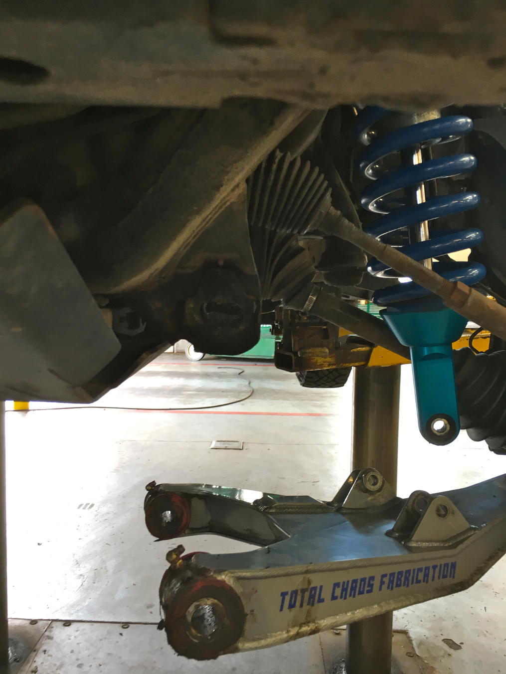

Weld on Cam Tabs 8/2/2016

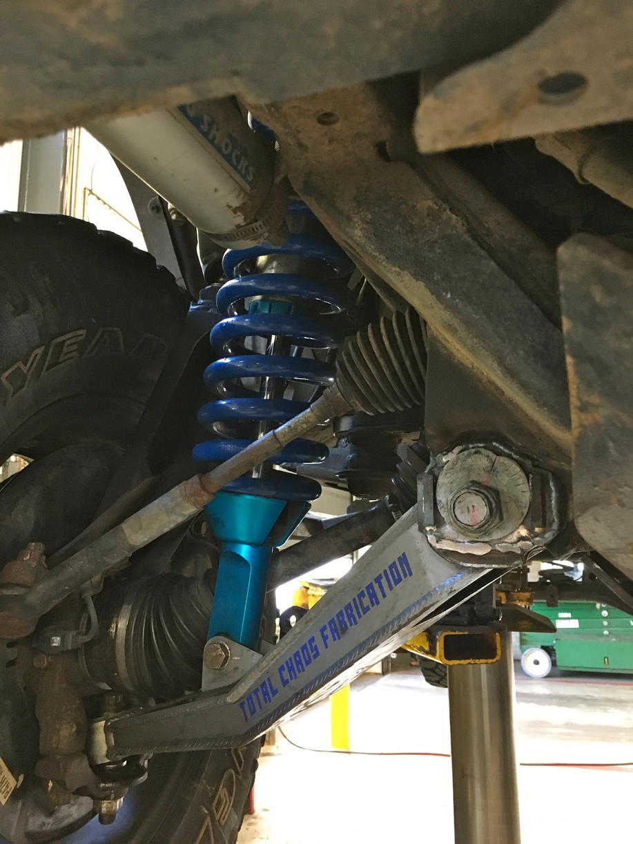

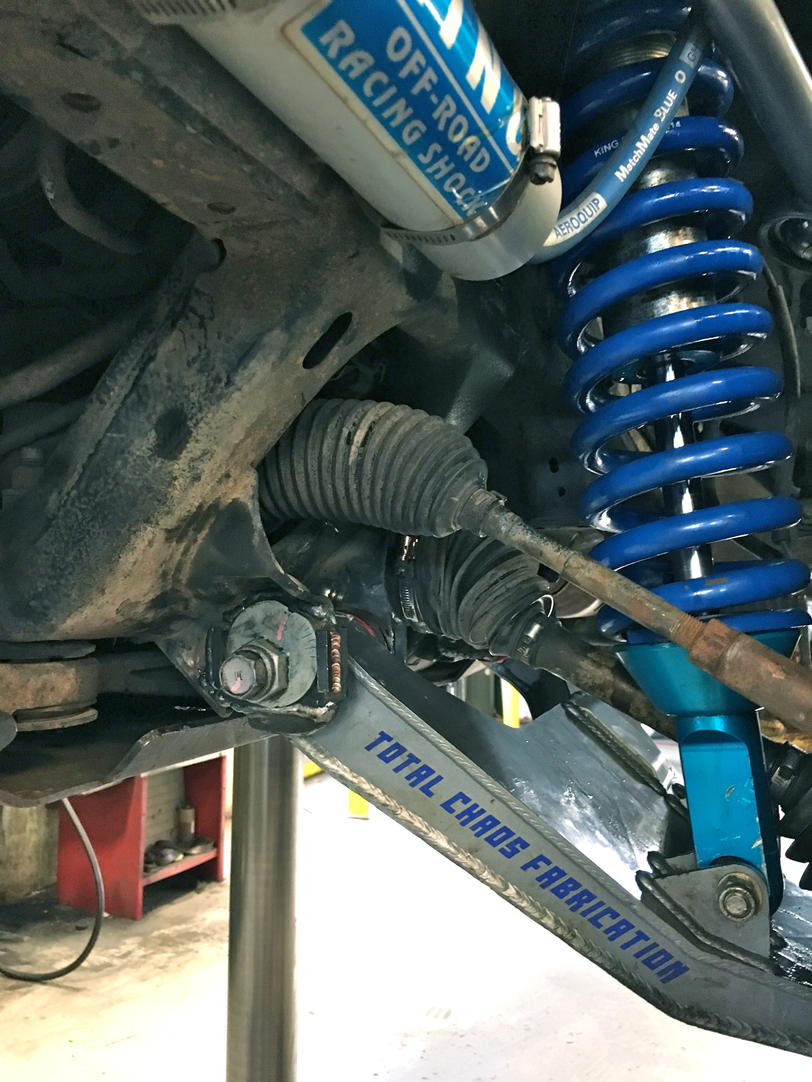

Started the process of welding on the Total Chaos cam tabs. Then while going to line one of them up to tack to the frame, I realized we welded the "ears" on the wrong side of the base tab. All were welded on the same side so a few of them wouldn't work. Only got three of the four on one side completed. Need to fix those tabs. Also tried to take an easy way out of removing the lower control arm without taking off more than needed. It's been a ***** to get it reinstalled. Lowered the perch of the coil over and tried prying the bottom shock mount back into place but it's impossible. The bottom shock mount eyelet is just slightly off but it won't let me fully seat it at the particular angle. I've left it as is because it's coming apart again soon. This is what happens when you're not exactly a mechanic lol.

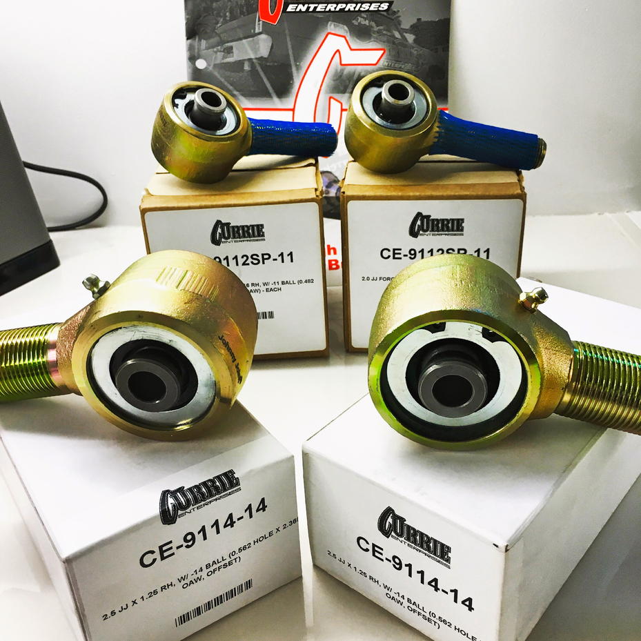

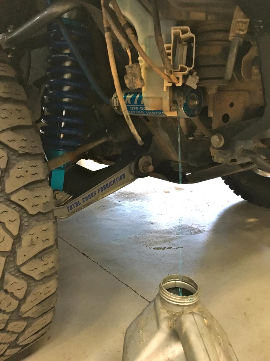

Curry Enterprises Johnny Joints 8/12/2016
Needing to replace the top two Johnny Joints on the Metal Tech upper rear links. Took an easier way out instead of rebuilding all of the internals Figured I'd just buy them all while I'm at it. The bottoms seem to be alright. In the middle of getting the bushings. Daystar is what they use and for $50 I can have them make up a set for me as they don't have this part number in stock right now.
Still have yet to finish the cam tab gussets. Slowly getting there. Started replacing the bushings and uniballs in the lower control arms.

Final Cam Tab Gusset Installation
Cam gussets welded in. Definitely wasn't the best welding job although the tabs that were tig welded to the base of the tabs came out awesome. Pretty bummed about that but it should work. Alignment is next and need to paint over the ground down areas. Sitting almost normal again now.
