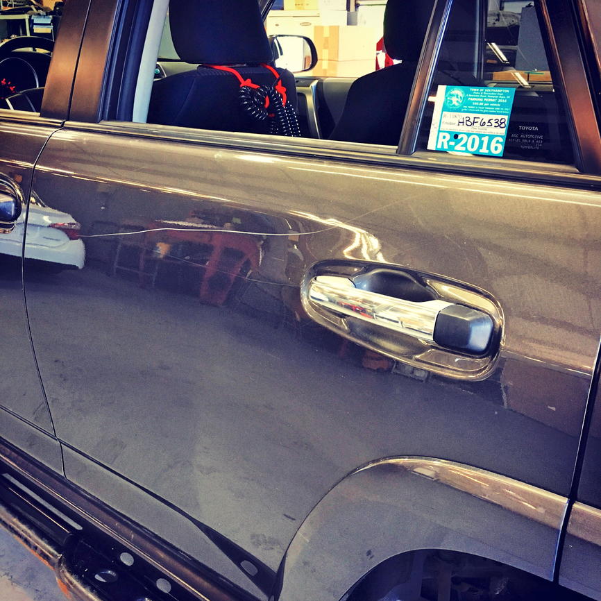

6/20/2016 Door Handle Replaced
Finally replaced the rear driver side door handle after having the pieces for about a month lol. Just need to Plasti Dip it.
