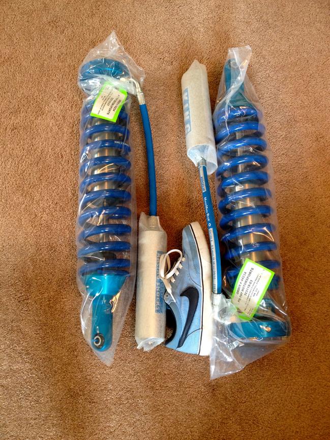

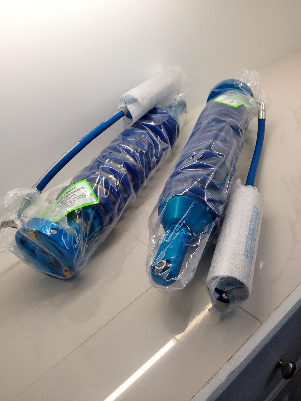

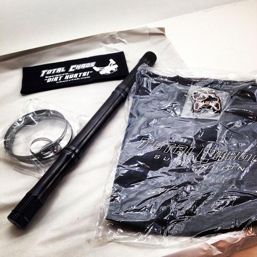

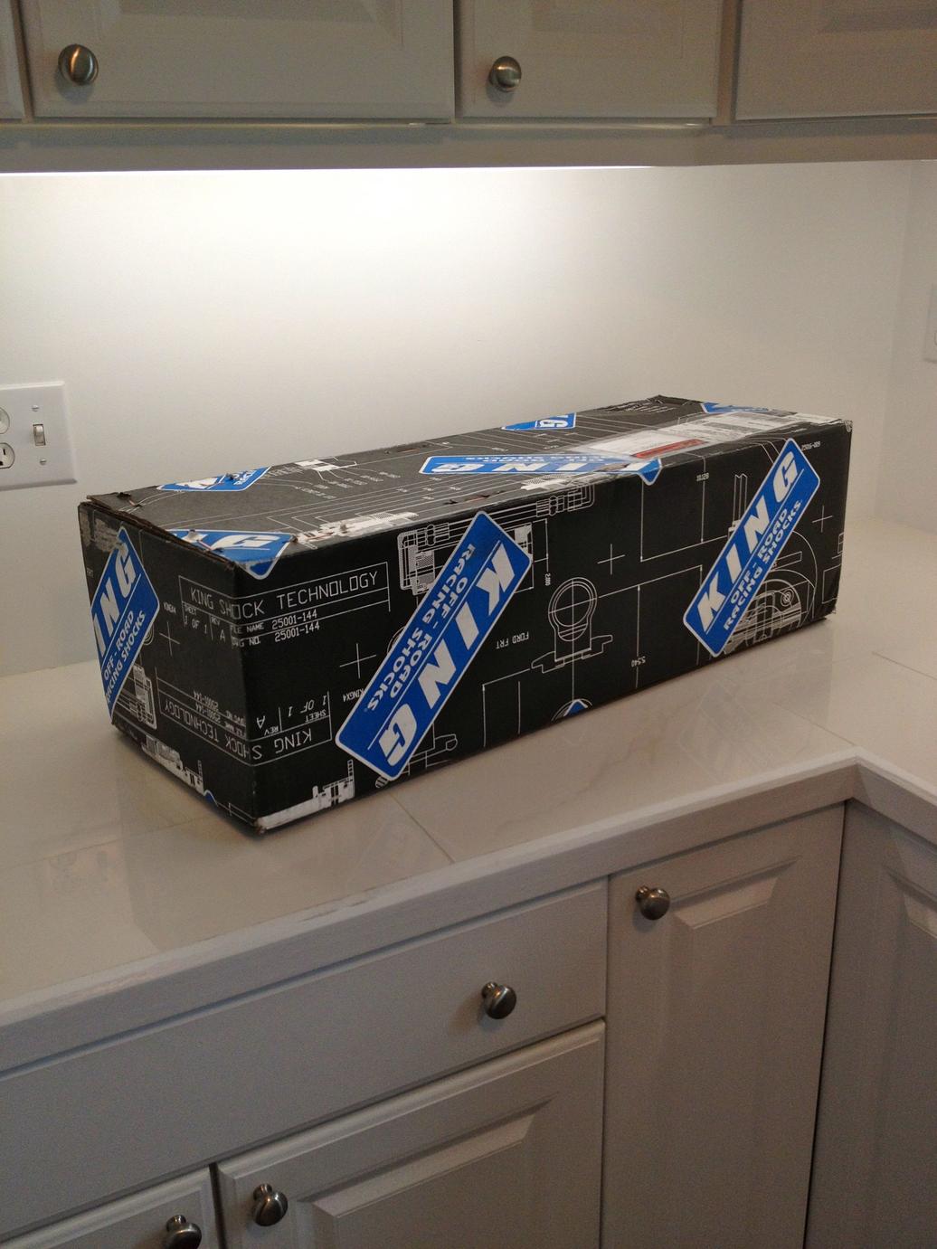

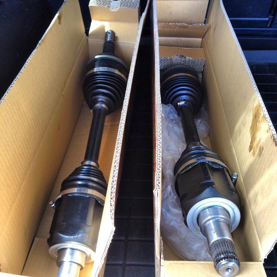

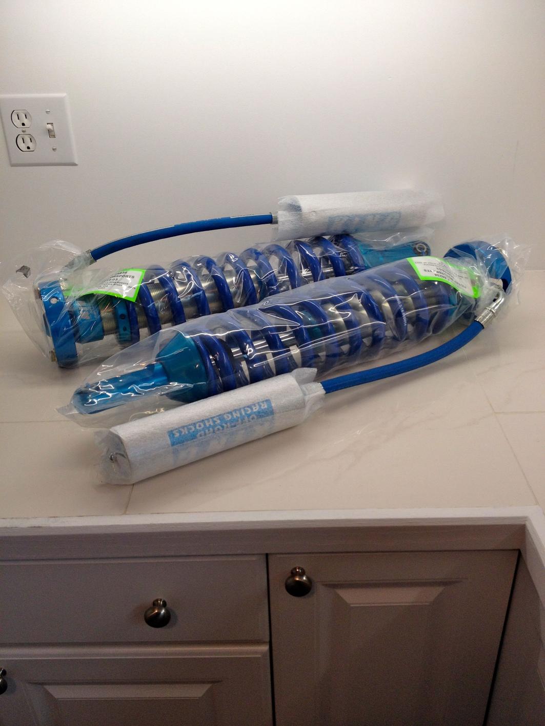

My third Total Chaos +2" axle shaft arrived for my spare along with my new 2.5" shock body King long travel coil overs with remote reservoirs for my Total Chaos long travel kit.

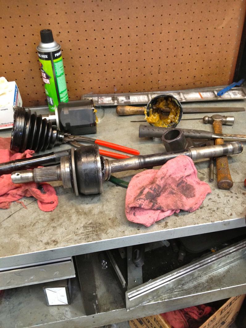

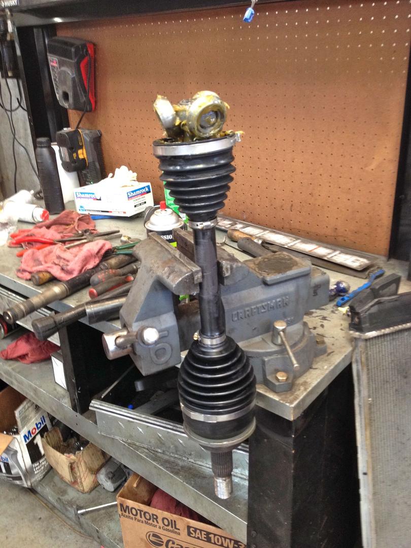

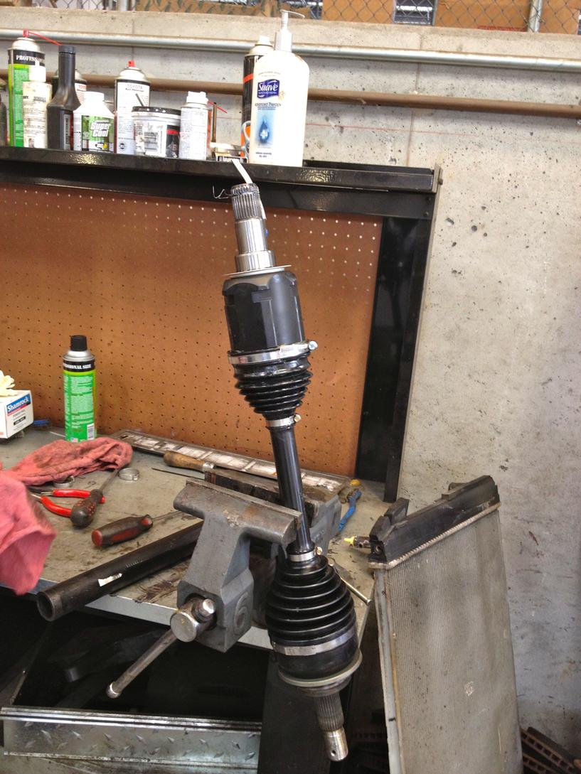

Installed 2 of the three +2" Total Chaos axle shafts. I had bought two genuine Toyota axles/cv(as they only come fully assembled) and replaced the shafts. I'll replace the third one when the front stock axles come off of my truck. Maybe buy another one so I have 2 spares.

Did you have any symptoms that led you to install the ECGS bushing or was it one of those "while I'm in there" things?
I've got a rubbing sound that only appears when the suspension is compressed. It doesn't happen in 4WD though so I'm wondering if it's the needle bearing going out.
Yeah, I had a constant groan coming from it. But yeah, since I was going to have it open, it was the best time to do it. You can install it without taking the front diff apart. Just need to take that cv out.
