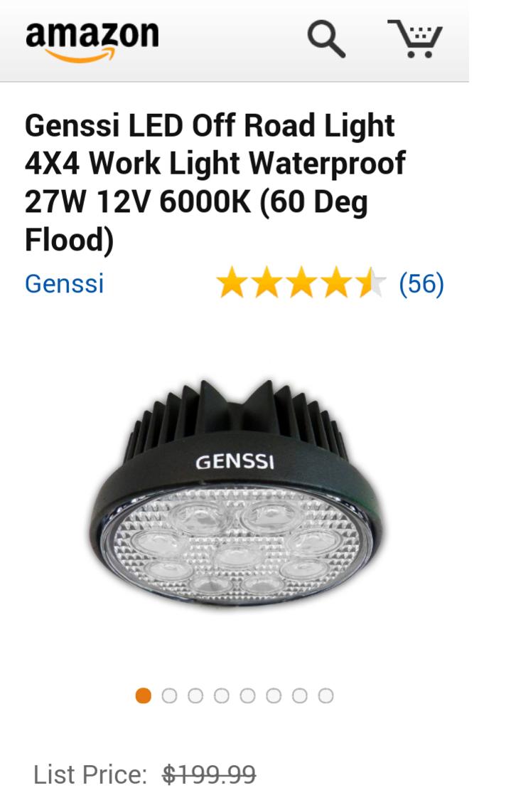

Can you post a link to lights you bought?
Maybe some night shots .... Of the road.
Thanks Brian, it's gettin there... I bought them off Amazon here's the link:Amazon.com : Genssi LED Off Road Light 4X4 Work Light Waterproof 27W 12V 6000K (60 Deg Flood) : Home Improvement -hard to beat this deal!

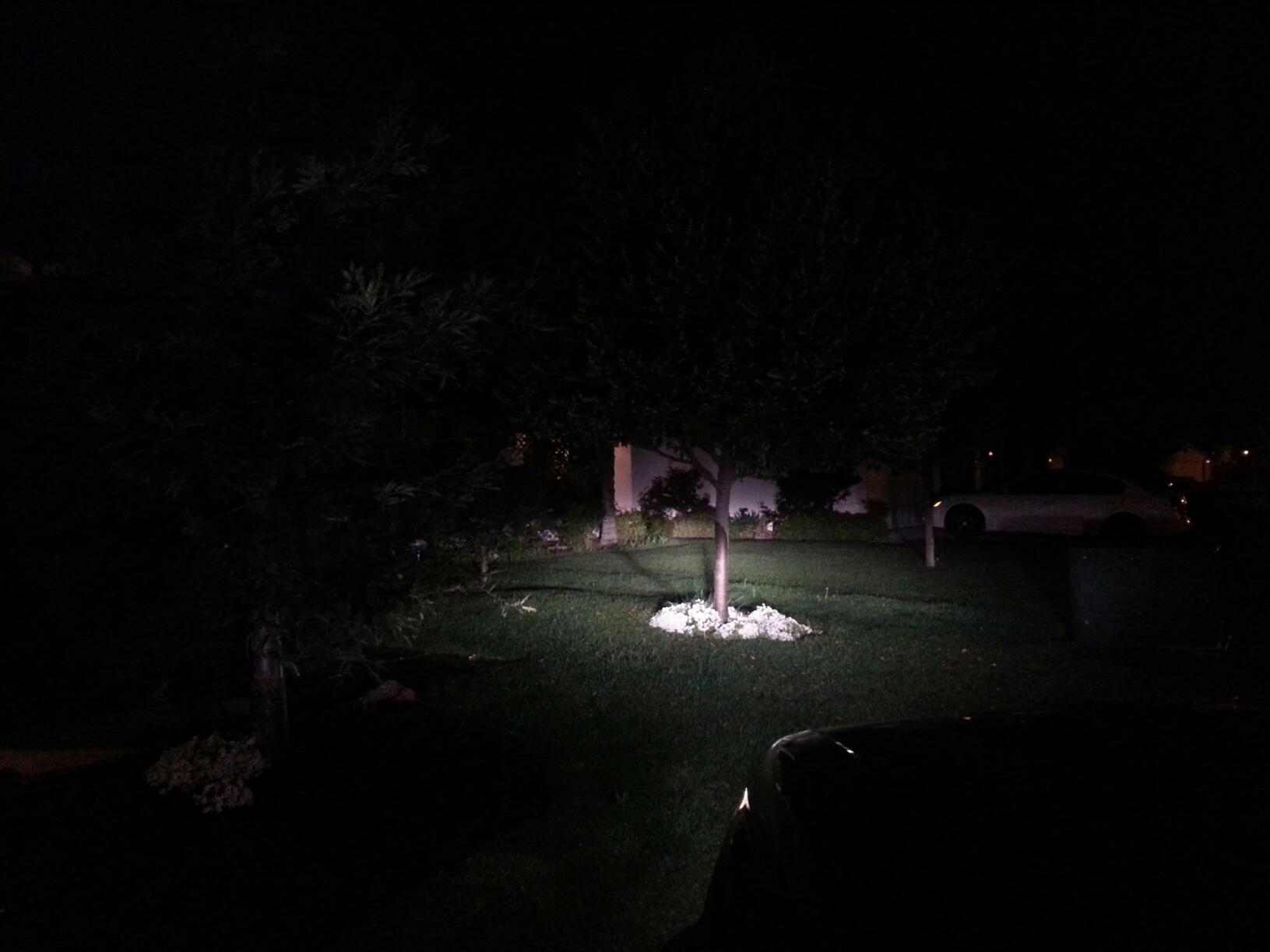

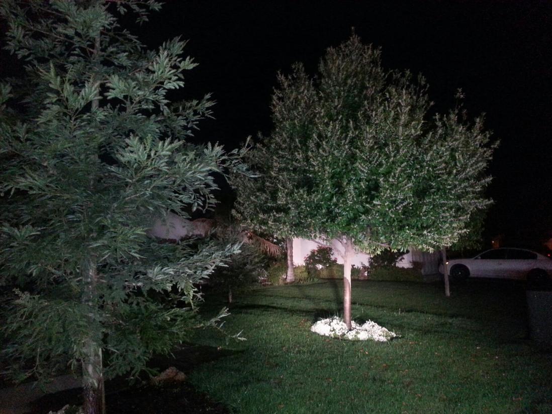

And here's a few night shots, keep in mind i'm using a cellphone camera so it doesn't do it justice, it was hard to get it to focus, however they are really bright, I recommend these, and Im pleased with the output... I'll try to get better pics later.
the first pic is just the LEDs by them self, and the 2nd shot was just headlights without the LEDs on, the 3rd shot is just the LEDs. these are 60 degree flood type lights, they also offer more of a direct beam light (30 degree)

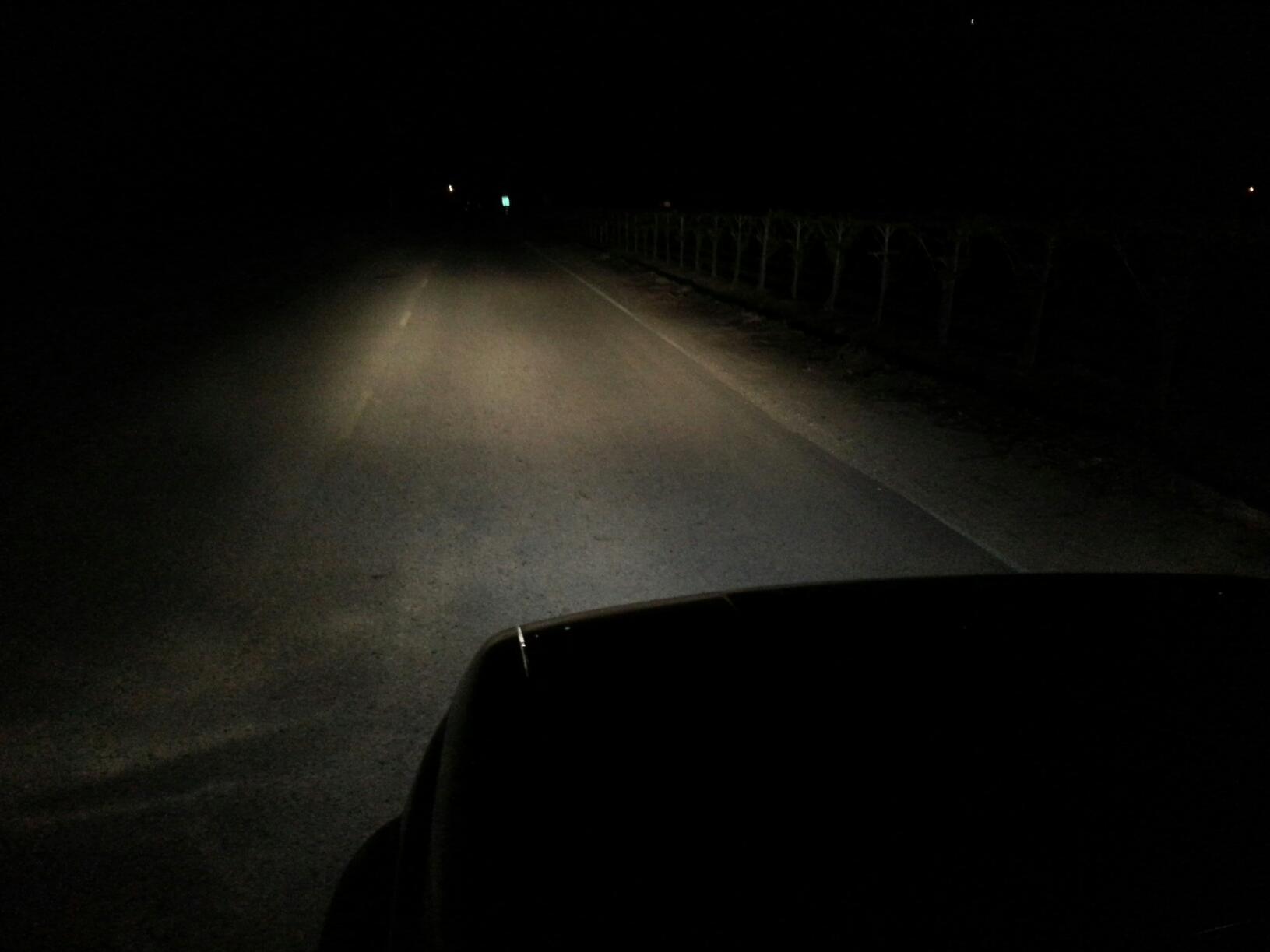

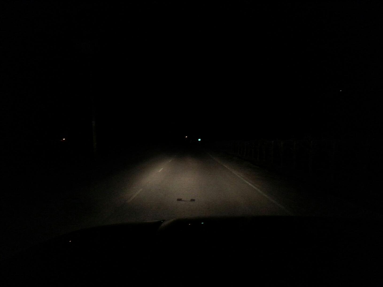

Here's a better representation of the light output at night-
*the pics above were bugging me, can't have that... :hand:
1st pic: only low beams on.
2nd pic: just high beams on.
3rd pic: all LED's

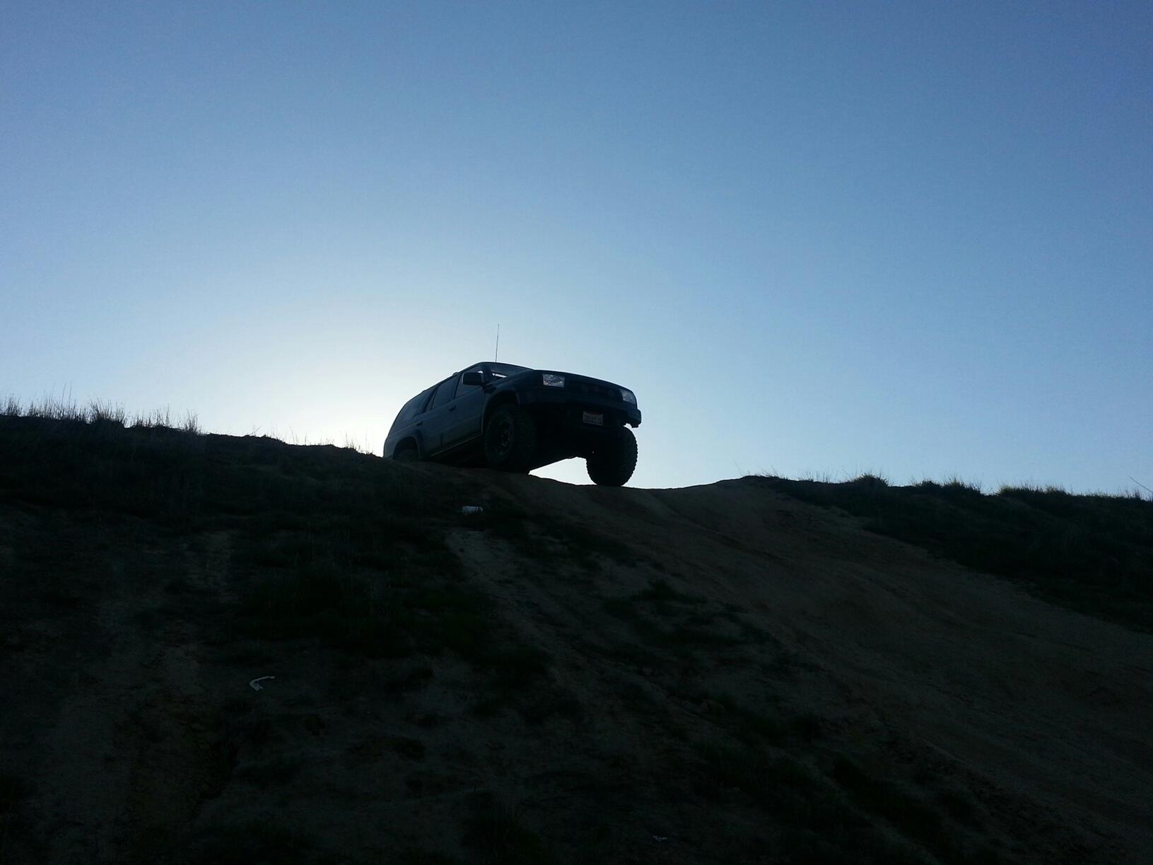

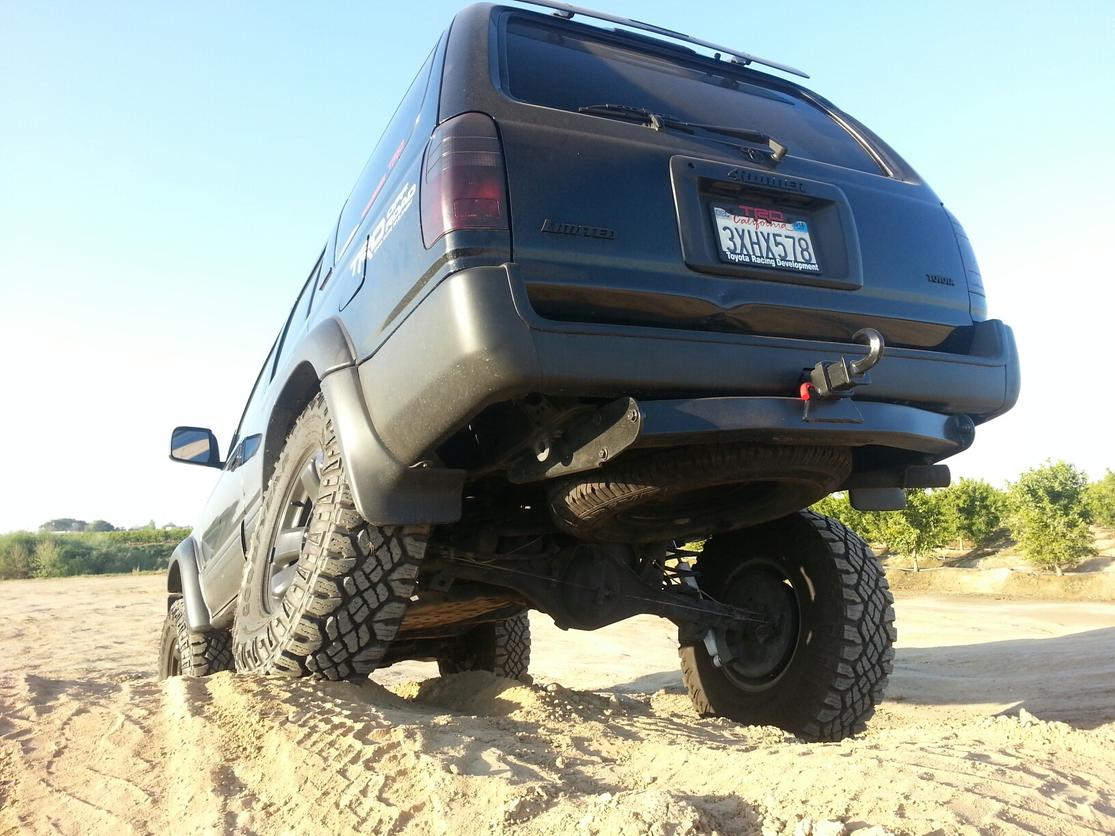

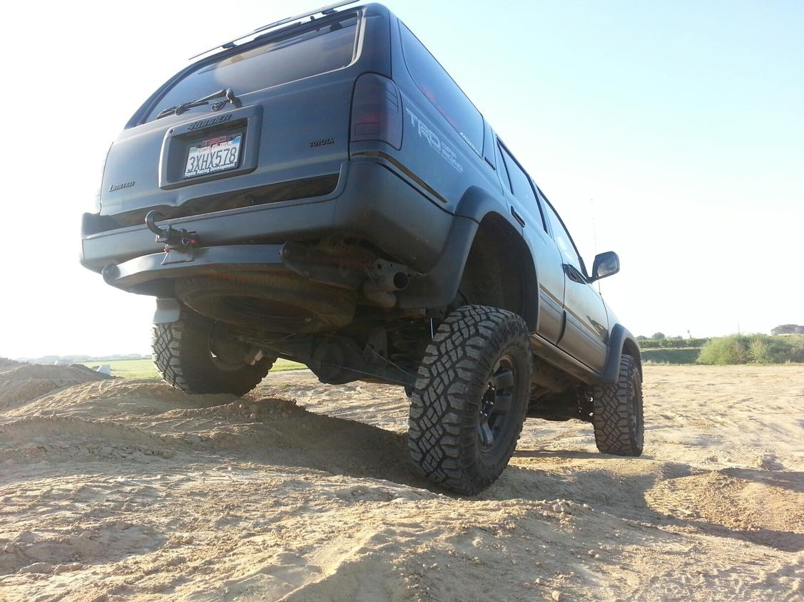

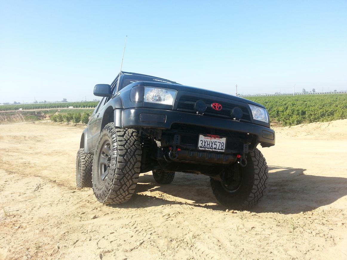

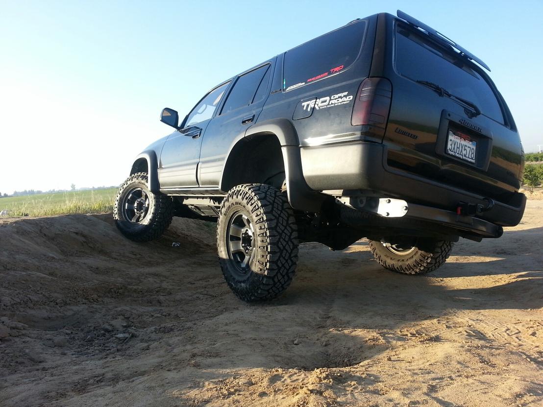

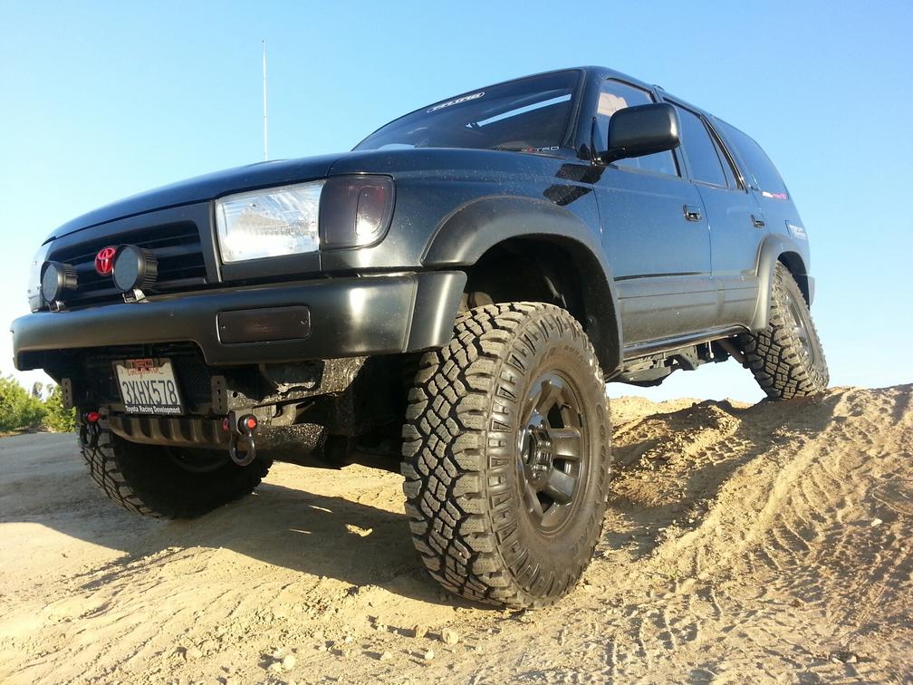

morning flex...

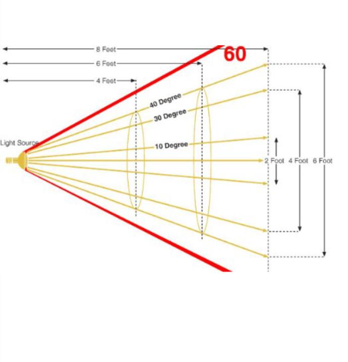

i have those same lights, they are just used for fogs, you can easily out drive the light, they are by no means driving of spot lights even tho the adds sometime say spot.
Yep i hear ya... these are only my fog light replacements, I got tired of my old halogen fogs, these are definitely better than my old ones. The next lights I get will be spot/beam probably more towards a 30* degree type for sure. The seller I bought them from offers them both flood and spot types. Ultimately I want a 52" light bar on the roof... I need more light:flame:

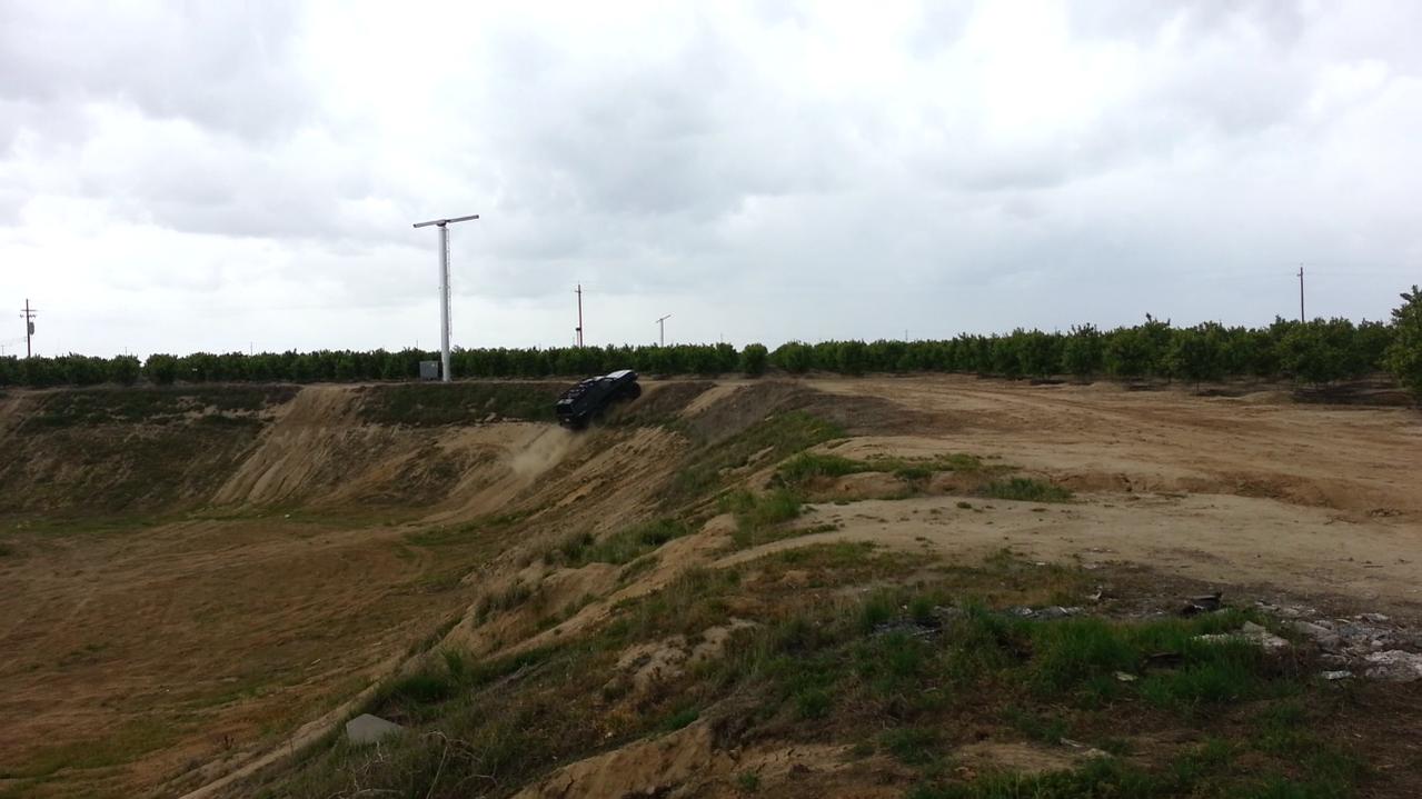

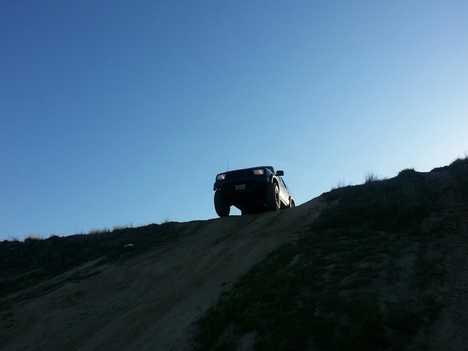

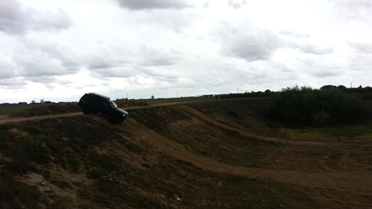

more pics from the morning... i found a reservior to have fun in...:eyebrows:

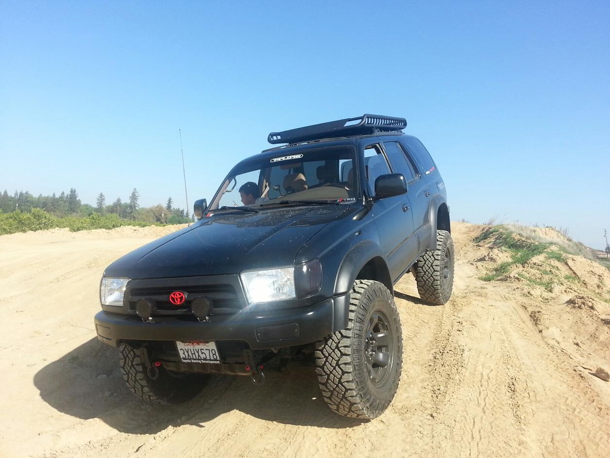

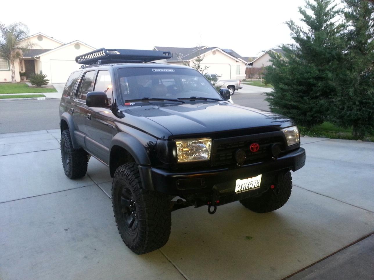

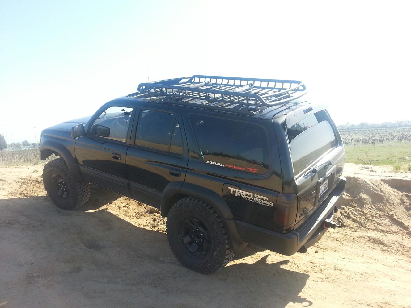

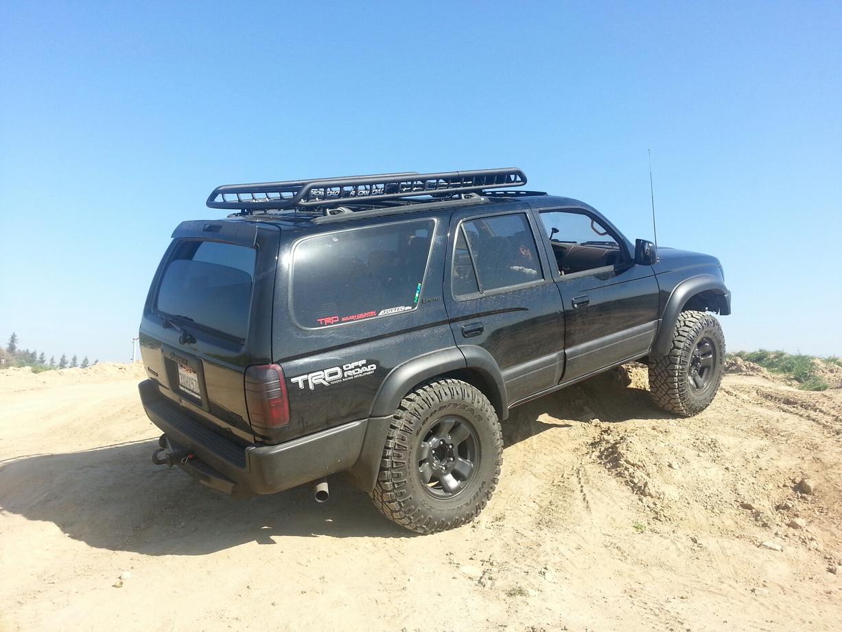

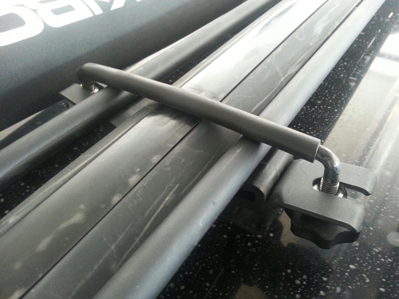

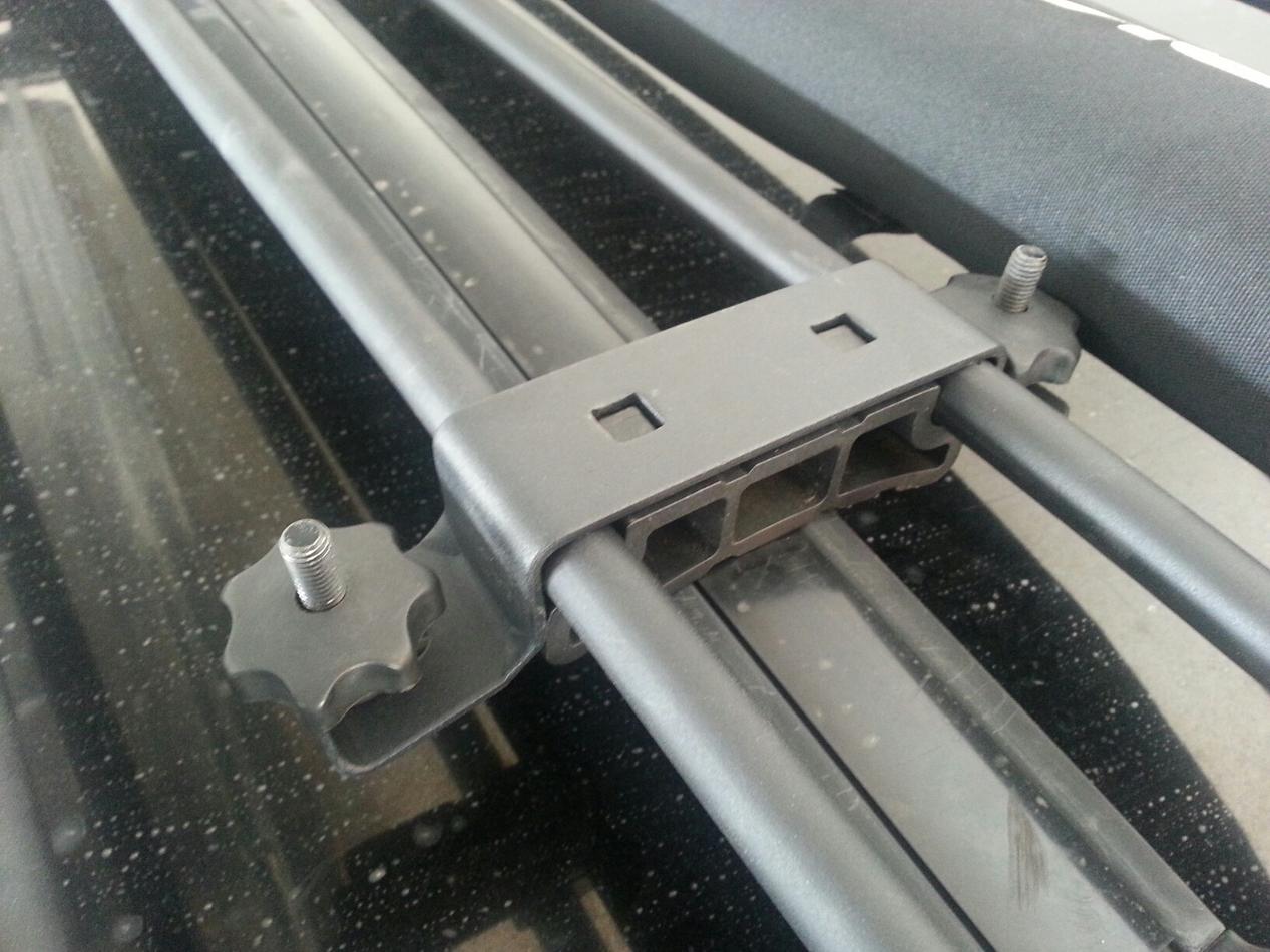

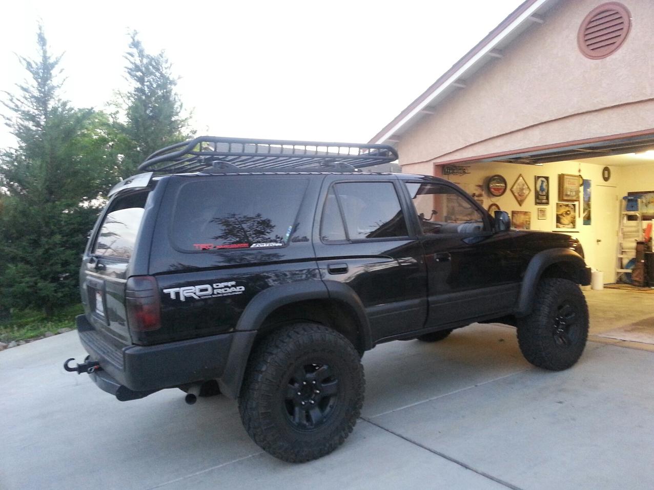

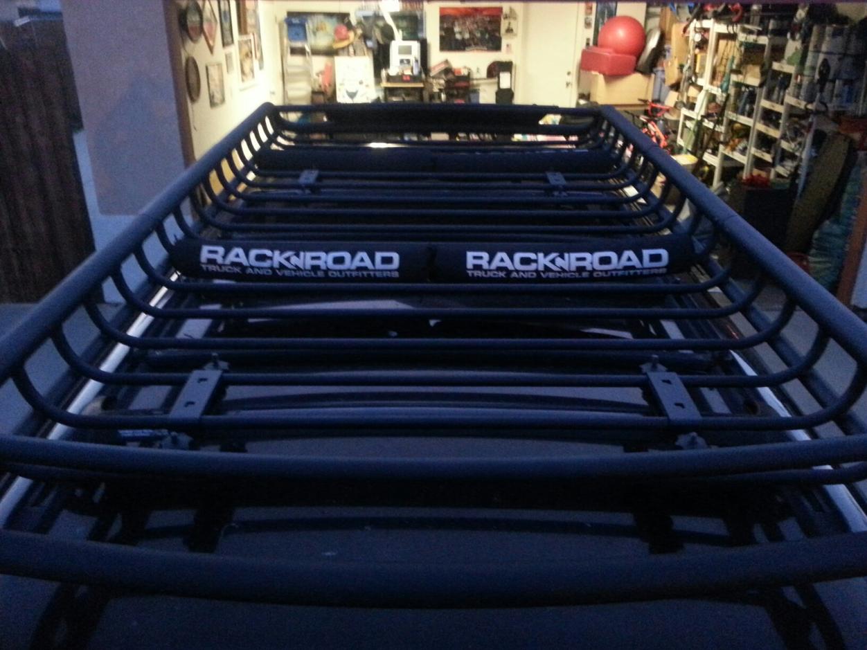

I finally got the rack on today. I really need to try and make some lower profile mounting brackets soon, I'm not diggin how high it sits on top of the cross-bars, but it's a decent looking rack though. It's going to look way better once i get closer to the roof!
*Here's some pics-

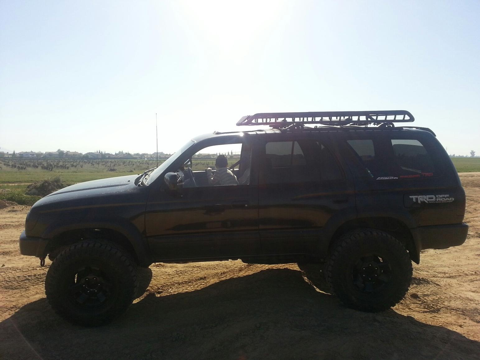

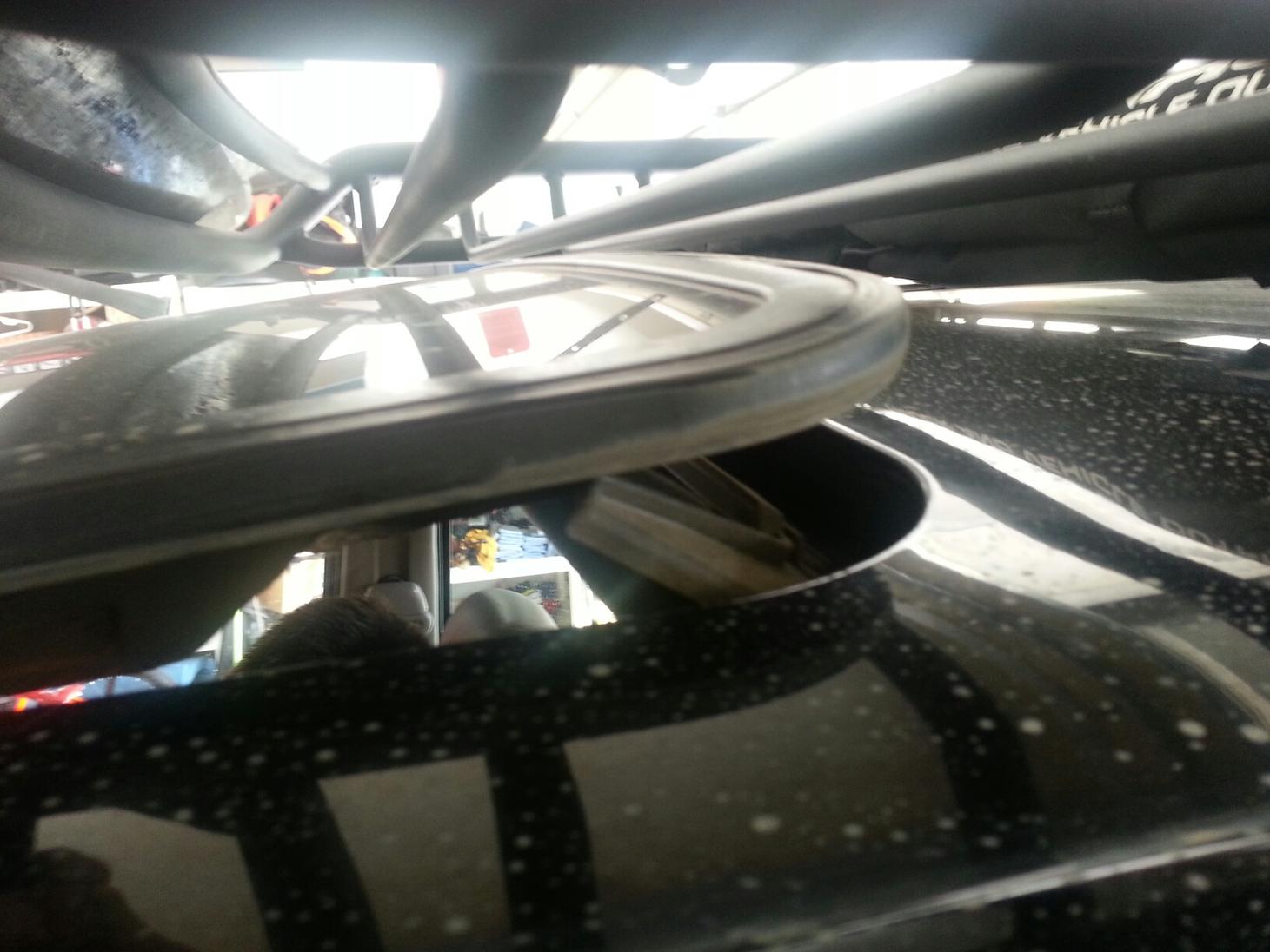

good idea

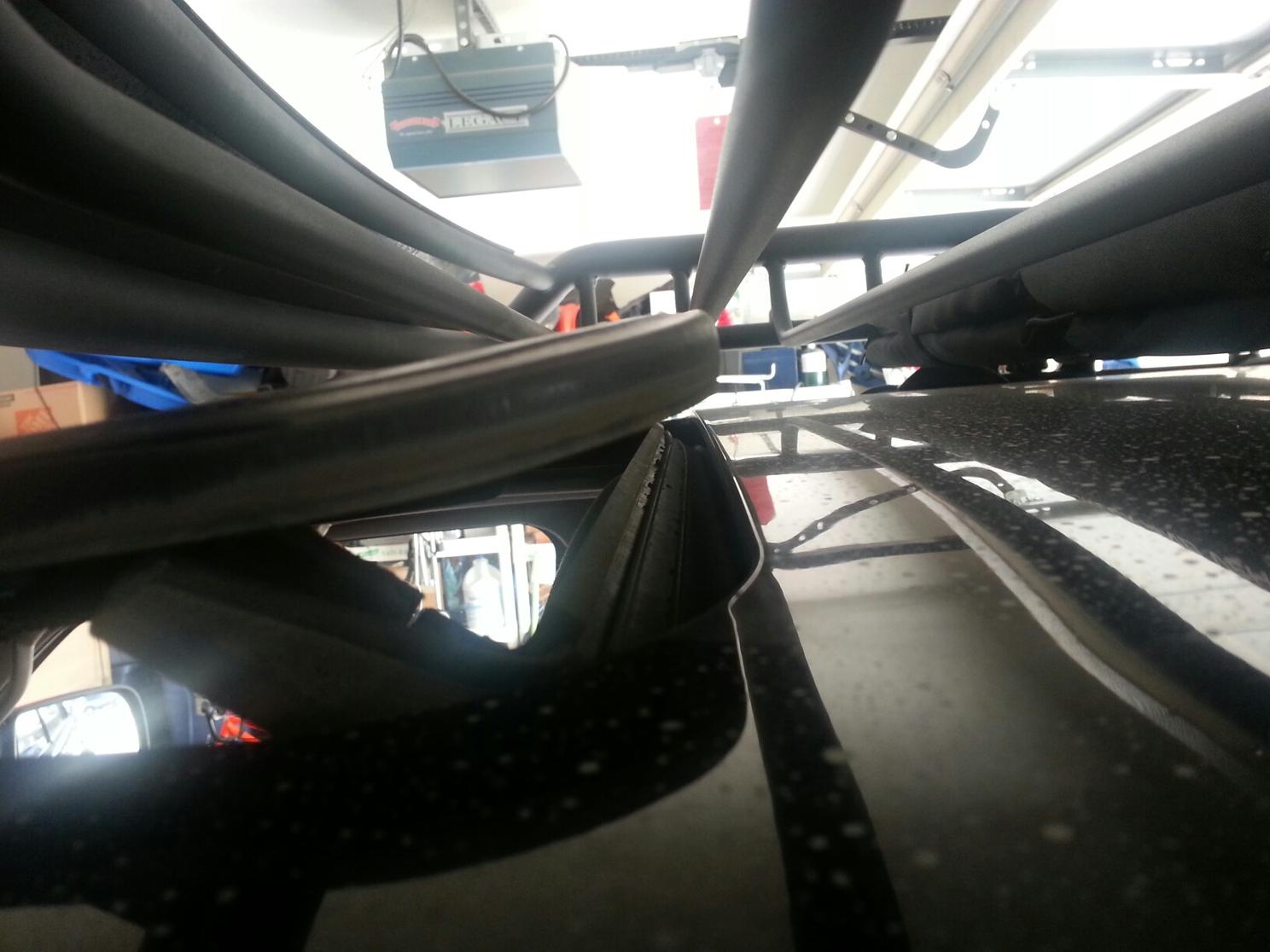

Can't you flip the brackets over and that will drop the reck down an inch or so
Hey thanks man, I flipped the brackets over and it worked out great, it lowered the rack much closer down to the roof at least 1-2" inches i'm guessing. It's a nice simple trick that works. Good looking out! :yo:
I eventually still want to get some custom mounts made.
I have just enough space to tilt/open my sunroof!

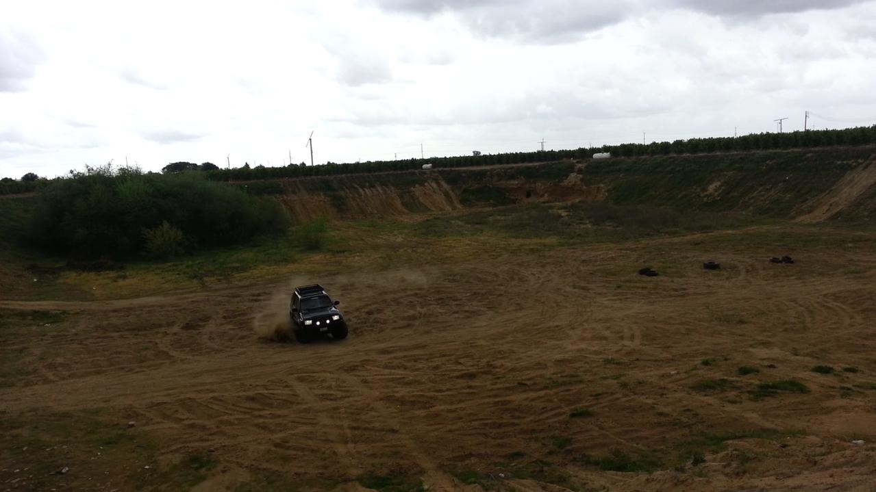

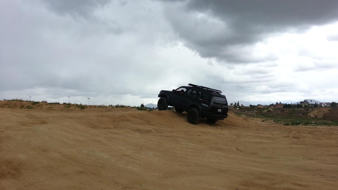

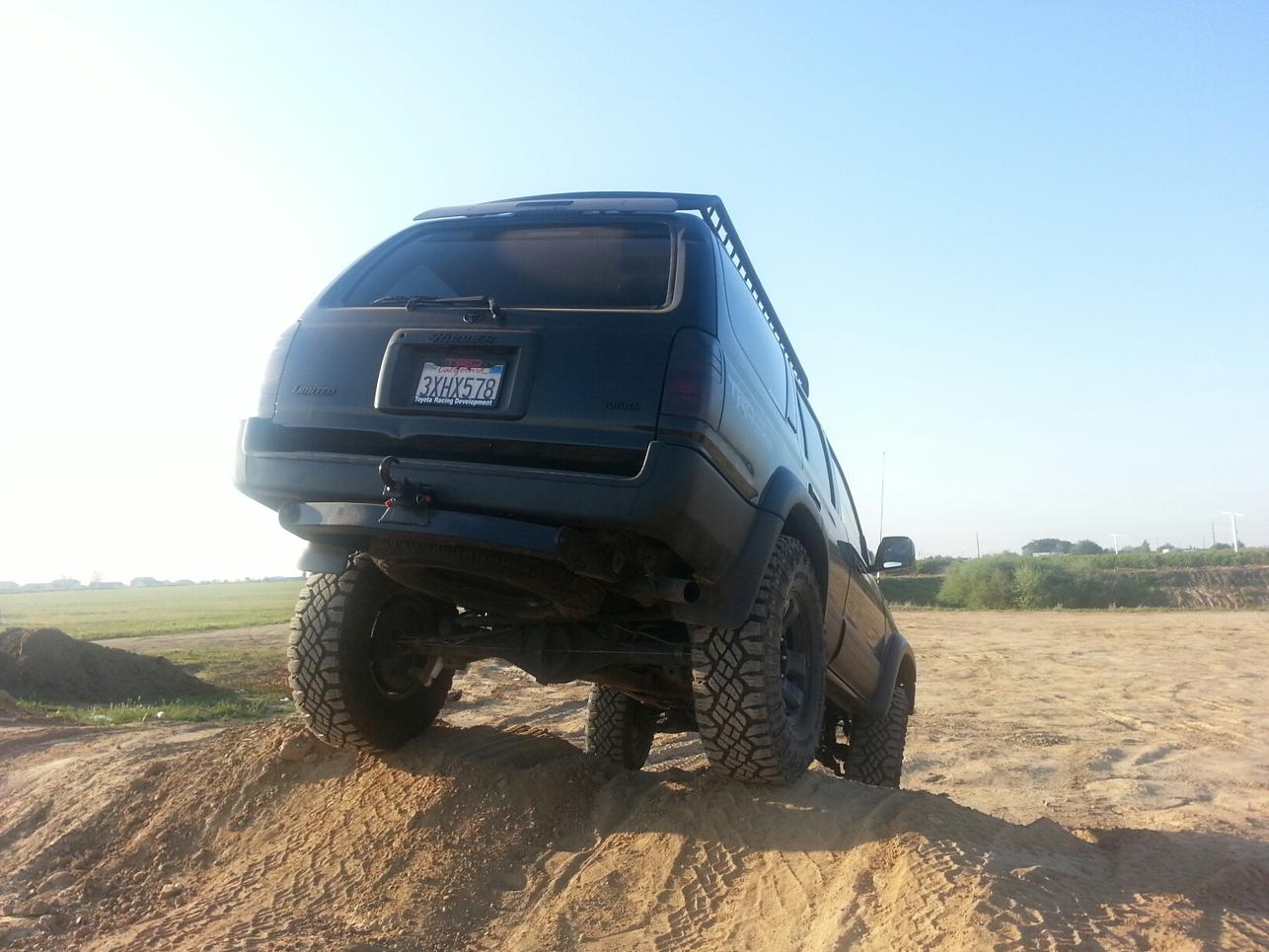

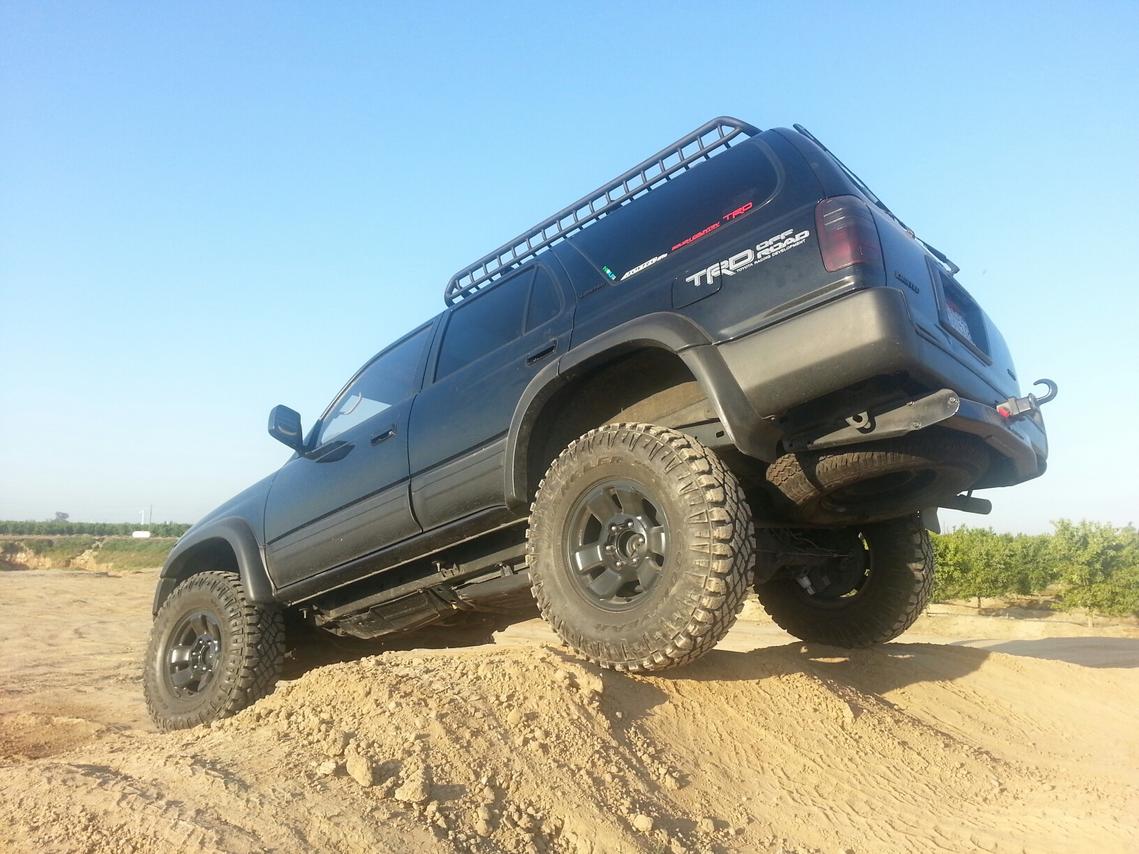

Took my son out for some fun today, this area is down the street from my house, so why not..:roadkill:

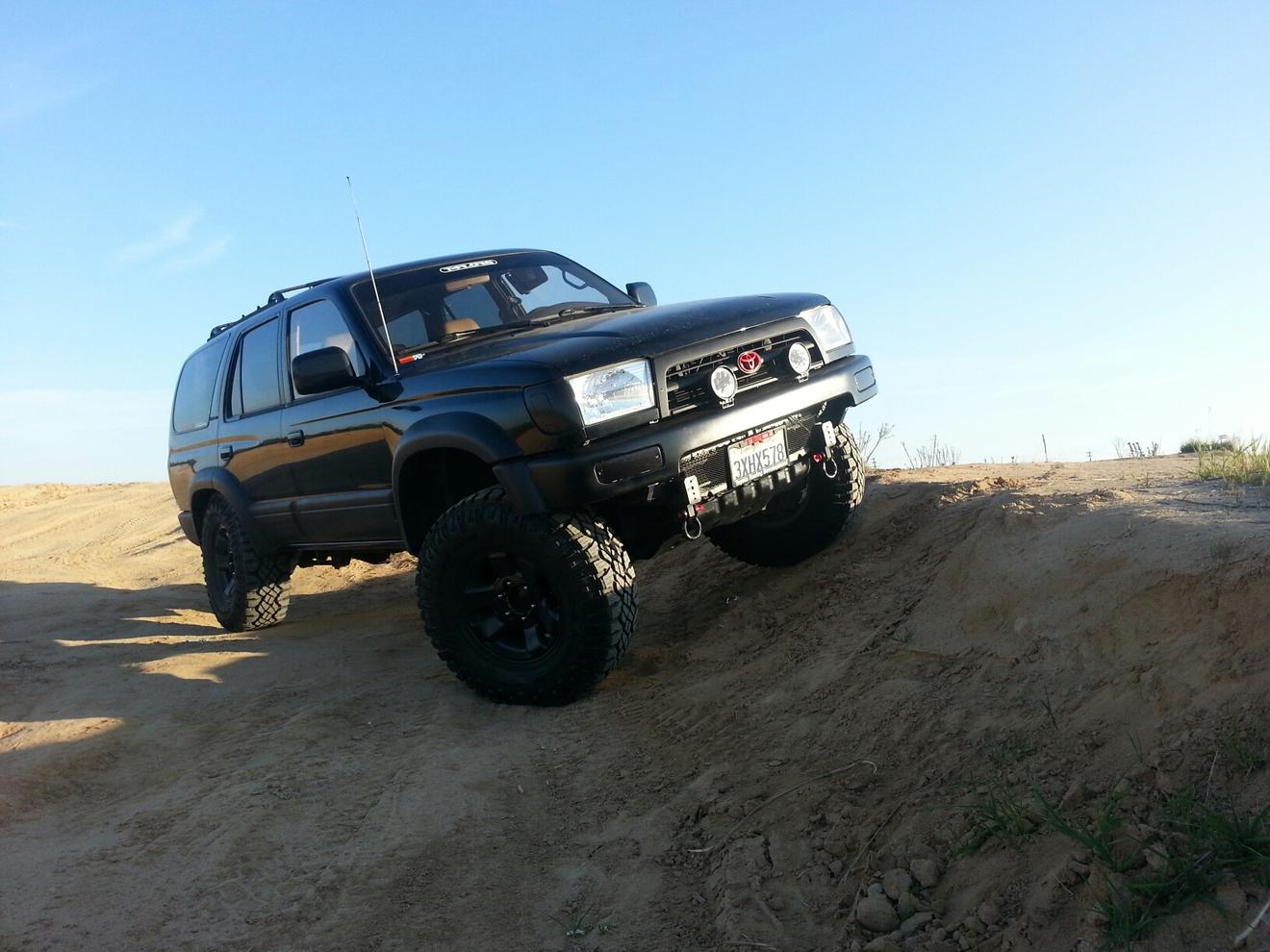

some still shots...

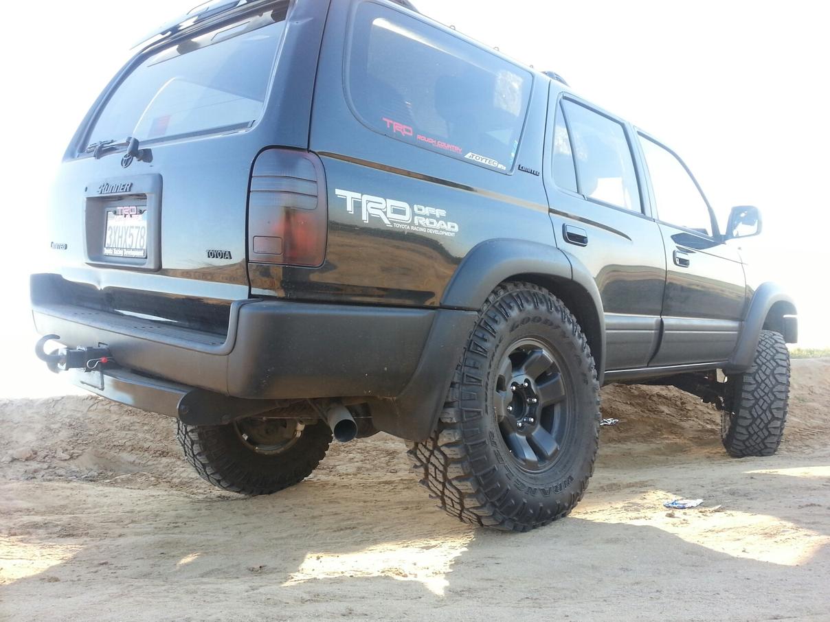

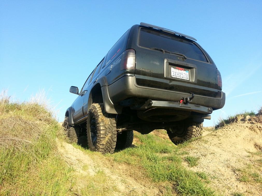

are those bought or did u paint your tails, if ou painted them then what did u use
Biggest fail non-quote ever, I thought you were a spammer in the thread haha :loco:
By the way CenCali, that 2nd pic in the last post looks boss! Someday my rig will be as clean as yours :D

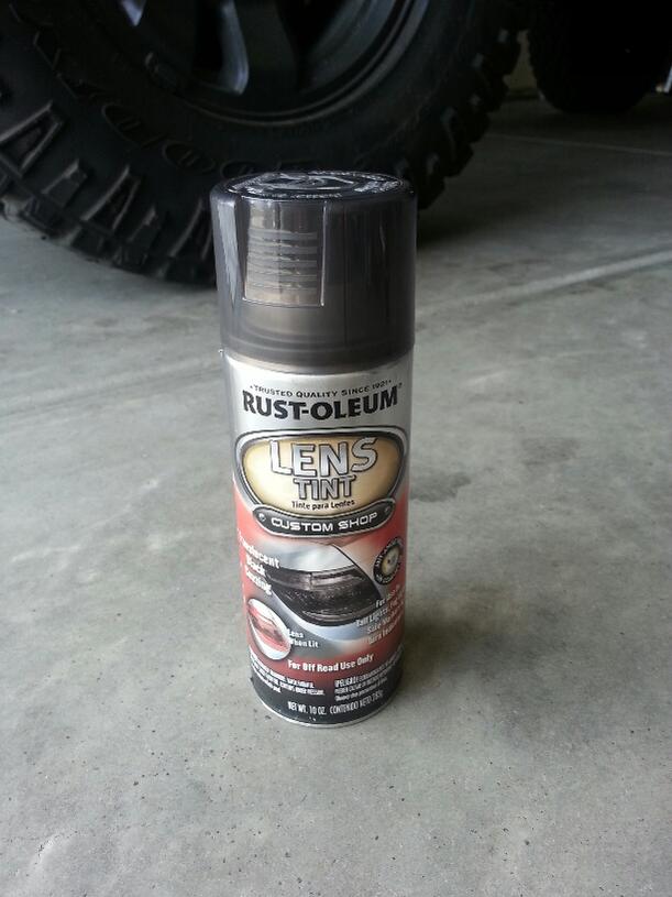

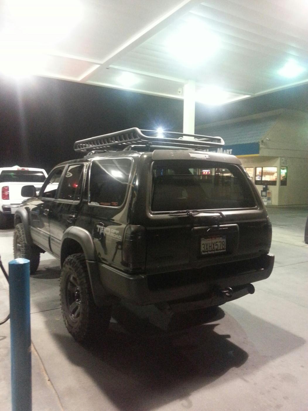

Those are just stock tail lights that I tinted, I plan on swapping out the reverse light bulbs, brake, and turn signals to LED's pretty soon... just to brighten things up a little more...
love the progress..
did you use rustoleum lens tint to tint all your lights and stuff>?
is it pretty permanent? did you have to sand the lights before you sprayed the tint? if so what grit?
Thanks man, really wish I had more progress though. Yes I used Rustoluem Lens tint, I got it at Home Depot for around $12 bucks a can, which is all you would need. I've tinted my tails, front blinkers and corners and still have plenty left over to do some of my buddys rigs. And no need to sand them down, but i guess you could, I'd suggest a really fine grit if anything. I just used a little soap & water, then wiped them down with a lent free cloth. The tint is permanent, but will come off with paint thinner/stripper, I know this because I went too dark on one of my tail lights and had to remove it and start over. really easy to do and really changed the look dramatically.
:tape2:Ha!:faint: There is definitely a learning curve on this site! *That 2nd pic is one of my new favorite photos! Thanks Sniv! I like your truck nice and dirty BTW, I always enjoy checking out your wheeling pics. Maybe someday it will rain and your Rig will be as clean as mine!! :rain: LOL...
lol my bad, i still dnt know how he got his tails like that
No worries bro! It's all good! Welcome to T4R.ORG -I did 3 light coats of tint spray, sort of just misted it on. Just remember how many passes you do of each light, so you don't get one darker/lighter than the other. I like to spray at least 1-2 feet away so it doesn't get too blotchy. I don't mind answering questions about things I've personally done myself. Good Luck with your build, look forward to see what you come up with. Cheers and Safe travels!
