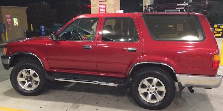

I decided to put a set of 4th gen 17" 4runner rims onto my '92, mainly so I could move the new tires/wheels forward at some point. I'm only putting on about 3k/year these days, but figure I'll be buying a newer 4runner at some point...even 5 years out would only be 15k into these tires.
They look nice, but it turns out the center caps don't fit over the auto-locking hubs in the front.

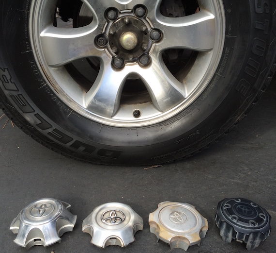

There's lots of Toyota's around here, so I've looked at a few different center caps. Turns out they are rim-diameter specific, so the ones I have from 16" ones and ones from my stock 15" rims are close, but not quite. And even from a different 17" 4runner wheel engage in a different way.
(in the pic, the 2nd from the left is for this rim, and the left is for a different style (TRD? from my neighbor). On the right is stock from my 15's, and the worn one is a spare from some 16's)
I'm thinking of modifying the worn ones I have from a 16", maybe with taking off the center and putting something cupped there, and then a gasket around it to tie it all together.
Any thoughts? What have others done? Or is there a good set of universal ones out there? I've seen a set of caps on a ~2004 tacoma that looked like they might flare out enough for it, but with the caps I've tried it looks like it really needs to be from a 17" rim to work completely right.

Um, take a hole saw to the middle of the center caps for the wheels that are on the truck so they fit. Then cut the face off another set of center caps with enough side depth that you can glue it over the existing caps.
But that's a damned lot of work, why not leave it like it is?

Maybe Tulip City Wheel will have a hubcentric adapter that will solve your problem? You'd need to have the ID/OD information and see if they have a hub adapter that works.
If it were me, I would make a simple chuck for my wood lathe and spin the center cap and cut out the logo part and make an offset piece and glue it back together.
That's what I was thinking, of modifying the worn 16" ones, cutting out the middle, but maybe bumping it out and then gluing the cut-out back on.
I see a couple ones in the sacramento craigslist where they just cut or popped out the middle on those 16" caps, so it is done.
