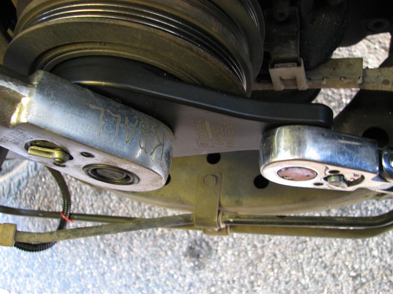

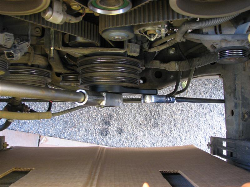

As far as holding the crank, I bought the official tool. It worked perfect as it should.
