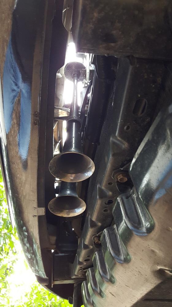

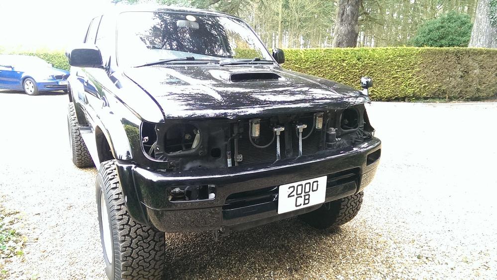

I had some Ebay "Truck" horns from Russia (suspiciously 12v though)
They are pretty long as you can see and make a decent noise without sounding too high pitched, as many air horns do...
Only video of sound I have is when sneaking up being the girlfriend and honking when she was refuelling... and if I post that on the internet i'll never hear the end of it....
Unfortunately I'm going to have to move these as want to add twin oil coolers, and a condenser fan :(
