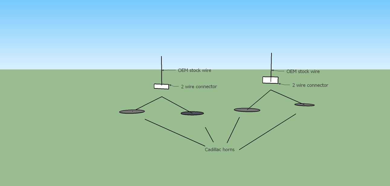

ok, the horns arrived today, the only thing I made was a harness for each OEM wire to attach 2 Cadillac horns in each as shown in the attached diagram. Everything was perfect, the sound is spectacular, it does not compare to the factory. Really I recommend this change. Locate the speakers behind the front grille. Tomorrow I will post photos.

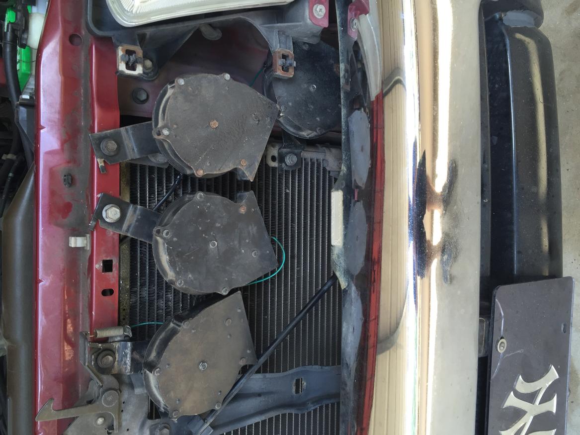

Cadillac horns location
the photos of the Cadillac horns (4 notes), located behind the 4Runner grill.
