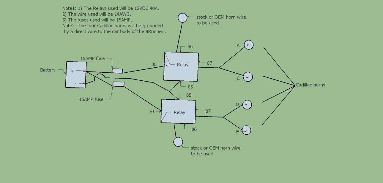

I want to replace the stock horns on my 1998 4Runner by 4 Cadillac horns (4 notes) using the stock connection. My question is, I need to perform some changes or only attach two Cadillac horns per each stock horn using an splitter in each out stock? I will appreciate your help. Thanks

You might need more power going to the horns then what is provided by the stock wires. Either just run 2 or consider rewiring with a larger wire.

Running that many, wiring it up to a relay and getting your power directly from the battery probably wouldn't be a bad idea. Super simple to do with a diagram like this:

Thanks, Twan! I have two more questions,
1) the cables that connect my actual 4runner horns (the stock wires to horn) will be connected to the Relay 86 input (as per your diagram)?
2) Is necessary run another cable from the Relay 87 output to the other 2 cadillac horns or I could split one cable in 4 way?
Thanks for your response.
Yes to both. You just need the signal from your stock horn wiring at terminal 86 to tell the relay to send power to terminal 87. There shouldn't be a problem running four wires from that one connector, since probably the hardest part would be fitting four twisted wires into one spade connector.

Thank you, thank you, thank you! Could you let me know which wire or cable #10, #12, or #14 I should use?

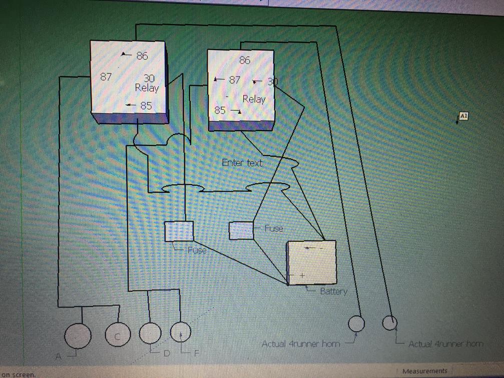

This is my other option
This is my other option, someone can tell me if it possible? Sorry for my poor diagram.
Thanks,

My diagram of Cadillac 4notes horns
I hope this diagram can help someone.
