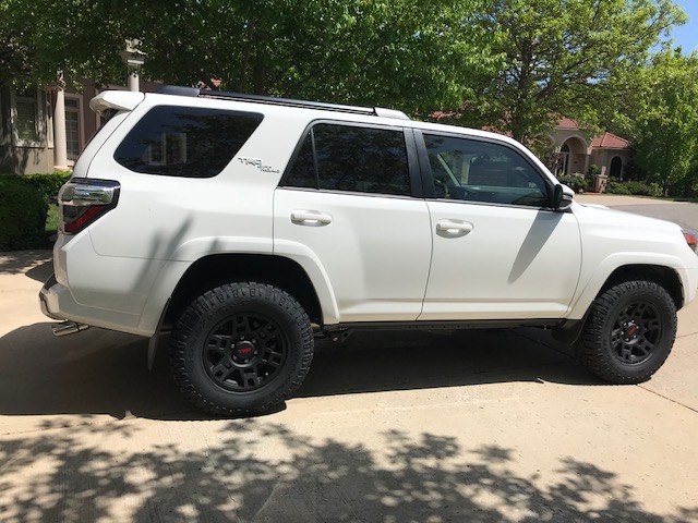

Swapped stock wheels and tires for a set of black TRD wheels and Goodyear DuraTrac 255/75/17's
