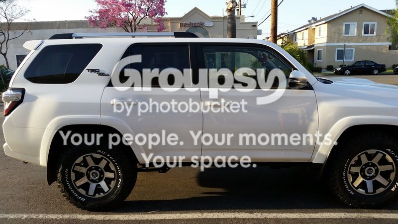

Yea I feel you. I was looking high and low for photos of white 4runners on 275s without a lift.
Awesome! That looks great.

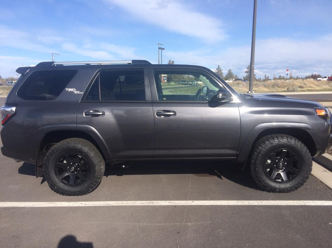

I ended up getting 5 Terra Grapplers g2 in 265. They look good. I'm happy with the size. I've driven them for 1.6 miles so not much to say :bolt:
Next are coilovers. There's this one from Icon but I don't know if it's too much for my once in a while off-roading necessities.
2010 - Current 4Runner Front Coilover Shock Kit - ICON Vehicle Dynamics
Any and all advice is welcome.
