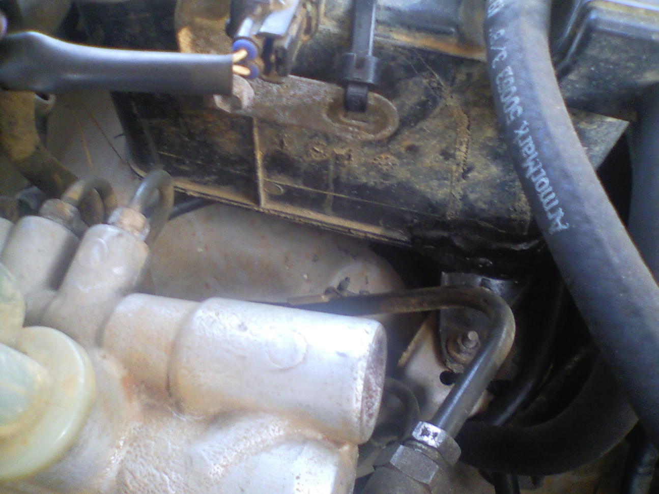

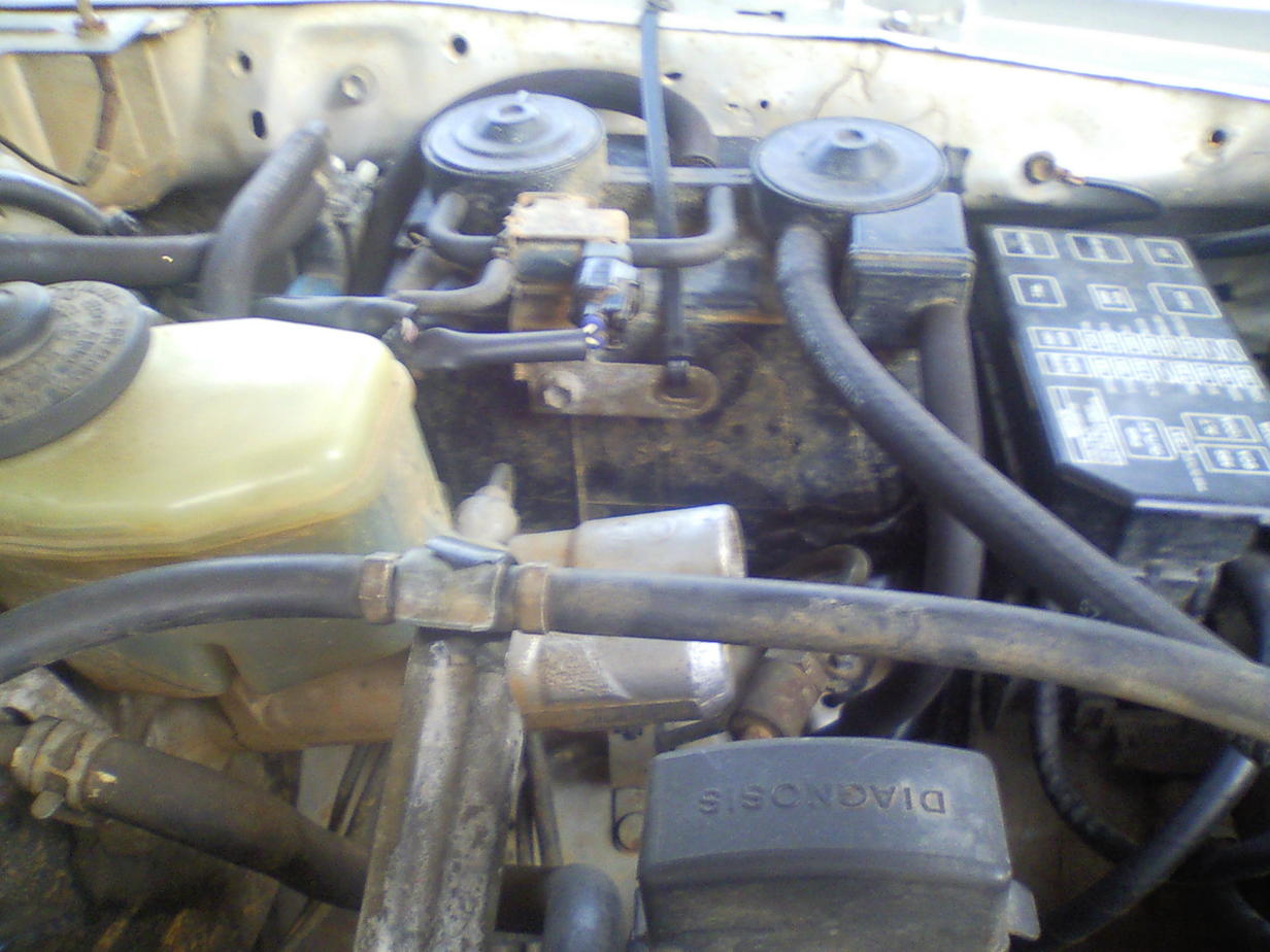

The corner broke off of mine where the bracket bolts to the fender. I JB welded the parts back to together and then used 2 coats of liquid electical electrical tape to seal is up. It is temp fix until I can round up another CC for mine. I did this 6 months ago and still no CEL.
