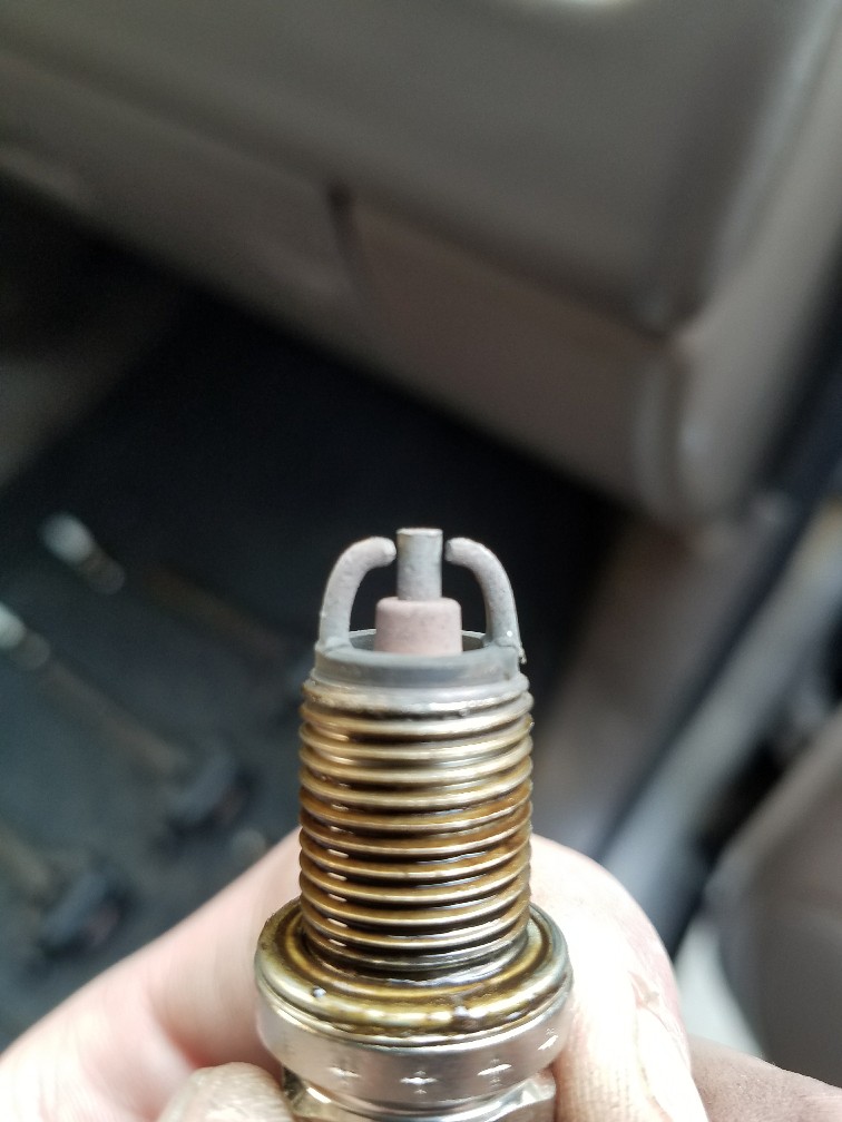

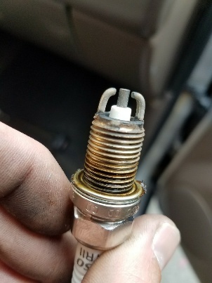

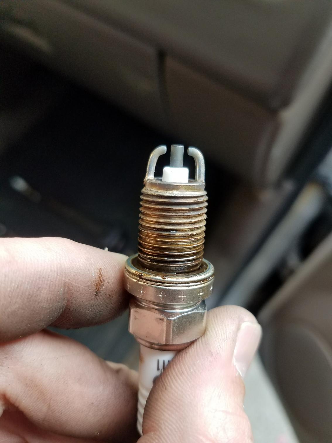

Spark plug 6 definately looks like it has endured a misfire...
Photos are plugs 2,4, and 6.
Plugs 1,3,and 5 look like 2 and 4.
Still getting same 3 codes. To be fair I didn't change plugs when I did injectors. Should I change plug 6 due to the corrosion?
where do I go from here?

Gotcha. The leak down test would show the engine’s ability to hold air. You may have one or two bad exhaust valves but can’t say from here since you have covered almost everything else and that plug doesn’t look too happy.
How did the plug from #3 look?

Plugs on 3 is the same as 2 and 4 in the photos above. My theory is cylinder 6 is obviously misfiring and the ecu knows it but since coil 3 ignites cylinder 6, the ecu is trying to adjust the ignite causing the p0303 code. I'm changing plugs today again with OEM now that new injectors are in since I didn't do that when I put new injectors. I'm hoping the plug is so wrecked it's still causing a misfire and changing it will correct things.
