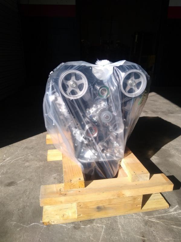

So Yota 1 is building the motor for me...as I don't have time or care to take that part on. They are back logged with Covid and holidays. So motor sounds like it won't be till mid February at this point. I have till mid January to let them know if I want the motor built to better accommodate forced induction. So if someone has a deal on a SC let me know!

Update on my end...I think I'm two weeks out from picking up my motor!! Pretty tired of the under load vibes and the 10mpg.

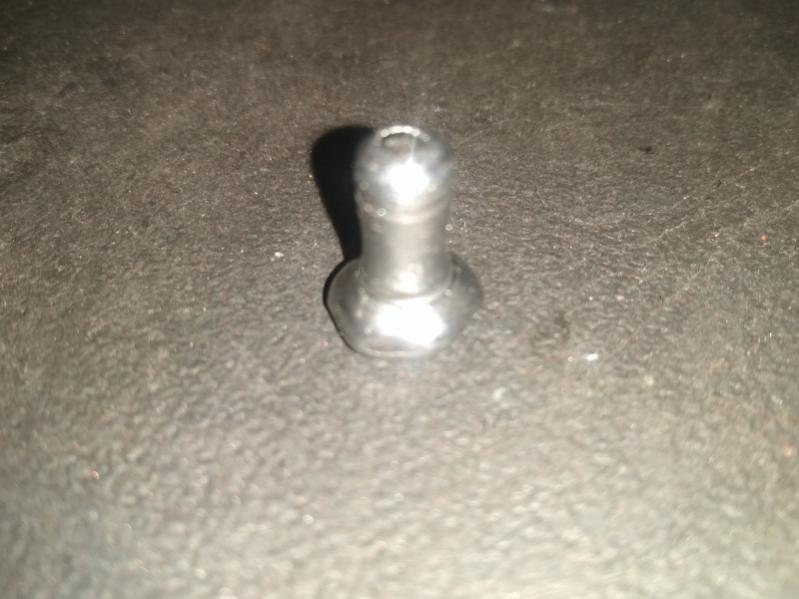

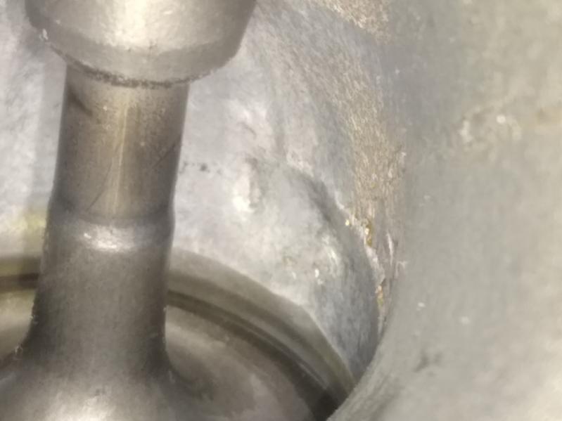

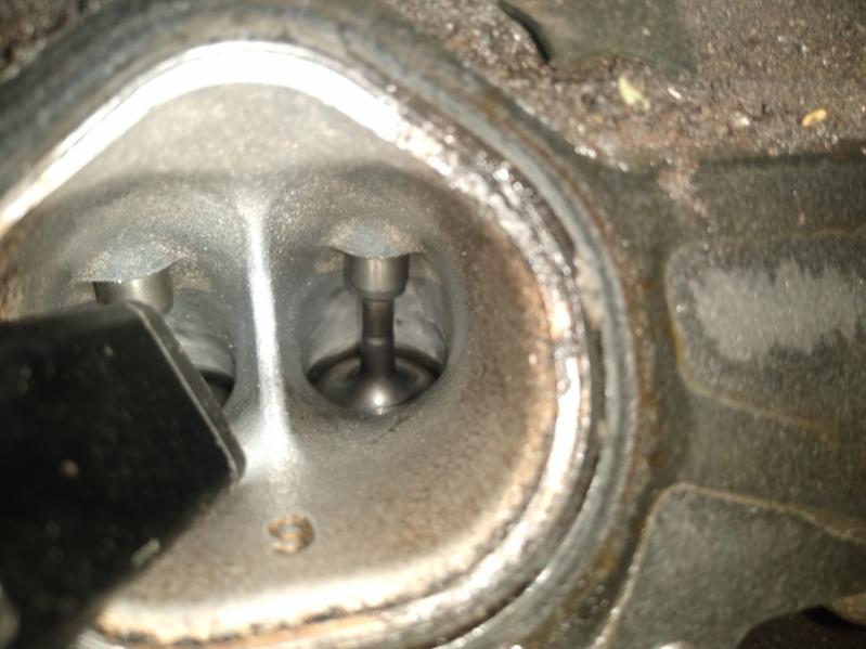

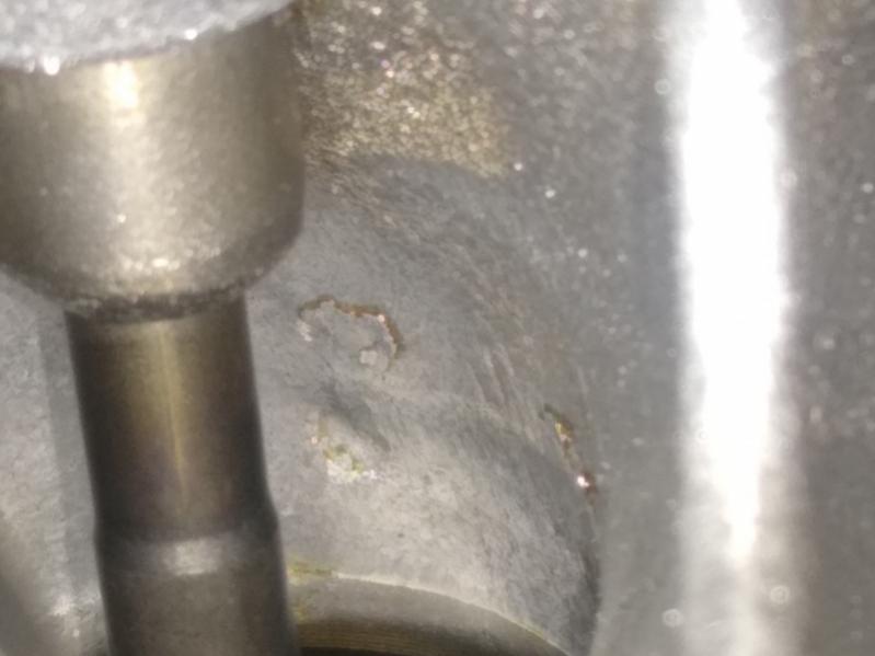

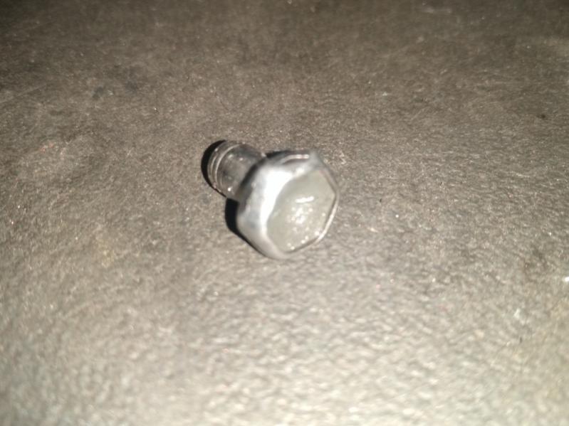

Alright folks. It's back up and running. Due to time and work constraints along with only having 1 vehicle I had Yota1 do the install. Here is what they found...a random bolt in my in cylinder 6 intake valves. No one knows how it got there or where it's from. Obviously it dropped in at some point. I hadn't had the intake open to do any recent work prior to this whole issue starting so I cant think of how or when something would have dropped in. The motor always had a valve tick over cylinder 6 since I acquired the vehicle out right from the in laws...so idk if it had been there for years before causing this issue. But either way I'm happy to say I'm back on the road! Yota1 was great to work with and communicated well through the process. And I'm currently typing this from my phone pulled over on the freeway doing my 30 minutes on 30 minutes off break in drive...
Just a reminder... cover the intake manifolds!
