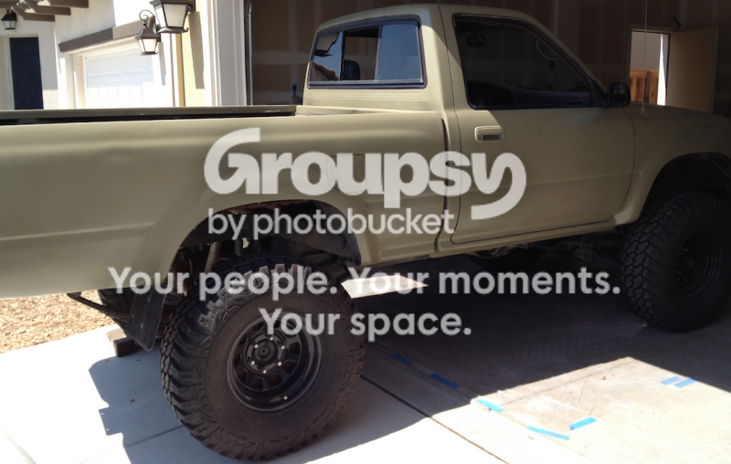

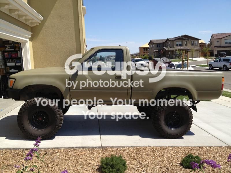

I guess my point for "cheap paint prep" was more around using 400 grit with tack cloth and acetone.
While certainly not perfect, I got decent results that were quite durable from what I listed above:

1) your pickup looks bad@ss
2) we can disagree - its cool
3) I still think that while your satin tan paint looks fine from the pics you posted, gloss green or gloss black from a rattle can will not look that great
4) I don't understand the watered down comment, especially since it is oil paint
