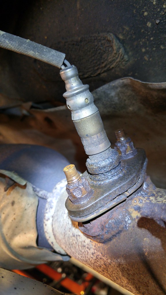

I thought maybe it was rusted/corroded through and moisture might be getting in on the o2 sensor, but I don't see any exhaust leaking from this area at all..[picture is pre-replacement..]

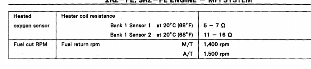

I checked the resistance of the heater circuit of the new O2 sensor, and that was within spec, so I moved onto checking the ECM...but its kind of confusing, to me anyway.
So, per the FSM, can only be two more things to check....bad connection in the harness, or a bad ECM.

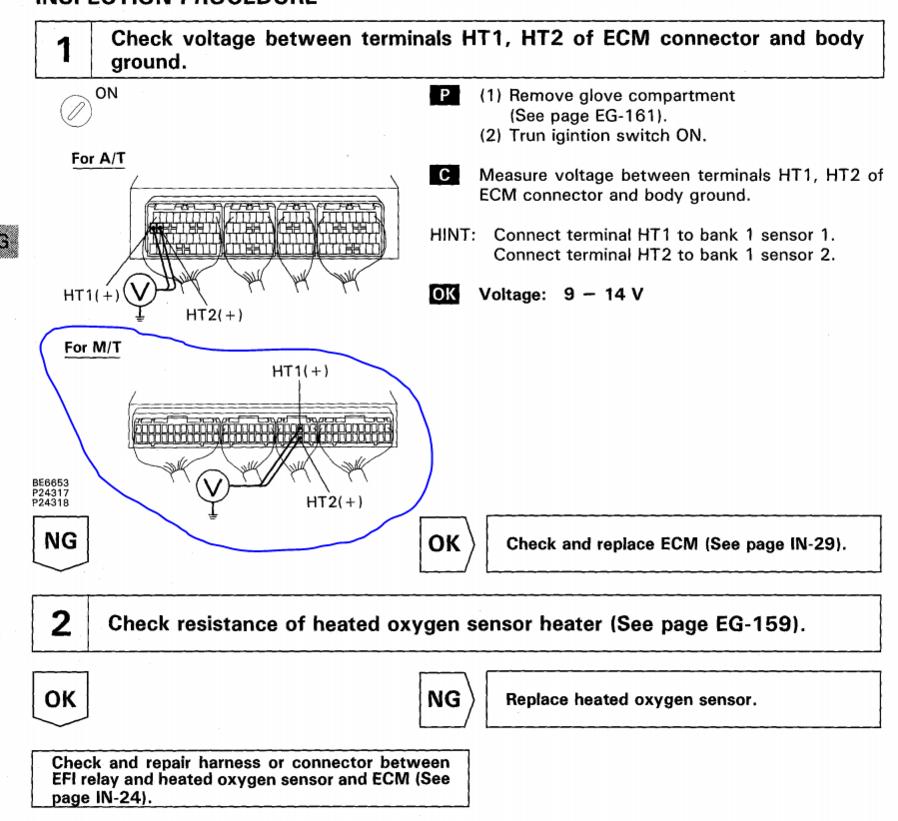

When checking the ECM, do I leave the connector attached (plugged into the ECM)? I think I read in the FSM to leave the connectors plugged in. Or do I unplug it and test the ECM connectors? Does it matter? Do I touch the red connector of my volt meter to 'HT2' and the black connector to a body ground....for sensor 2? I don't have a fancy data logger, so I can't see whats going on in real time, but the trouble shooting steps seem pretty straight forward. The code comes back at the same point in my commute drive everyday.
Also, is there a way to see what the O2 sensor heater current is when the heater is operating? Guess I'd need a nice scanner for that.
Finally, the FSM states that the voltage is 'OK' at 9-14V when testing the ECM, but if it checks 'OK', to replace the ECM. Am I reading that right? Seems odd.....nothing is 'OK' if the ECM needs to be replaced.

Yes you check it with the connector connected to the ecu, you are basically checking that you are getting power from the efi relay through the sensor to the ecu. yes the red lead goes to the ht2 and the black to body ground. if you do it backwards you'll just get a negative voltage reading. the check engine light comes on at the same point in your commute due to the drive cycle meeting the criteria needed for the ecu to run monitor.

So I checked the ECM, get 0 volts from the bank 2 connector with the key on. According to the FSM, that is acceptable and the ECM should be operating properly.
To add to my confusion, I checked the bank 1 connector, and got 12 volts, which points to an ECM malfunction, but I'm not getting a P0135 (front O2 issue) code.
Am I looking at the FSM wrong? I would think that 9-14 volts output with the key on would be the correct operation? With the key on, shouldn't voltage be sent by the ECM to the O2 heater? With the key on, I get 12 volts from the front O2 heater connection and 0 volts from the rear O2 heater connection (at the ECM).
Also checked voltage at the connectors with the engine on....get 0.24 volts for the front O2 and still 0 volts for the rear O2.
Rechecked the resistance at the rear O2 again, and that is within spec.

All of this is leading me to believe the ECM is faulty.....thoughts?

Only three repair options for this, per the FSM.
I replaced the O2 and checked the heater circuit resistance....all good.
I'm getting no voltage out of the ECM rear sensor heater circuit with the key on (also no voltage with the engine running) but get 12 V out of the ECM to the front circuit when the key is on (not running)....which makes me believe the ECM is bad, but I'm confused by the FSM wording. Also, when searching on this site, most mention that the ECM very rarely fails...adding pause to replacing the ECM, but I'm not sure of the accuracy of that statement.

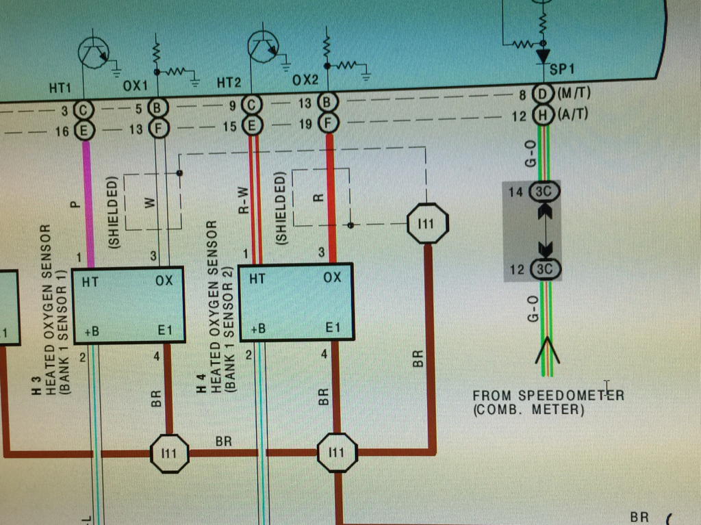

Does anyone have the ECM pin schematics for all the 3rd gen (with manual trans) years?
thinking about trying a new ECM, however I know that there are wiring changes between some years, but do not know the extent. Wondering if a 1997 or 1998 ECM would work on my 1996. Doubtful, but not sure.

What FSM are you using to trouble shoot? Your 96 is a narrow band sensor.
Pull your o2 sensor apart and look for corrosion in the wiring. I have a 97 wiring book and thanks to Durk a 97 wiring PDF as well. I'll take a gander at work this evening.

Huh? On mine, the ECM connection gives ground, and the 12V+ comes in on the other leg straight from the fuse.
2nd question. Are you still connected at the ECM end when you tried whatever you tried? Because that sounds like a short through the ECM to me (ungood).

With engine running you should be able to probe the back side of the HT2 pin (red with white) If you read 12v it looks like the transistor that provides the ground to energize the heater circuit is burned open.
If instead you read 0v pull the sensor connector off and look for 12v on the B+ terminal (white with blue). Also try and measure continuity between the HT pin in the sensor connector and the HT2 pin of the ECU.
If you have something in between like 5v there is some sort of path to ground and your reading the voltage drop across the heater element.
If you indeed have a bad transistor in the ECU you could wire a relay up that will be energized when the EFI relay is energized and ground the HT wire through the relay you installed. Extract the wire from the ECU connector.
I'm still looking at things but this is a start.
Edit. If they are measuring heater element amps in a 96 ECU to determine proper heater operation rather than the typical how long it takes till a valid sensor signal is present then that 96 ECU is pretty advanced for that area.
