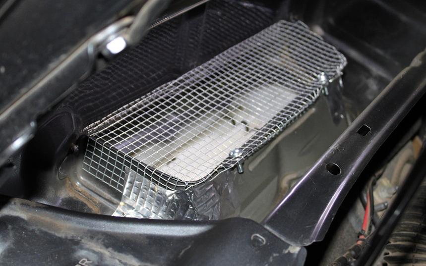

Do the screen, its the only way to keep them out.
I finally did it, now I am wondering about the rear vents in the sides, under the bumper side cover. That looks like a determined rodent could make short work of...2 little rubber flaps.

Thats a clean fix. I haven't checked mine in a while now that I am reminded. Hope it doesn't look anything like OP's
