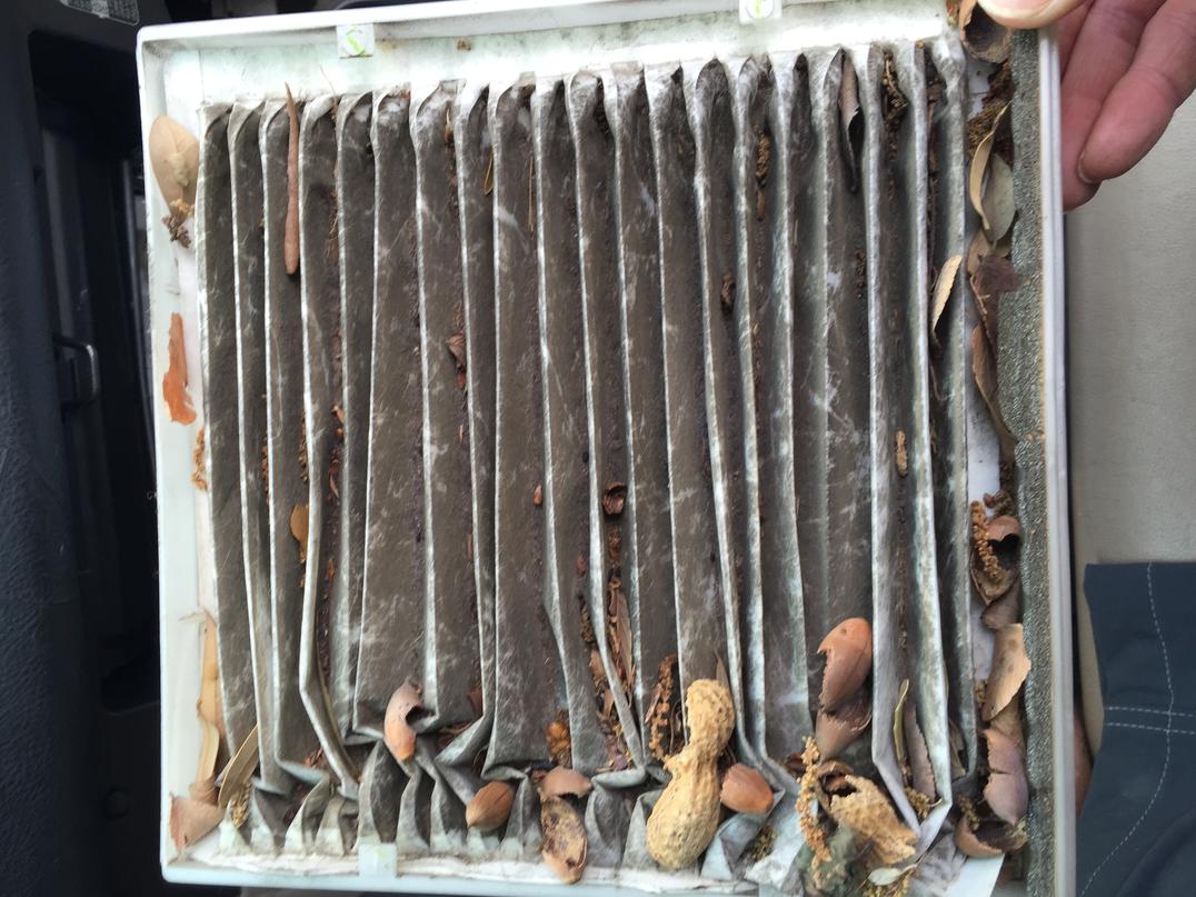

This past weekend I dropped the glove box to check the cabin air filter and found this....wtf! Somehow the little basturds (mice) have be gaining access to the filter and having a field day. No damage to the engine bay, wiring or passenger foot well, they just seem to enjoy sitting on top of the filter and eating seeds. I have ordered a new filter....any ideas on how to prevent this from happening again? :rant:
I cannot sleep, I woke up having a bad dream about that picture of that air filter. :) only kidding. Hope you get it cleaned out.
Peanuts???? Ugh!!

You have to remove the plastic cowl that is just below the windshield. You have to remove the wiper arms to get it off. You will find the fresh air intake on the passenger side. Cover it with wire mesh like the prior poster did. Do a search on this issue, there are several posts with pics.
Thanks for making it clear where it is,man that sure seems like a lot of work to fix something that Toyota should have known could happen, and had it taken care of in their Design and Engineering.

Dude, i found a family of dead baby mice in mine. The amount of dry-heaving swearing and bleaching was high. ended up taking the blower motor out and cleaning it. Then shop vac all of the vents. This was 6 months ago. IM STILL PISSED

Found that mice were eating nuts on top of my filter too. Hopefully the gutter guard installed over the fresh air vent will stop them.
