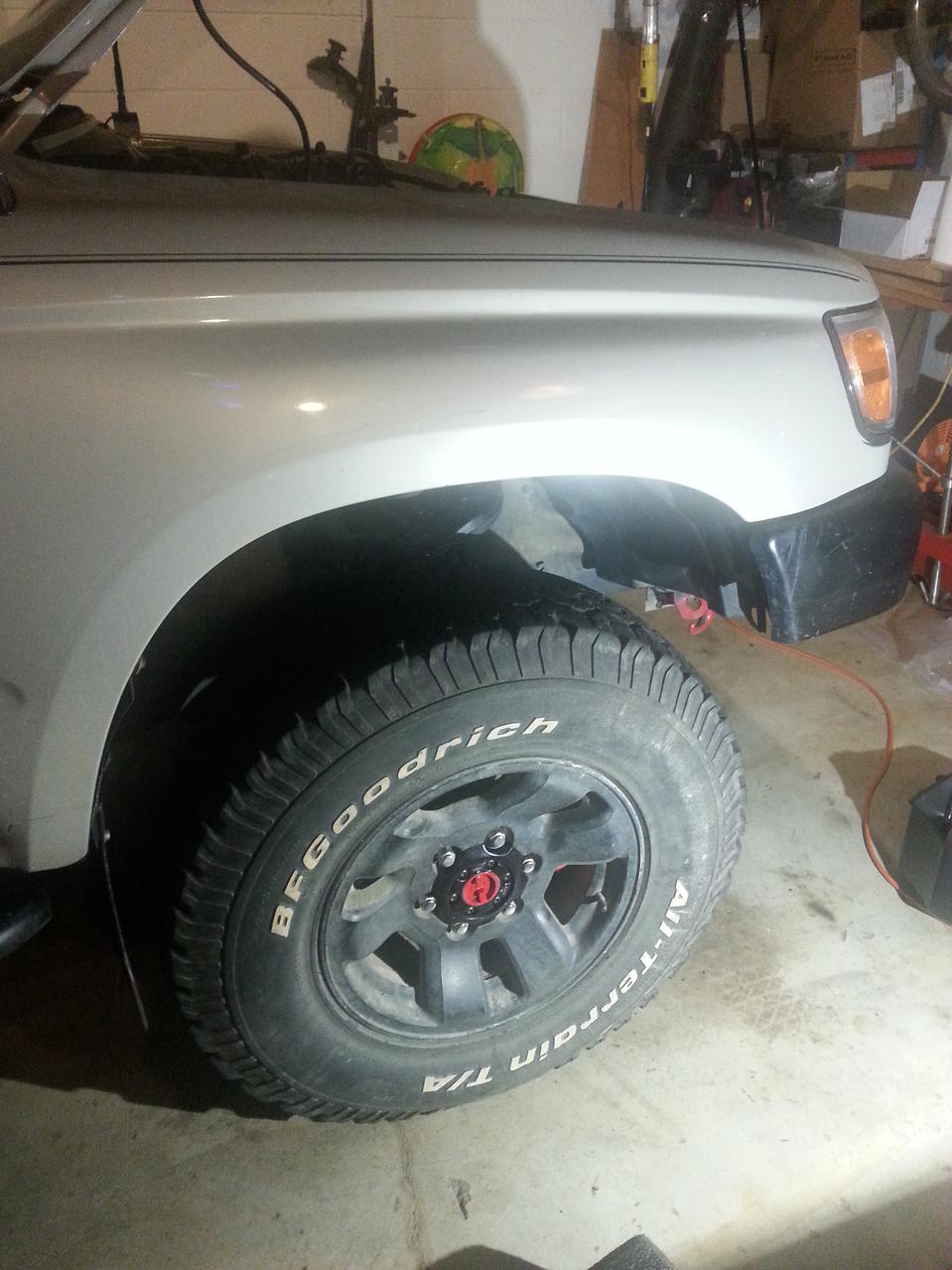

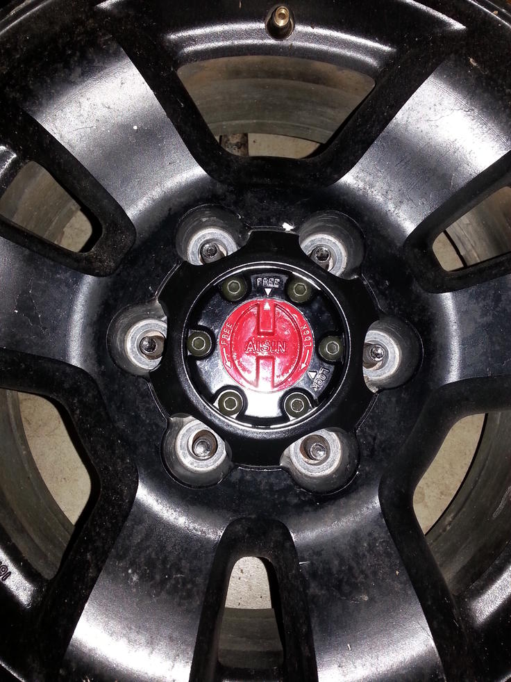

I just had to pull out one of my spare wheels to see how it's going to look haha

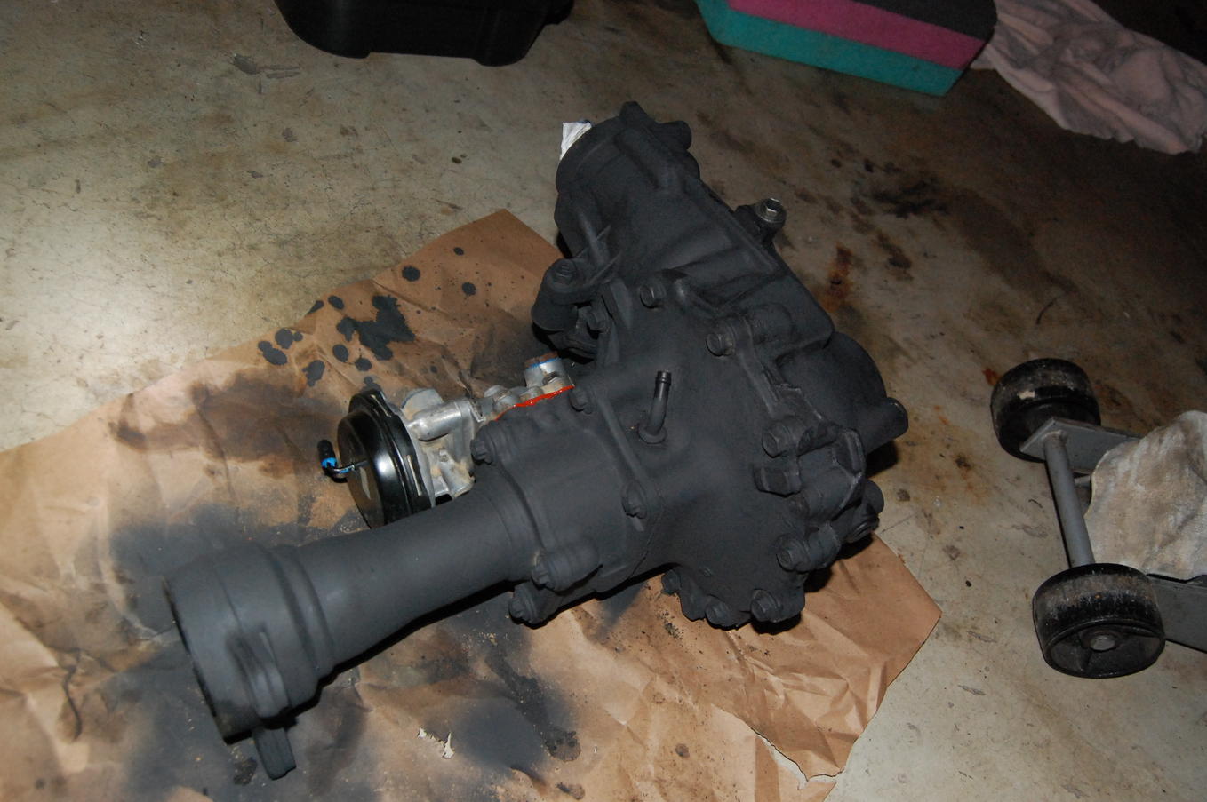

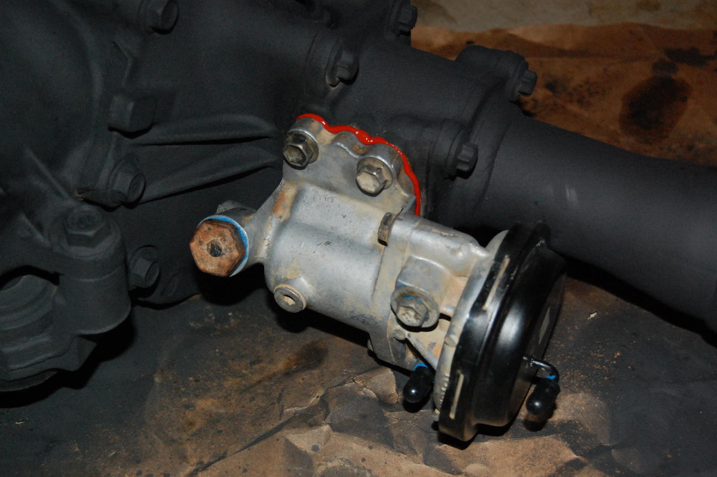

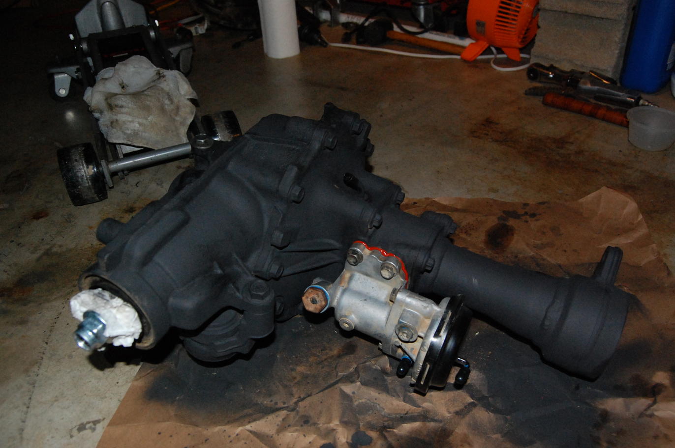

I guess I'll start with the differential...

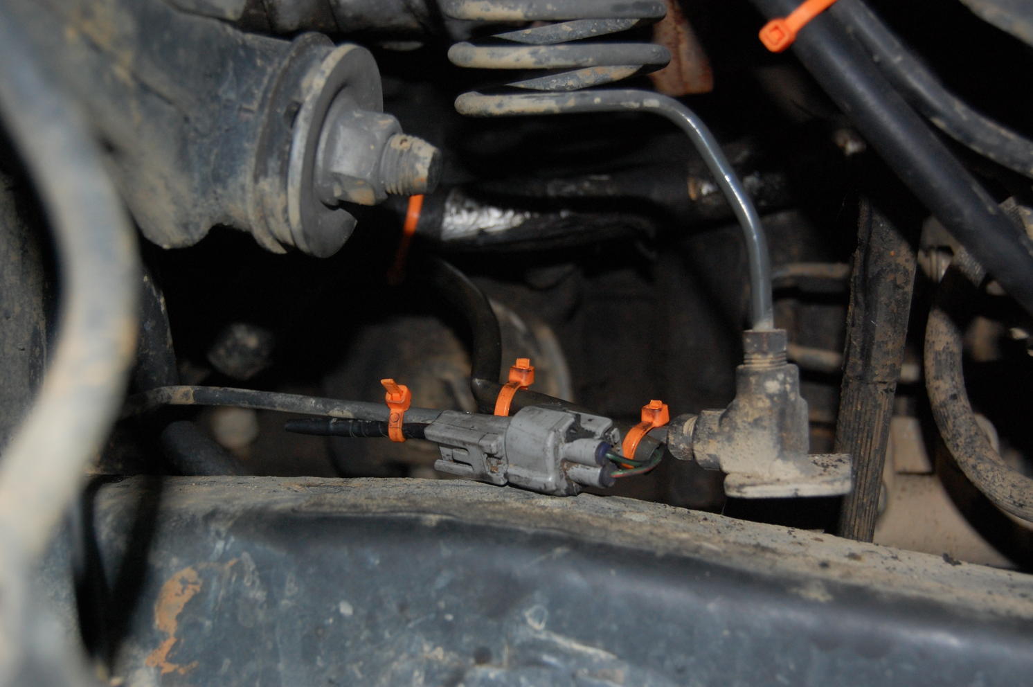

I cleaned the actuator, clamped the sliding fork in place, removed the switch, plugged the air lines, and sealed it back up.
Here is the pigtail that used to go to the diff switch. I simply soldered the two wires together and zip tied it out of the way. The 4WD light works when I pull the lever now!

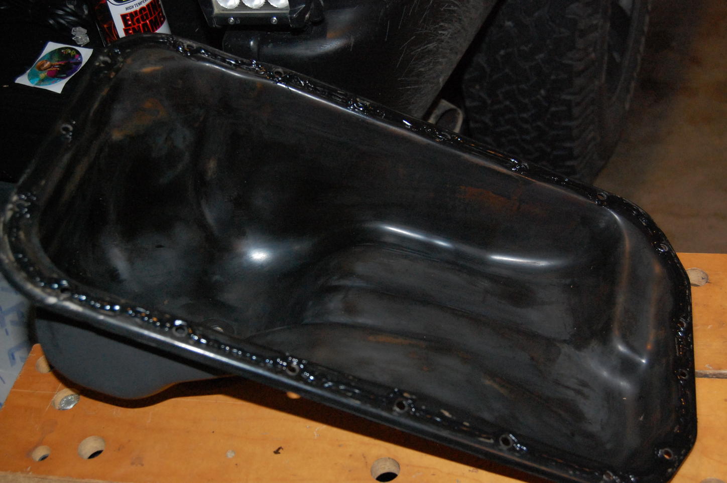

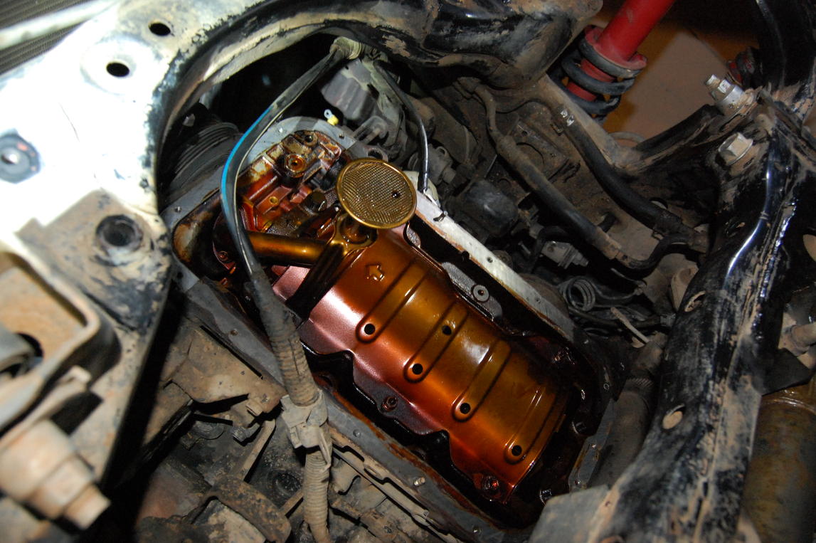

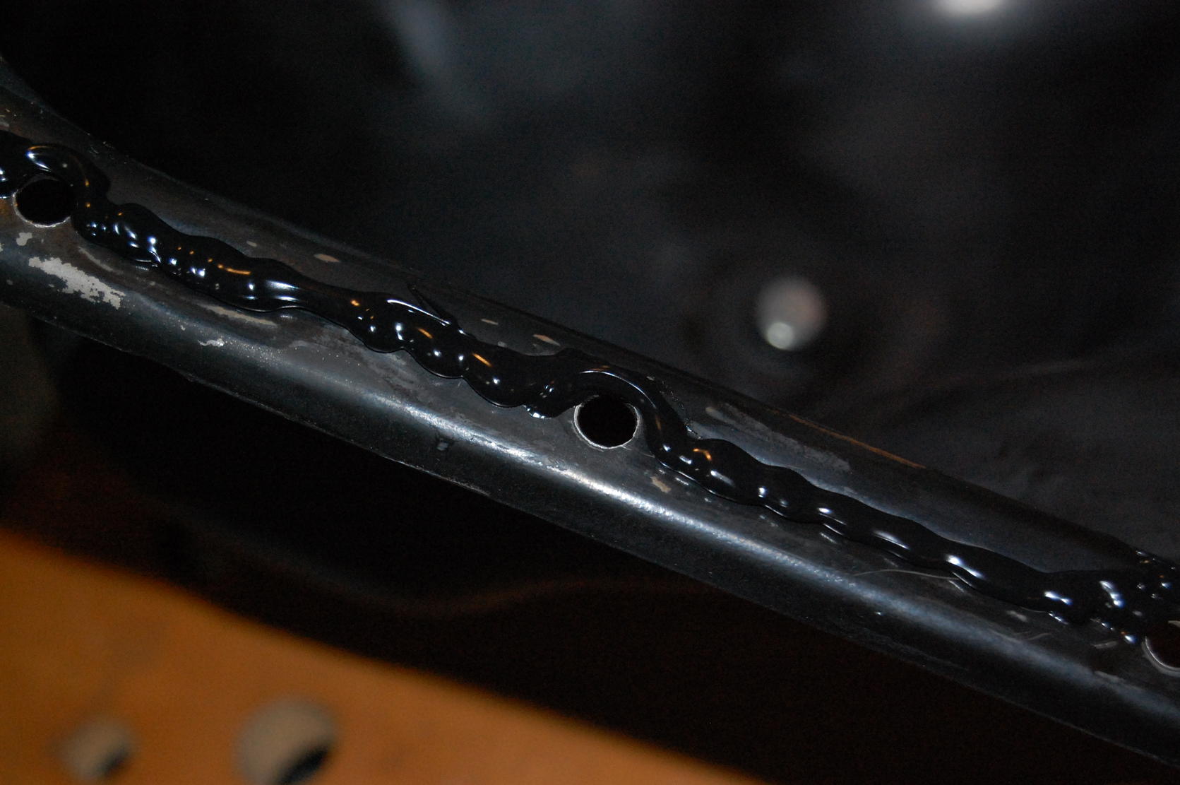

Oil pan

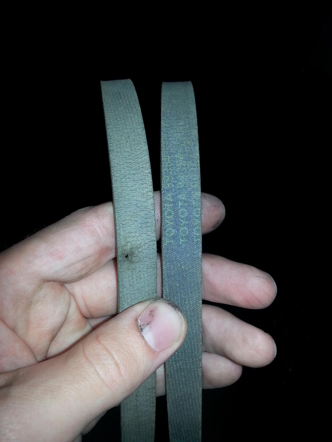

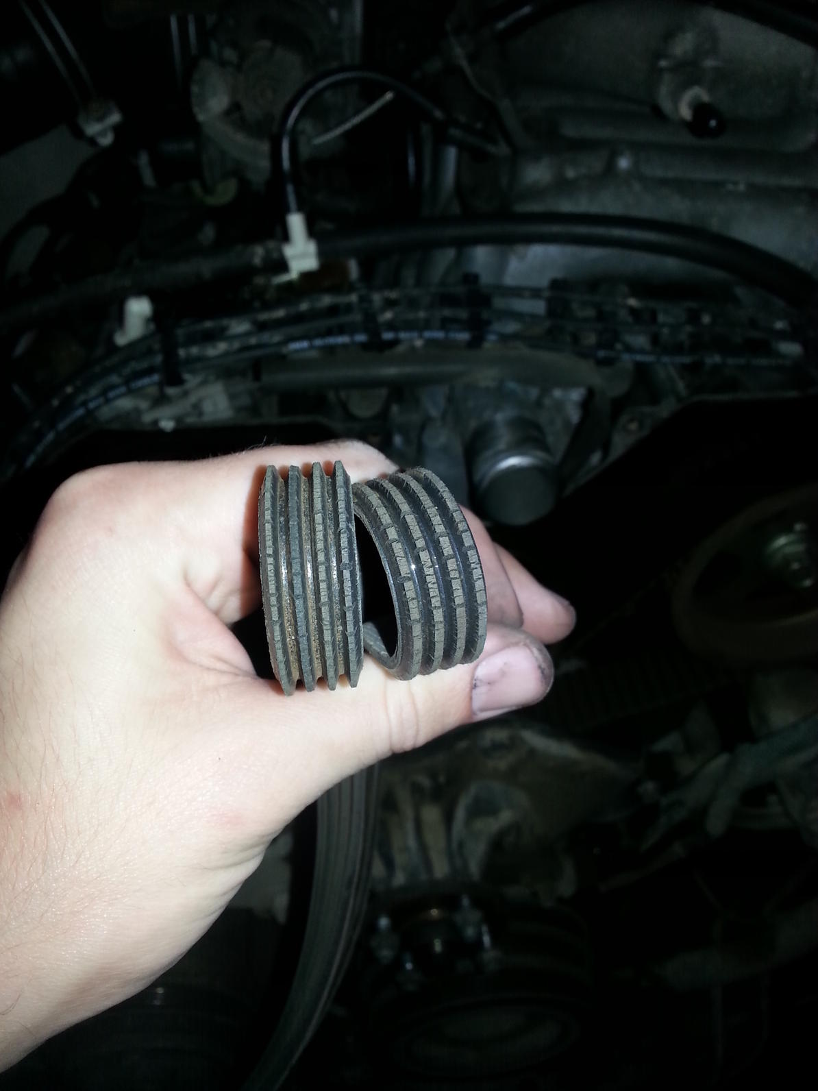

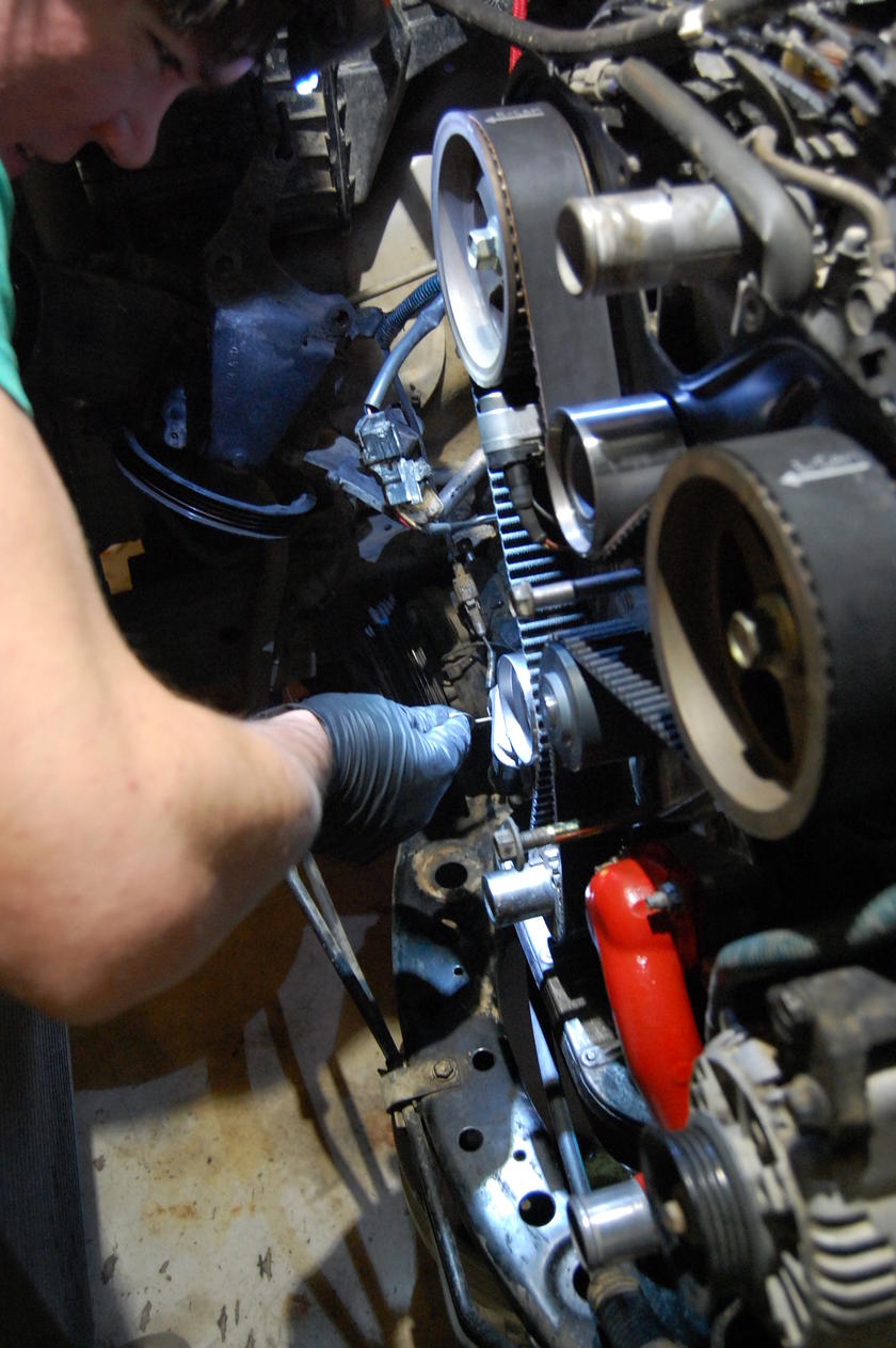

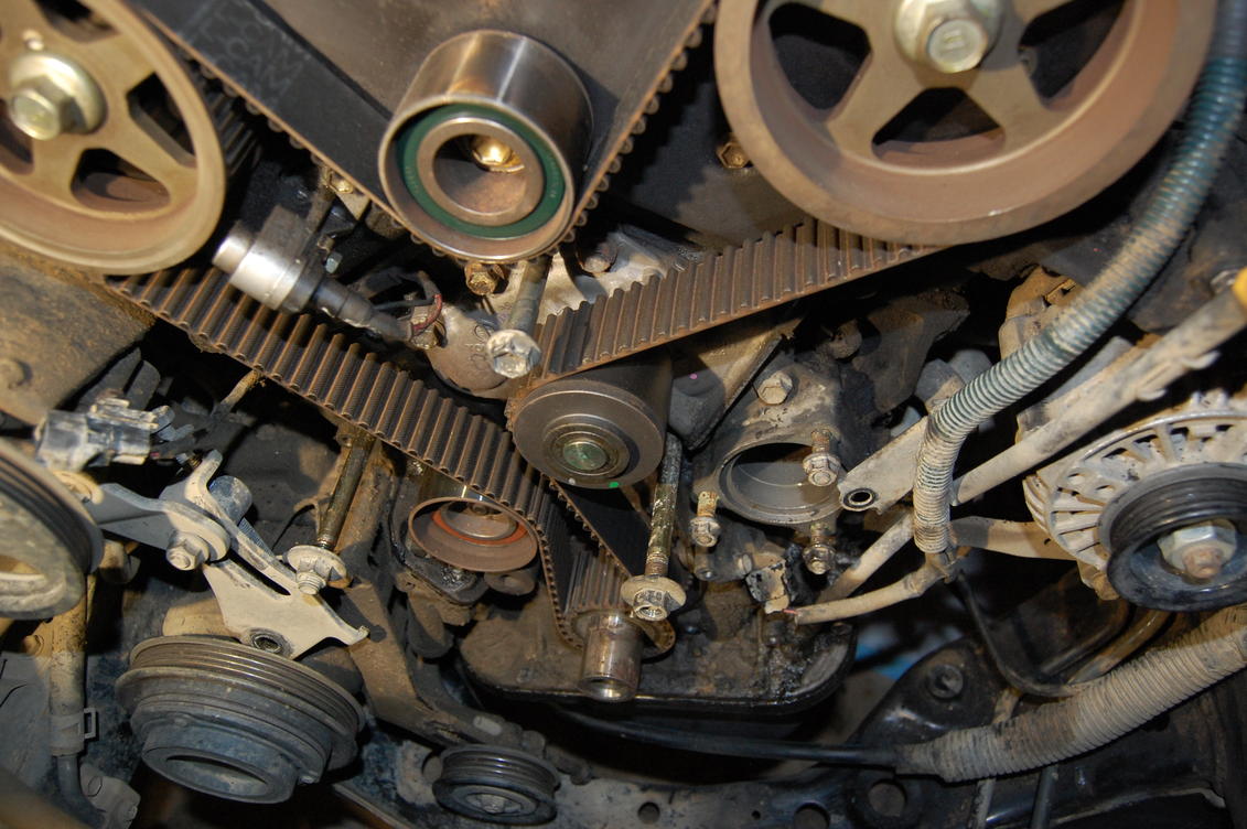

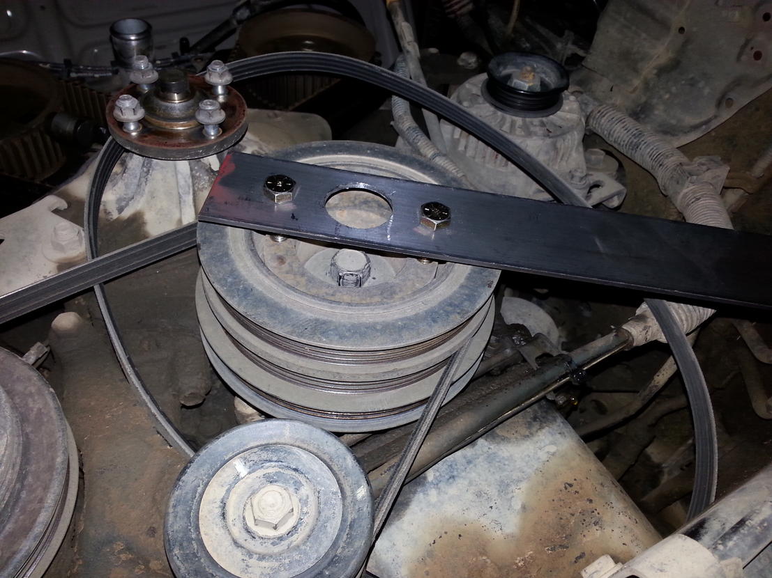

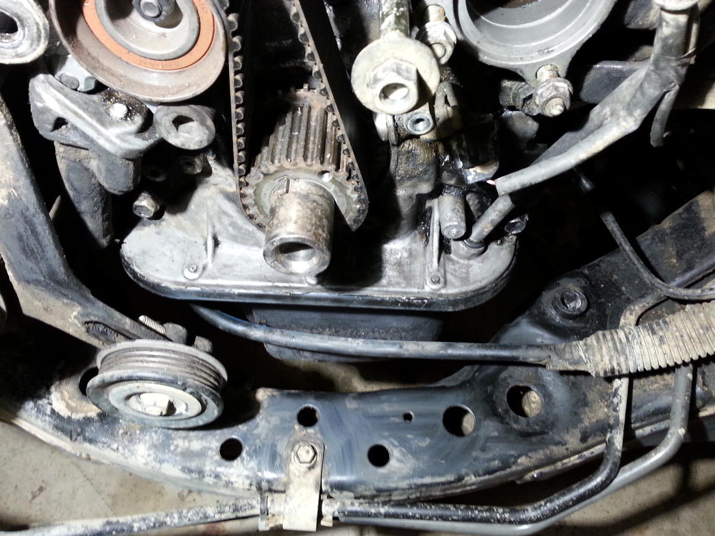

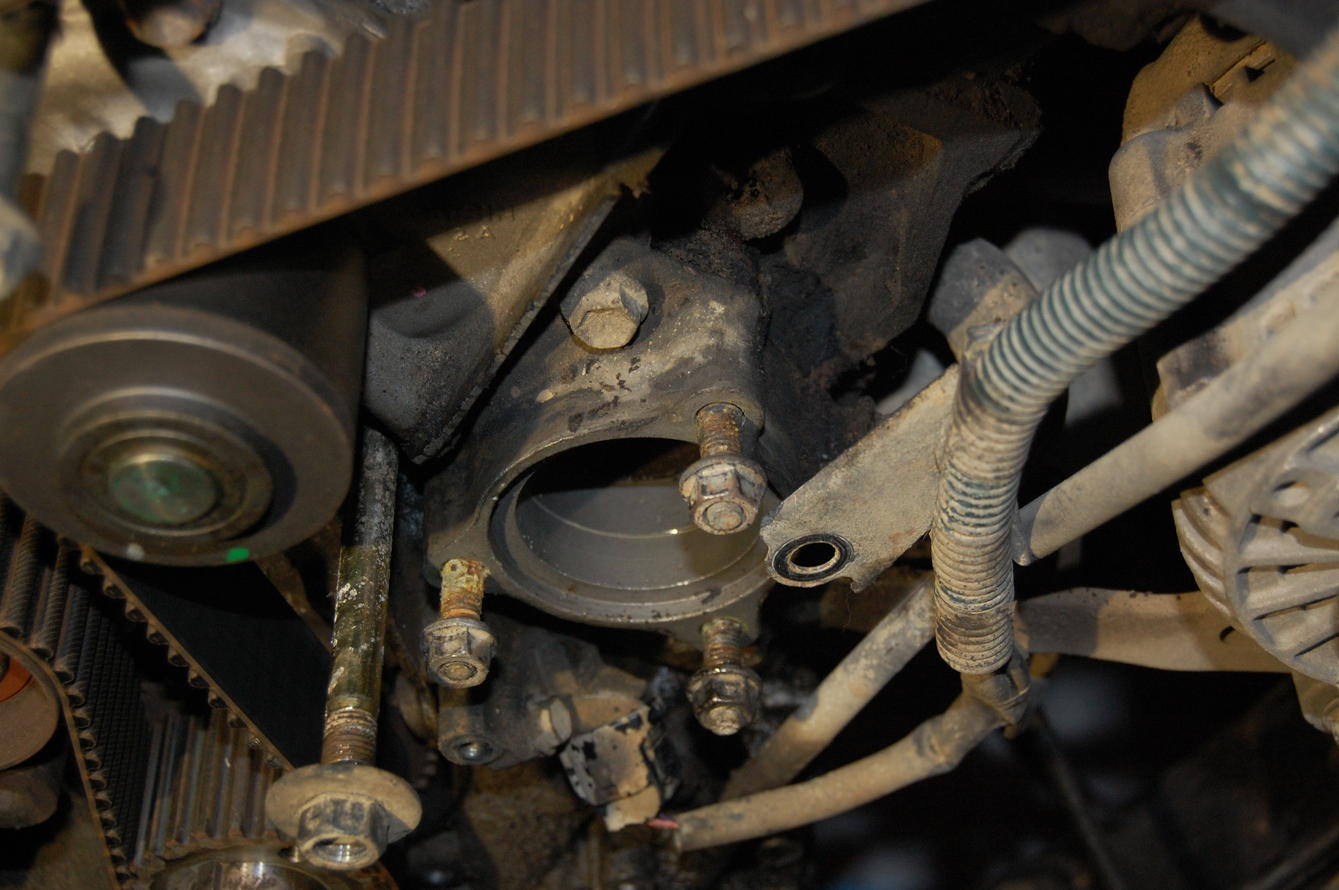

Timing Belt
Partially torn apart
Cranshaft pulley tool I made
Old belts- possibly original, notice the hole in one of them

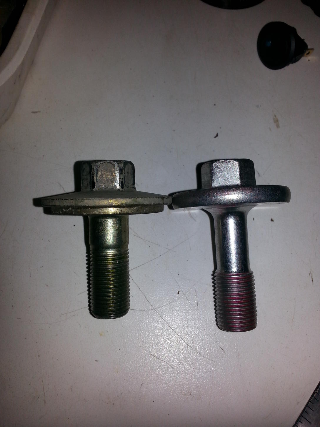

4-cyl vs. V6 pulley bolt. I somehow ordered the wrong one, but it was on the V6 parts sheet. I have the correct one now.

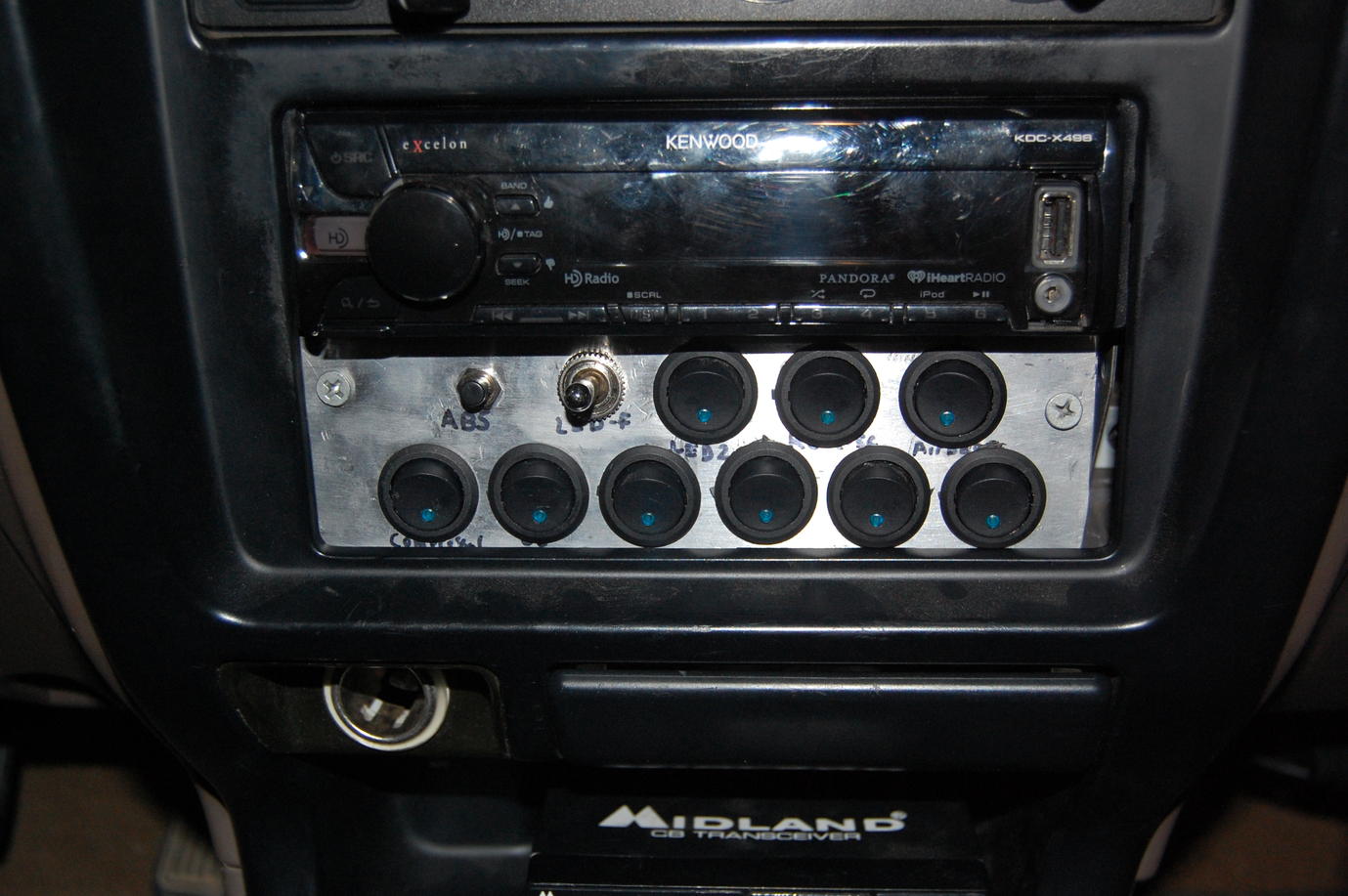

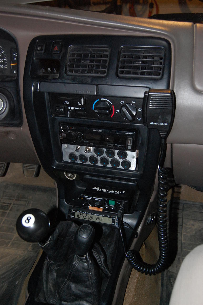

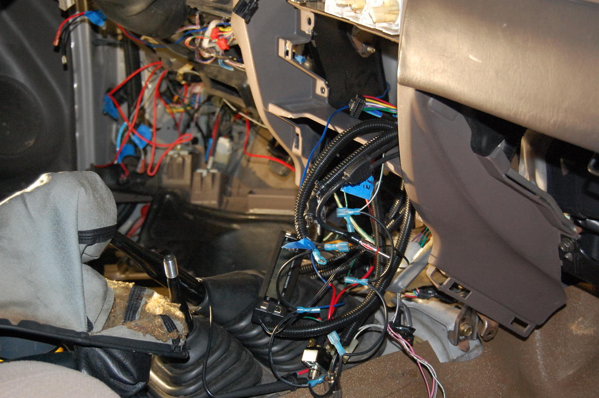

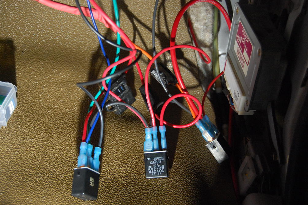

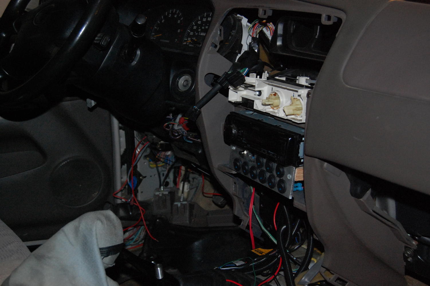

Switch Panel
The wiring guy himself!
My 3 relays in the passenger kick panel
It's not pretty, but it gets the job done! 3 switches are unused

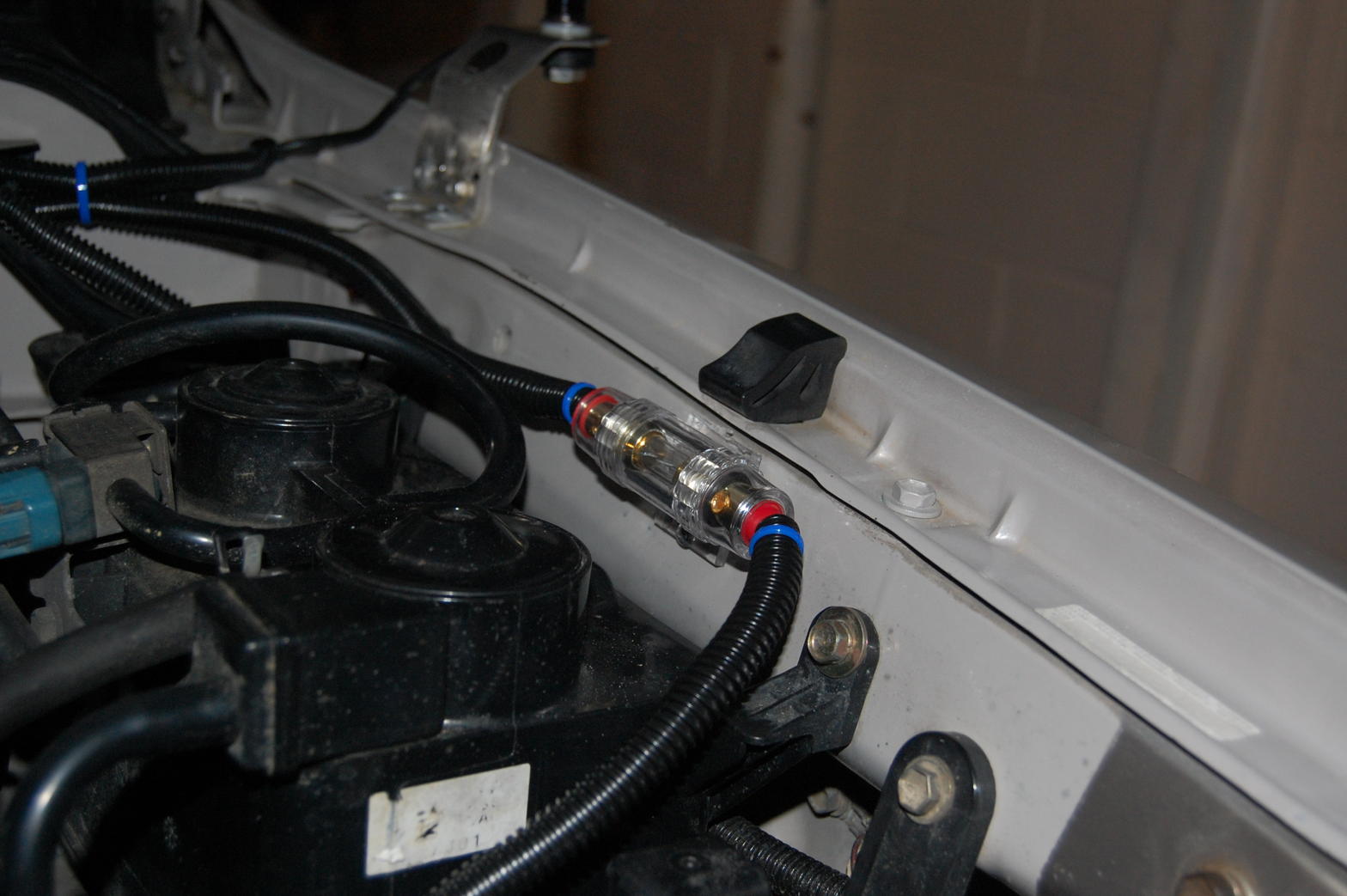

My fancy fuse holder

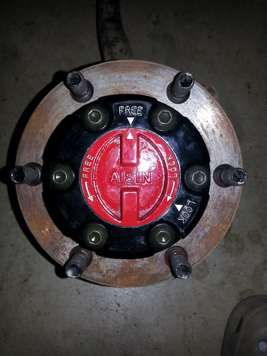

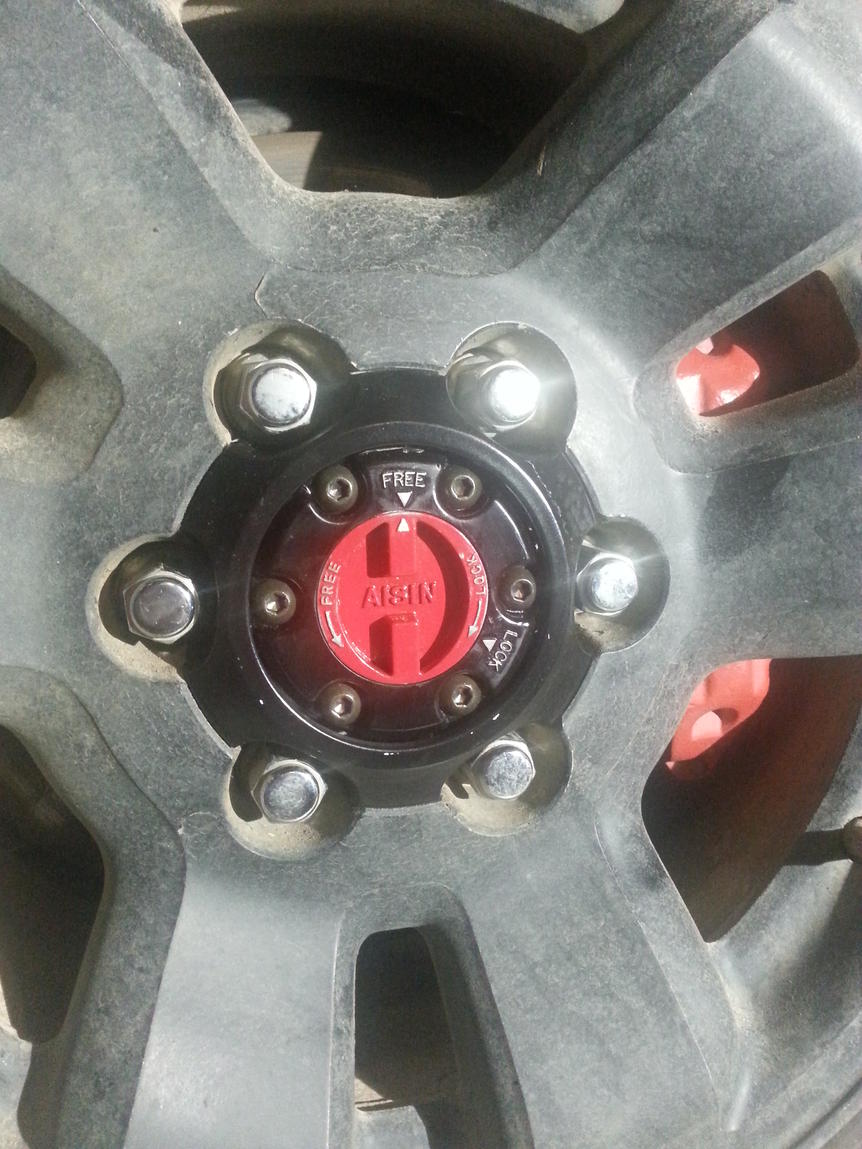

Hubs!

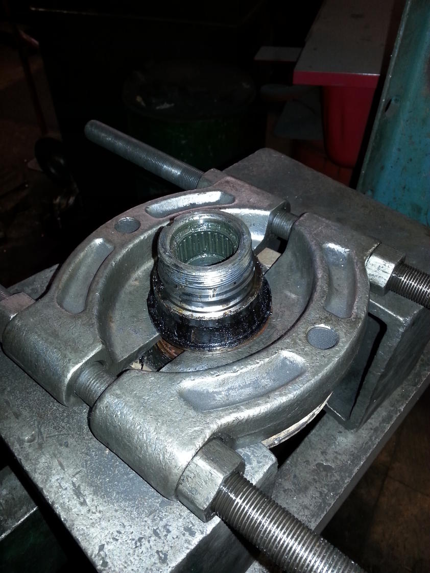

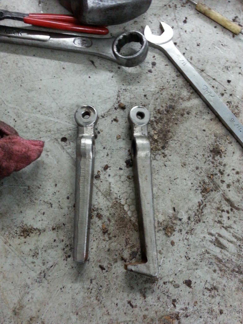

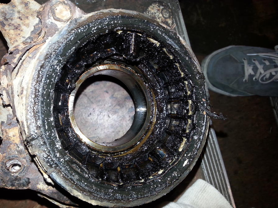

The first time I got mu hubs pressed out, I went to my mechanic guy. He was a scout leader in my troop for a loooong time. Well, he should have told me to take them to a machine shop with a real press for this kind of stuff. It would up costing me $150. I still had one hub to be pressed out and pressed into the 4Runner spindle.
Broken professional puller
The guy at Carquest in Nashville charged me $25 to do it
Nasty bearing- took a 20 ton press (10 ton didn't do it)

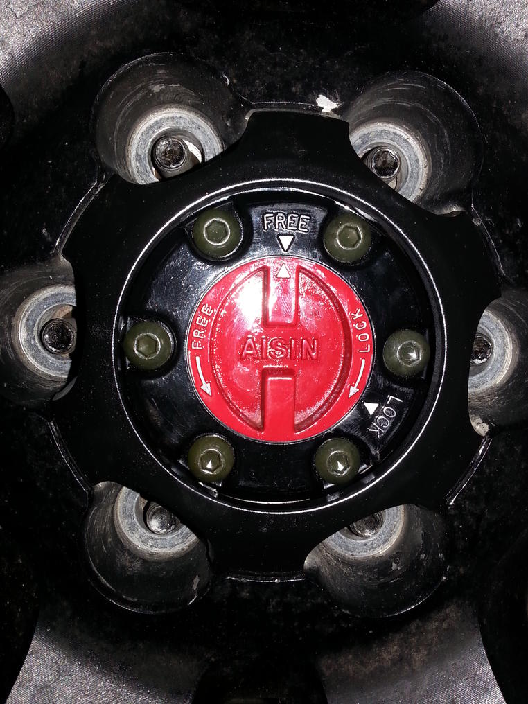

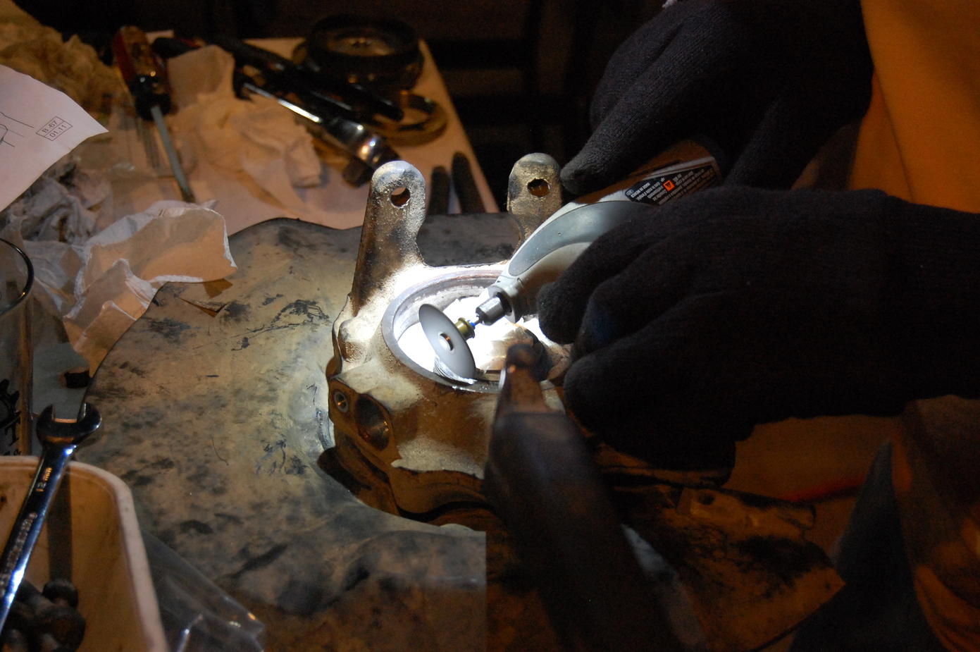

Thread damage fix- he ground the threads of the top and saved me $155!

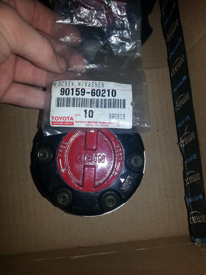

Allen head bolts for anyone that wants them for their Aisin hubs

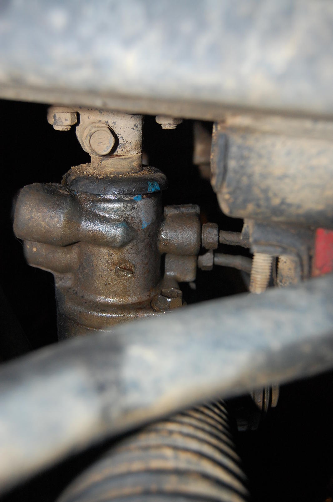

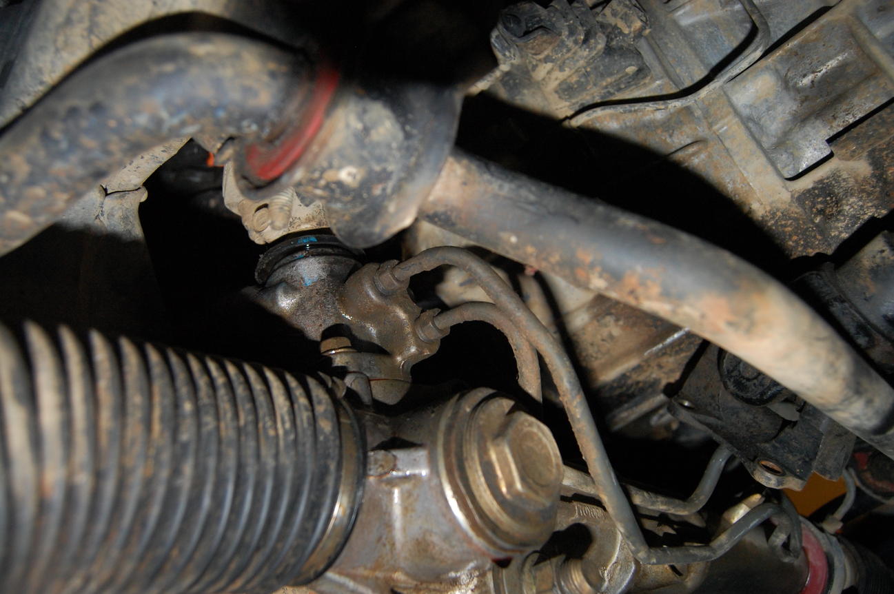

Here's my PS leak. I guess I'll wait 'till it gets worse then I'll replace the rack :( I might be able to buy some seals and fix it at the input shaft, but it's unlikely

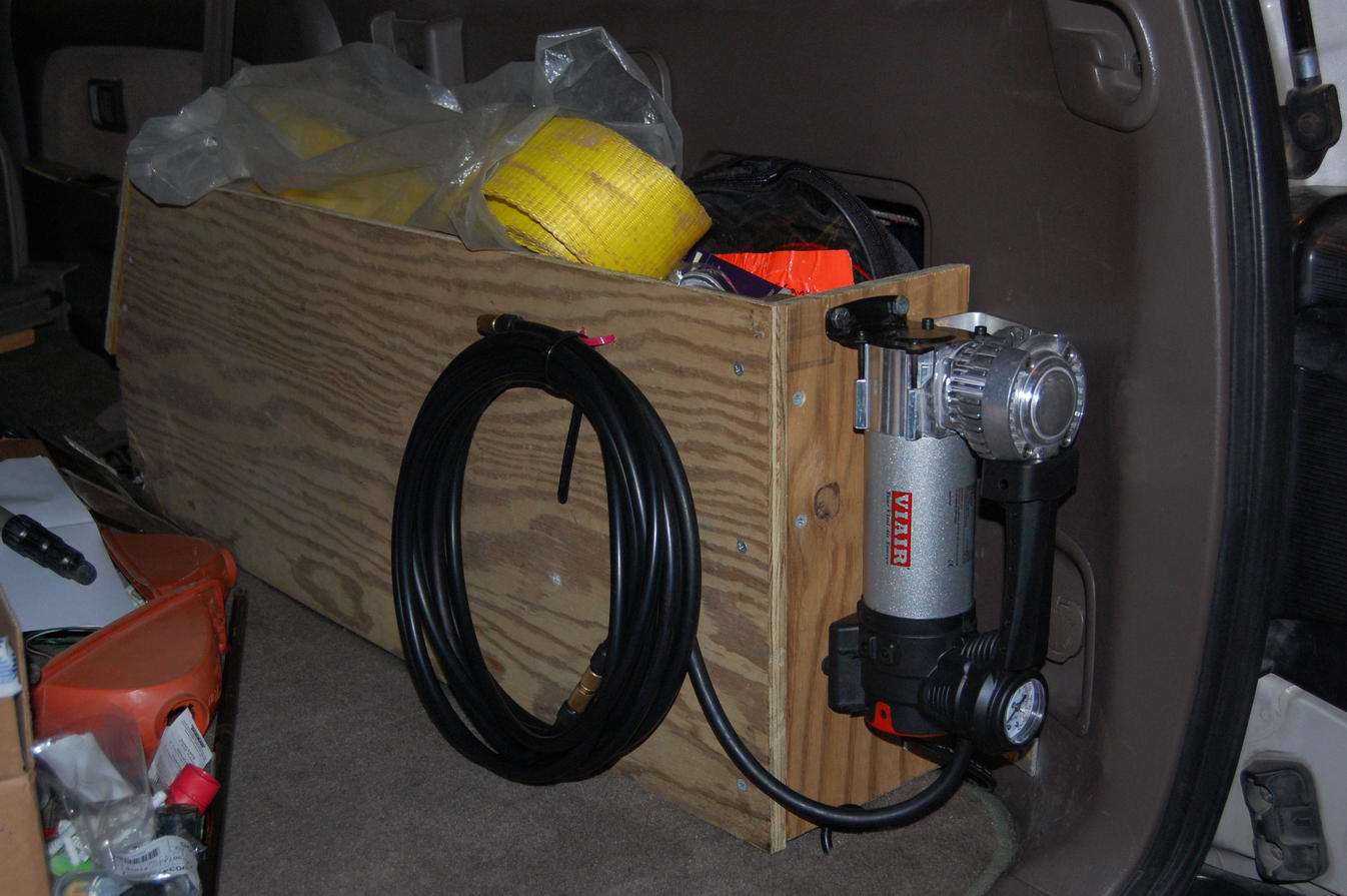

I mounted my compressor on another cargo box that I built. I have a switch on the dash for it.

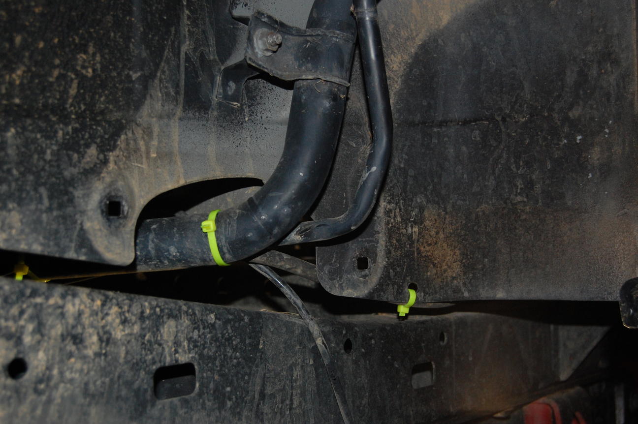

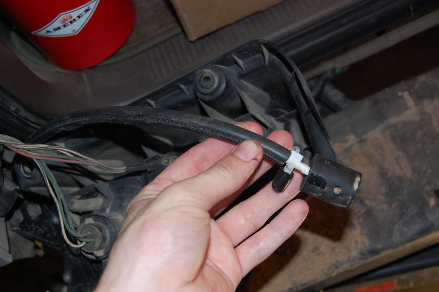

Rear Diff. Breather Extension 2.0

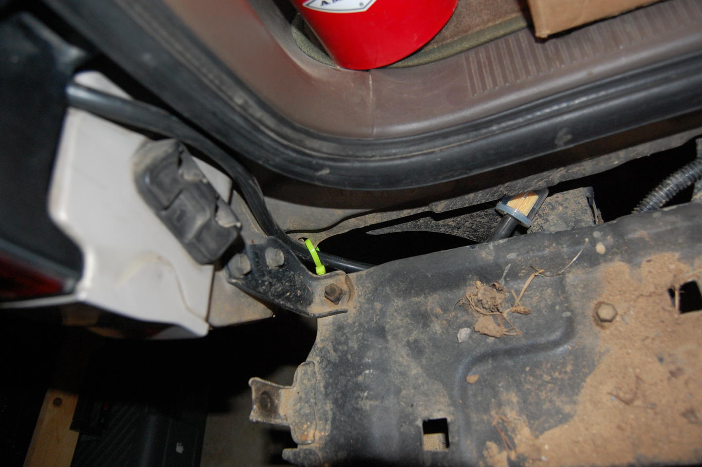

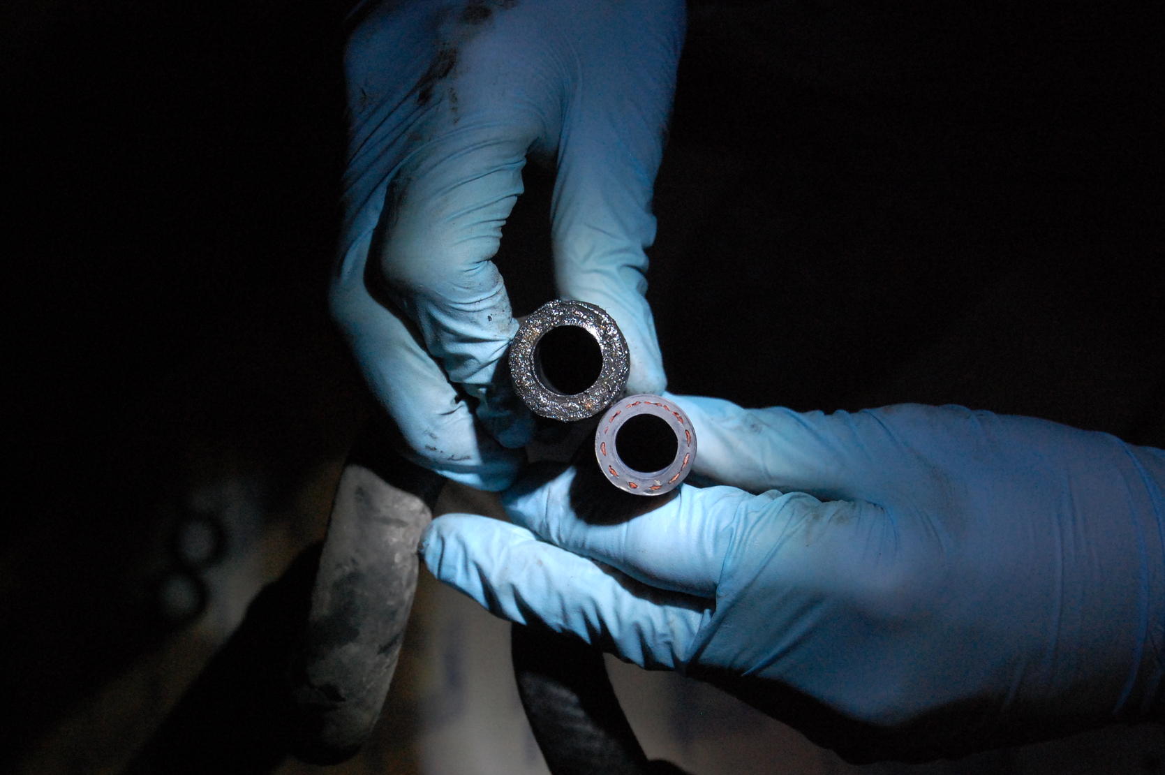

I got rid of the stupid 1 way valve! Now my axle is free to breathe without sucking water through the axle seals. I don't know why people have writeups that extend the crappy one way valve...
Here is the line running along the body
In-line fuel filter and line running into taillight area
Extra breather filter on the end for added protection

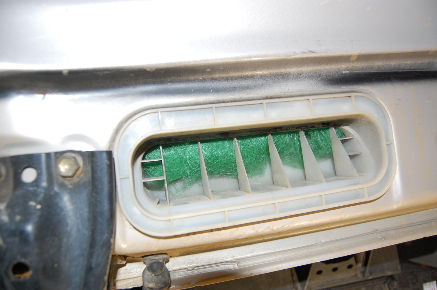

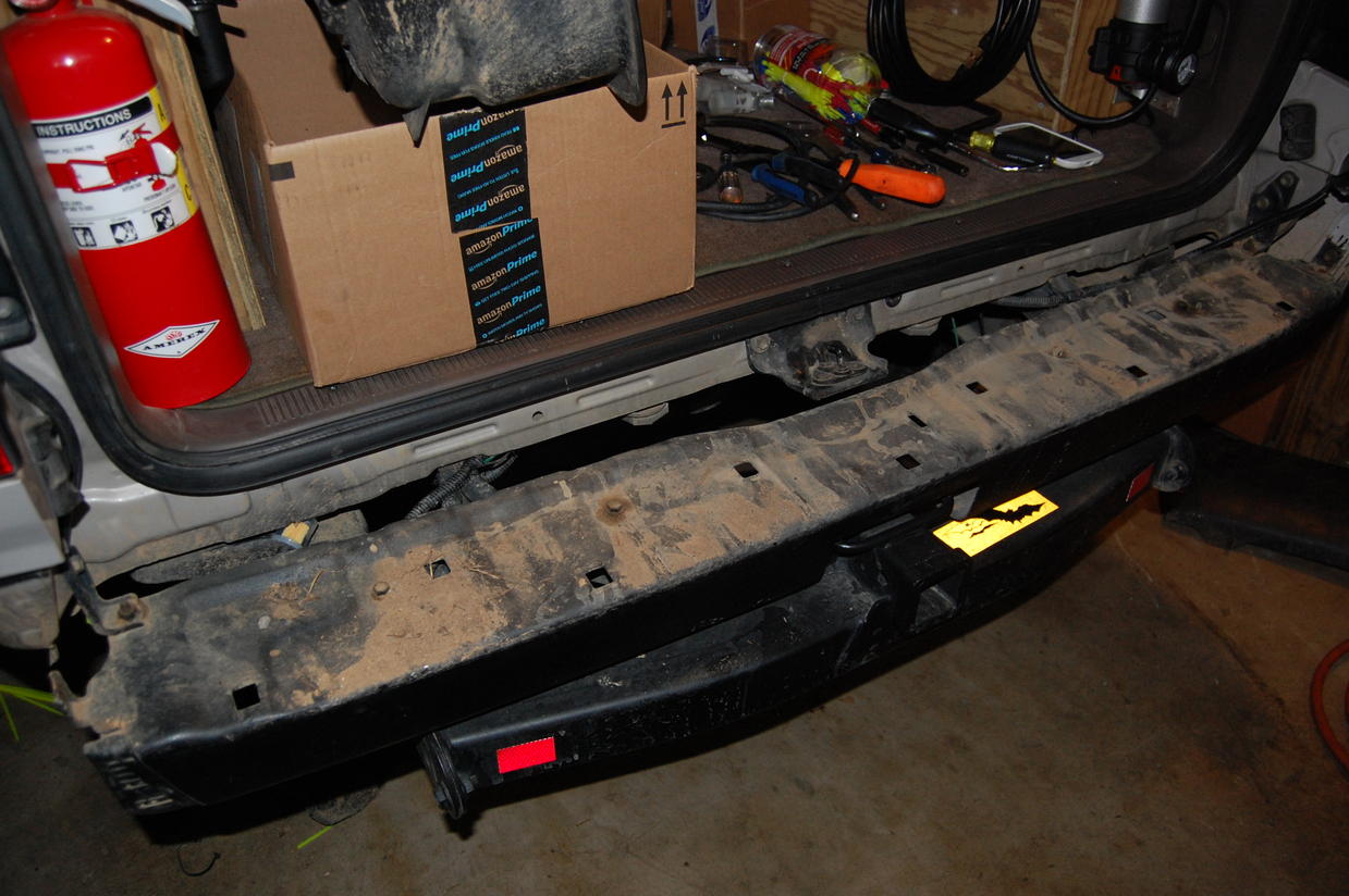

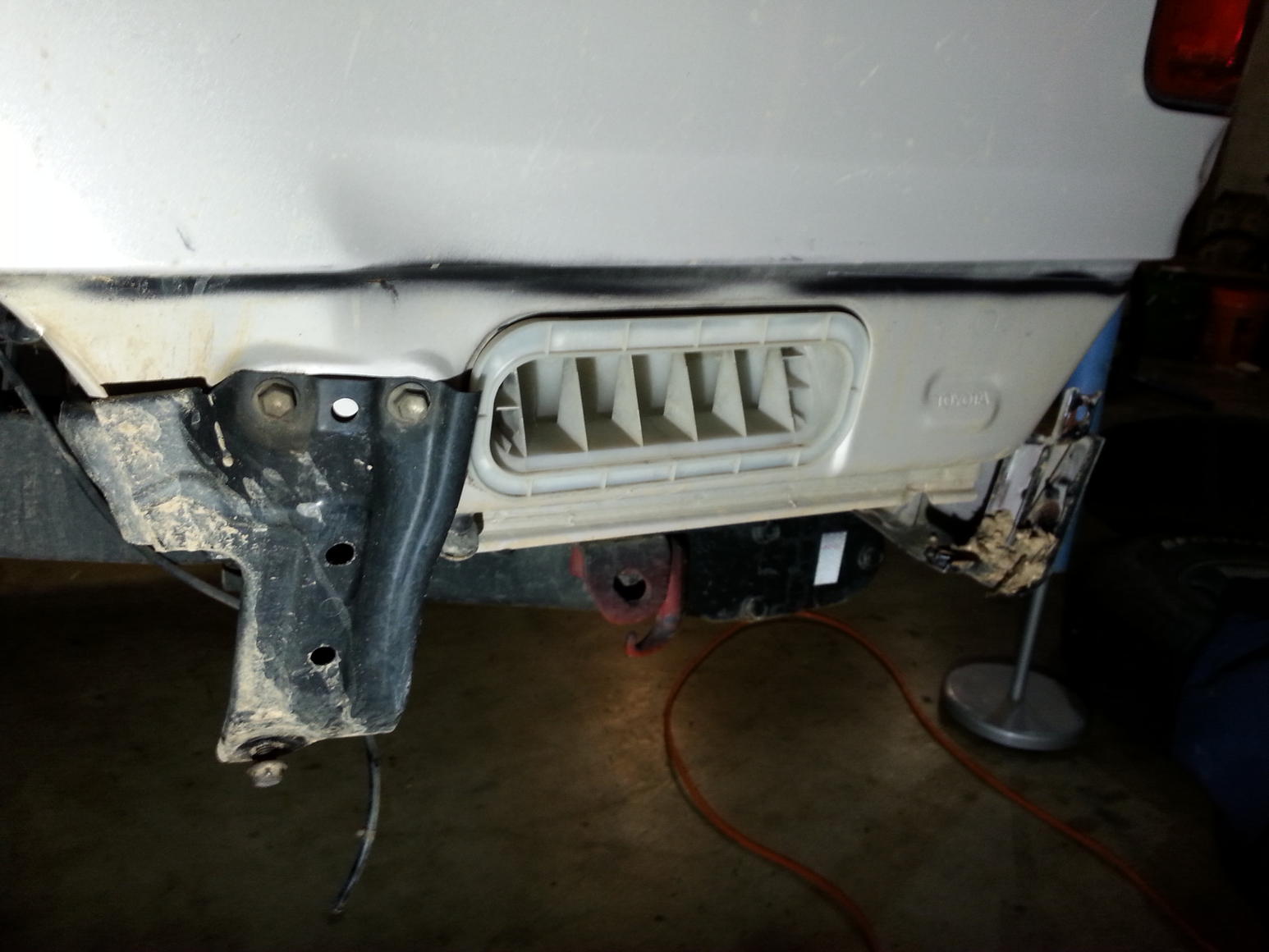

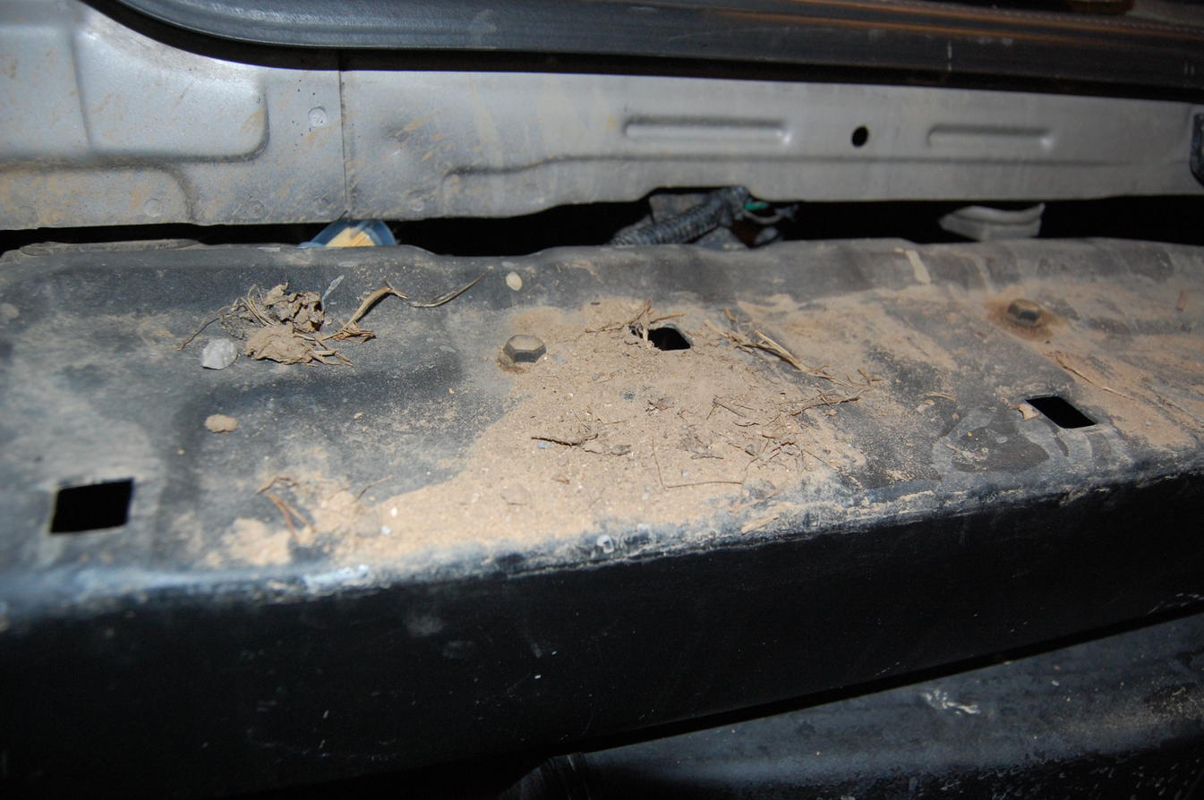

The bumper plastic traps a lot of dirt!

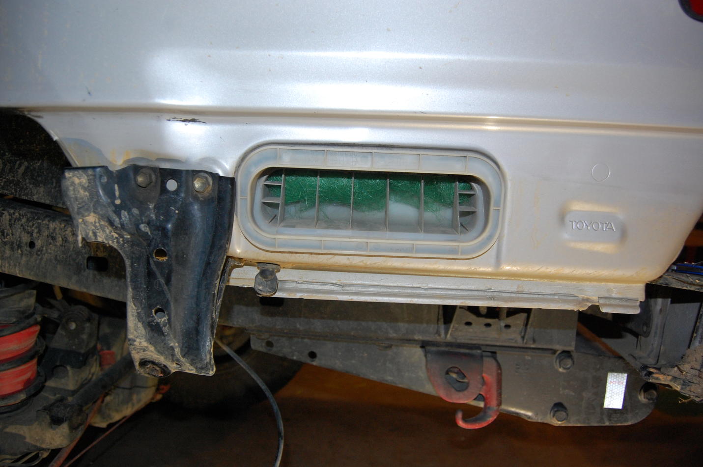

I put a piece of fiberglass filter in the rear vent to prevent so much dust from entering the cargo area
Also cleaned off my overspray from touching up the bumper
Before

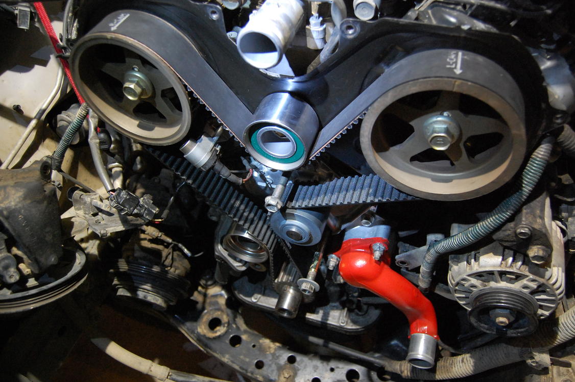

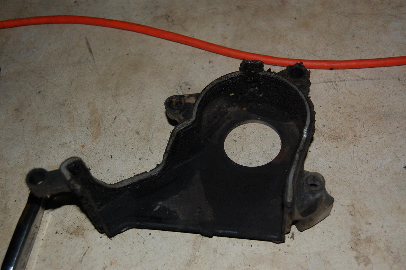

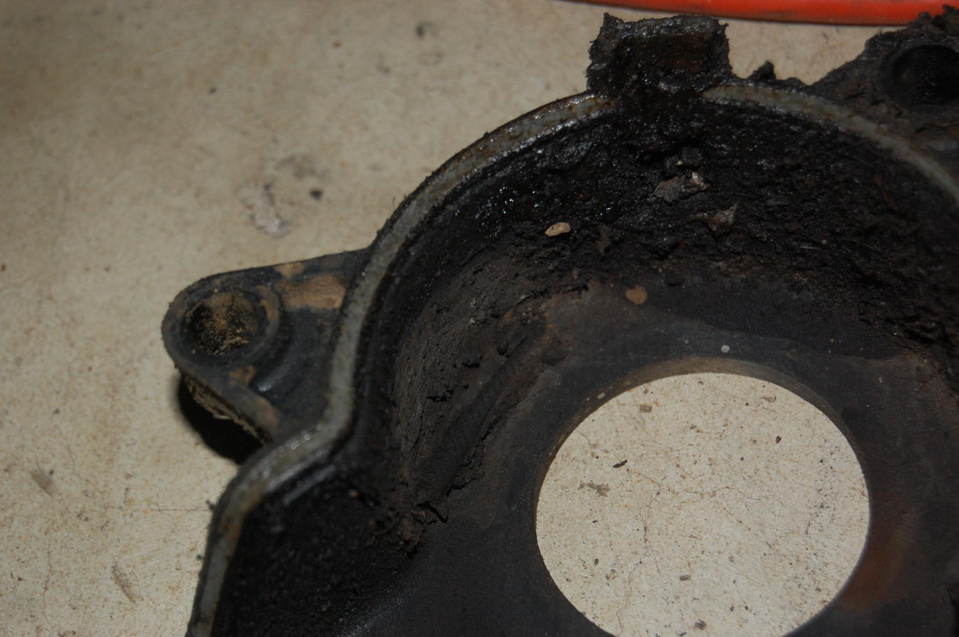

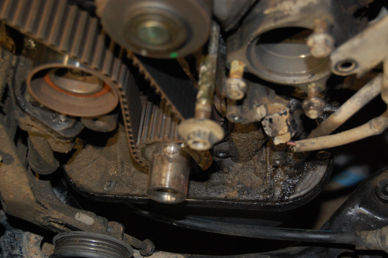

Engine cleaning
I cleaned a lot of the front of the engine yesterday. I still need to do more tomorrow. I think most of the gunk was coming from the dipstick tube.
Here's the only part that you could tell a difference that it is cleaner

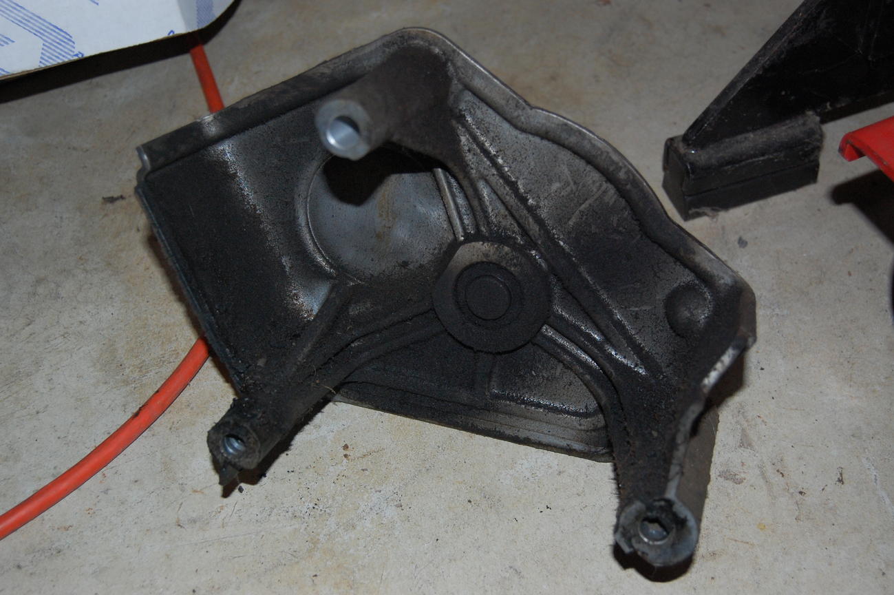

Lower timing cover. Yes, that is a timing belt rib stuck to it
Pulley bracket

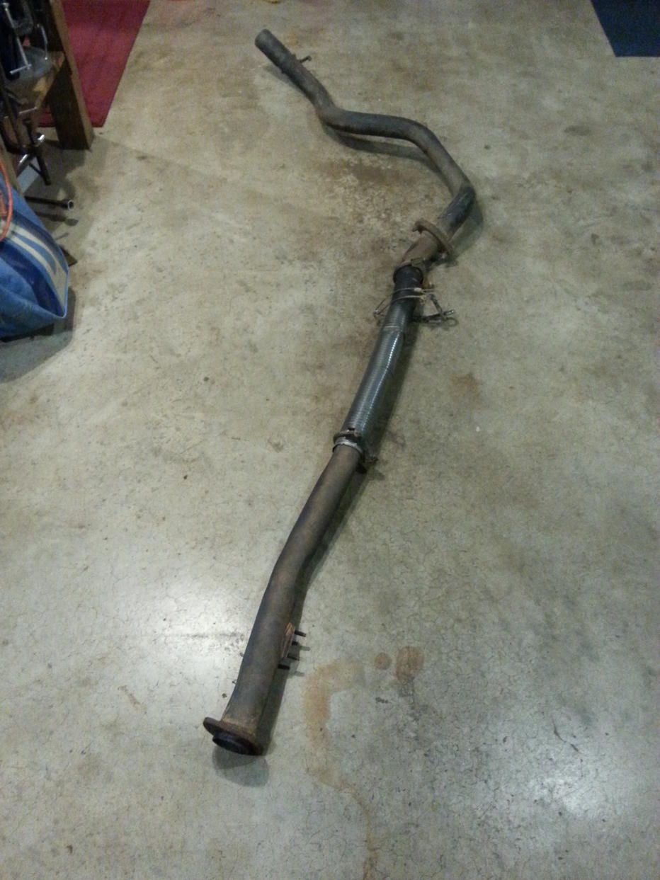

Not engine related, but I will be putting the straight pipe exhaust back on just to show off to the guys since they have only heard mine quiet haha! Don't worry, it won't be on there for long.

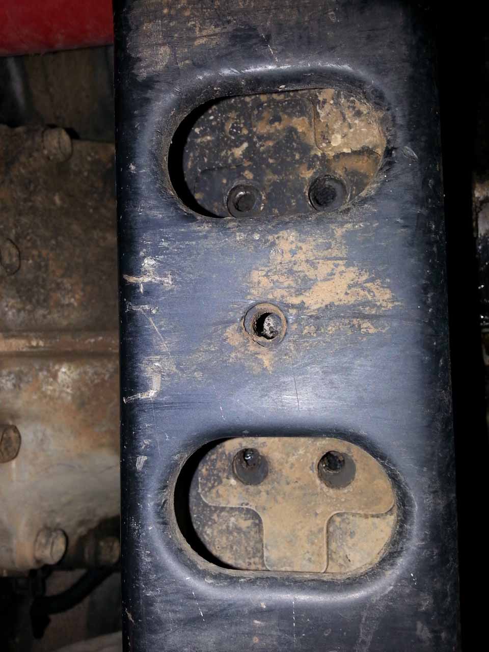

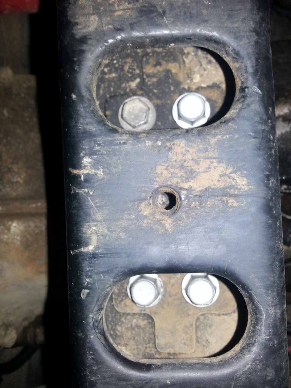

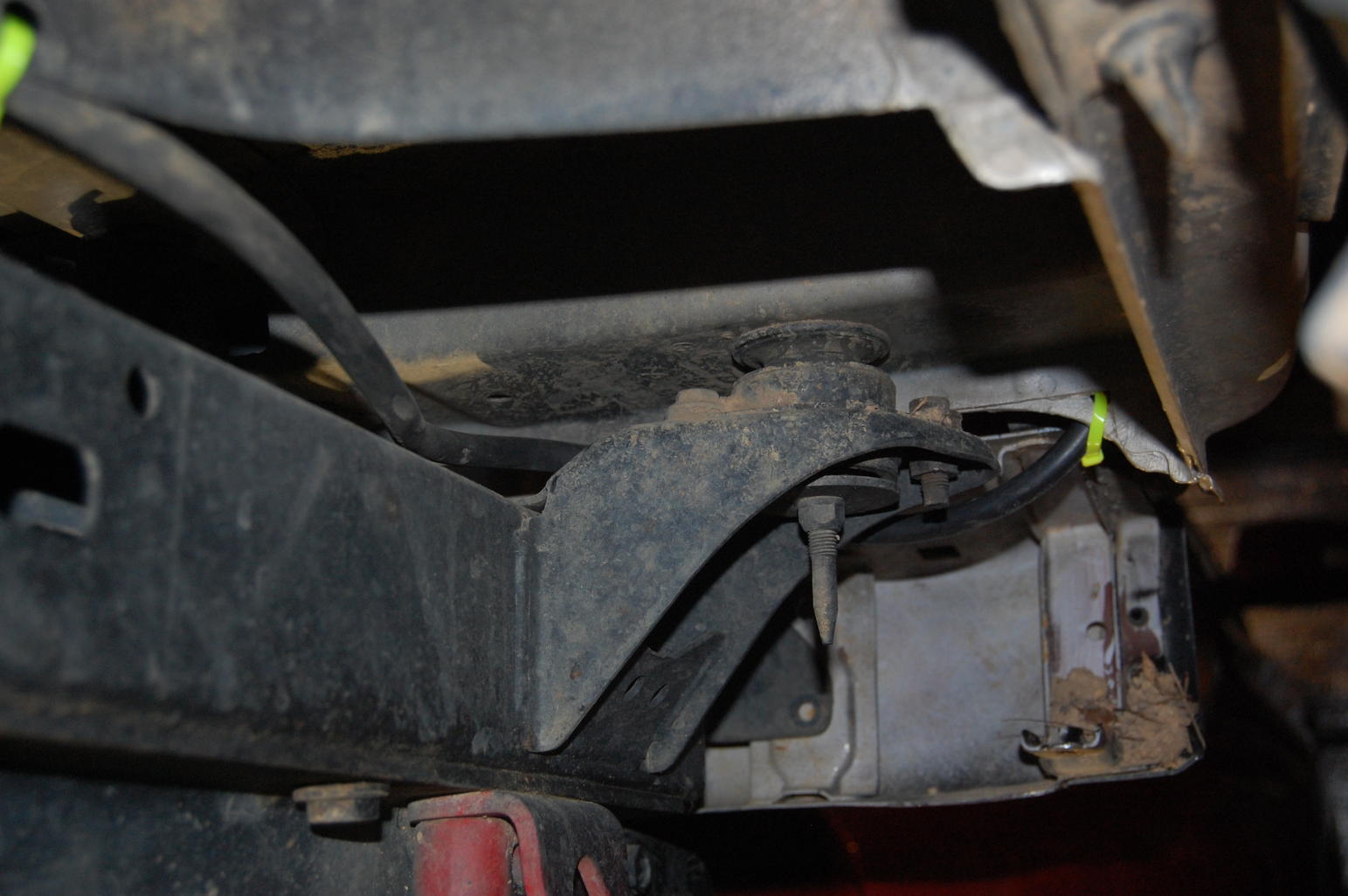

So tonight, i discovered where my other clunking sound was coming from......
After 10 months of ownership, I finally found that the transmission was not bolted to the cross member. :frusty: Smithville tire and service does about the worst work I have ever seen...
I promptly stuck some bolts in. I haven't driven it yet, but I will tomorrow. I'm sure it will make a huge difference.
Do you happen to know the bolt size or part number for those bolts?
Also, do you know the torque specs for those bolts?
Sorry, but I have no idea on what size they are. I just grabbed some random bolts out of the metric bolts jar and got 4 that fit.
I just got them good and tight...

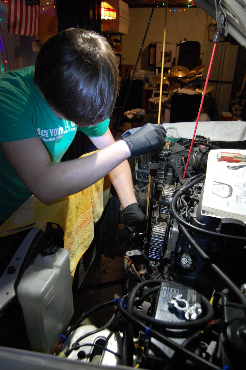

Torquing things

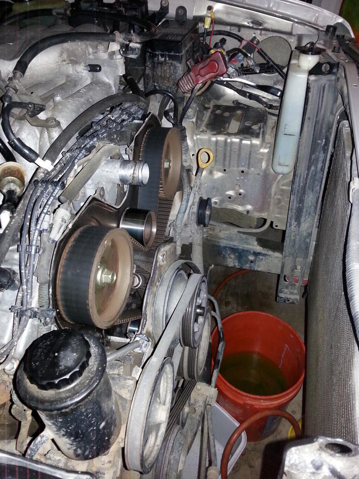

Pulling the pin!
Belt rotates correctly!

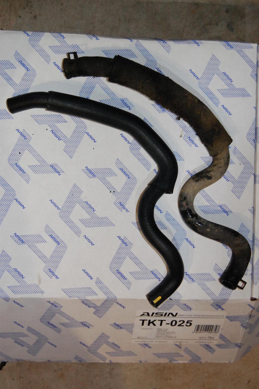

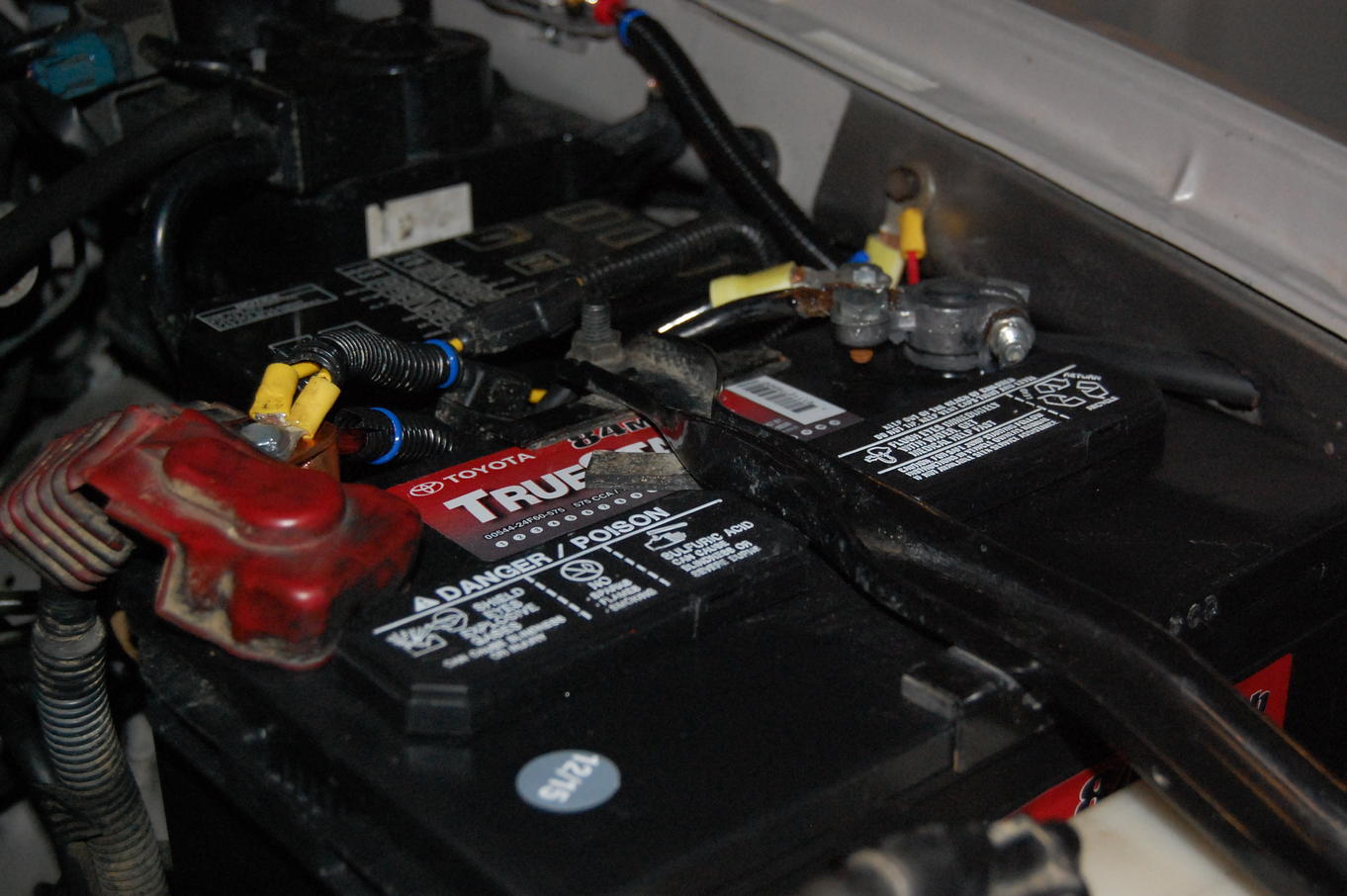

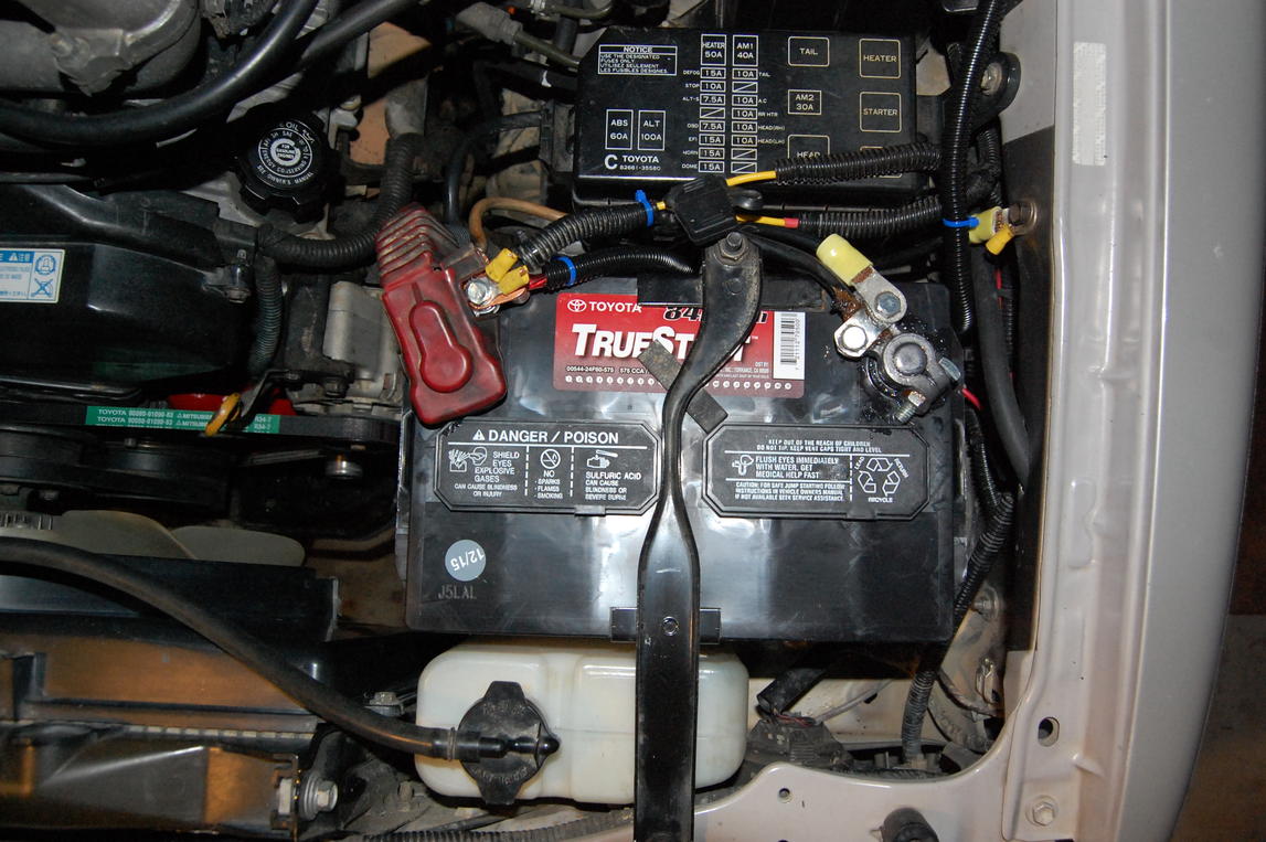

So I get everything else installed this morning and pour the coolant into the upper radiator hose and I discovered a leak :( I think it came from the thermostat housing. Tonight, me and my dad put some thermostat sealant around it in hopes to seal up the mating surfaces. I also replaced the oil cooler hose because it was in really bad shape. I plan to replace a lot more hoses this summer.
Old vs. New
I also got a new Toyota battery and a positive terminal
