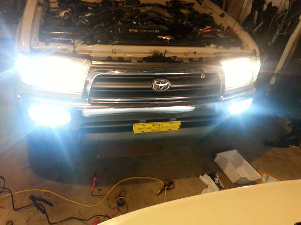

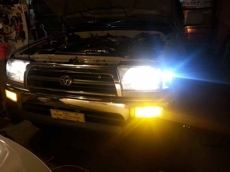

Hi, I've owned my 97 sr5 4Runner for 9yrs, I'm trying to do the switchback lights
But I can't find any kits on eBay. Where did you bought yours?? How is this installed. If you don't mind. Thanks
Housings
http://www.amazon.com/Toyota-4Runne...8-2&keywords=1998+toyota+4runner+turn+signals
LEDs
http://www.amazon.com/JDM-ASTAR-Ext...968&sr=8-3&keywords=switchback+LEDs+jdm+astar
Sockets
Amazon.com: Bestcompu® 2X 1157 2057 2357 Socket Adapter Harness Wiring For Front Turn Signal Light Bulb: Automotive
I do have some disclaimers about this mod (that I have learned from time).
1)The housings do not seal very well. I have them sealed with RTV silicone at the moment. The lenses crack easily if you overtighten the screws.
2) The LEDs are junk I got a warranty replacement for one a couple months ago and now, the other one has stopped working.
3)The bulb sockets do not fit the housings. You will have to enlarge the holes and secure the sockets with RTV silicone or tape.
The way they are installed use the factory wires that need to be spliced in to the new sockets for the turn signals. The white function needs a separate power wire either from the parking lights or a switch in the cab.
