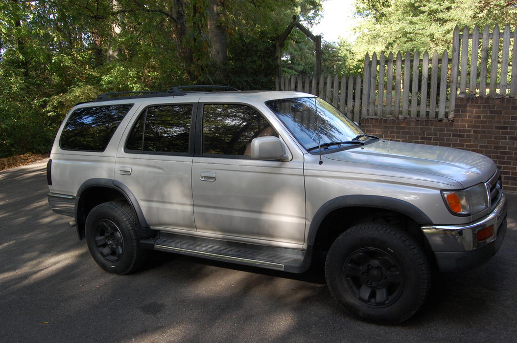

When I first got it

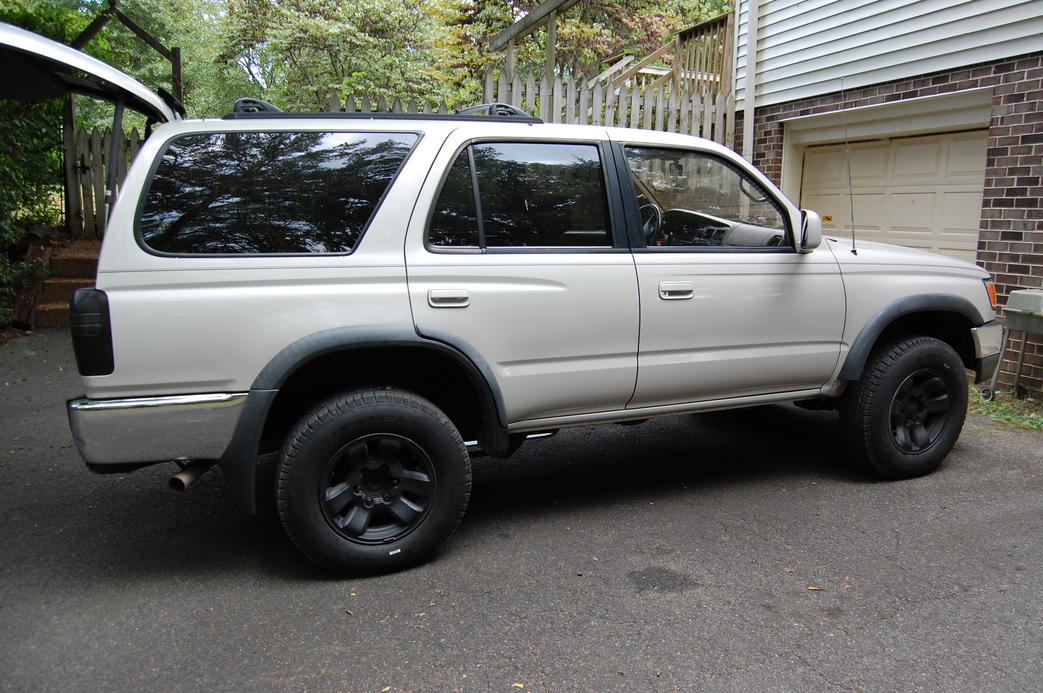

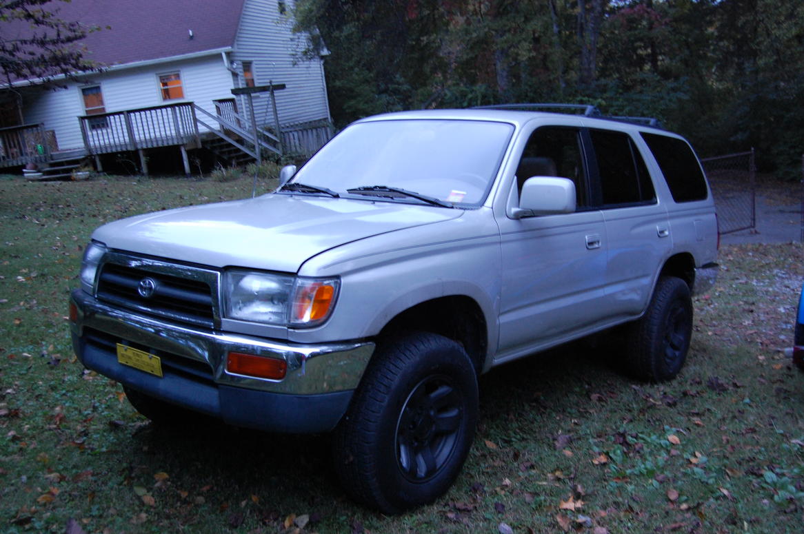

Running Boards removed- instant 4" lift lol
Fender Flares removed

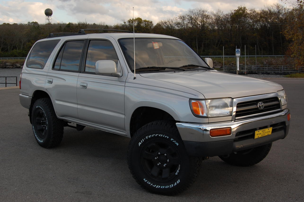

99 Tall Coils and KYB shocks
32" Skinny BFG AT's

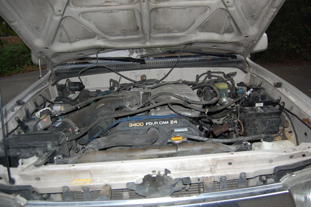

October 2015

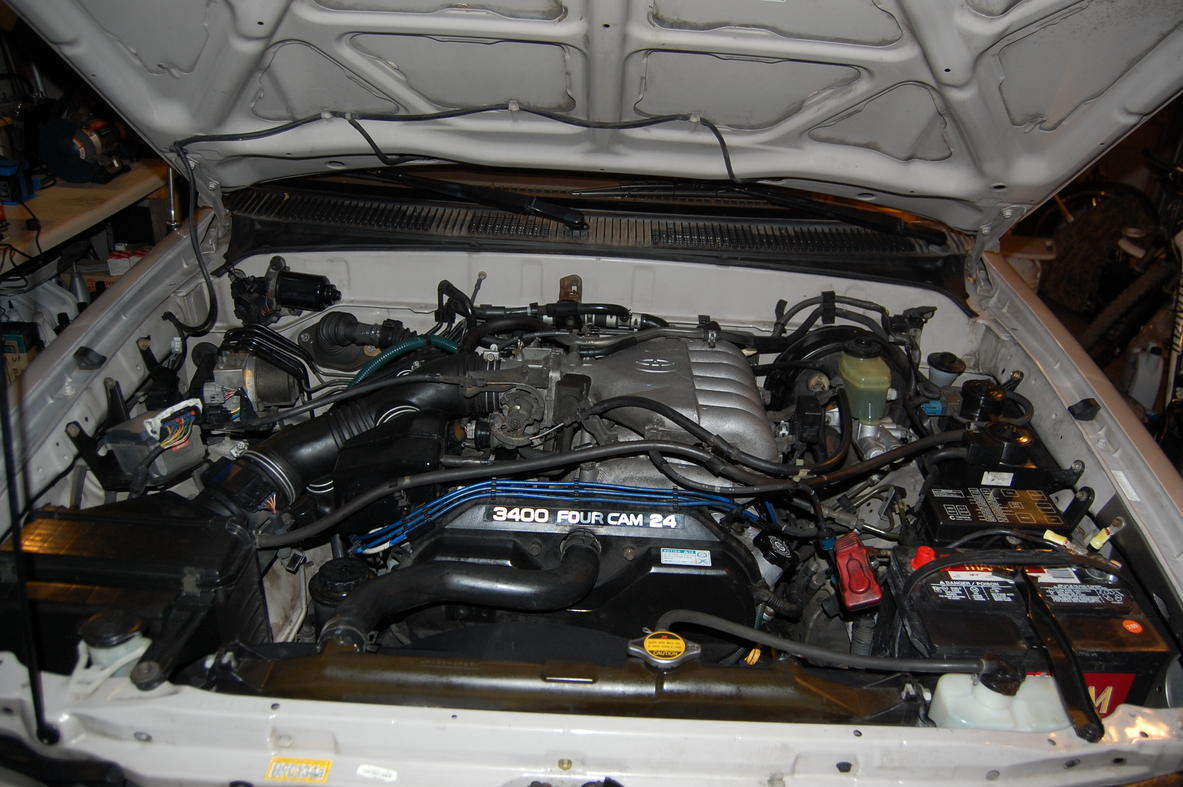

Engine when I got it
Engine after cleaning multiple times, rust removal, and valve cover gaskets

Tire Size
What size tires are those BFG's ?
They are 235/85/R16. They were the skinniest 32's I could find. I think they are equivalent to a 32x9.5 R16
Edit: I compared the tire width to the 31x9.50 R15's on our trailer and I think mine are closer to a 32x8.5 R16

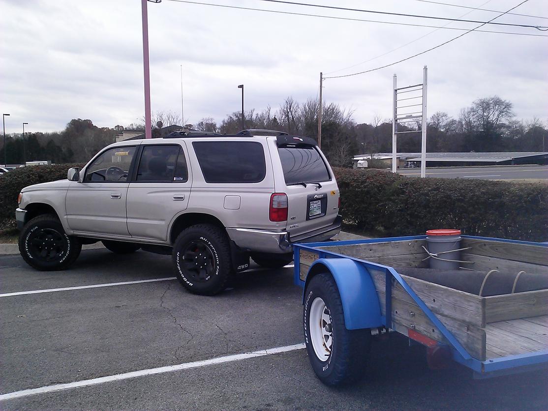

Towing/ Airbox Mods
First time towing today and my first time pulling a trailer. Did good even with a bunch of gravel in the back

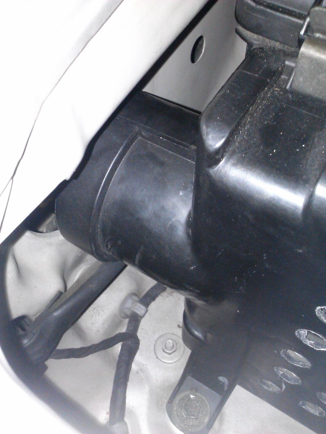

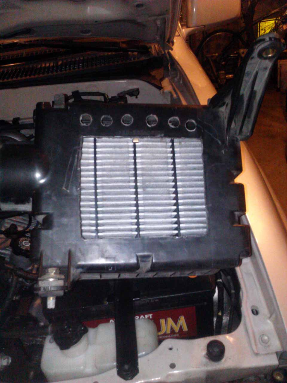

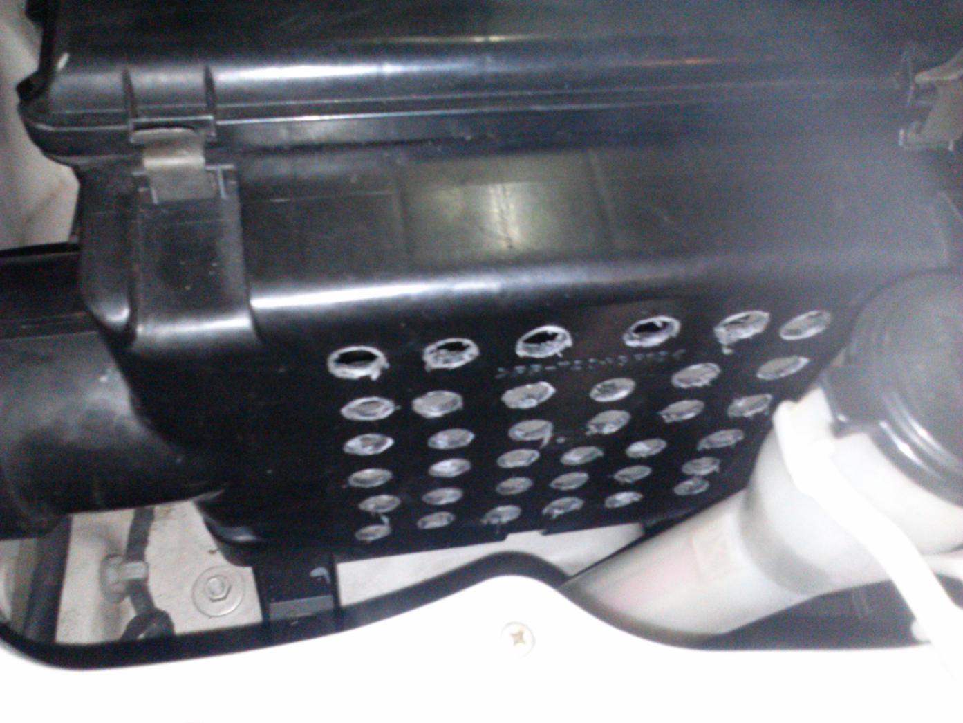

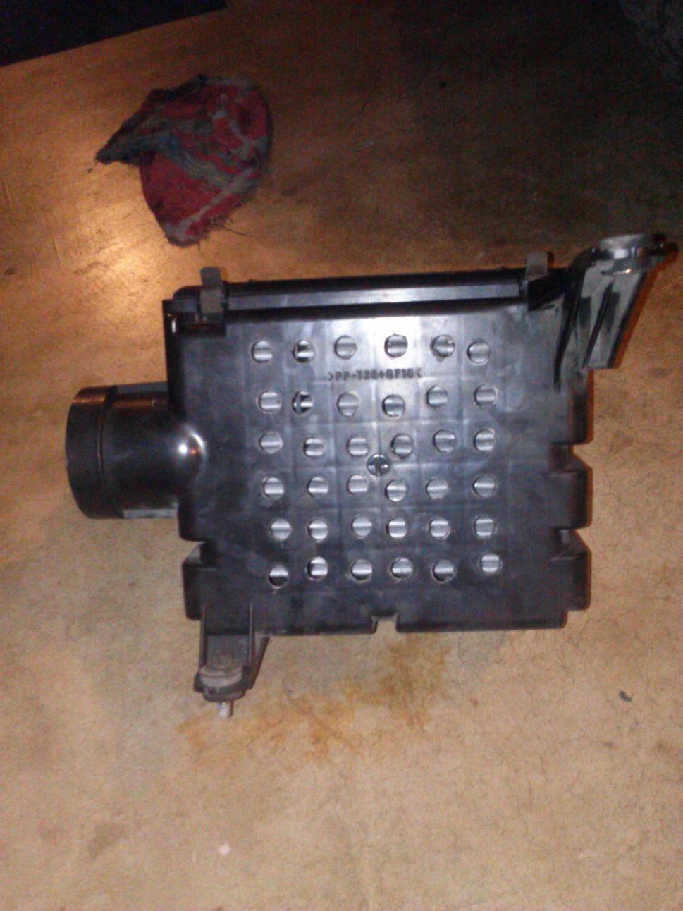

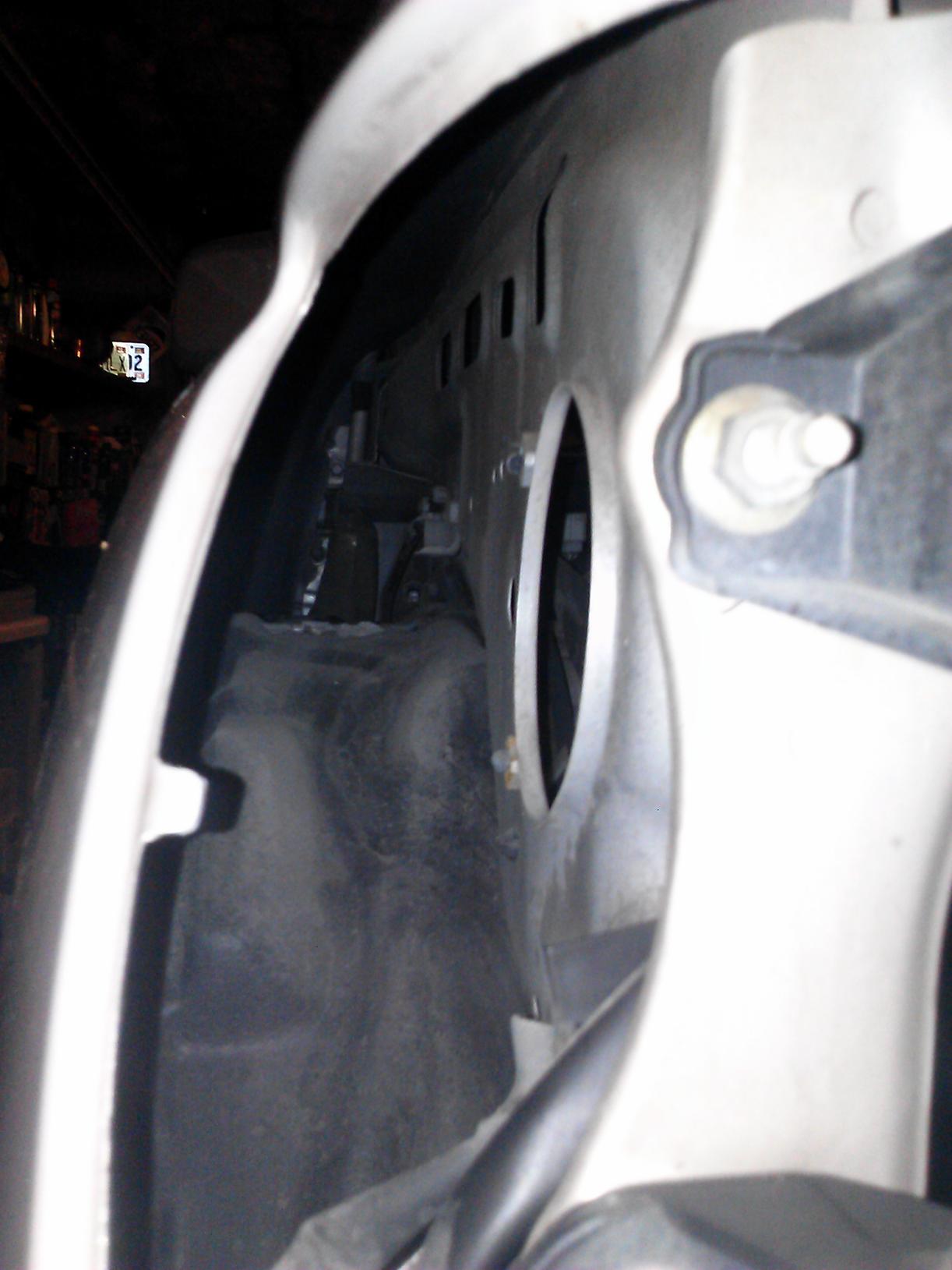

I made some mods to the intake...
Drilled some holes
Did away with the elbow and tube in the fender
I know this changes it to a warm air intake, but there is much better airflow now. There is a very slight noise increase, but I can't hear it from inside. All I need to do the ISR mod is a pipe and a few hose barbs.

I cleaned the MAF sensor today. While I had the airbox out, I did this.

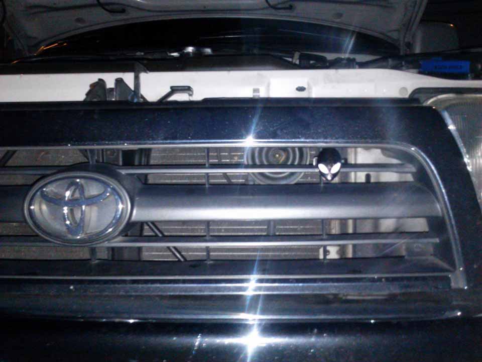

I also installed my Alienware emblem on the grill.

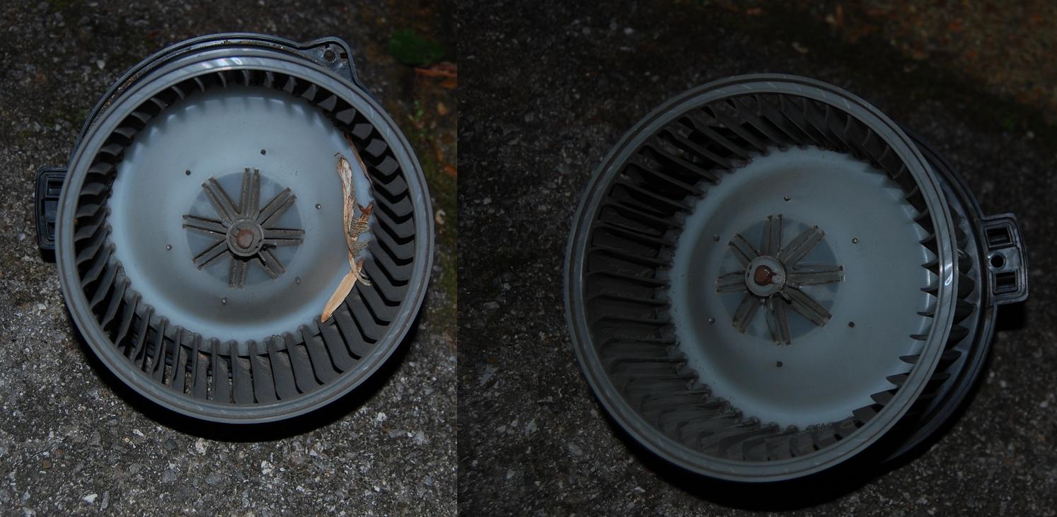

Blower Fan Clean/ 5th Gen
Sunday night, I cleaned out the blower fan for the front HVAC. It was nasty! It is a lot quieter now. Next thing to do is the rear heater fan. We might be tackling the fuel filter soon.
Before on the left, after on the right

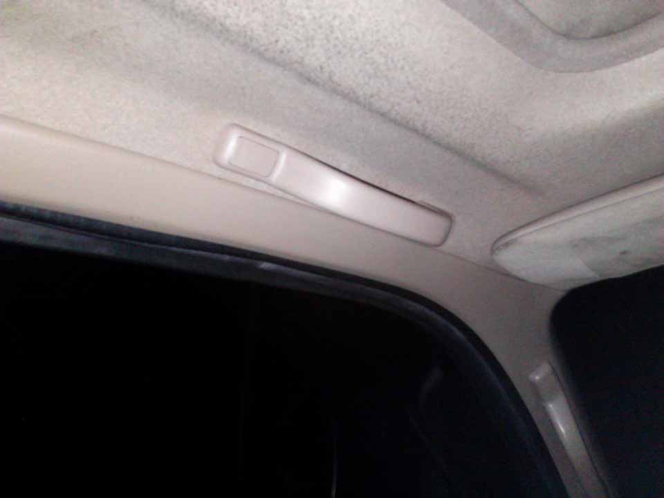

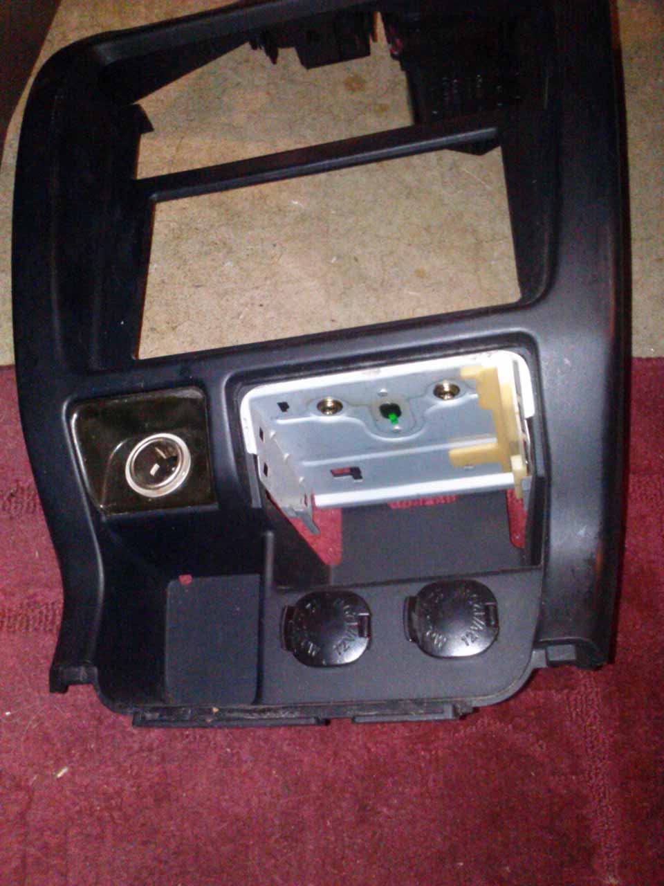

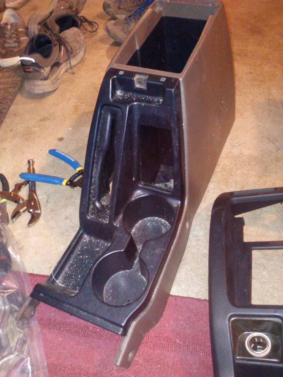

Went to the junkyard today after seeing a 2000 online that arrived on Friday. I was amazed at how stripped it was in such short time. I got a pull handle for the driver's side, a center console with cupholders, e-brake handle, center bezel with 3 power outlets, a brand new looking air filter, one hub cap, and a center a/c vent louver, and an owner's manual.
The center console doesn't have a rear heater, so I will need to graft the cup holders onto my console.
The dual power outlets will need to be attached somehow.

If you want to sell the heater-less console shell shoot me a pm, I've been unable to find one that didn't have a heater in the local yards.
