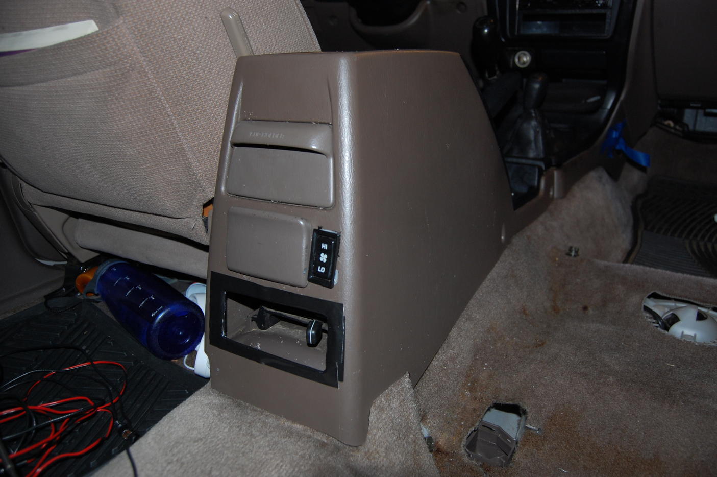

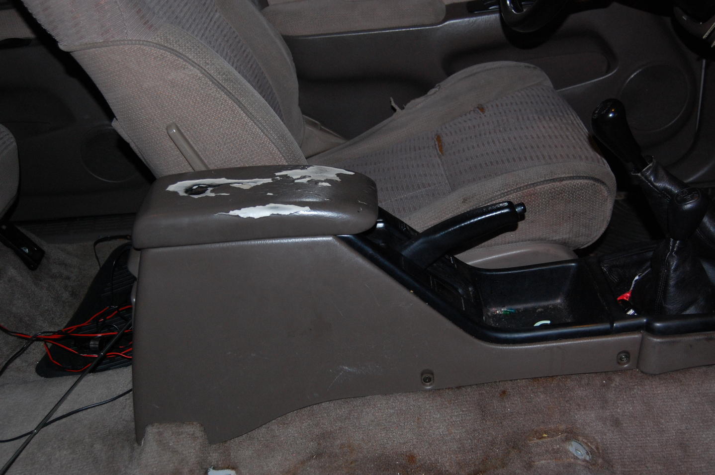

Console Retrofit- Cupholders!
Before
The Nastiness
My custom rear heater stuff (the picture makes it look bad, but it actually looks good when you are sitting in the back)
Finished

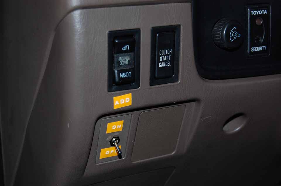

First of all, here is the switch I put in for the ADD. It is a simple interrupter for the yellow wire under the truck. I routed the wires through the shifter hole in the floor.

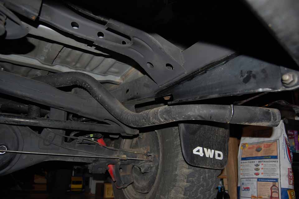

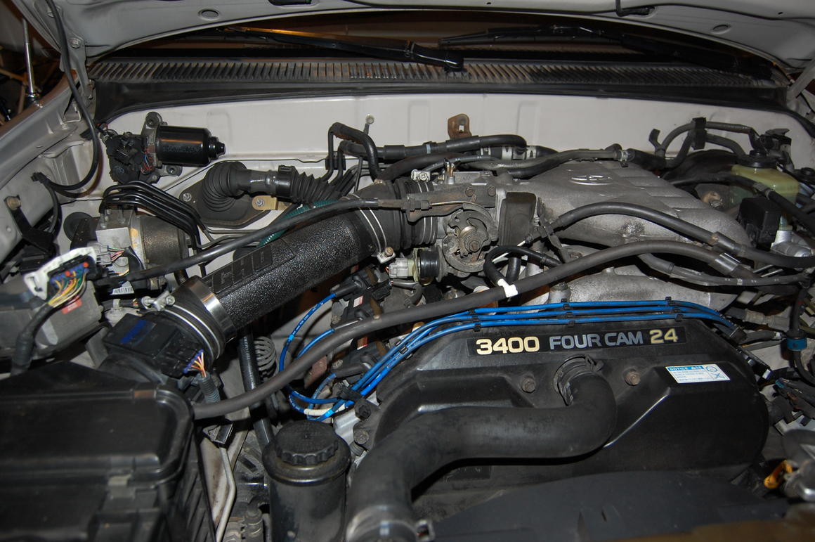

I did my ISR mod today. I used a pipe off an old leaf blower. Hopefully it holds up. I got a tee for $2 and made a new hose for the vacuum line. The total cost for my ISR and "Deckplate" mod is a whole $7!
I also added in a filter ($5) after the PCV valve. I also replaced the hose- it was cracked and clogged up.
I still have an oil leak somewhere. Next time I'm under the truck, I'm going to check the oil pan bolts to make sure they are tight.

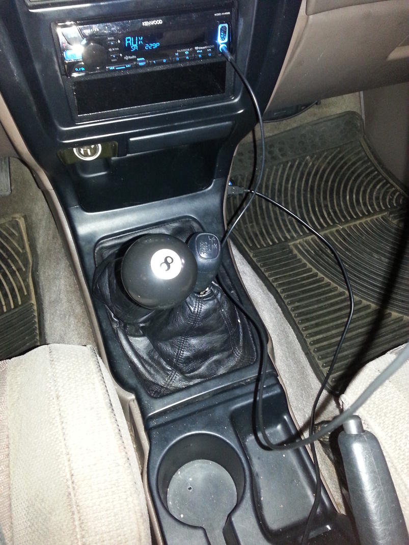

8 Ball Shifter
I got my shift knob puttied in.

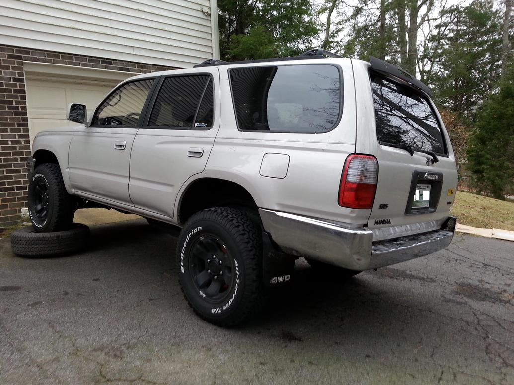

Off-Roading Fun!
Had some fun last night... I went to visit my troop and Order of the Arrow buddies at the local scout reservation last night. On our way to a site, my friend told me the wrong directions and ended up going down a gravel road that turned into a dirt road that then went into a field. It was pretty wet and the tires did great going up a few rises. I really need to do something with my hitch because I hit it on a rock while backing up. That thing is soooooo low! When I pulled up next to my scoutmaster's truck, he had a worried look on his face... There was around 3 inches of mud where we were. His truck had been stuck for two days and was afraid I was going to be too when I backed out. He has a 2WD Dodge 1500 with no weight in the back. I put it in low range, let the clutch out and I didn't spin out at all lol. I was going to pull him out, but nobody had a tow strap.
I'm pretty disappointed with my '99 springs in the rear. The hitch hauler with some scrap metal on it scraped in our driveway when pulling in. Around 2-3 inches of my chain on the hitch was dragging. It usually has about an inch of clearance.

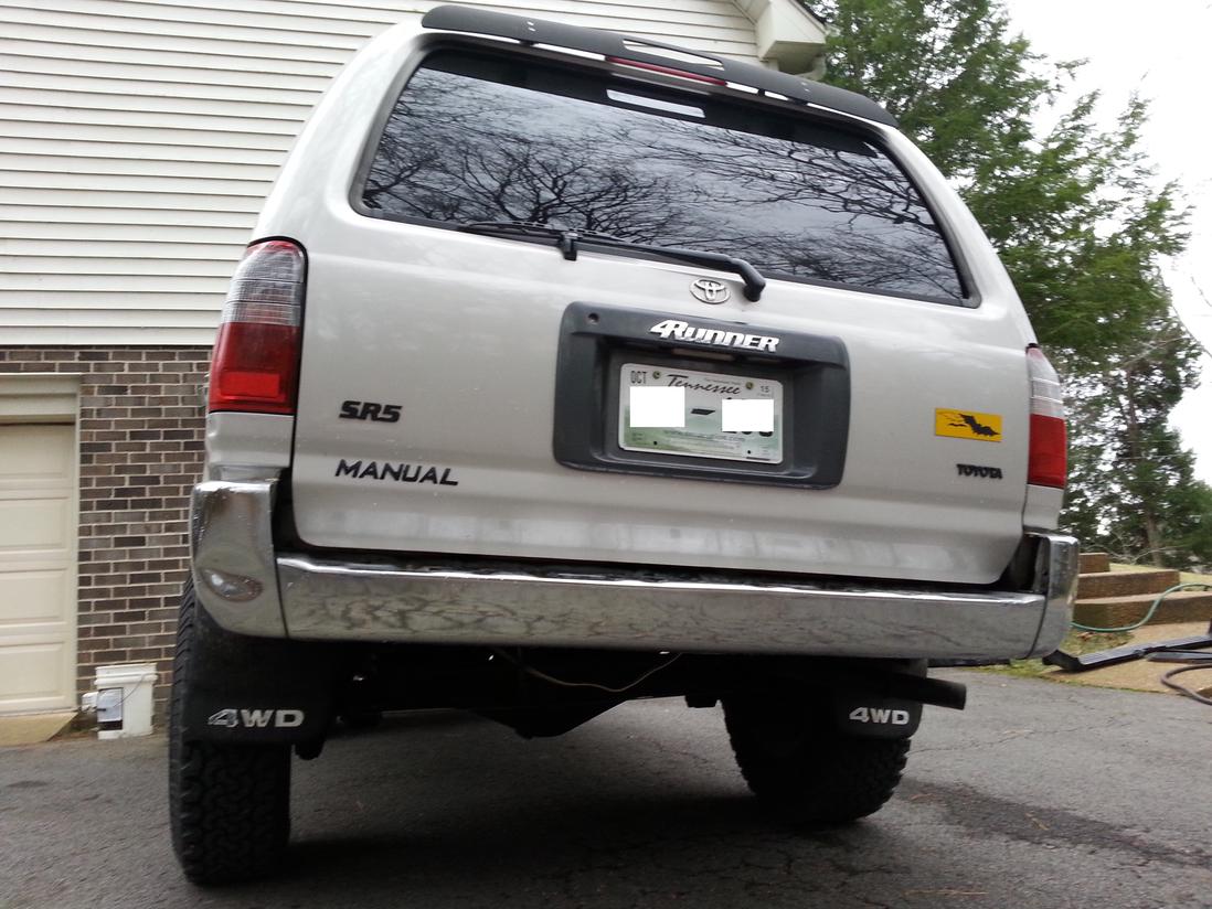

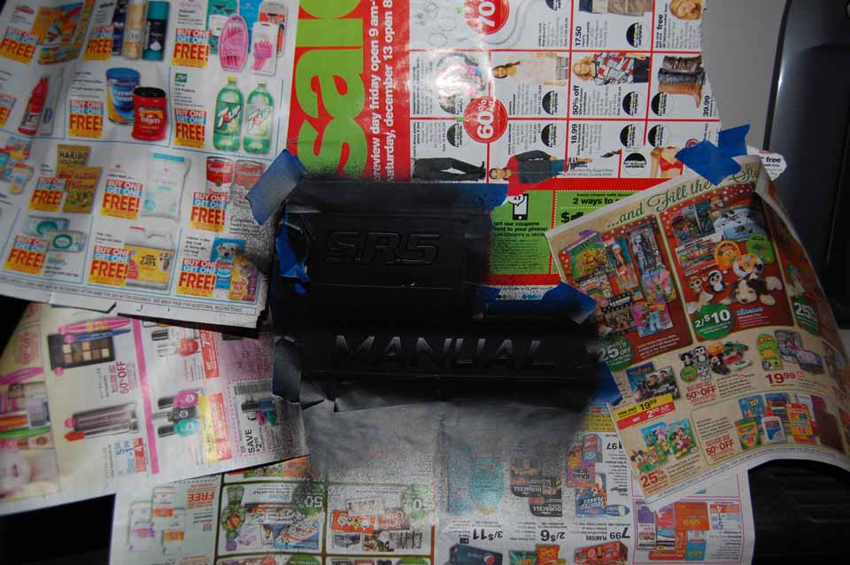

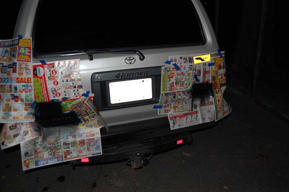

Plastidip rear emblems

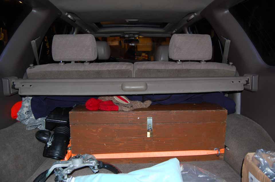

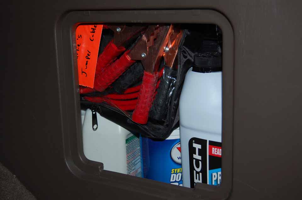

I mounted my Grandpa's old toolbox in the back with some eye bolts and a ratchet strap. I also added handles on the sides. I have tools, a chair, change of clothes, bungee cords, and other random supplies in there.

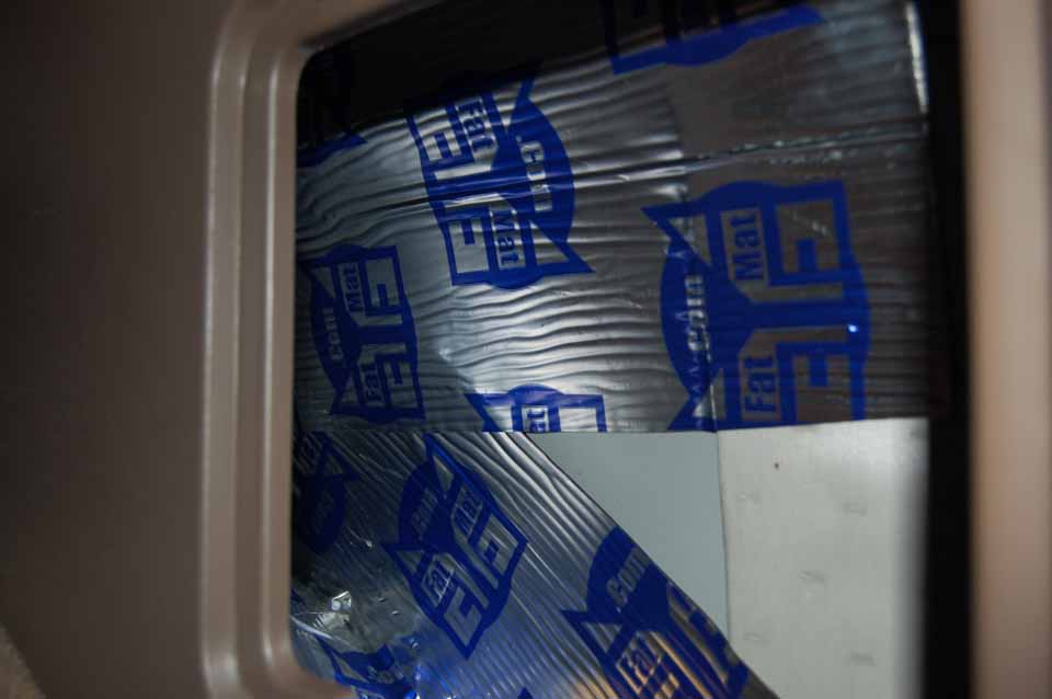

I deleted the box in the side panel and sound deadened the entire area. I did it on both sides of the rear including over the fender well arches. In the storage compartment, I can fit a blanket, a gallon jug of coolant, a quart of brake fluid, and a quart of 10W-30. It's an awesome free mod.

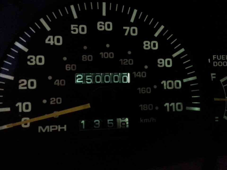

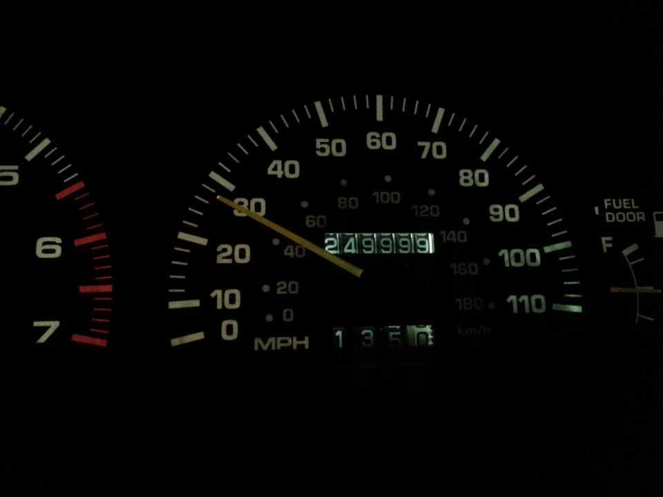

250 Thousand Miles/ Cargo Area LEDs/ Hitch Removed

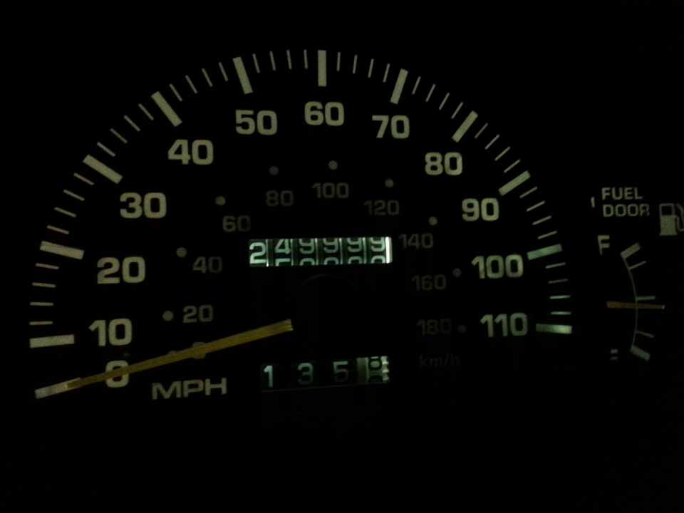

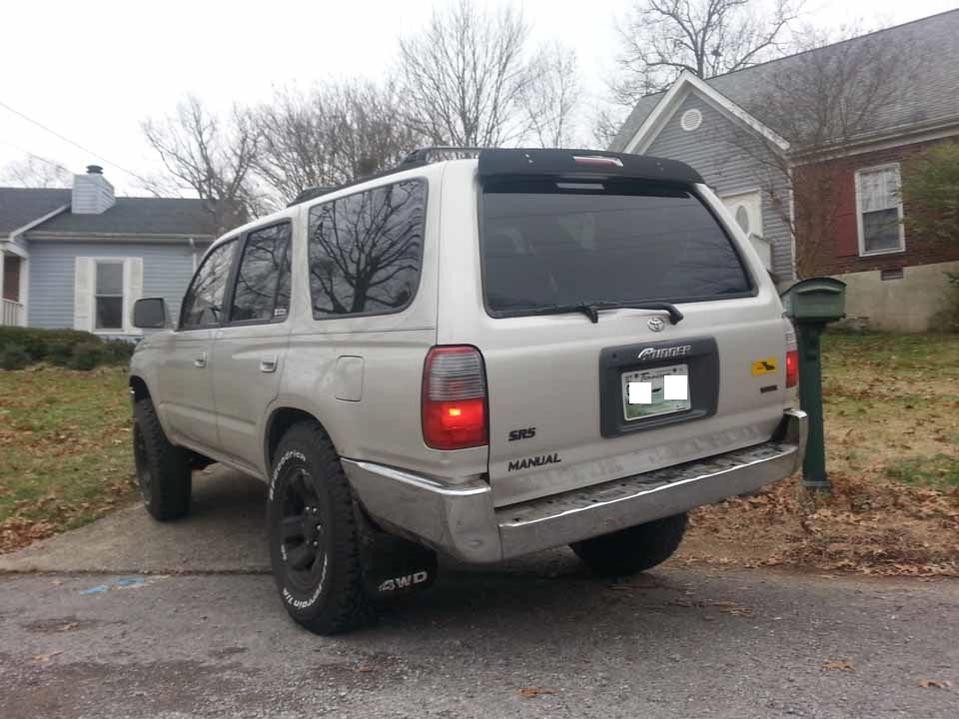

On Tuesday, she turned over to 250,000! I can't wait 'till 500,000!

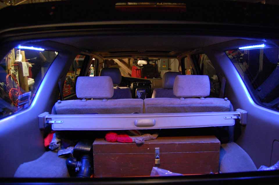

I installed some "Type R" lol Amazon LEDs in the back. They are super bright and only cost $7 for 4 of them. We might put the other 2 in my dad's '04.

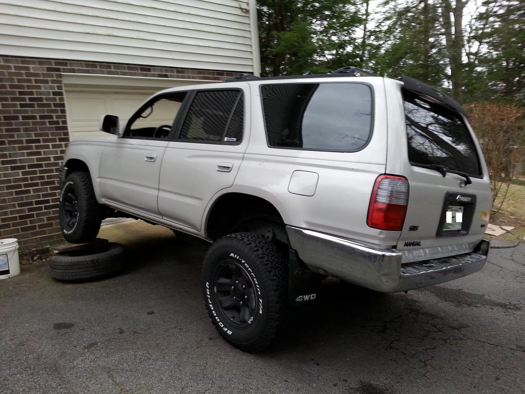

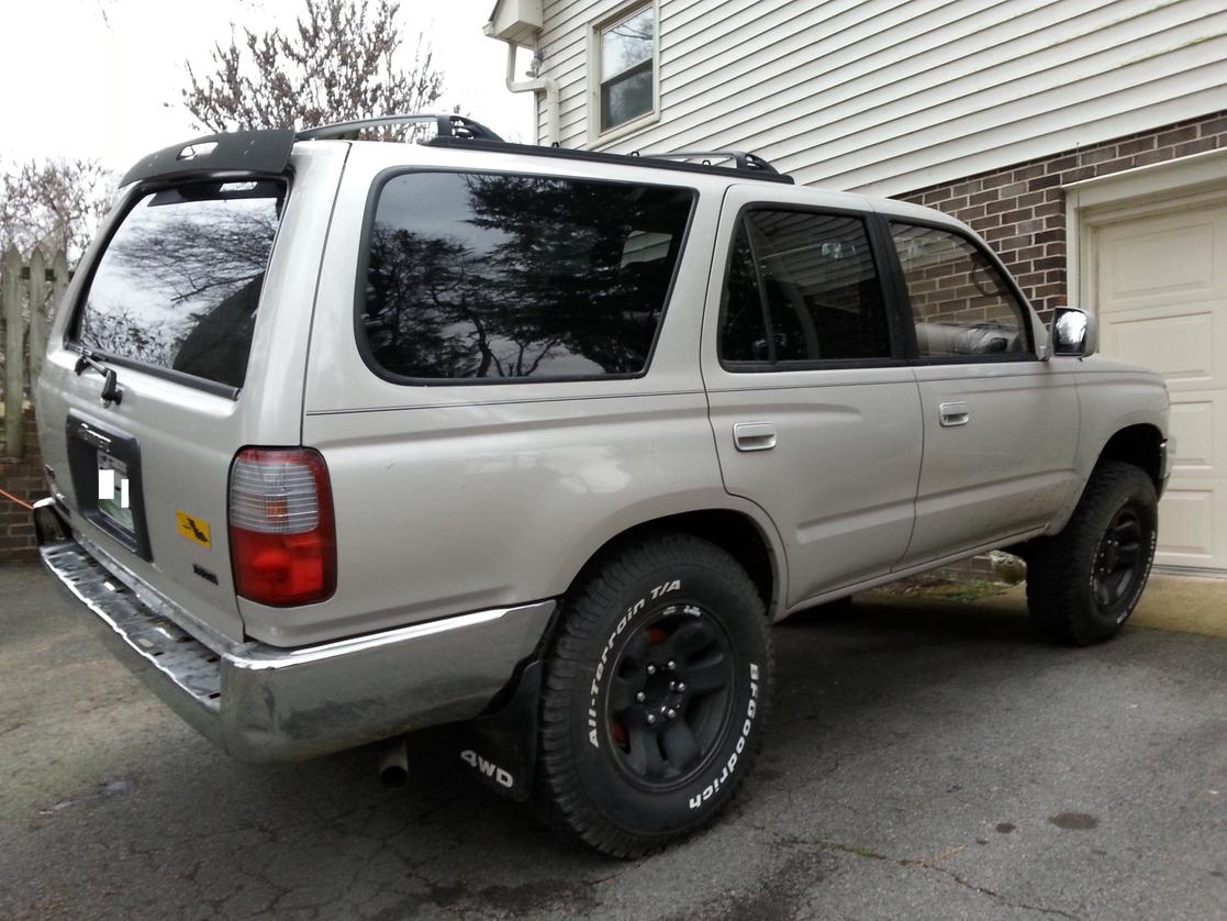

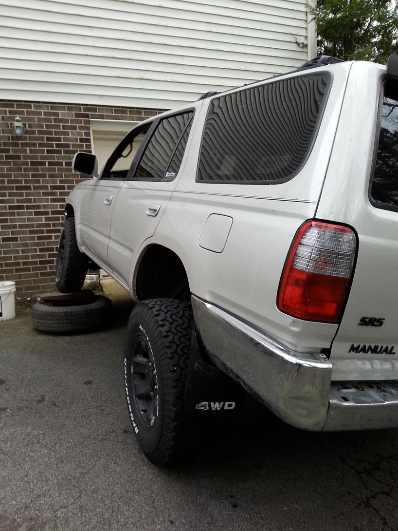

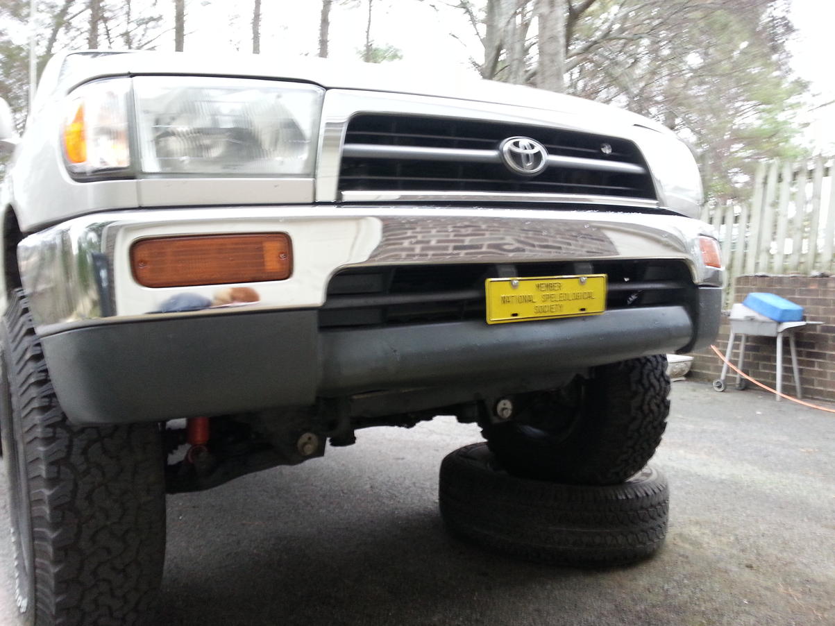

Flex in my sister's friend's driveway. Notice the hitch is gone ;)

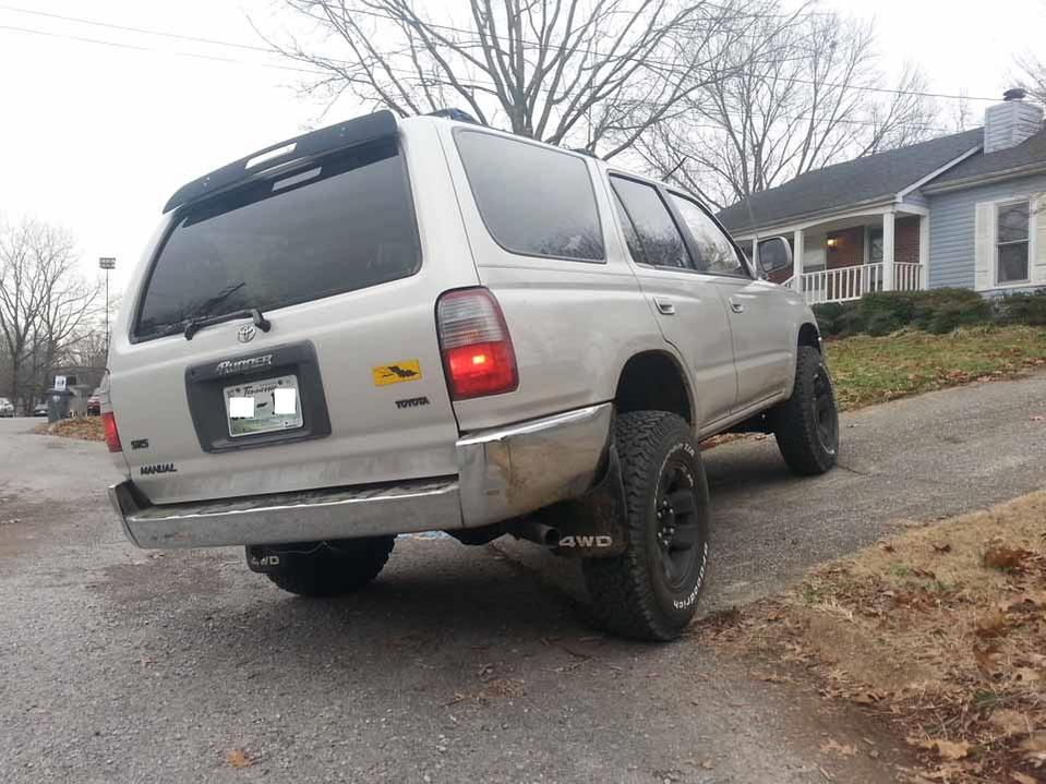

Driveway Articulation :)
I found a use for my 17 year old paperweight!

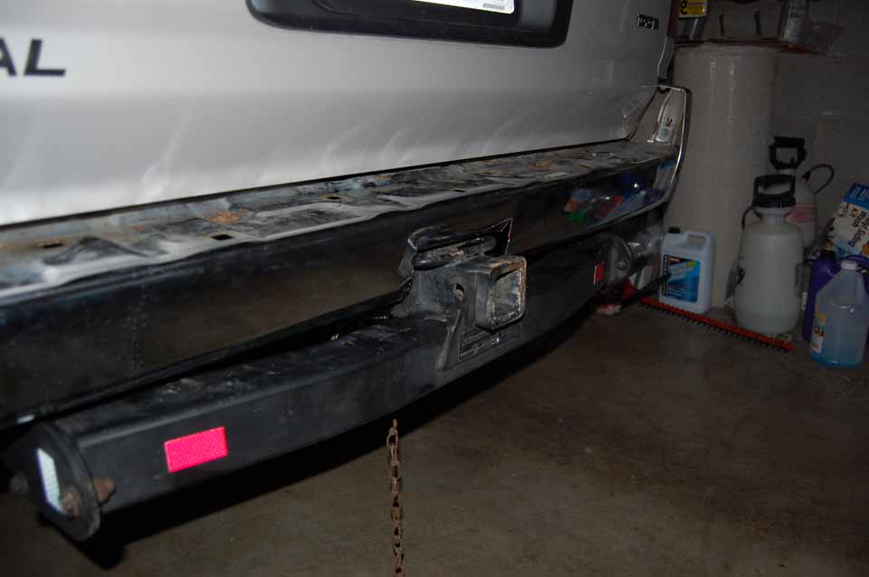

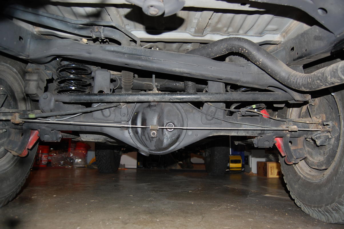

Frame Paint/ Hitch Flip

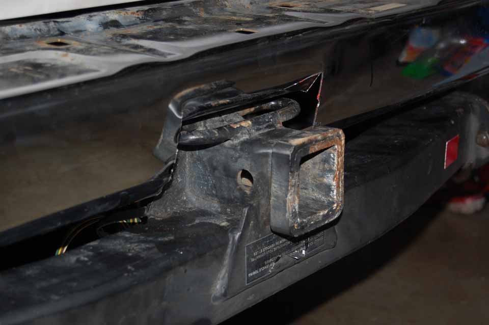

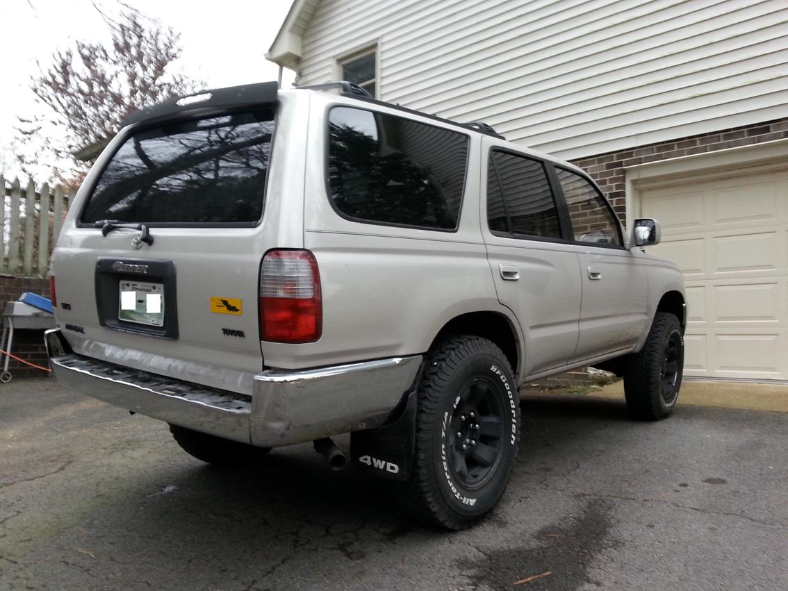

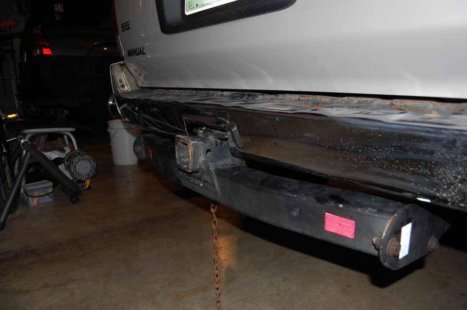

When I took off the hitch, I noticed a little of surface rust on the seams of the frame. The axle was also rusty in places. I wire wheeled the rust an painted with Rustoleum.

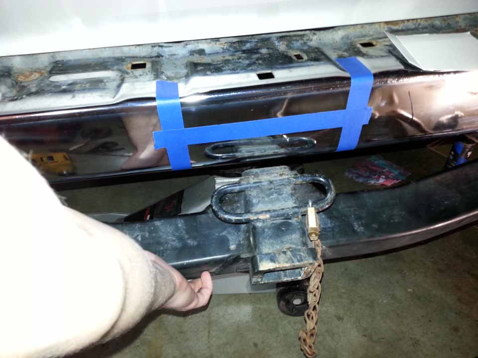

I copied 4Running Daily and flipped the hitch. We marked the lines with tape and cut the bumper with the sawzall. We then bent up the metal with the jack and me jumping on the bumper. It looks great and I gained 3" of ground clearance for free.
