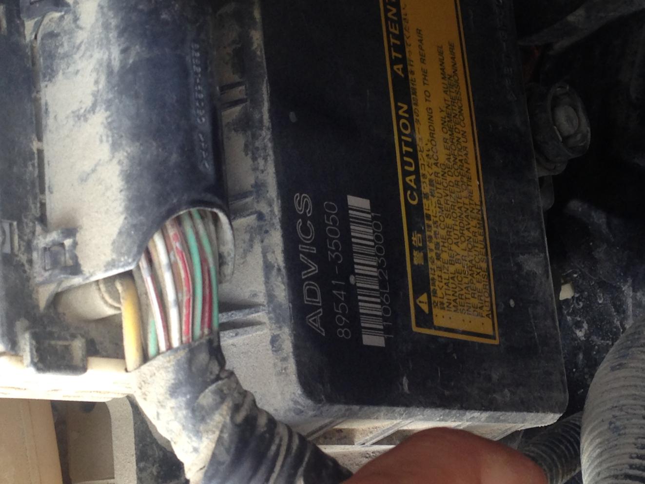

If anyone who has a '07-'09 4Runner with the 1GR-FE 4.0L V6 in either 2WD or 4WD please post the part number printed on the side of the Skid Control ECU bolted to the master cylinder that'd be helpful (please post year and if 2WD or 4WD.) At this point its more for my own personal curiosity than anything.
The part number on this vehicle is 89541-60060, so I am curious if someone tried to change it out in the past at an independent shop (because I don't see any history on it in Toyota's system.)
Here you go, 07 V6 4WD
No need for a photo of mine, same-same part number.
2007 V6 4WD Sport Edition.

Based on the various part numbers for the Skid Control ECUs I saw on the Tacomas, FJs, and 5th gens on our lot (all using the same HydraBoost assemblies, but different ECU part numbers); I'd say that Toyota does seem to have gone with a 2WD & 4WD Skid Control ECU (there's 3 Part numbers when looking in our parts department for a 2008 model year, but it does not show if its 4WD or 2WD; even more confusing there's one labelled "Baja" which I have never seen...)

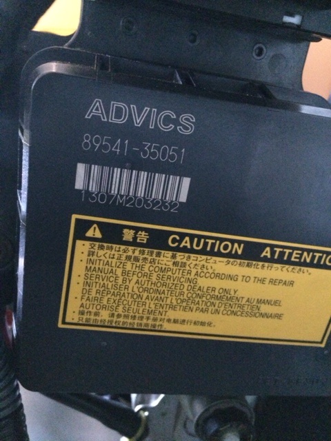

Customer bought the new Master Cylinder and Skid Control ECU (P/N 89541-35051) and the issue is fixed in case anyone was wondering.
Feel free to keep posting ECU part numbers though, I think the unit in the vehicle was from a Land Cruiser Prado?

That's the thing, Toyota doesn't seem to mention anything about the part number for the ECU. The number doesn't seem to match what is on the side of the case when you look it up in the parts catalog (probably because its not available separately.) What's even more confusing is that for the 2008 model year there is what seems to be 2 different ECU/Master Cylinder part numbers but both are for V6/V8; but it does not directly state if its for 4WD/2WD or SR5/Limited, CA/Federal, and/or any indication why there's two different units.
I'm not entirely sure how compatible they are, the unit installed in the customer's vehicle originally does not seem be a 2WD unit (at least based on how its acting) and the only reference I found for the 89541-60060 was a "Land Cruiser 120" (Land Cruiser Prado sold over seas) from non-US Ebay Sellers and non-US part sellers. That's why I was asking if people could post the P/N of their units so I could get an idea of how many different P/N for the ECUs there are.
