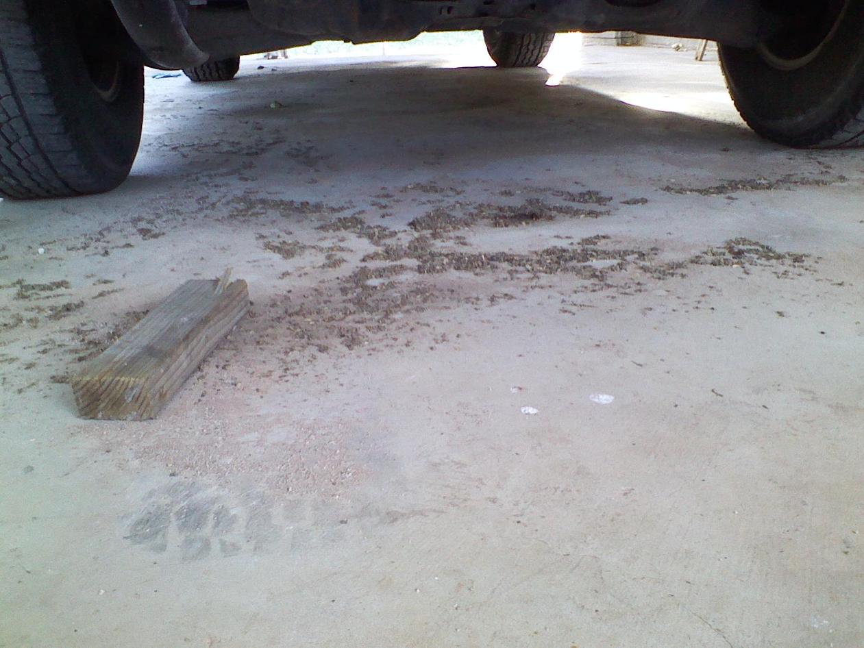

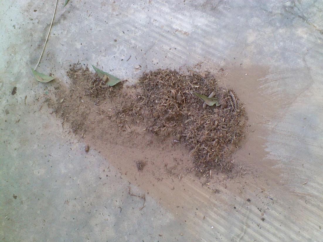

Here is a tip to keep the radiator/Engine temperature at its best.
Clean the radiator and AC condenser before each summer.
IMPORTANT: apply pressurized water 90 degrees (perpendicular) to the radiator/AC condenser core (fins) otherwise the fins can bend.
All the dirt/bugs/grass came from my new to me cruser!
Geez! How'd that block of wood get wedged in there :). I'll have to do this today. Just recharged it yesterday so this will help keep it running.
