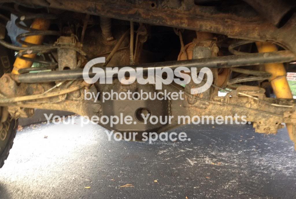

I was worried about inadvertently backing into a rock and ruining a day out on the trail so I decided it was time to armor up the rear diff
I bought the Trail Gear large diff armor from FROR even though it only listed fitment on 86-95 axles. I had to cut my non functioning parking brake cable at the bell cranks, then cut off the mounting bracket that is centered on the back of the third. I had to cut the bottom half of the bracket that holds on the main parking brake line to clear the left side. That cleared everything away on the axle and all I had left to do was cut about a half inch off the back side of the fill plug tube so that the right side would seat all the way down. Only took about 30 minutes in total to get it fitted with no directions. I've got an automatic trans and my parking brake hasn't worked in at least 5 years so it won't be missed
Did the typical wire wheel the axle, por15 the center and then sprayed everything once I was finished.

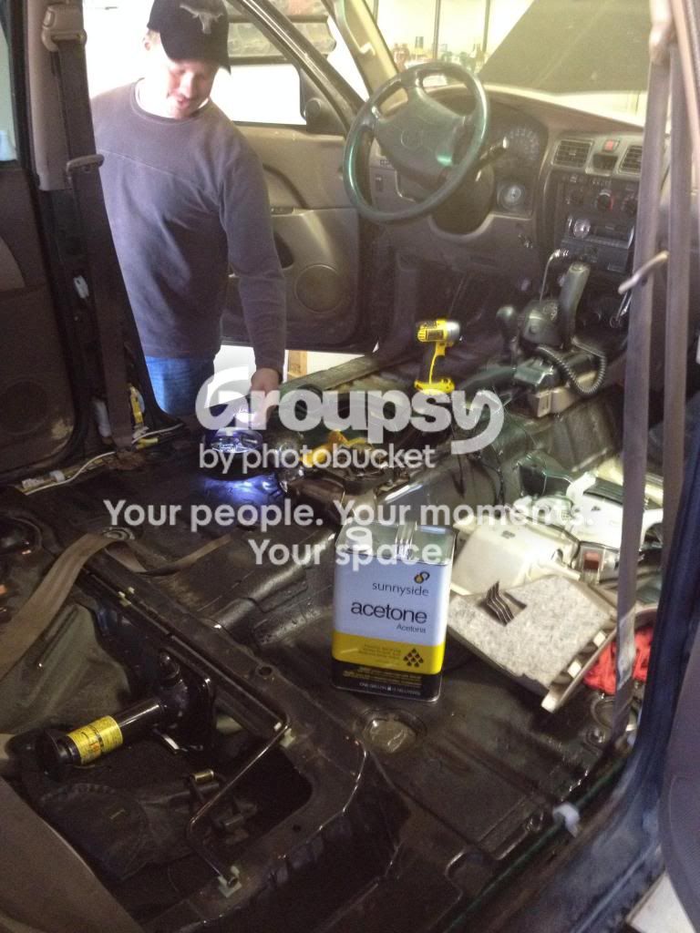

Little preview of the next project I'm working on with [MENTION=85167]jmildoc[/MENTION] 's help. Gutted all my old, wet, moldy carpet and sound deadening and replacing it with herculiner. The noise isn't as bad as expected, little bit louder on the interstate and I can hear that I have a small exhaust leak. Can't complain with that, I'll update with the pictures of the finished product when I roll the liner sometime soon-ish

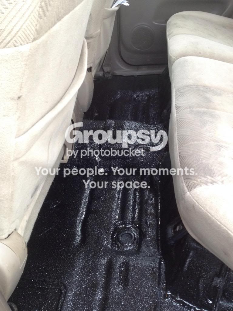

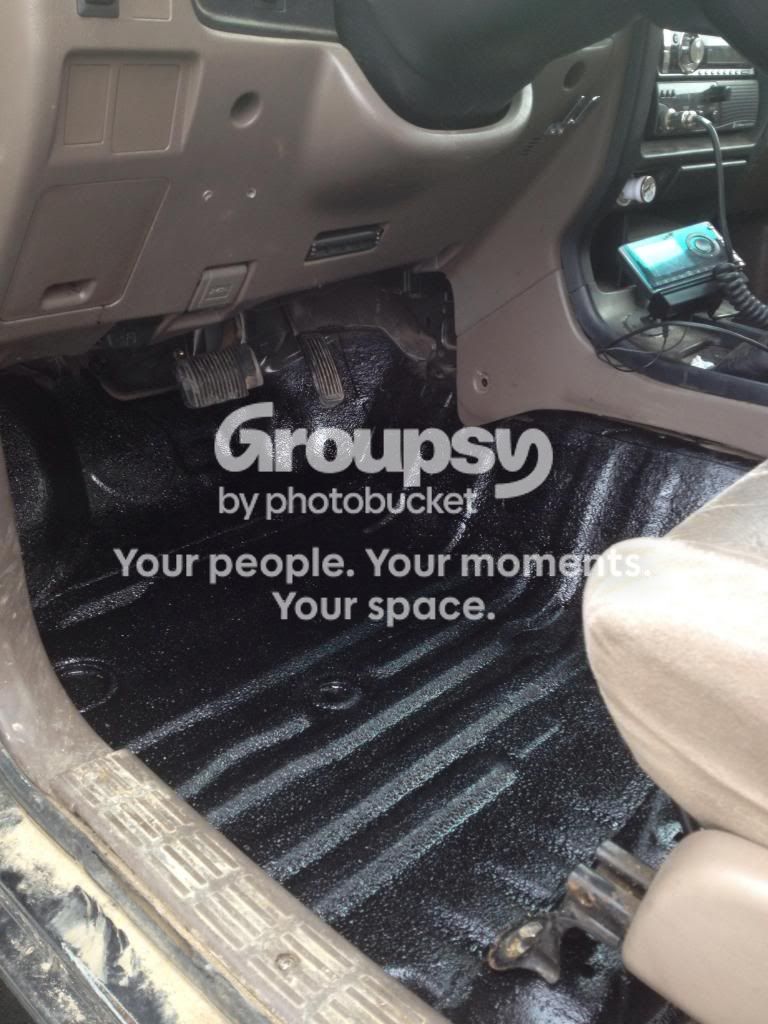

Pics as promised, this is shortly after rolling. Not totally cured yet. I'm pleased with how it turned out and was pretty easy to do, just $150 and some time for no more old nasty carpet is worth it to me...especially with how much I wheel my rig.

No wires across the floor fortunately, made the job super easy. I ended up leaving the sound deadener in the back and only pulling out the stuff on the front floorboards. Where there was damp carpet it peeled right off. Taped off the trim and kick panels, pulled the seats again and away I went with rolling it on. The sound isn't bad, it's a little boomier at highway speeds and I get primarily more engine noise around town. It's subtle enough that if somebody got into the truck they wouldn't be like wtf loud...very subtle honestly

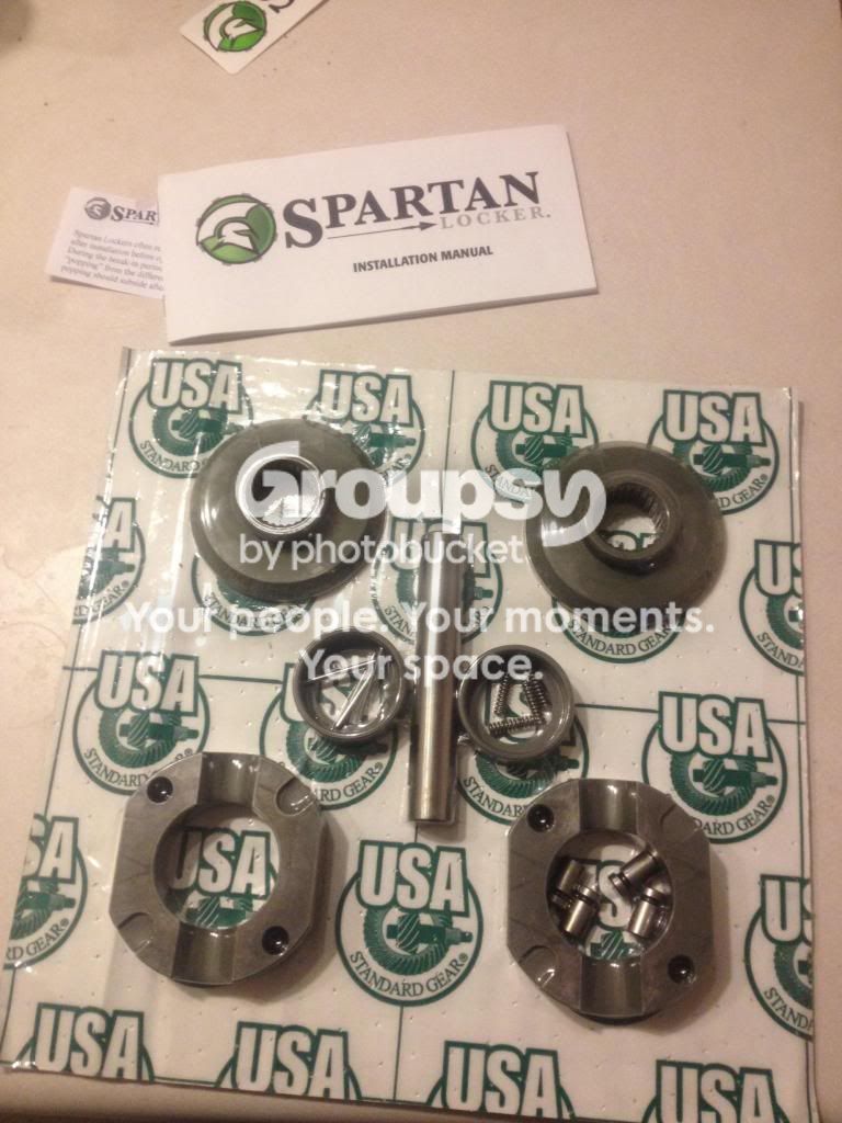

Front locker waiting to be installed for spring wheeling. So far the list for spring includes the locker, finishing my tube doors, and building new upper links in back. Unfortunately, everything is on hold pending what I hear from a orthopedic surgeon about some severed nerves in my left index finger after cutting it at work..
