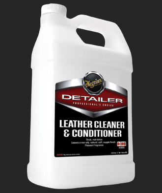

What did you put on the steering wheel?
I'm saving money to repaint the Supra I bought. The Total Chaos UCA's are priced at $750 for a set. It only costs $100 for new OEM upper ball joints and I already had a pair of good control arms laying around the house... the price difference made the call for me on that one. Those uniball joints are nice though, but for the cost, I have some other things on the list to do first.
Steering wheel was conditioned with Meguiar's Leather cleaner and conditioner - http://www.meguiars.com/en/professional/products/d18001-leather-cleaner-conditioner/

Using a leather conditioner on the steering wheel never even crossed my mind... I'll have to do that tomorrow.
Looks good!
There's a few things we learn in the course of outdoor vehicle storage... The sun hates steering wheels. The sun also hates leather. I hope it gives the leather steering wheel the power to survive.
