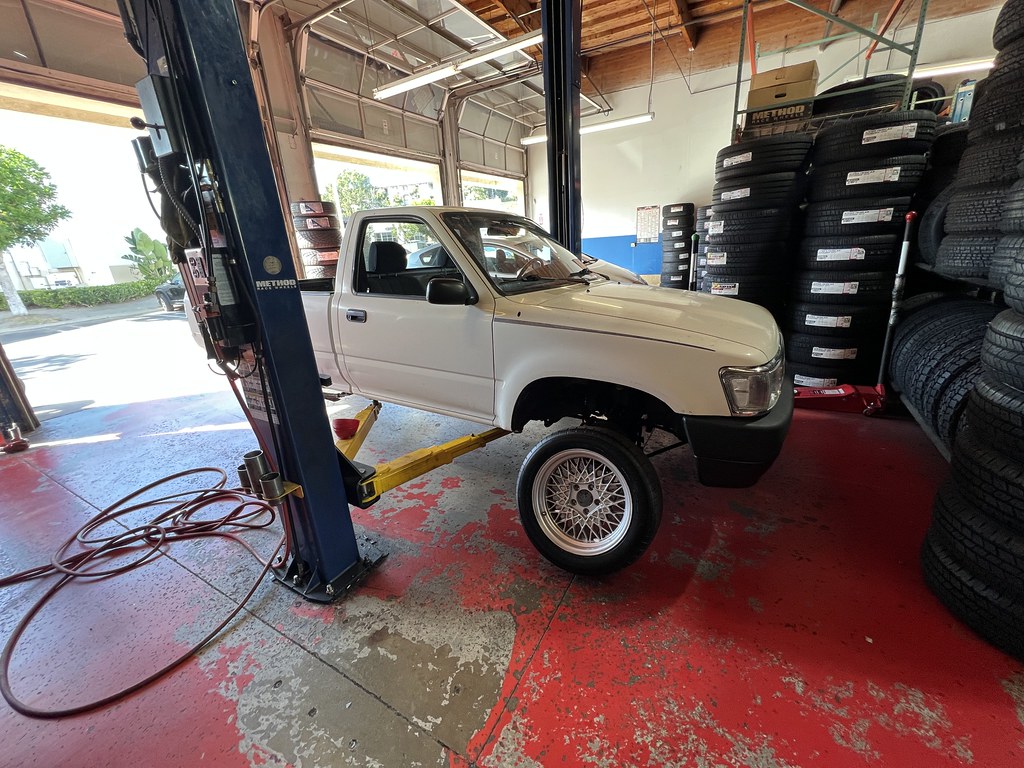

The alignment came out of spec again after the blowout incident, so I had installed some new tie rod adjustment sleeves before loading it up on a trailer to take to the shop once more.
Also loaded up some other wheels for the 4Runner.

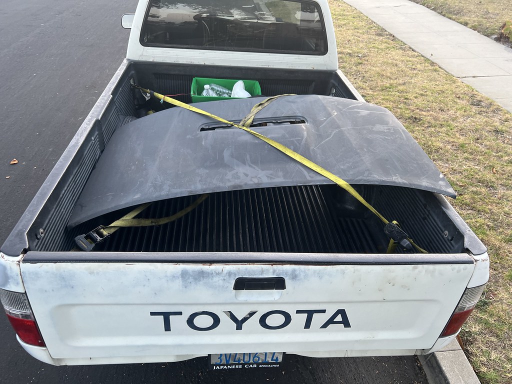

5th gen sport hood
