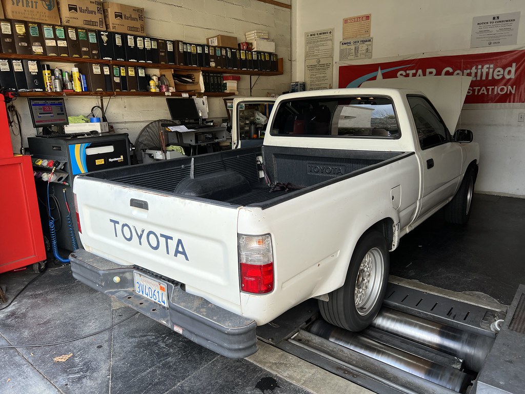

COB's '89 Pickup 2WD
Couple years have passed, picture dump
Pickemup truck!
